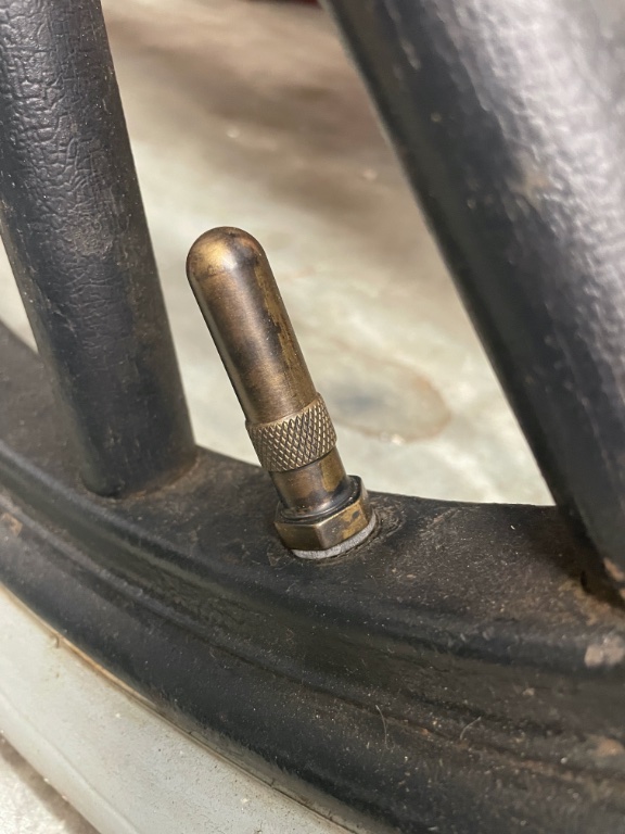

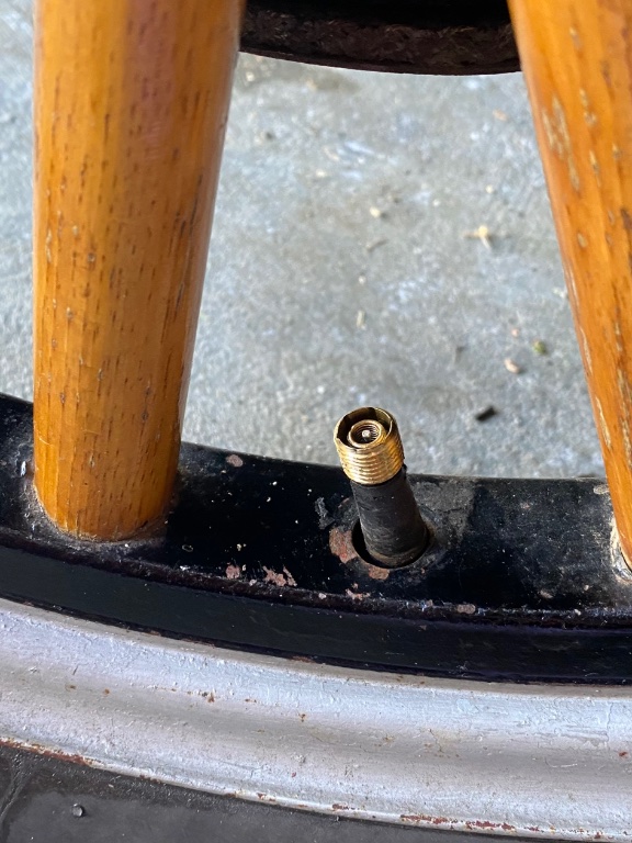

My first T so learning quite a bit. I have 21” wood wheels on my 26 Roadster Pickup. I went to check tire pressure but was surprised when I removed the dust cap on one of the wheels. It looks like the stem and valve are inserted into a larger stem and valve. At first I thought the dust cap cap apart and left part on the wheel but in comparison to the other dust caps it doesn’t seem that’s the case. Before monkeying around I figured I’d asked the club. What setup do I have in this wheel and how do I access the valve to check pressure and pump up? Didn’t want to break anything
Posts: 5583
Re: Tire valve question
Post by RajoRacer » Thu May 25, 2023 10:42 am
Those are accessory stem covers to look like old timey covers ! The adapter came off from inside.

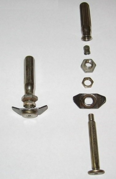

You have an aftermarket dust cap setup designed to adapt to a modern rubber stem tube. The threaded insert inside is adjustable to compensate for different heights of rubber stems. I am running them right now on my 1912 Flanders 20 because it came to me with rubber stem tubes and I don't want to change them out for now.
https://www.modeltford.com/item/DC-RSBR.aspx

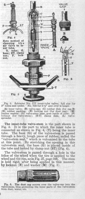

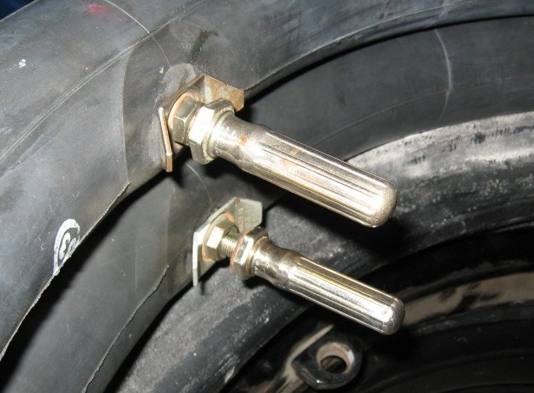

Model T Fords originally came with Schrader 777 stems that clamped the rubber tube, see the attached pics. Although valve caps and dust covers are fairly available, the stems and other parts themselves can be hard to find. If you want to switch to Schrader 777 metal stems, keep an eye out on Ebay and the classifieds here. Schrader 888 stems will also work, they are 1/4 inch shorter than the 777 stems. You can cut the rubber stem off of a modern tube and insert the Schrader 777 or 888 stem like this:
http://sheepisland.com/cars/tech/metal_stems/
The metal stem tubes currently available from the vendors use a larger size metal stem, not compatible with Schrader 777 hardware. Some folks run them anyway.
Do a Google search for "schrader 777 stem mtfca" and lots of older threads will show up. :)

Jim
the answer to your question is this: your aftermarket valve cover has come apart and left part of itself stuck/threaded onto the tire valve. Use a padded pair of pliers on those threads and they will screw right off, leaving a normal looking rubber stem exposed, to which you may add air.
Your old cover may or may not be repairable by applying a small dab of epoxy and screwing the thread adapter back in.

Jim - carefully twist off the little brass piece off the tube stem then air up your tire. You need a large hex wrench to screw the adapter back into the cover.

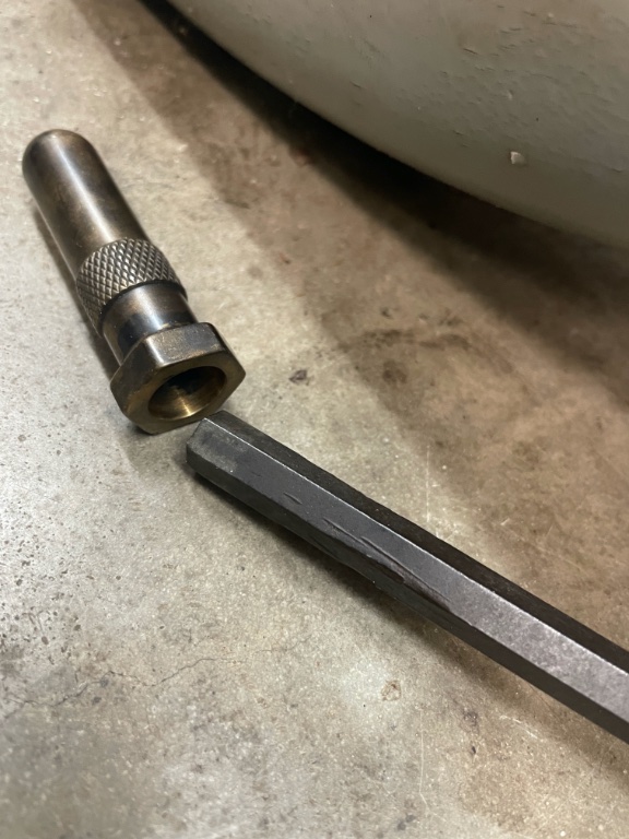

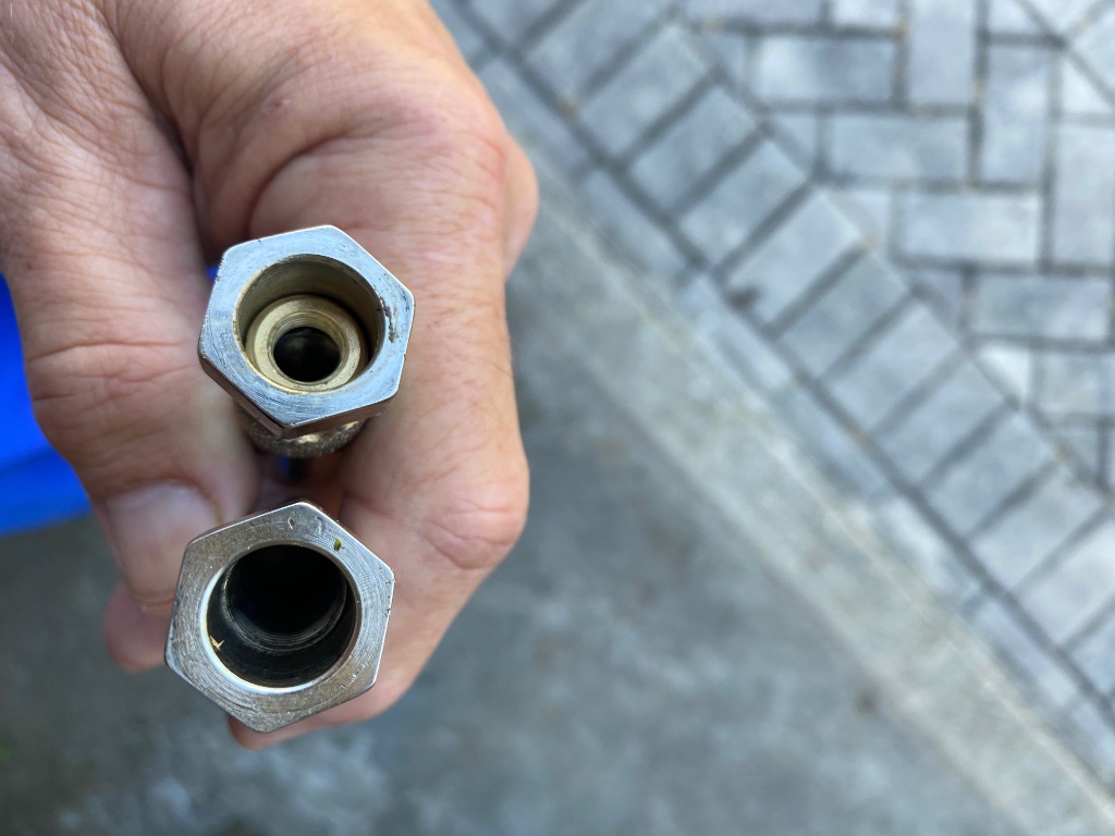

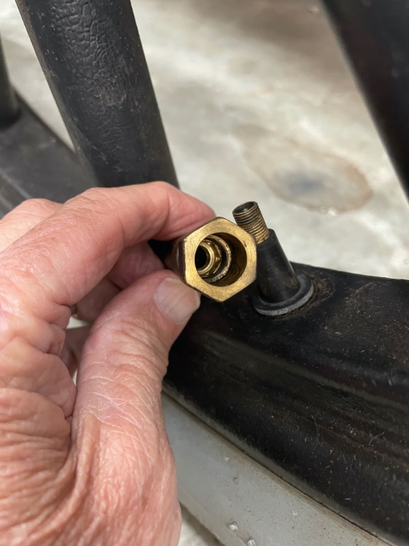

Here is same type repro cap for rubber stem tubes in brass. The insert is threaded for the valve stem, and is adjustable for depth depending on the wheel application. Once you get the insert out, it has very small splits that you can pry out just a little, and that gives resistance to backing off with the larger threads inside the repro cap. The insert uses a 3/8" hex wrench to position it back to where you want it, trial and error, but you'll want the cap to bottom out on the wheel felloe, or that insert can stick like that one did.
