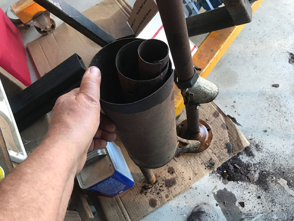

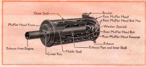

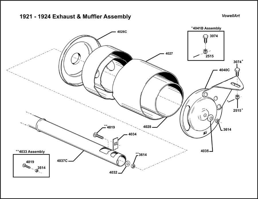

Post by TRDxB2 » Sat Sep 09, 2023 3:25 pm
Assuming normal engine running & just focusing on the muffler issues. Not exactly sure what muffler you have
