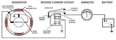

Travis, welcome back to the forum!... The cut out you have on your generator may be in question, if it is a real cut out or is it a voltage regulator from fun projects? Flashing the generator with a fun projects, voltage regulator will cook your voltage regulator , will give the same results as you're getting with constant discharge. Looking at your generator comutator surface,... is it shiny copper yet or has it a gray to black look to it? Cleaning that commutator with some light sandpaper while it's running may reestablish your working generator. How many times did you readjust the third brush for a charge change? If your rebuilt generator did not include new insulating gaskets , you may have a grounding fault on that third brush which would result in getting no charge in the generator. There are a couple variable factors that you have to address to get an answer. Good luck!!

Good morning Travis... That third brush is mounted on insulating gaskets. When that generator was purchased how much of it was rebuilt if any?.... I have come across rebuilt generators that look like they've been repainted, and that's all. With moving that third brush, loosening to a degree that it would drag when moved before, tightening has a probability of breaking that insulator and having that third brush ground out by touching metal in the brush retaining ring... Original gaskets will dry out, become brittle from age, engine heat and cold cycles and moving that brush will change generator output and none if grounded out...... The commutator is visible when the band is taken off and gives access to moving that third brush. Would there be someone in your local chapter that could have a hands-on check of that generator?

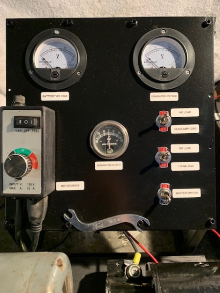

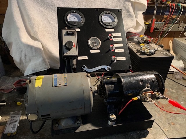

I rebuild generators and have a bench tester I made to quickly diagnose issues. I can walk you though a few tests if you have a basic voltmeter.
Shoot me a message if you want to take a few measurements.

Understanding the purpose of a cut-out..... trying to keep it simple
The purpose of the cut-out is to prevent battery voltage from running the generator as a motor. The original cut-outs were electromechanical switches that would open or close based on generator output by setting a setting its points to open/close at a specific voltage. So when the voltage of the generator is greater then the voltage of the (correction per Jerry V below not battery but point setting, the magnetic coils on the cutout will close a switch connecting the generator to the battery. --
If that voltage threshold is not reached the points would remain open and there would be no current reading. As a result the ammeter would not register a positive amperage value. Since the original cut-outs required a voltage source to operate when they fail it could be that the points need to be set or the voltage from the generator is less than that of the battery.
An electronic cutout using a diode serves the same purpose but operates more of a check valve than a mechanical switch.
A Voltage Regulator includes the function of a cutout as well as regulating the output voltage to the battery to prevent it from overcharging. The Model T generator design, 3rd brush, means that a special VR is needed not just any 6volt one
The ammeter is registering amperage load on the system. Theoretically, you could get a positive reading with lights on if the 3rd brush was set to a value greater than what the demand of the electrical system is. The recommended setting of the 3rd brush is 5 to no more than 10 amps. Filament bulbs take 1.5 or more amps. That is why many change to led bulbs that draw less than .5amp - do the math
Bottom line - the ammeter just indicates if the generator and cutout are operating correctly.

UPDATE:
I sent the generator off to Chris Mize and they put it on their bench spinner and was able to set the null point. I just installed it today and it’s working fantastic now.
Travis Towle
Topeka, Kansas
Travis Towle
Topeka, Kansas
