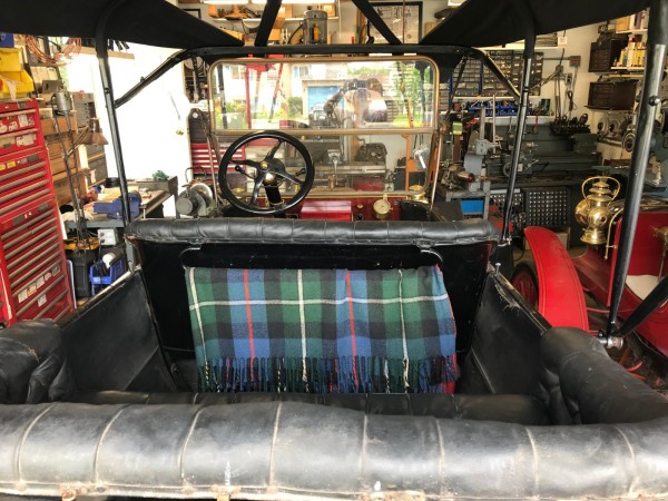

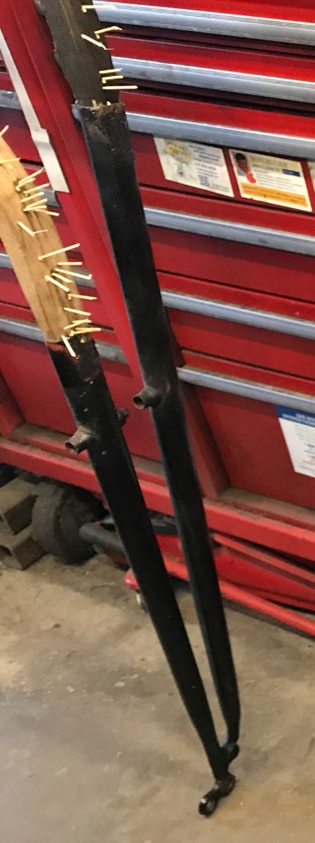

I'm installing a new top on my early Canadian '13. It had a new top sometime in the past and the original "top covering" was still on the bows up until today. Because of the amount of tack holes in the wood needing plugging, I decided it was best to replace the front bow top material covering.
As far as I can tell, this top never had the front flap installed that takes up the space between the top and the windshield. I remember when I was a kid when this car still had it's original top, and there was no flap then either. In fact there was a rear view mirror installed on the inside of the top front bow. Only screw holes remain of that accessory.
The top assembly on my car seems to be more of a "1912" style, but it did have a '13 rear window according to my photos. The locating sockets that lock the top assembly together when it's down indicates a "1912" style top sockets.
Did all '12's and '13's from the factory have this top flap?
Thanks for any input!

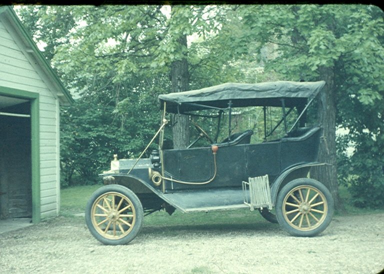

In this picture of the car from 1912, you can see fairly clearly there was no flap. I see the top straps running right to the front bow. Even though the car is 16 years old in this picture, what are the chances that piece was removed?

Darren J Wallace wrote: ↑Sat May 25, 2019 9:07 pmIn this picture of the car from 1929, you can see fairly clearly there was no flap. I see the top straps running right to the front bow. Even though the car is 16 years old in this picture, what are the chances that piece was removed?

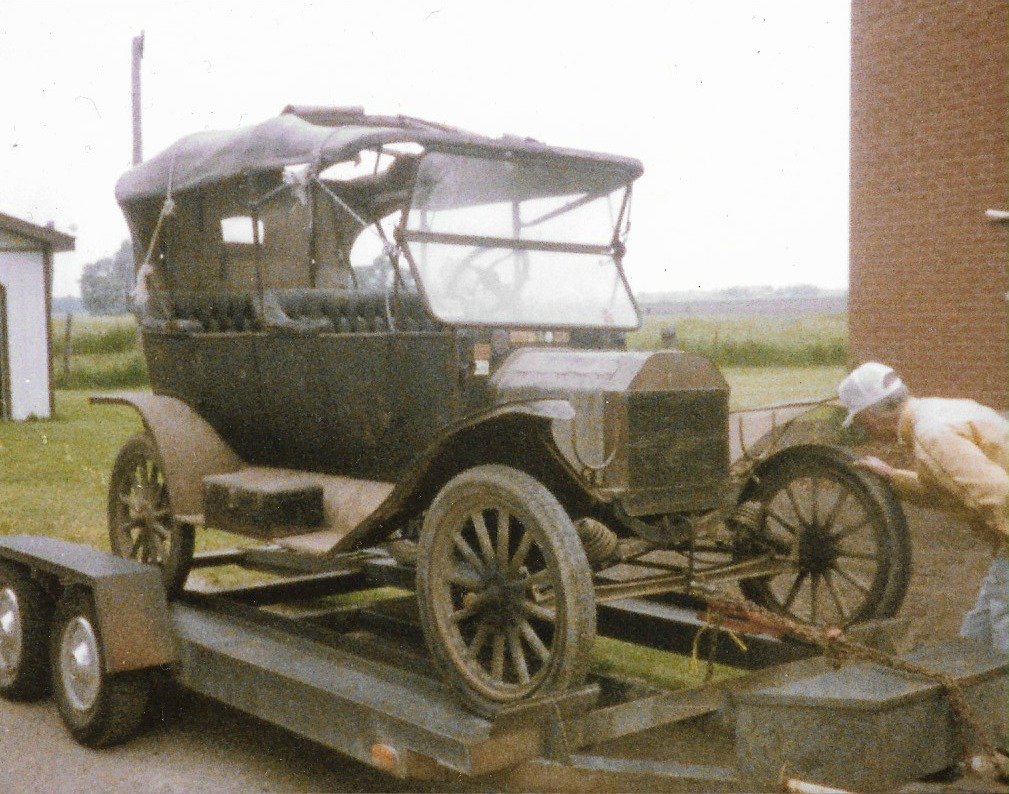

This photo from 1989 shows the original rear window

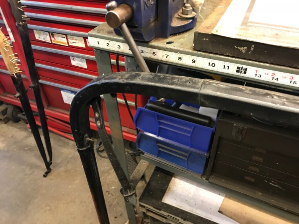

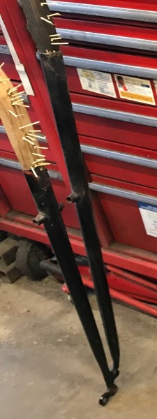

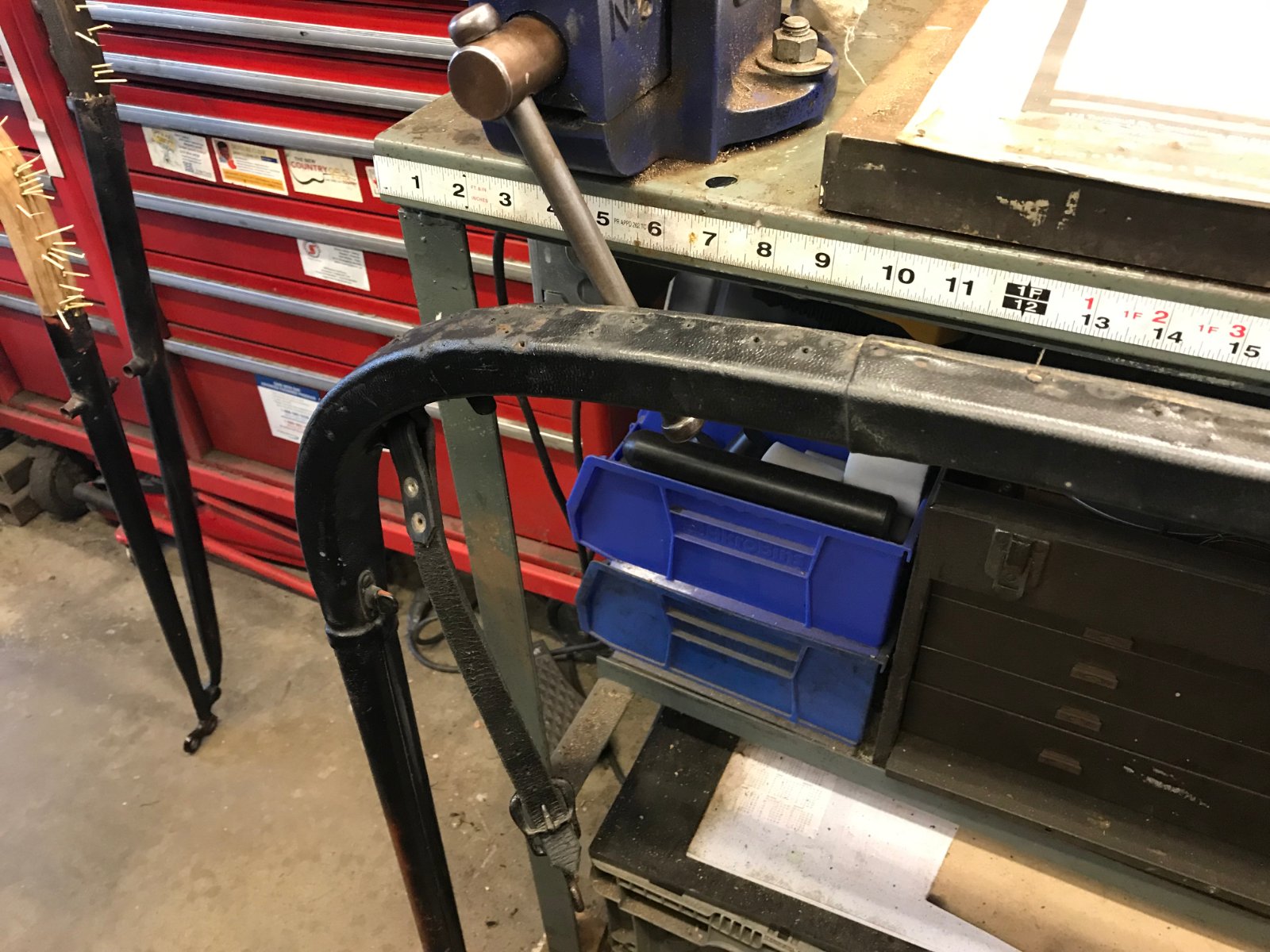

Here are the top sockets locating bushings for lack of a better description, they're quite thin, and not like later ones which are much fatter looking, and the original material over the front bow if this helps.

Don't forget, the front bow doesn't use bow drill. It uses top material, and MUST be installed on the bias. It is really a job to get it right, and uses quite a bit of material. I've found a heat gun, and contact cement help a lot. Expect sore fingers too. Next, I can't imagine your car having a rear window as small as the one in the old photo.

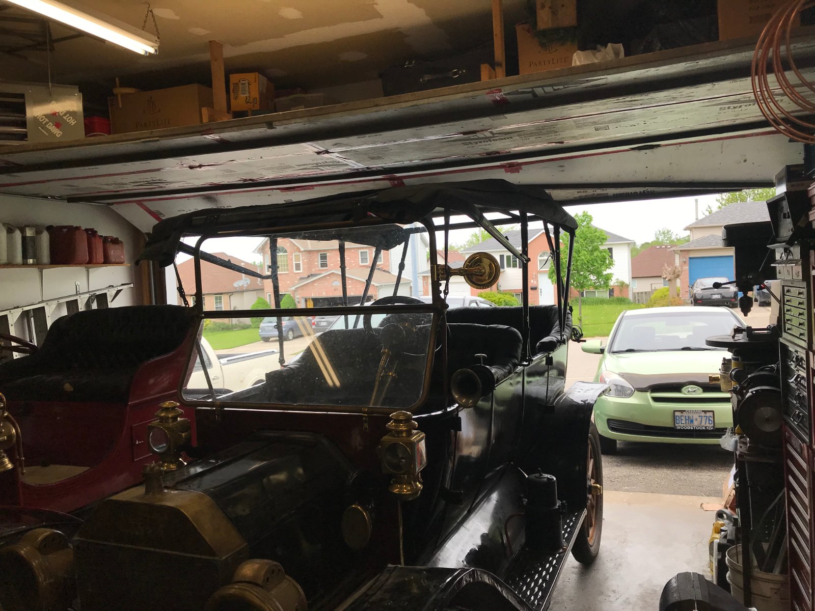

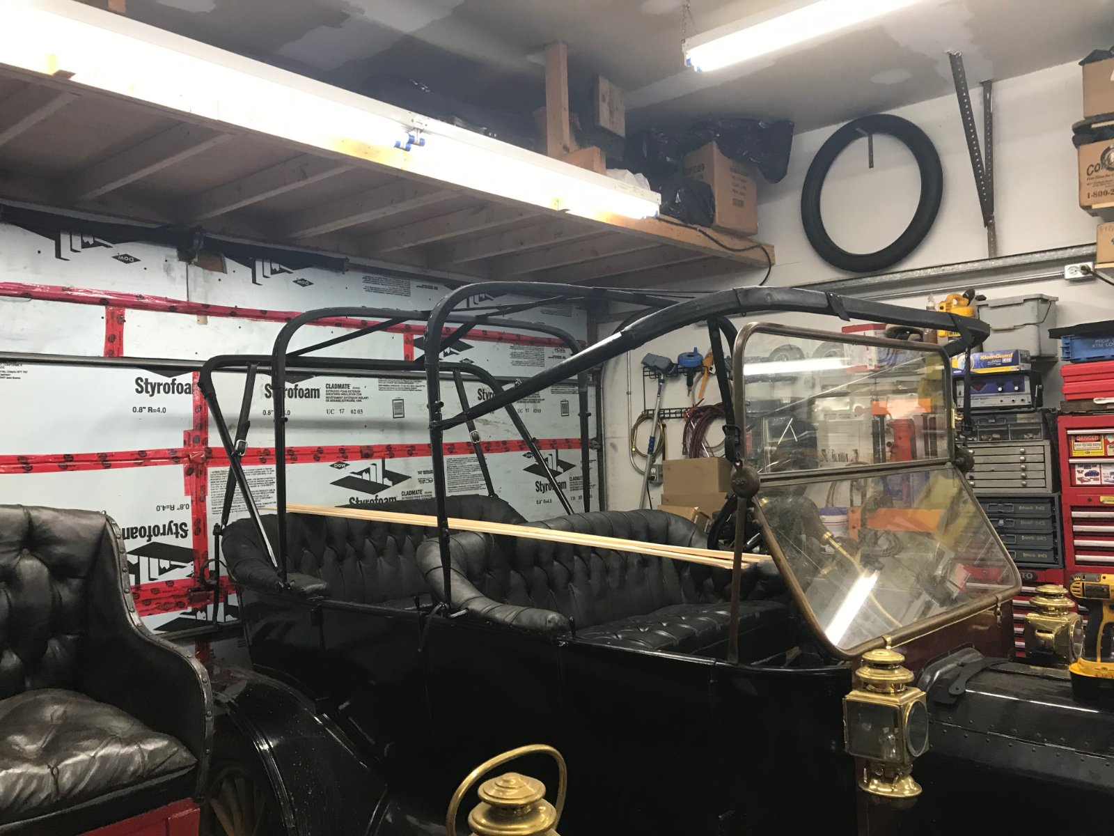

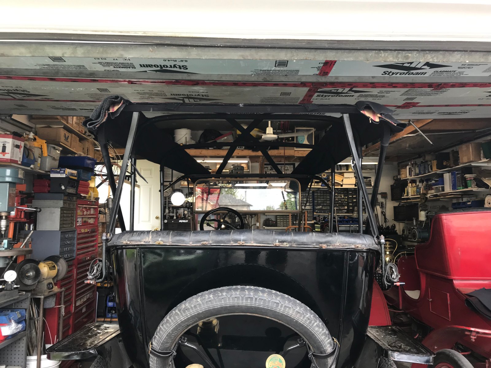

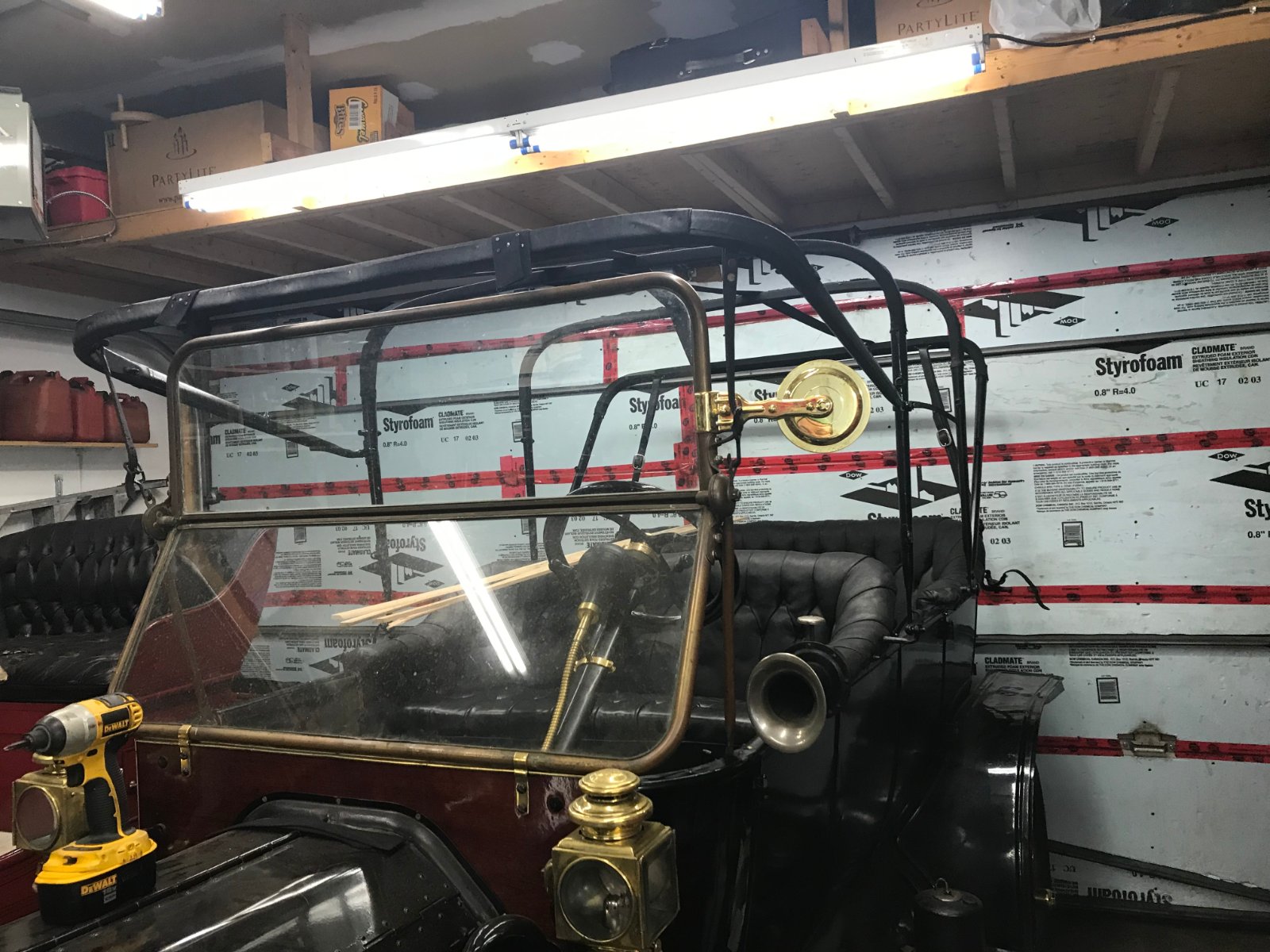

More pics from today's work

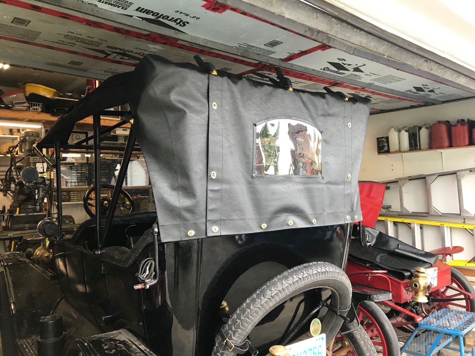

Had to correct the top pad on the driver's side, the pic was taken before I did that. These project require a gazillion checks and rechecks. So far, all the dimensions are really good. I've been using a pictorial guide from Royce Peterson's website and it's been a huge help, with a lot of time saving suggestions! This is the third top I've installed in 20 years, but this one is going a little easier thanks to what I've learned previously from my past mistakes

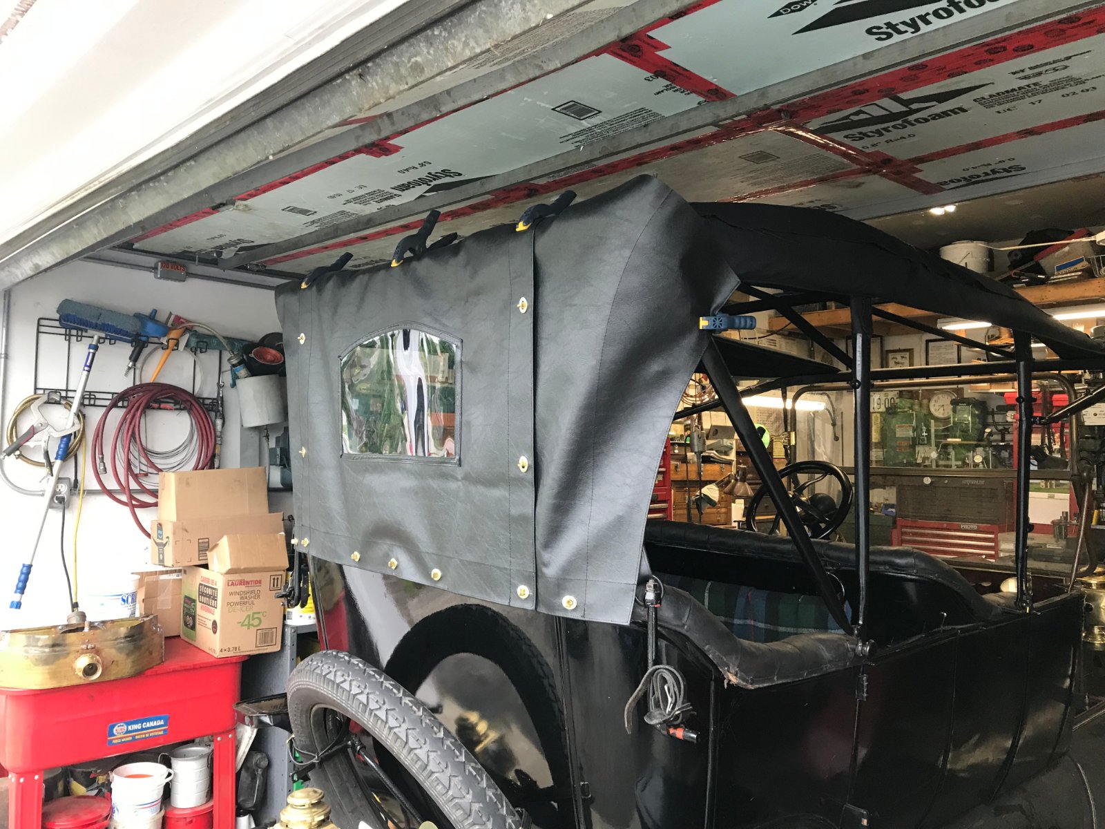

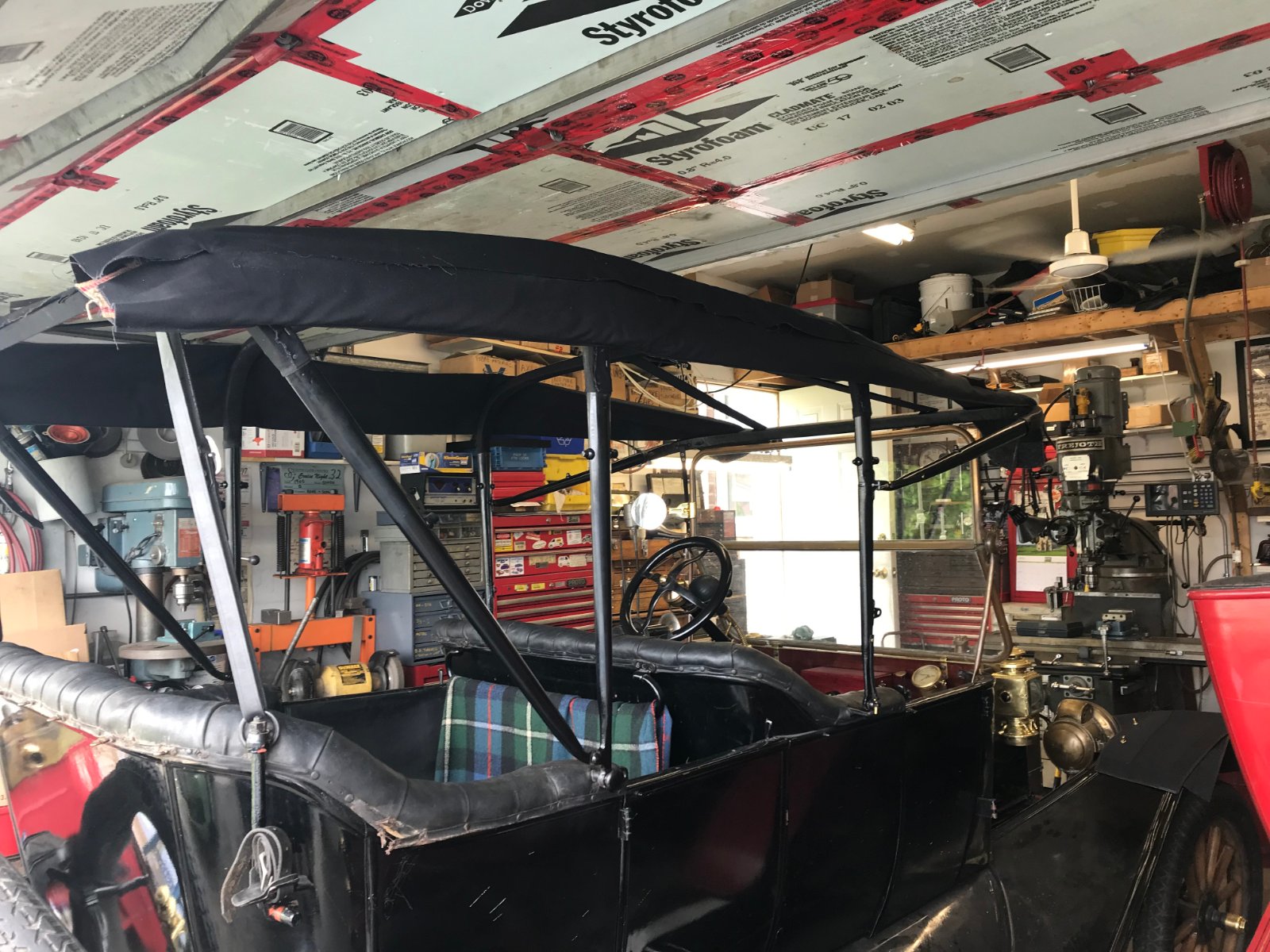

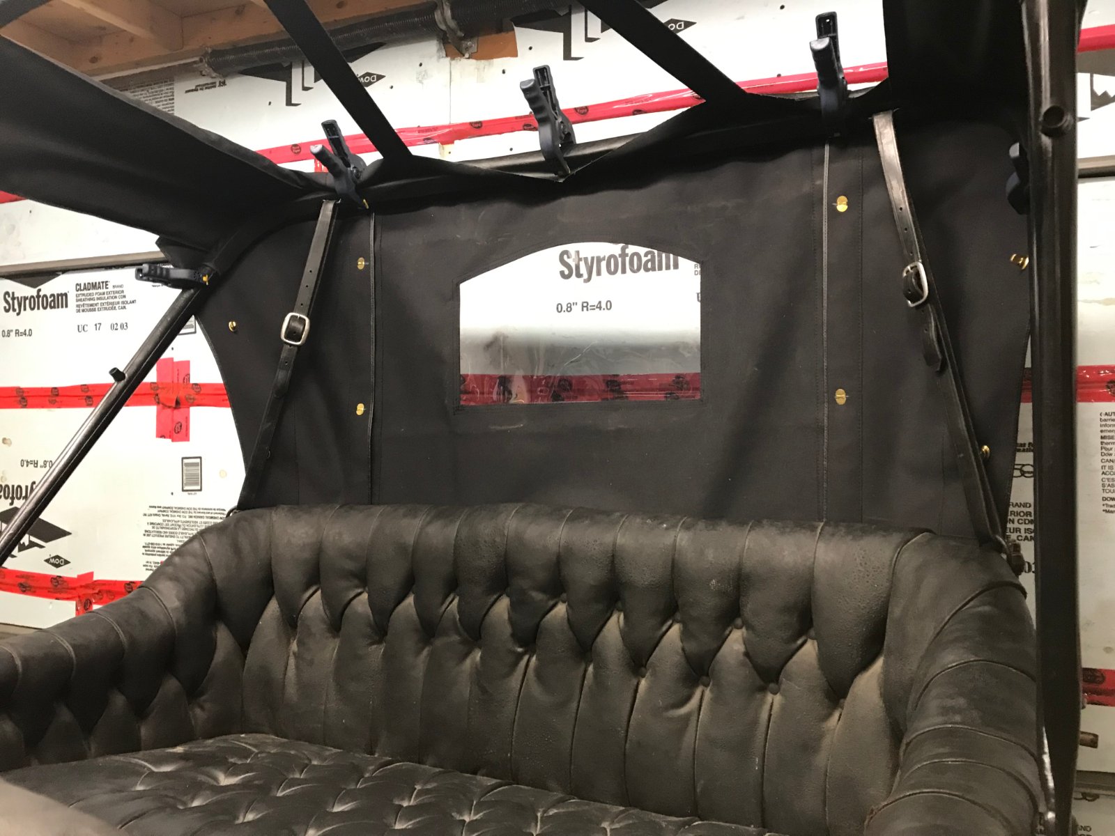

Much better now!

Re: Question regarding details of top installation on my '13 Touring
A little more progress....too cold to tack to the bows. Classtique left the Murphy fasteners off of the bottom row so I could match them to the car's original fastener positions. I wonder why they put them on in such a manner?
