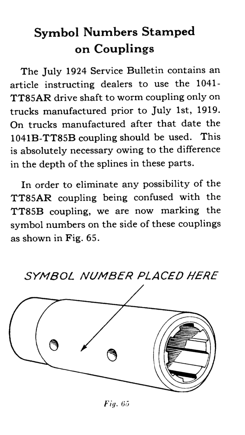

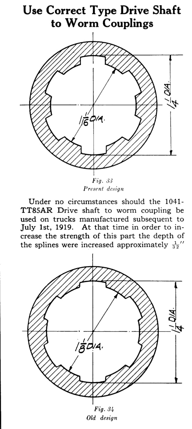

Here are specifics on the TT variations:
1920:
Then, by 1924, they realize the mis-match causes problems and tell you not to do it!
1924:
The couplers began to be “marked” late 1924…
Later in 1924:
