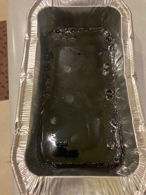

Tried the Bar-B-Q idea @ 150 degrees no movement was noticed. I kept increasing the heat a little at a time. The tar started to move @ 500
degrees. but did not melt all of the tar out. It did how ever destroy the wood, the connections & the bake-a-lite parts & melt out all of the
solder leaving the coil a complete loss. Good news is I have 1lb 10 OZs of high temp tar/bitumem for sale if you rebuild coils.
& the high
tension coil wire cover that I didn't leave on the coil for a Atwater Kent model K 2 coil. & can know show others where everything in the coil
box is if you want to dig the tar out with a screwdriver.
Somedays this hobby is not as much fun as others.
Craig.
