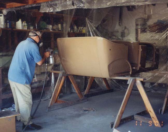

I painted mine right here at home. If you don't have a compressor and spray gun, you can rent one from an equipment rental store. There is one right here in Alpine across from Al Poncho's Mexican restaurant on Alpine Blvd. I put sheet plastic all around the garage and opened the door. Worked fine for me. Used Acrylic enamel from PPG in Santee. I did not use clear coat over it. Since I park in a garage, there has been no problem with the paint for over 20 years.
See attached picture

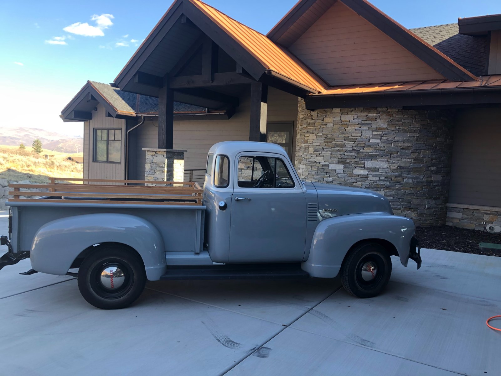

I'm another MAACO fan. In 2008 I did a frame off on a 52 truck. Talked with our local MAACO in Texas and they said if I primed it myself and wet sanded (which I did do in my driveway), they would finish paint it for $800. They actually talked me out of their $1200 paint job and said their cheaper one would cover more imperfections and look a lot more like 1952 paint and last just as long. I'm sure that would cost something like $2000 today, but thats probably a lot cheaper than what other shops might charge. I know from talking with other car friends their typically paying $4000-$10,000 today depending on what they have done and how perfect they want it to be. Here's a pic of my truck taken 2 years ago. It still looks exactly the same.
