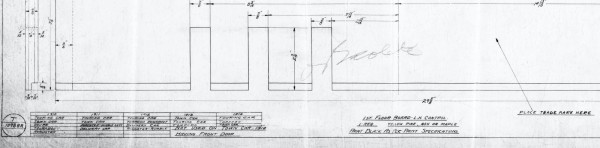

Use mail to order, or electronic, download the form from the website for drawings. As mentioned, you have to use Factory Numbers, not Part Numbers from the Parts and Price Books, the Factory Numbers are normally also listed in those books. They do like to send the drawings electronically, in pdf files. I personally find that Digital Image Order form is the way to go. Usually mail the form with check payment. If not enough payment for the work, like if extra reaseach is needed, they will just bill you for additional. The prices are noted on the form for what you are requesting. If your want print copies, specify that, but the price goes up, and some of the paper prints are very large for even small parts.
Here was a request made during the pandemic, but got lucky. Also showing a portion of the drawing for a # 1 board on early Ts, like a 1911. Easy to print off the electronic copy when saved to your PC.
(Click on images to enlarge)
P.S. You can see that the old myth of 'shipping crates or parts boxes being given specs to such suppliers by Ford for floorboards' is indeed a fairy tale.No parts supplier could meet these specs, including the noted finish in black paint. And any small parts in a box with slots and holes would fall out

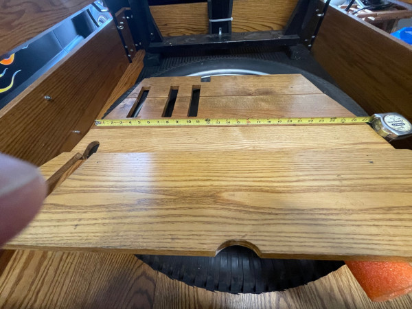

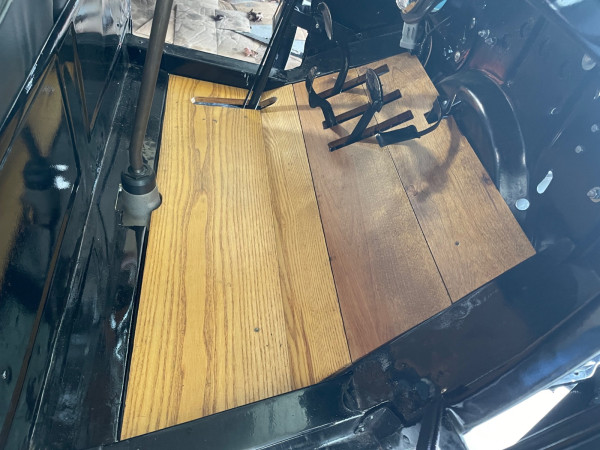

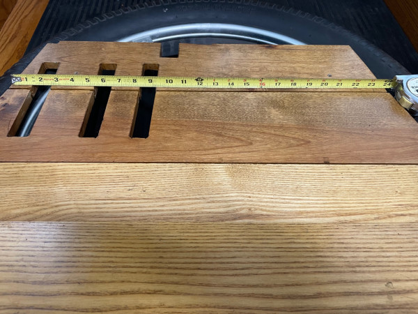

Here's some photo's & measurements from my 24 C Cab floorboards. Ordered from Lang's a few yrs ago. Waited over a year for their vendor to deliver, opted for hardwood but got 2 different types of oak. As you can see I added a foot throttle notch. The hinge in the middle helps installation. Hope this helps.
John M
Oscoda, Mich
John M
Oscoda, Mich

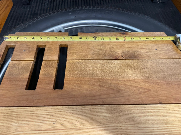

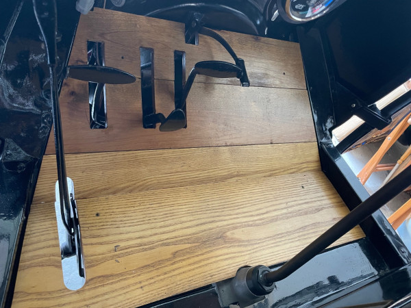

Re: Source for C Cab TT FLOORBOARDS
More photo's

Great photos but it might be a '24 BUT you have '26-'27 transmission pedals so the slots are not in the same position.
- Posts: 115
- Joined: Sun Jan 06, 2019 4:43 pm
- Last Name: Monticciolo
- * REQUIRED* Type and Year of Model Ts owned: 1924 C Cab truck
- Location: Oscoda,Michigan
Yes, I installed the 1924 cab on a 26-27 chassis, and lowered
The truck Henry Ford should have thought about producing.
John M
] the roof so it will fit in a standard garage. All original running gear with some modern upgrades for safety & convenience. Tried to use up surplus T parts before they end up in the scrap heap.The truck Henry Ford should have thought about producing.
