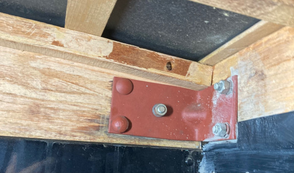

Post by George House » Wed May 01, 2024 12:51 pm
….specifically for TT C Cab top wood metal corner brackets. Each of the 2 rear corner brackets have 5 bolt holes for 5 carriage bolts - 3 with nuts on the inside and 2 with nuts on outside in the rear. Of course I’m removing the zinc finish from the carriage bolts and painting them black…… but are the nuts square or hex ?? Any original C Cabs with brackets out there ?

Looks like the original nut is square on mine.

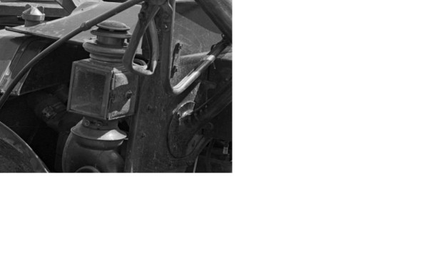

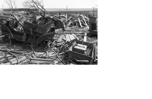

George, these photos were taken in 1913 of a Tornado-damaged '09 or '10. Look at the nuts on the dash. They are square for the windshield but hex for the lamp brackets.
Sorry, these are not great photos but what I had available.
