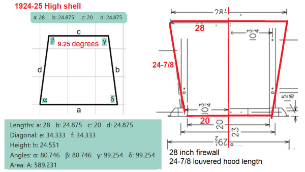

Given the dimensions of the hoods & especially the cowl (firewall) measurements, there would have to be a flare difference for proper fitment since the front mounting points are the same width apart. Going to see if I can do the math

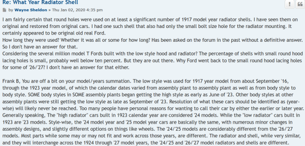

I understand that '26-'27 shells no matter what material they were made from had ROUND lacing holes - earlier are open rectangular.

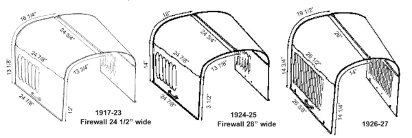

John, I don't know the reason of the change from rectangular to round lacing holes. I don't know that anyone alive, today, does with authority, but I have had 23-25 steel shells with the rectangular and 26-27 steel and brass shells with the round holes, but no rectangular in 26-27, which verifies what Steve said. Also, Thank you, Frank, for posting the dimension diagrams of the different hoods. As they show there was only 1/8" difference on the top hood panel on each side (total for both sides of 1/4") compared to a 26-27 hood and they show a 1 1/2" difference (per side; total of 3" difference) in the hood width at the firewall, it is obvious that the shell sides on 26-27 shells must have a greater flare than the sides of a 23-25 shell. I do not currently have a 23-25 shell to observe, but my previous observation is that compared to a 26-27 shell, the sides on a 23-25 shell have no OR ALMOST no flare to them. If they have any flare, it is minuscule compaired to 26-27 shells.John kuehn wrote: ↑Sat Jul 06, 2024 3:08 pmMaybe a different company making them or a design change for what reason??

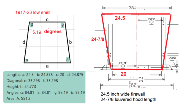

These "estimated" calculations are only intended to show that there should be a difference in the flare of the shells in order to support Allan's observations. It may be that for whatever reason the sides of the shells were adjusted, flared, for a better fit once the hood was placed on it.
Don't have a measurement for a 1926 firewall
for 1917-23 low shell possibly a 5.17 degree flair
for 1914-25 shell possibly a 9.25 degree flair

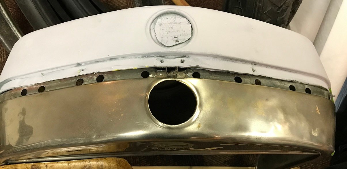

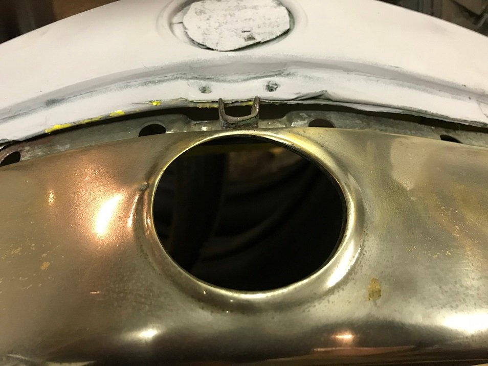

Re: High radiator shells

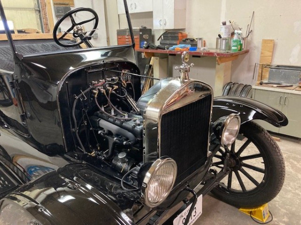

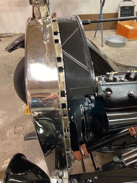

This is a July 25 Touring I am restoring. The nickel rad shell has rectangular holes and the sides are clearly slanted. From my read in the Encyclopedia the nickel rad shell and headlight rims became available as dealer accessories in April, 1925 and were subsequently available as options on some 26 cars. Not to pull this discussion away from the shape of the rad cover but I would appreciate an opinion on whether the use of the nickel rad cover and headlight rims would be correct on my late July 25 Touring. Hope so, they sure match the hubcaps and steering case nicely.

- Posts: 6394
How correct do you want to be? For judging, for self..rickd wrote: ↑Sat Jul 06, 2024 4:59 pmThis is a July 25 Touring I am restoring. The nickel rad shell has rectangular holes and the sides are clearly slanted. From my read in the Encyclopedia the nickel rad shell and headlight rims became available as dealer accessories in April, 1925 and were subsequently available as options on some 26 cars. Not to pull this discussion away from the shape of the rad cover but I would appreciate an opinion on whether the use of the nickel rad cover and headlight rims would be correct on my late July 25 Touring. Hope so, they sure match the hubcaps and steering case nicely. Rad.jpgRad11.jpg
Repro headlight rims are a bit narrower than original (need closeup of yours). Some plated steel shells, so have you confirmed its brass plated shell?
