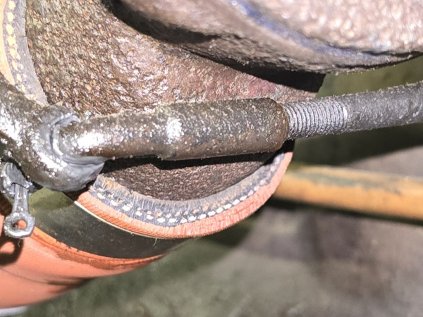

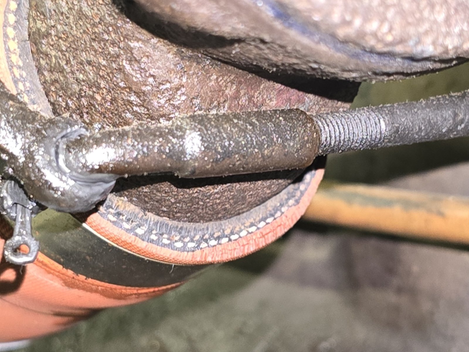

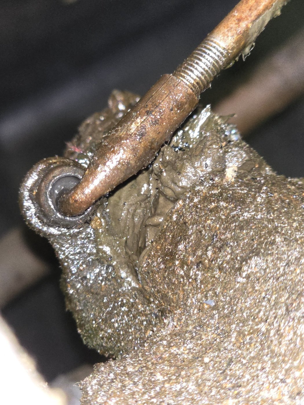

Pictures of the throttle rod and spark rod adjustable ends on my unrestored 1915 Touring, no. 679,2xx. Adjustable ends are at the steering column side. The rods appear to be bare steel and there are no jamb nuts. There are two different adjustable swivels - the timer rod has a ball joint with a nut affixing it to the steering column lever where the carburetor rod does not. It is held by a cotter pin. It is possible that the adjustable ends may have been black painted, but I would need to clean the goop off to be sure. You can really see it on the carburetor end, under there layer of grease. I will try to clean them later today to confirm. There are no adjustable ends at the timer side or the carburetor.

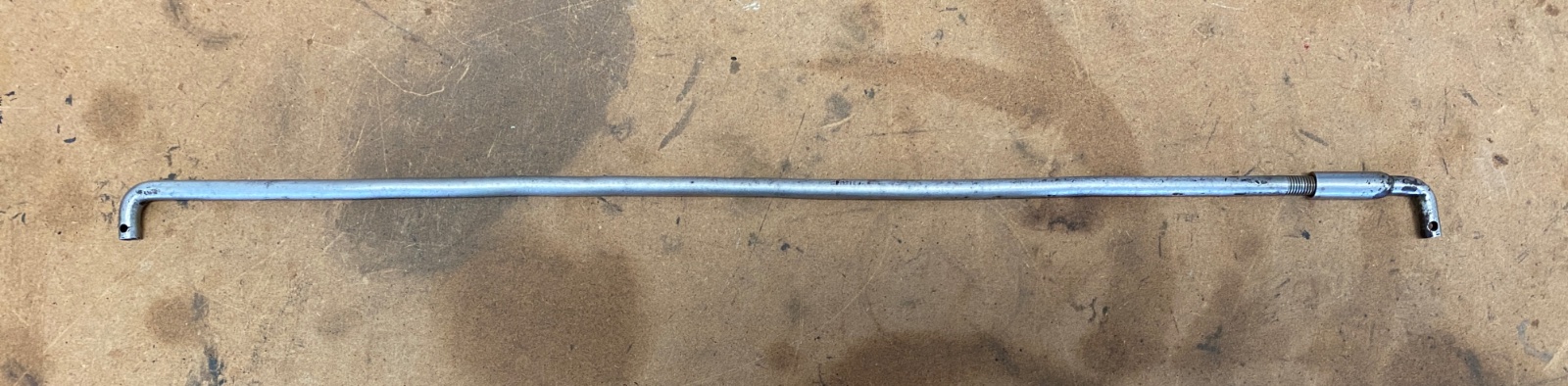

On a similar subject. The carburetor mixture adjusting rod. The diameter of this is 3/16". For the early cars it has a forged end welded to it, about 2" up. Some have a factory number on the forged end, and some don't. The diameter of the forged end is about .009" larger than the upper portion of the rod. Some factory photos of this rod show it to be a natural finish, and others show a black finish.
