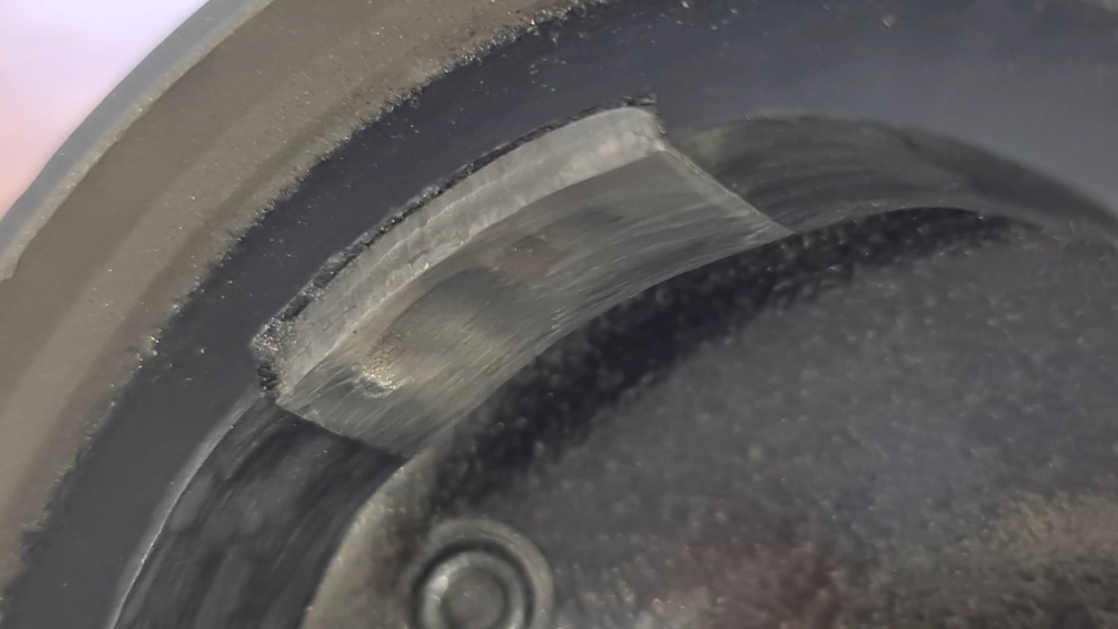

My Model T was running worse than the Mexican economy; and I was at a loss as to why that was. Until I took the timer cover off...
So, using a sanding head on my cheap Bunnings engraver tool, I managed to (by eye) re-surface the contact (and insulator) surfaces inside my roller timer. Now I know this should really be done on a lathe to get a perfectly rounded surface, but as I don't have access to one, this was the next best thing, which I'm pleased to say worked very well!
Enjoy the video... https://www.youtube.com/watch?v=p-PDswiyUTQ

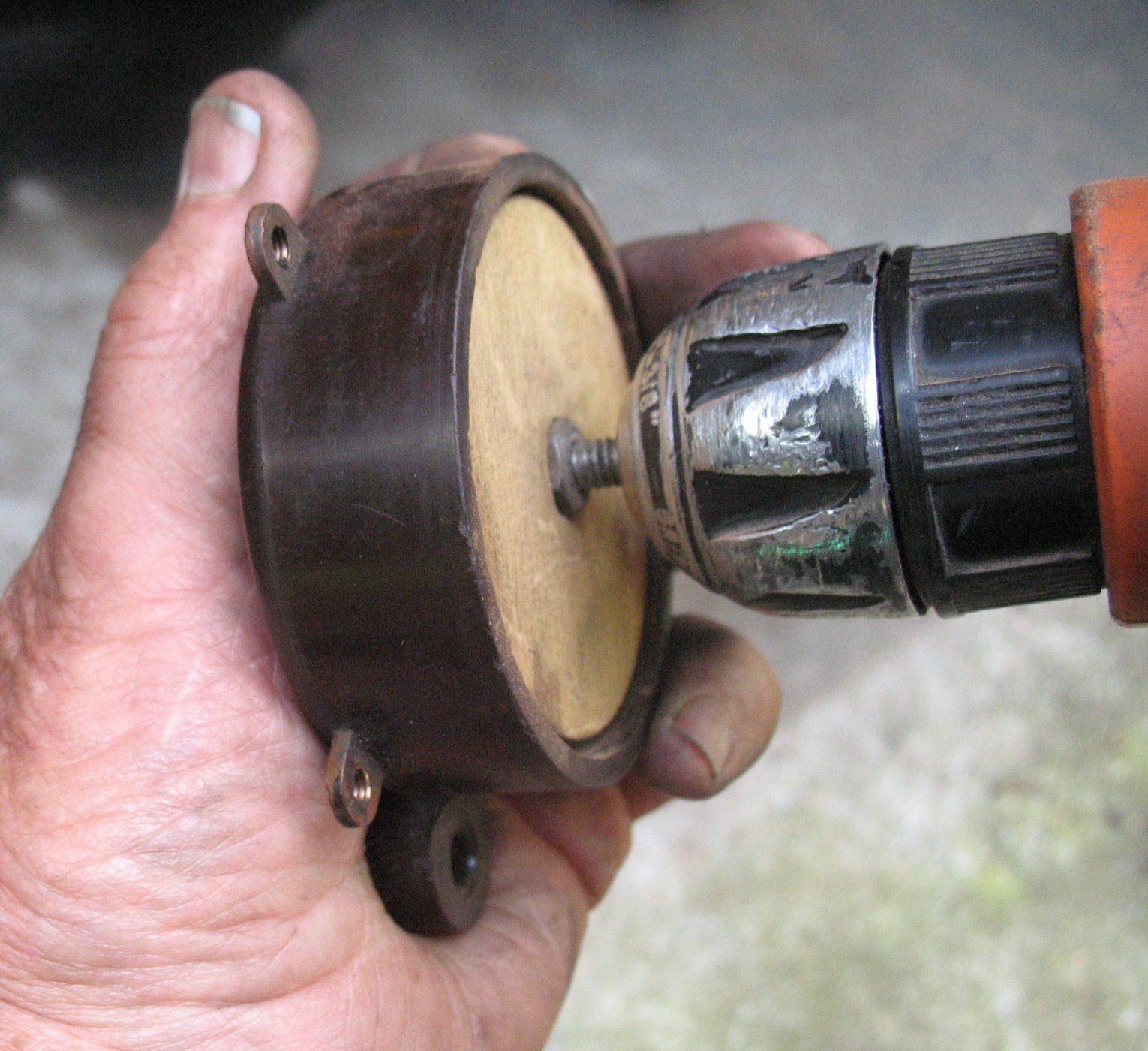

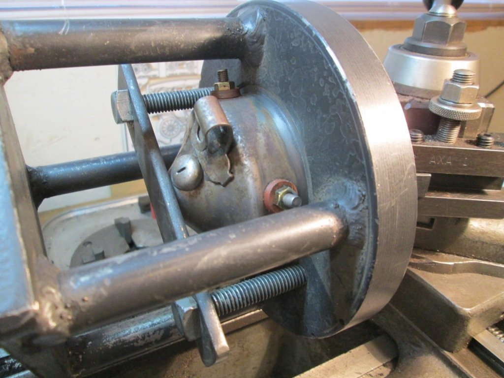

Wear is universal with mechanical devices, but the flat surface in a New Day is easier to fix than the curved track in a roller timer. Using a lathe, I expect they are equally easy.
Without a lathe:
Without a lathe:

I use your method on the New Day timers also, Steve !

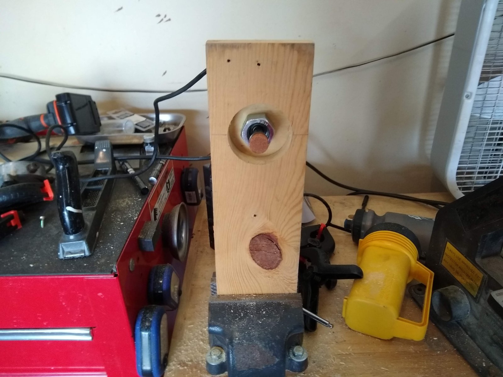

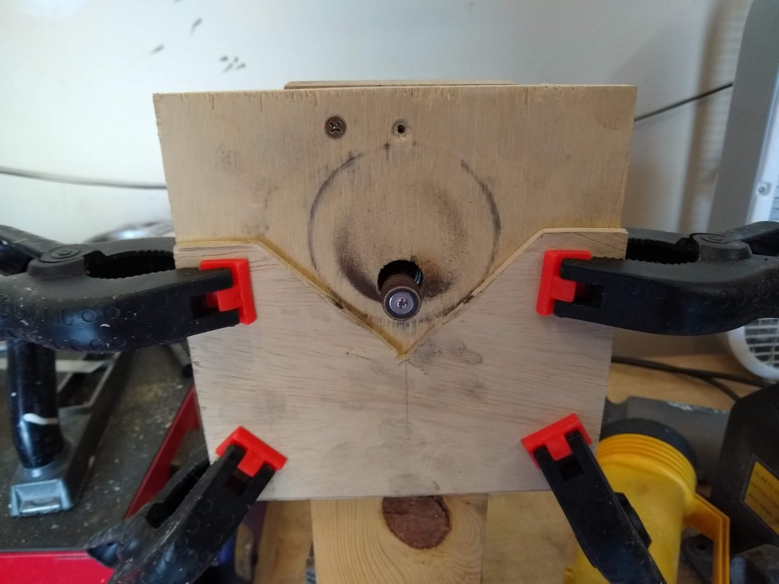

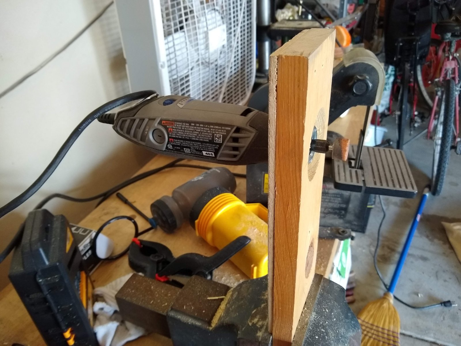

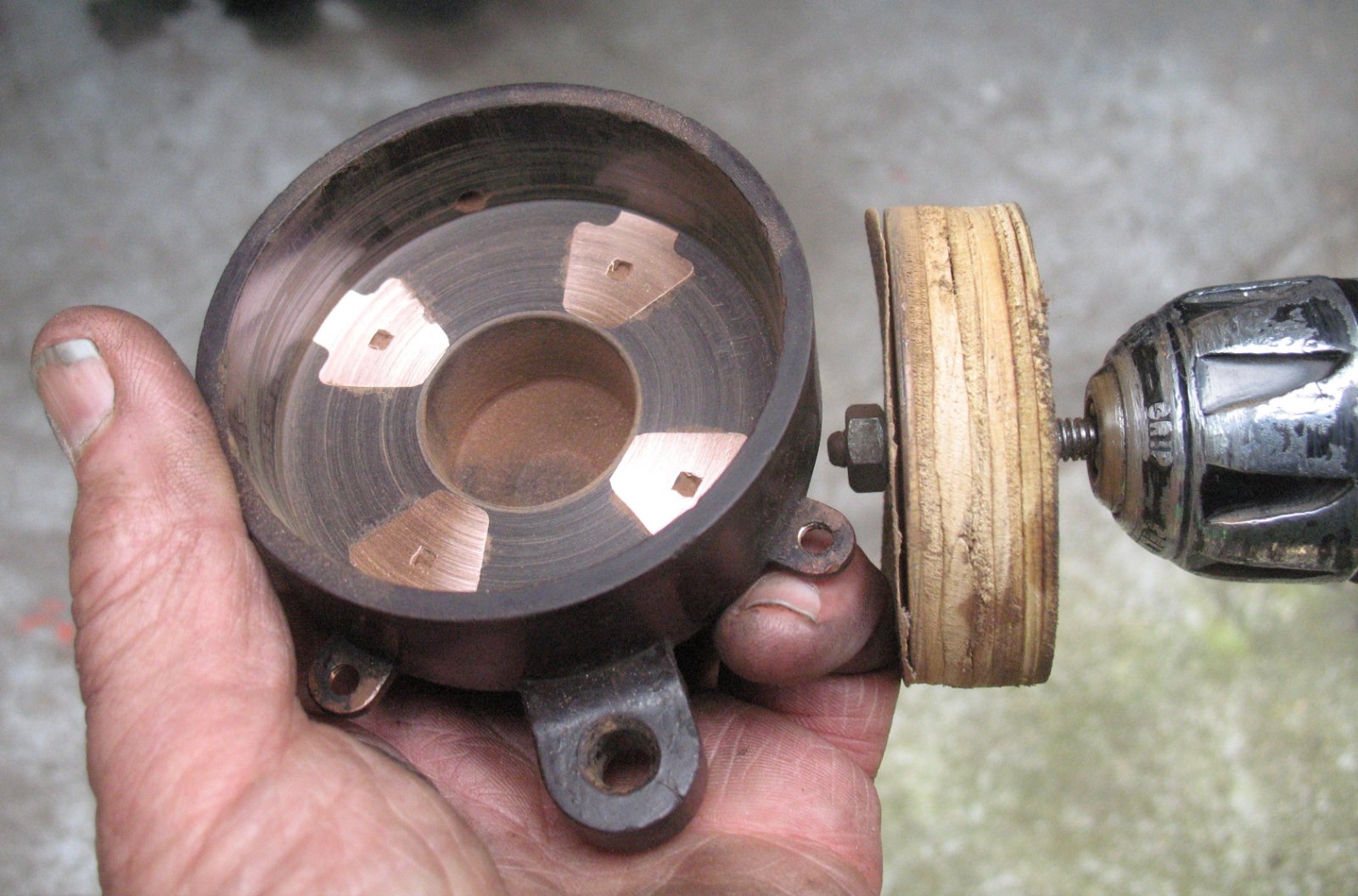

A couple of years ago I resurfaced an original timer using a Dremel and this primitive jig shown in the pictures below. Once set up, you just rotate the timer around and pretty soon you get a surfaces that is smooth and round. Better than you could do by hand but probably not quite as round as the lathe method. However, when you don't have a lathe, you need to be creative.
Neal
https://modeltfordfix.com/repairing-a-m ... ler-timer/
Neal

I've got to say, I'm impressed with the ingenuity in this thread! Henry Ford would be proud! Some of these solutions are so simple its insane!
I'm liking Neal's plywood jig held together with clamps! I may just have to try something like that myself next time.

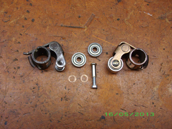

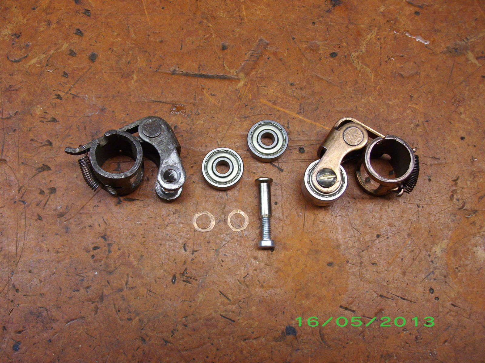

To clean the timer I use the following :
And for the roller I use two ball bearings ,till now it works for me
Toon
Toon

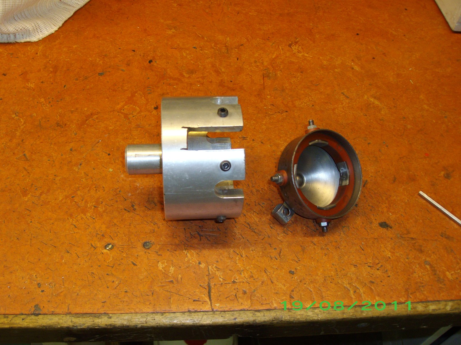

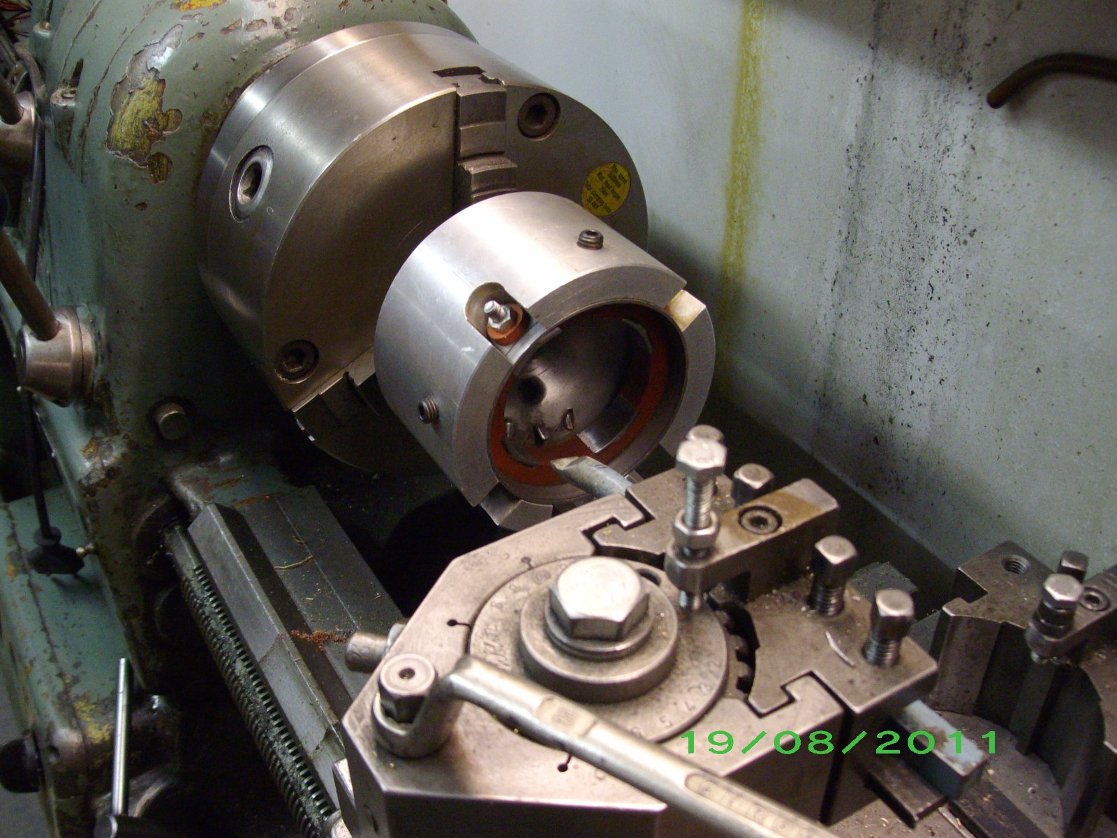

Re: Bad Timing!
This is the best solution I've seen, did you make this jig yourself for your lathe? If so, you could probably make a bit of cash making them, they'd be a hit I reckon!
If I had access to a lathe, I'd definitely buy one from you.

But Mitch, if you had access to lathe, you could make your own.
ModelTMitch wrote: ↑Tue Nov 05, 2024 6:17 amThis is the best solution I've seen, did you make this jig yourself for your lathe? If so, you could probably make a bit of cash making them, they'd be a hit I reckon!

Toon, how are the bearings holding up with the balls and races being part of the electrical circuit? I tried using those and they didn’t last very long…
Last edited by Kenny Edmondson on Wed Nov 06, 2024 4:31 pm, edited 1 time in total.
