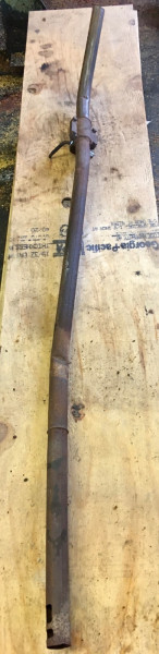

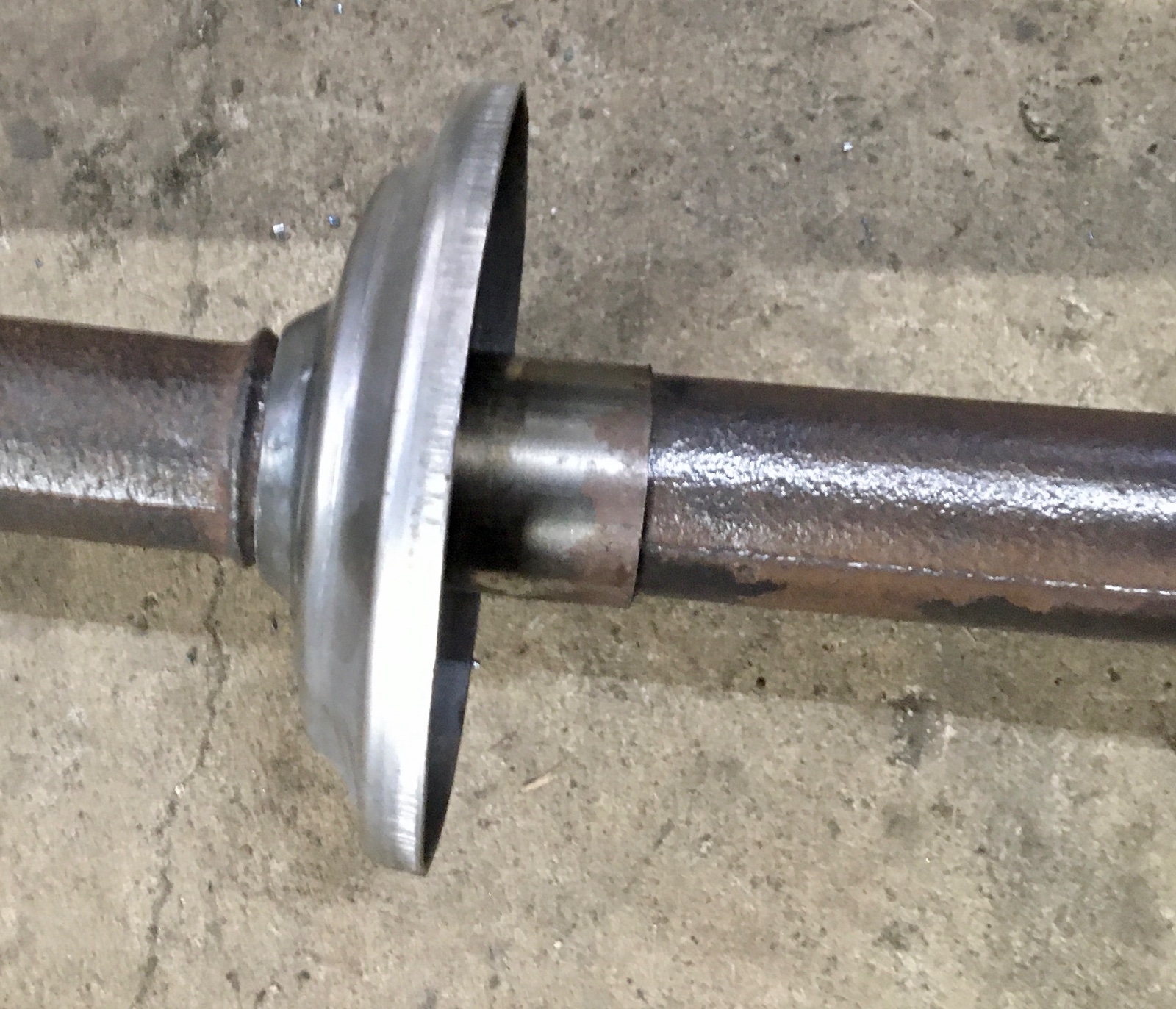

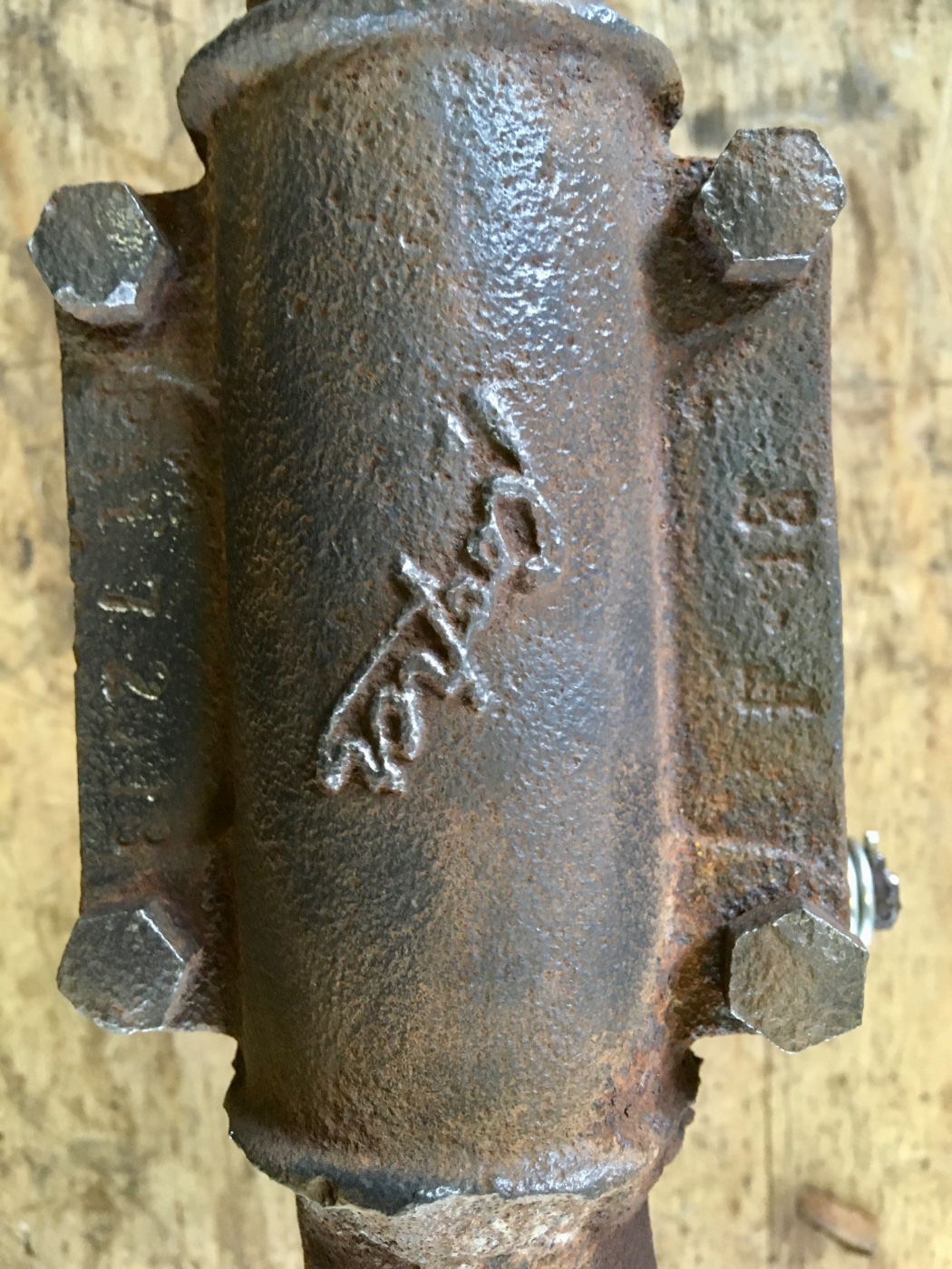

Trying to fix up the exhaust pipe that came with the T. It’s still solid enough to work with.
Looks old. Is it a possibility it’s an original or maybe an aged aftermarket?
Has an interesting seam going down the middle of it.
I managed to get the cutout to function with a new return spring. I can’t quite decipher the brand name. Obviously an add on.
Bryant

Re: Original exhaust pipe?
I believe the script reads "Cooper".
Moxie26
- Posts: 2033
- First Name: Robert
- Last Name: Jablonski
- Location: New Jersey
Yuppers.... That's original

Cooper!
wow I see it. it was making me cross eyed. i wonder if there is a matching foot pedal for it.
The bottom end of the exhaust pipe in the top picture, gives away the fact that the owner has a late year, possibly 26-27 T and uses the muffler with stamped steel ends, and rear end of the exhaust pipe, actually is the center tube of the muffler assembly. Without cutting the rear 12 inches or so, off the pipe, a current available muffler can't be used. as they clamp on the pipe. If i'm correct, the owner mush use his original pressed steel ends and just replace the middle and outer shell. The outside shell measures 12" long and 5 " in outside diameter. I've forgotten the dimensions of the middle tube.Bryant wrote: ↑Wed Apr 30, 2025 10:02 amCooper!

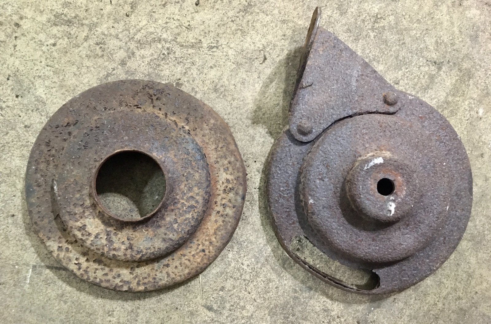

The original pressed ends where still on it but I removed them to Inspect. They are to bad to re use. The new repo muffler I purchased comes apart and fits nicely on the pipe.
Bryant
Bryant
ModelTWoods
- Posts: 1552
- First Name: Terry
- Last Name: Woods
As the new repro mufflers clamp on the existing exhaust pipe, I didn't think the repro front pressed end would work, so I don't know how you're doing it. The middle and outter shell, as well as the rear pressed steel end should work with no problem, though. P. S. Your pipe, although usable NOW, may go to heaven before you do, so it'd take it to muffler shop and have them make you a duplicate while you have a good one to copy..

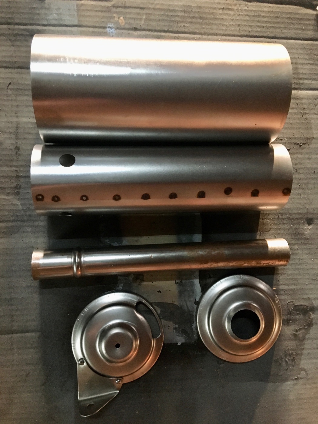

Dan the repo muffler disassembles with ease. I will not be using the inner pipe. The engine side muffler end needs resized to fit tight on the rolled ridge on the pipe. I will not just be clamping it on the end of the original pipe so it hangs out the back looking stupid
But as I said before I now know I most likely have an original pipe. The original question of this topic.
Bryant

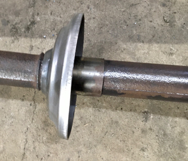

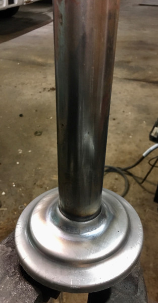

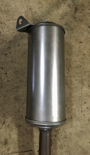

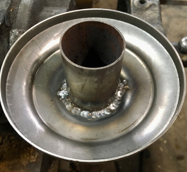

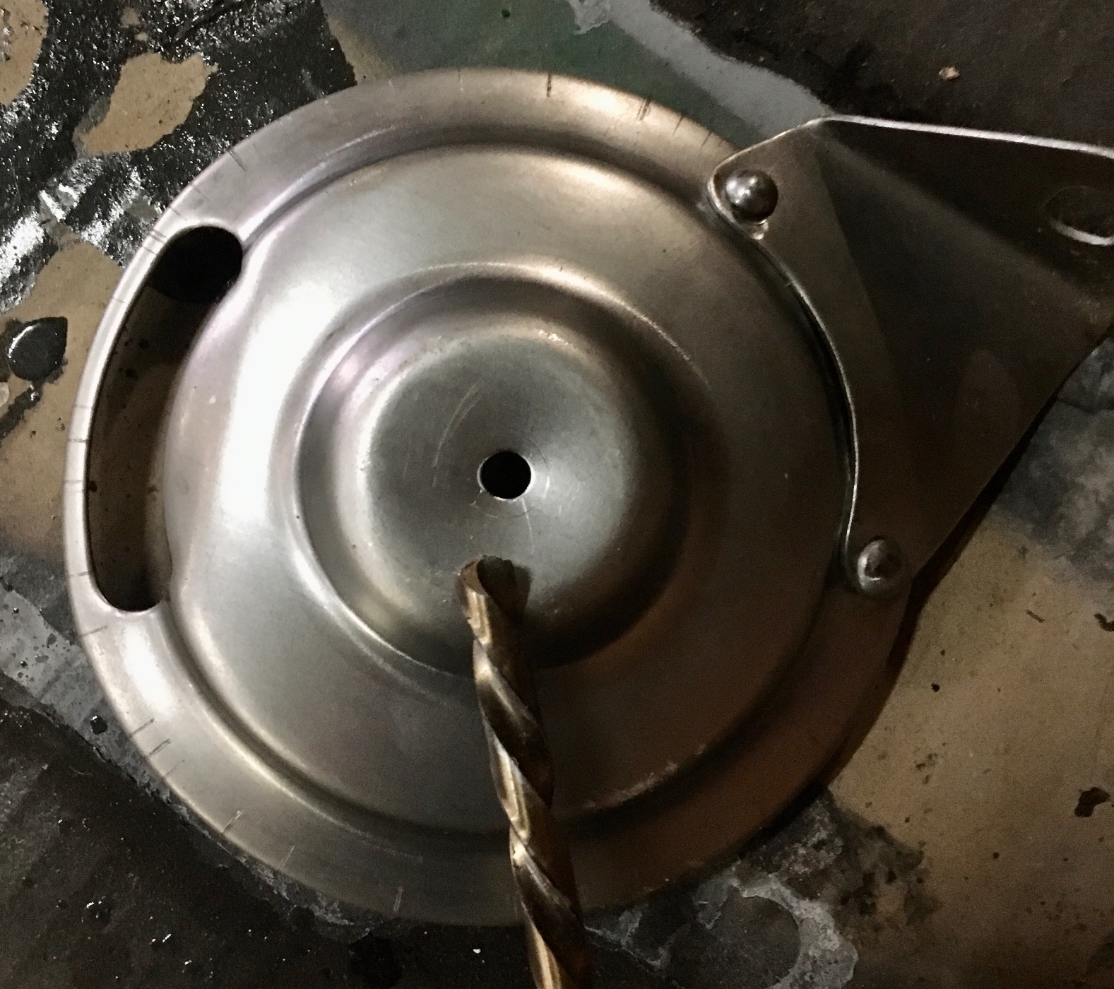

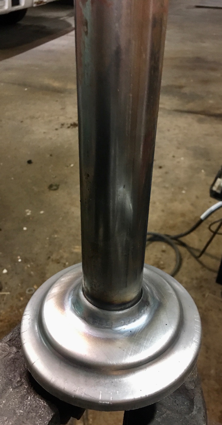

Because inquiring minds want to know. Here we go.repo muffler broken down.engine side muffler end needs the ID shrunken to accommodate the original pipe bead because it is designed to be a slip over. Just flip the inner pipe around backwards. weld it. cut the excess off. nice and flush and smooth.
Bryant
Topic author - Posts: 1213
- First Name: Bryant
- Last Name: Shafer

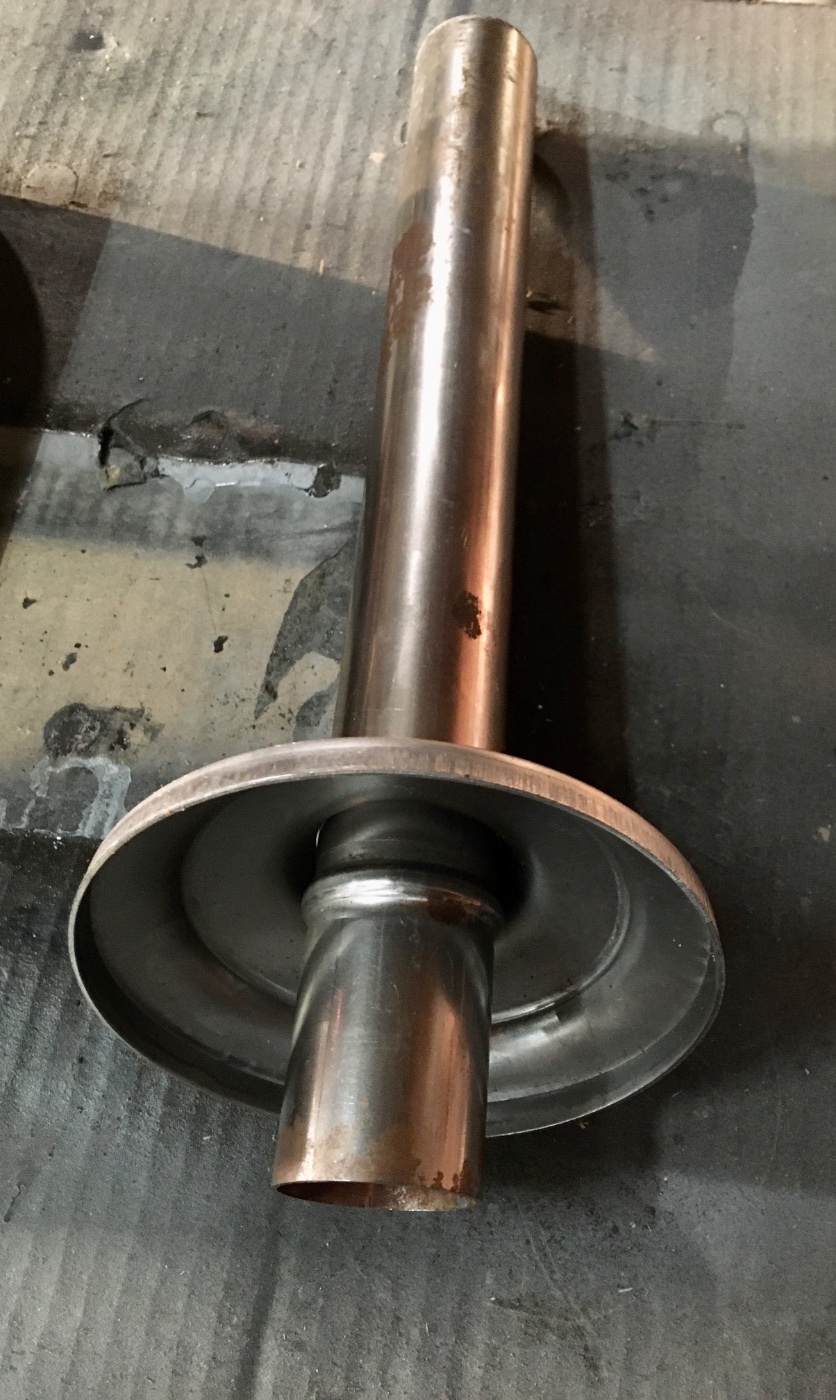

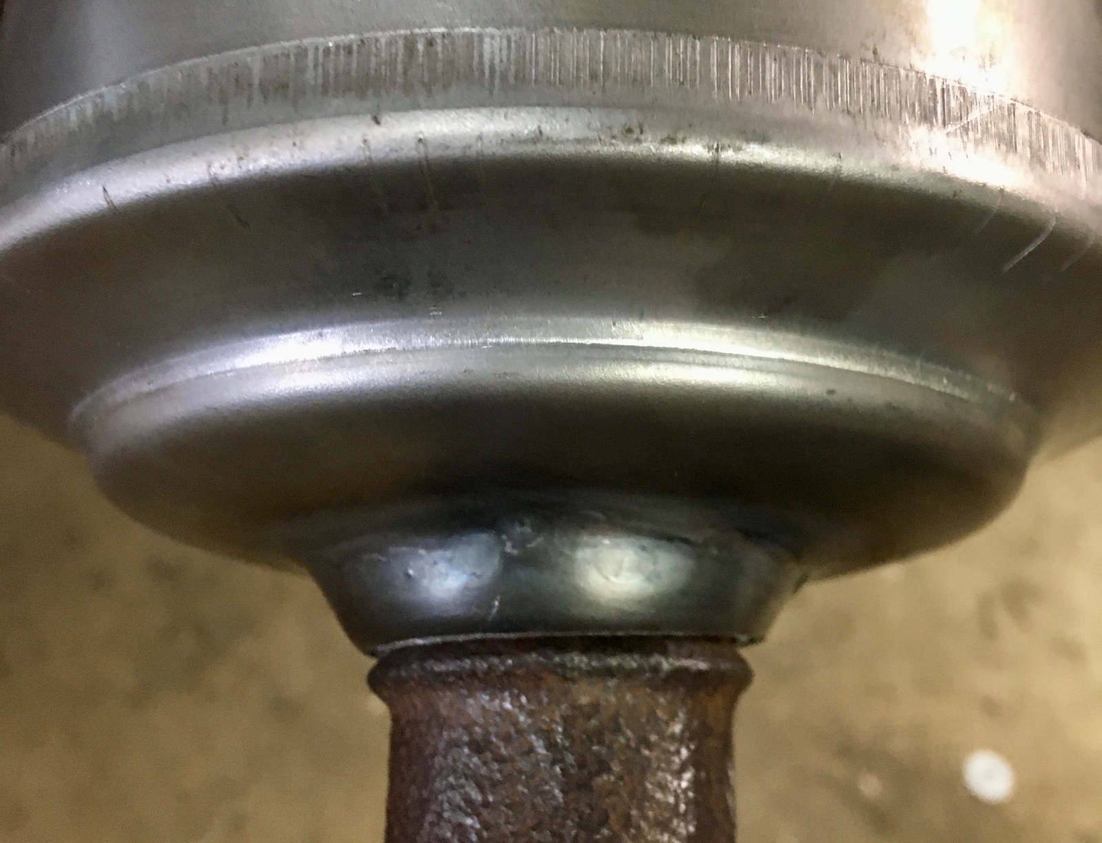

slide it over original pipe end and it will stop at the bead. drill 1/4 20 hole out to 5/16 to accommodate the original size carriage bolt. assemble muffler. wa-la
Bryant
Bryant

It may not be the way FORD did it, originally, but you seemed to have made it work.
- Posts: 2060
- First Name: Jeff
- Last Name: Humble
- Location: Charlevoix, Mi
- Board Member Since: 2006
Great job!
- Posts: 7131
Neat work Bryant. Your short length of pipe in the front cover allows it to mount exactly like Ford did it. You should use a heavy, slightly dished washer on the back end when assembling the muffler. This will spread the load over the whole inner "bump" on the end.
To my eye the materials used in the making of the end covers and the mounting bracket at the rear are lighter weight than the originals. Am I correct in this? Some original ends I have discovered seem to be pressed using TWO thicknesses of lighter material. Is this another example of Henry using scrap from other areas of manufacture?
The scoring marks around the outer flange on the ends indicates that they are pressings. i have mine made by a metal spinner using heavier material. The brackets are heavier too. On Canadian mufflers there is a deflector to direct gasses to the ground in front of the rear axle. This deflector is of lighter construction.

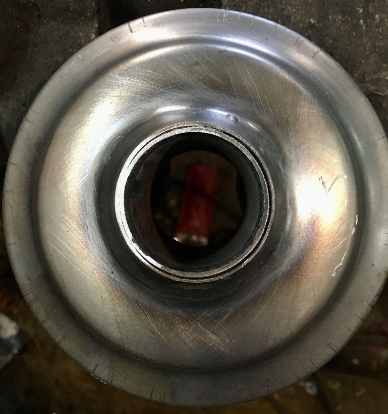

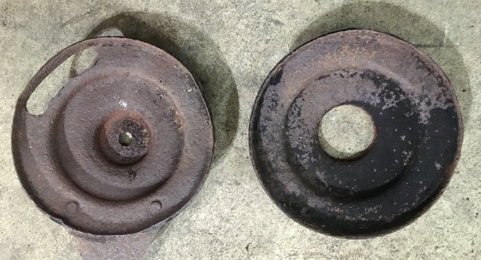

Allan, I have read on the forum, previously, about some of the pressed muffler ends, being of two layers of metal, laminated together. I think Ford did cut corners every chance he got.Allan wrote: ↑Mon May 05, 2025 9:42 pmNeat work Bryant. Your short length of pipe in the front cover allows it to mount exactly like Ford did it. You should use a heavy, slightly dished washer on the back end when assembling the muffler. This will spread the load over the whole inner "bump" on the end.
Bryant
- Last Name: Shafer
here are the originals that where on it. they are indeed two-piece pressings. the mounting bracket measures approximately 12 gauge and the repo bracket measures 16 gauge. so, originals are definitely thicker.
Henry Ford using scraps he had? makes me feel better about this whole project. maybe Ford did do things this way.
