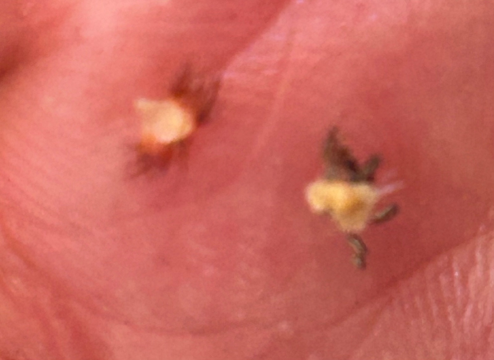

My Lizzie pulled up with a belly-ache the other day, woes with the Holley G I’m running. It’s a brass-body G I rebuilt about 7 years ago, using the available composite foam float available from Lang’s. As usual, it’s never just one thing wrong, found a little crud in the inlet port, and the float valve prospered by “lapping” with toothpaste. When I could not get the float level set properly, I finally accepted the fact that the float had become “waterlogged” in gasoline. Replaced the float with a new one of the same material, problem solved.

Tiny bits of unidentified “crud” from the inlet passage

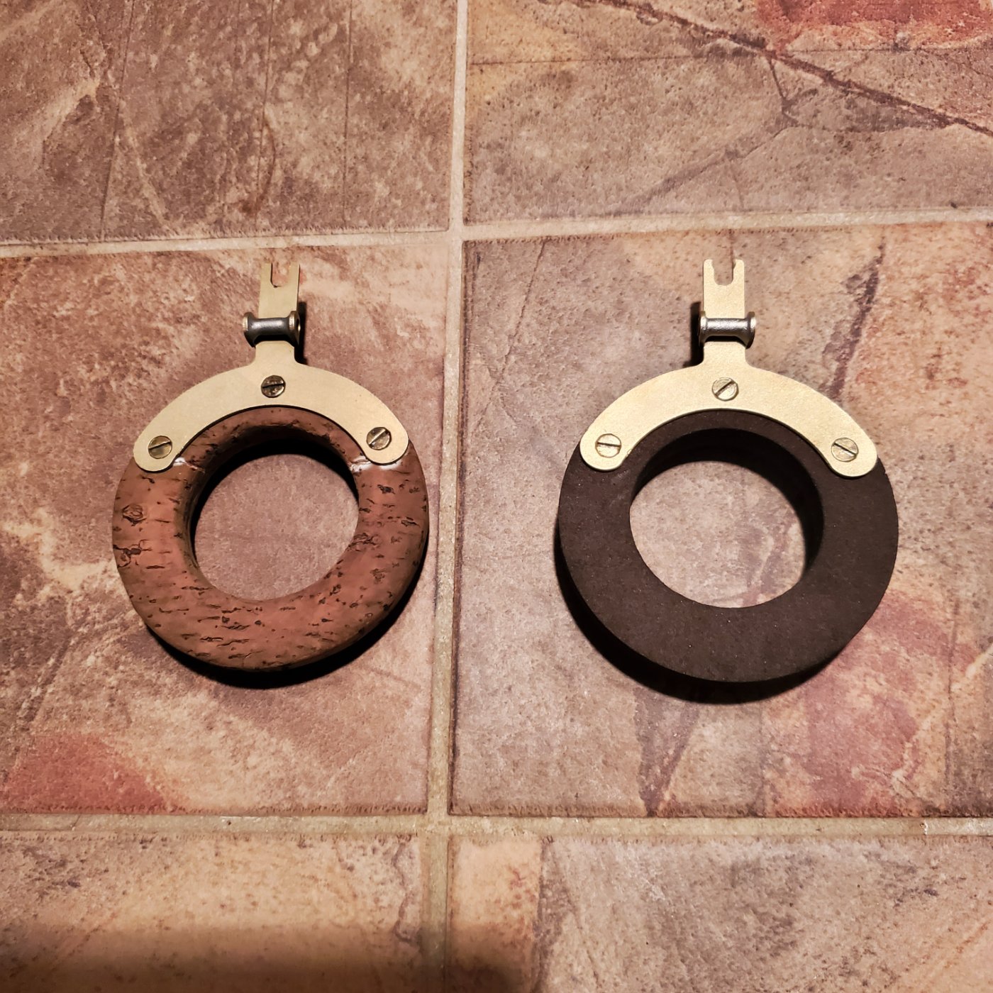

The float material I purcased from Langs was closed cell. I rebuild a few floats using this stuff some years ago and havent had an issue.
I dont know if this makes a difference but I puchased blocks of the material and made my own using originals as a guide. I never sealed them.

Both from the same source, perhaps we can assume it’s the same stuff ? It appears to be the same vis-a-vis the photo. Lang’s catalogue only specifies “modern material”. Just curious whether anyone else has found that it will absorb fuel “in time” ?
BTW, Nice work on that float, Richard !

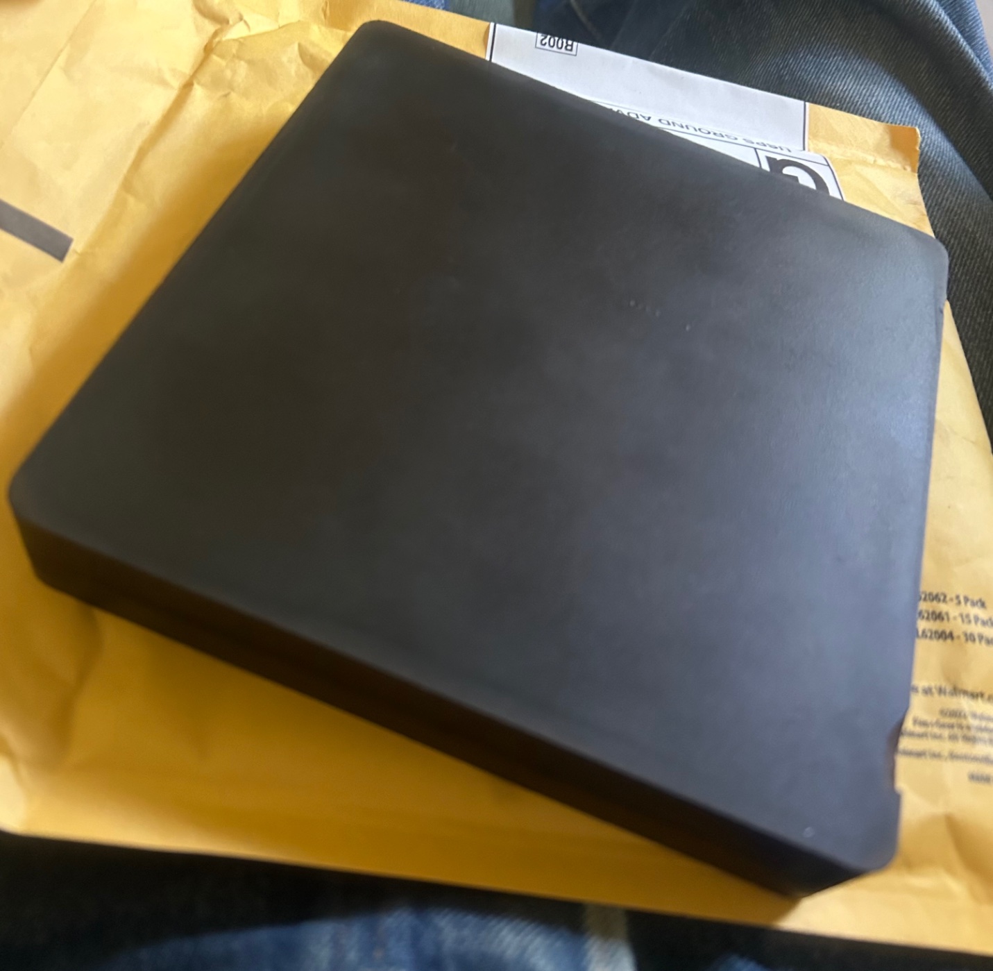

Update for anyone interested in this thread. The block of nitrophyl from Kelch Restorations came in today’s post.
FWIW, its appearance is VERY different from the float blank I had obtained from Lang’s. Smooth, black, with a sheen even when cut, it does not resemble the grey, granular texture of the previous material.
