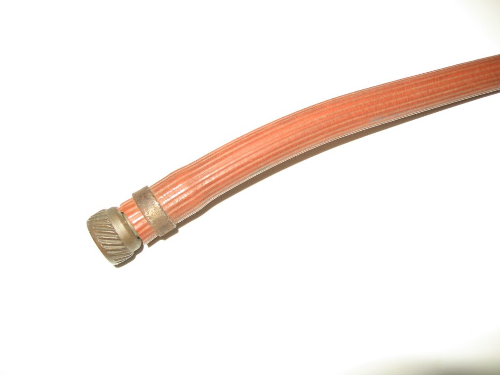

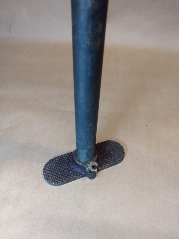

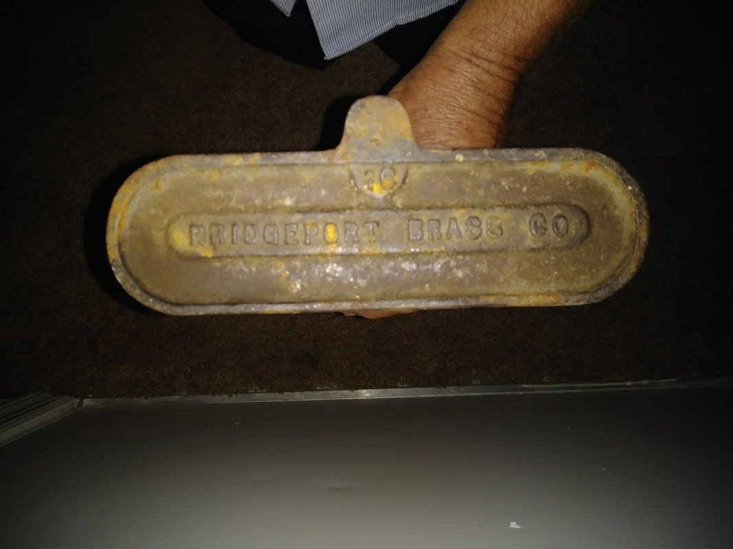

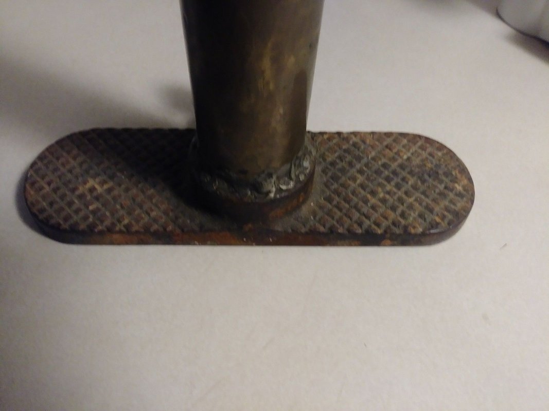

I recently purchased a single barrel Bridgeport tire pump. I thought it was the correct one for the 1915 era Model T. Now I'm not sure. I've noticed it does NOT have the Ford script on the bottom. Does anyone know what year(s) the single-barrel Bridgeport pump was supplied with new Model T Fords? Does it have to have the Ford script on the bottom, or were some supplied without the script? Following are photos of my pump:

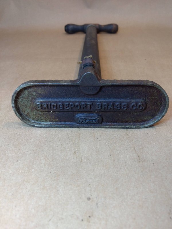

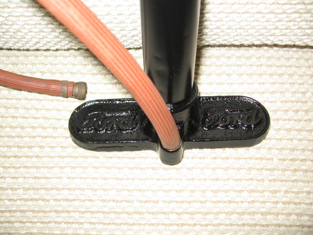

Following are photos of the Bridgeport tire pump with the FORD script on the bottom:

Then I would like to know: Is the Bridgeport tire pump with the Ford script for a Model T? This is not the only one I've ever seen.

The single barrel Ford script tire pumps don't appear to be as common as the double barrel non Ford script pump. I've never seen a double barrel Ford script pump. Has anyone else? I would like to find out more on the double barrel pumps. There is a check valve between the two stages. Is it spring loaded? Never been able to get one to work.

I have a pump identical to the one shown. It has a nickel plated barrel. I always thought that they were for the Model A's.
The Model T pump with the brass barrel and the two large FORD script on the base where your feet hold down the pump are the more common pumps that I see.

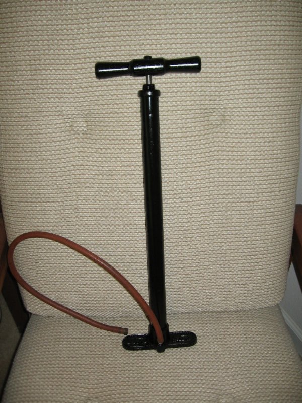

I think Jim is right, the waffle pattern base ones are Model A. Here are some pictures of a single tube pump that I bought for my 1924 Model T. A lot of folks polish up the brass body, but I'm betting that they were painted black originally.
