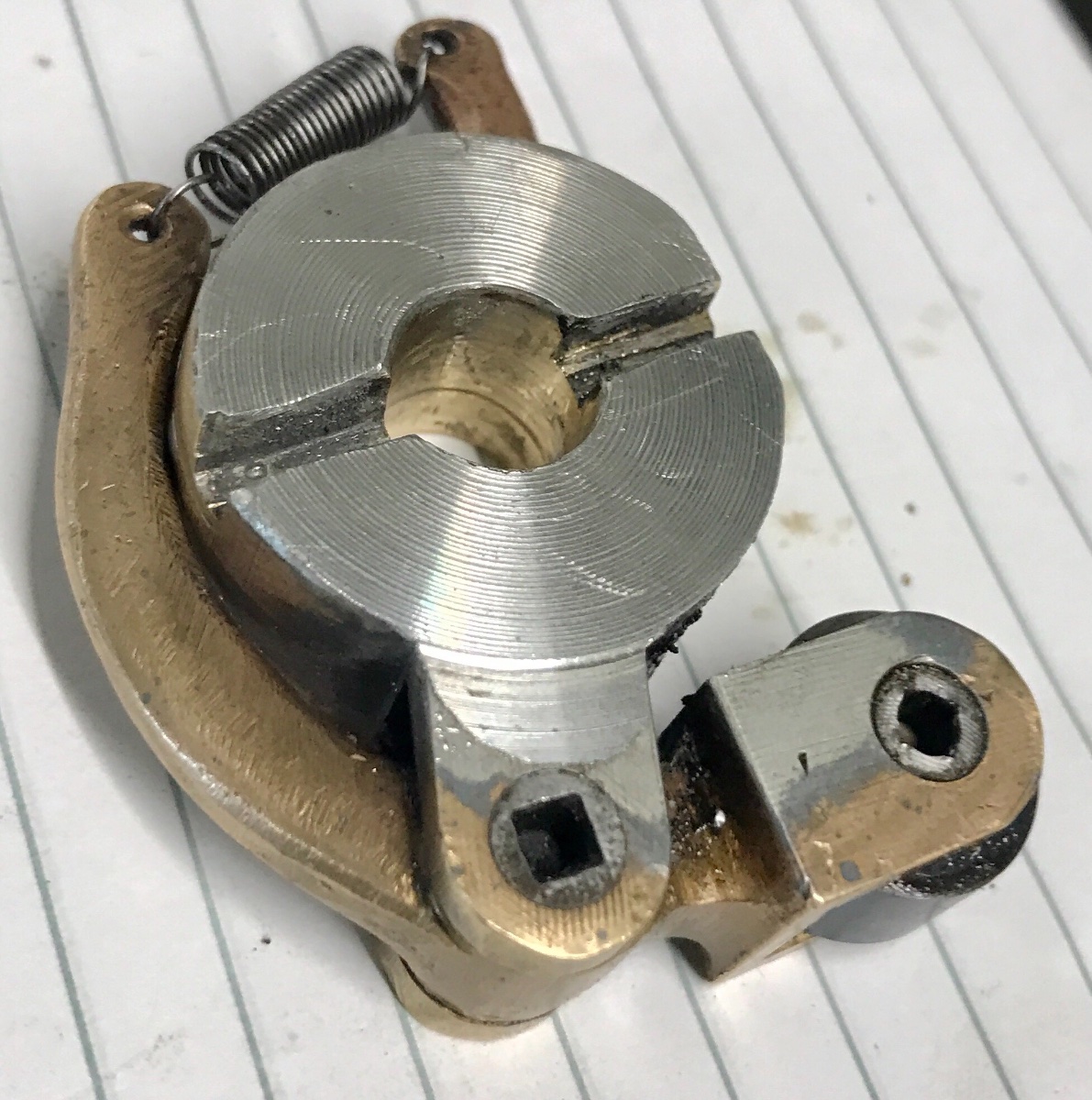

The roller was worn down unevenly, and the brass holder grooved on the bottom:

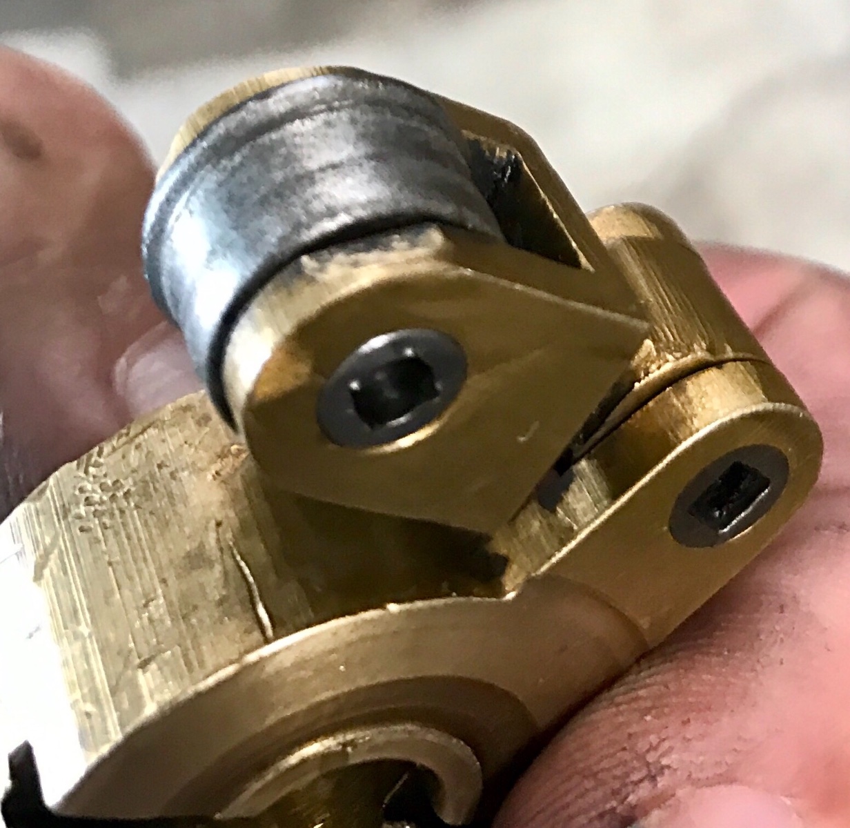

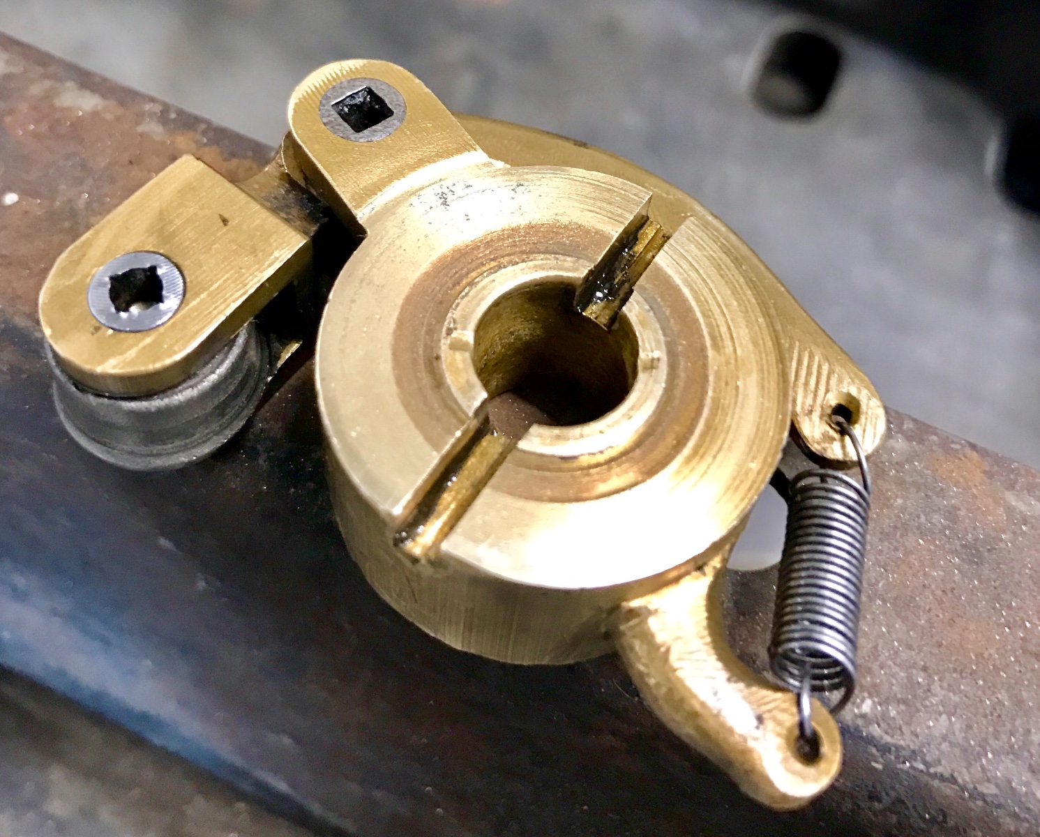

Dean turned down a new roller, and tinned then babbitted the uneven surface. Now it’s as good as new, or better.
This is the third Model K Dean has brought back to life, and fifth K motor he has worked with.
