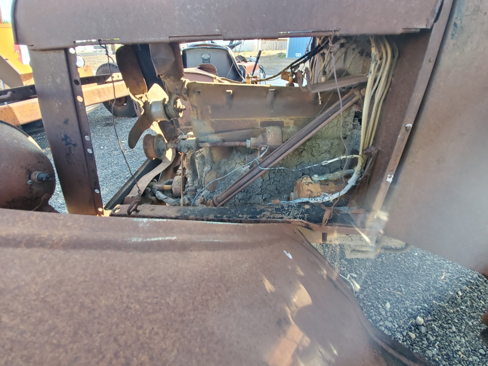

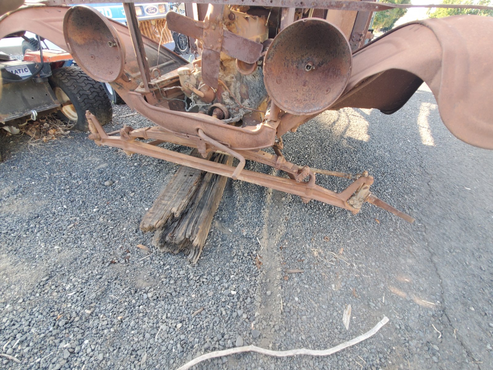

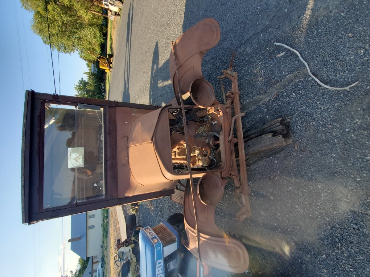

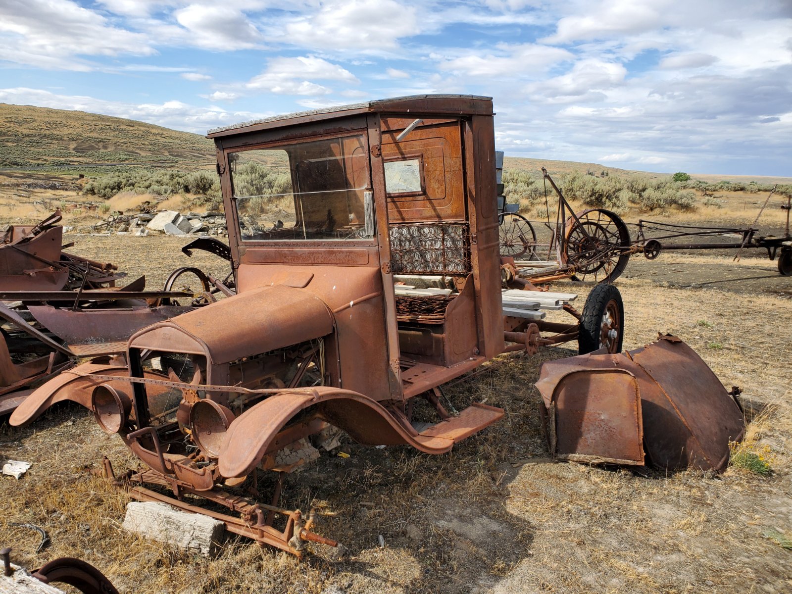

Good morning!

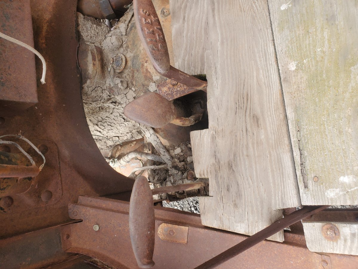

I recently acquired a Model TT and am trying to identify the year it was made. From the little information I've found on these trucks, it seems to be a 1925 or 1926? Where can I go to find more detailed change breakdowns for each year?
To be honest, I purchased this truck in a large lot of Model T parts and will be selling everything I don't need. Thank you for your time.

Re: Model TT id?
It’s somewhere between a late ‘25 (wide tranny pedals) and mid production year ‘27 ( (rectangular dash switch) .Engine serial number ??

Re: Model TT id?
I would say 25 if fenders are original. No lip for apron.

Re: Model TT id?
I see them now. Never mind.

Re: Model TT id?

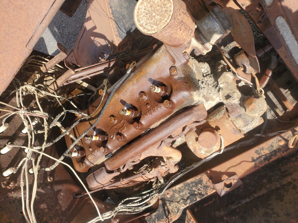

Looks like 26-27 engine, but front axle looks 25 or earlier.

Re: Model TT id?
You said you plan to keep what you need and sell the rest. For whatever it's worth it looks like your truck has a complete set of Bennett auxiliary brakes. That set of brakes (the pedal, equalizer, rods, actuators, bands, rear anchors and all the little do-dads that go with them) is something a lot of folks who read this forum would be very interested in. If you decide to sell them I hope you'll give the MTFCA Forum readers a chance to make an offer.

Re: Model TT id?

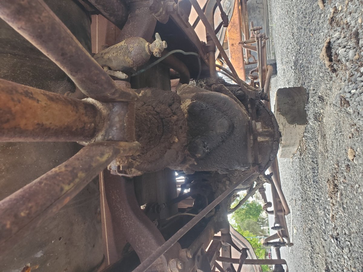

Interesting truck! Probably a '26. Auxiliary transmission, maybe an overdrive? Uncut rear end under a spliced/lengthened frame! Long truck with a couple nice accessories (including those brakes!). Well worth restoring.

Re: Model TT id?
I believe that trucks used 'old style' (1925) guards right through production. They did not use the updated car style fenders. Henry thought why waste the stock on hand for an old truck?

Re: Model TT id?
It is a late ‘26-‘27 cab. The windshield adjustment brackets are straight instead of angled like the earlier models.

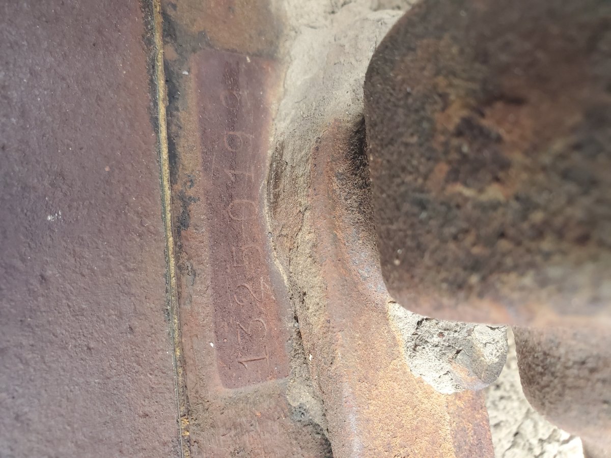

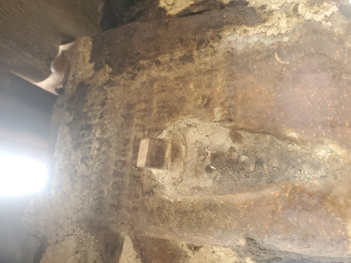

Thank you all for your observations! I'll get a picture of the engine serial number tomorrow. I'm more familiar with Model AA's so there are a few things I didn't realize weren't factory on the TT. I too agree that the truck is in restorable condition, but have a large project list. If I do decide to sell this one, I'll give you all the first opportunity.

Re: Model TT id?
Where are you located ? That sage brush country looks mighty familiar !

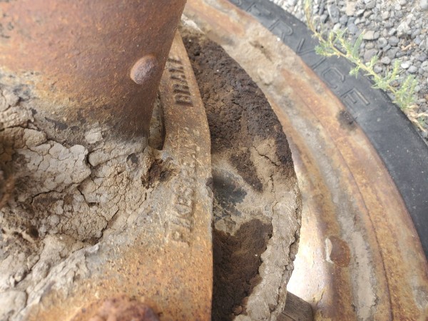

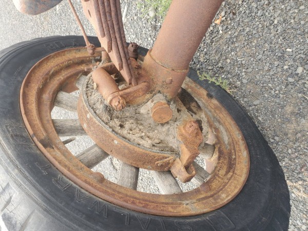

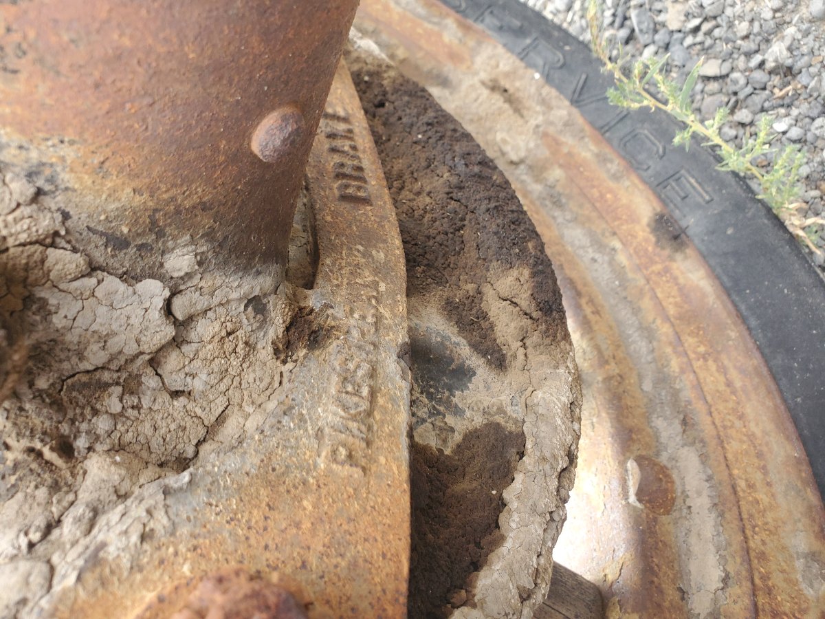

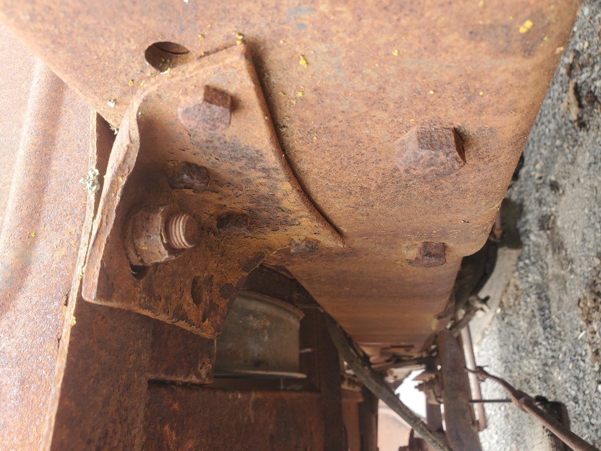

Wayne, thank you for the wheel information. I have several different wheels. I'll have to research which is the type you refer to. I took more pictures of the truck yesterday. Apparently it has Pikes Peak brakes and a Warford auxiliary transmission. Thank you to those of you who pointed out the existence of such.
Burger in Spokane, I'm located not too far from you. I prefer not to share my actual location on a public forum.
Here's some more pictures.

Re: Model TT id?
Thanks for posting the additional pictures! I don't think I've encountered Pikes Peak brakes before. Very cool. They are similar to Bennetts in that the band is anchored at the rear center.
This truck would make a great project. Lots to work with.

That makes sense. Reading the serial number chart, it looks like this truck was built in February of 1926. That is, if the engine wasn't swapped at some point in the truck's history.

Re: Model TT id?
If your frame is a 25-27 frame, it will have the serial number stamped on the top
of the passenger-side frame rail, just forward of the seat base. You can check that
to see if the engine and frame are an original "set".

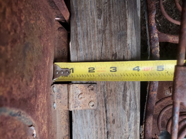

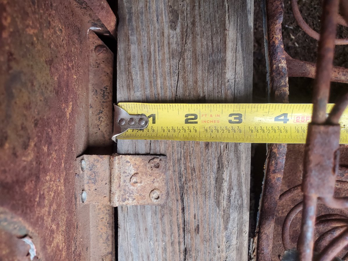

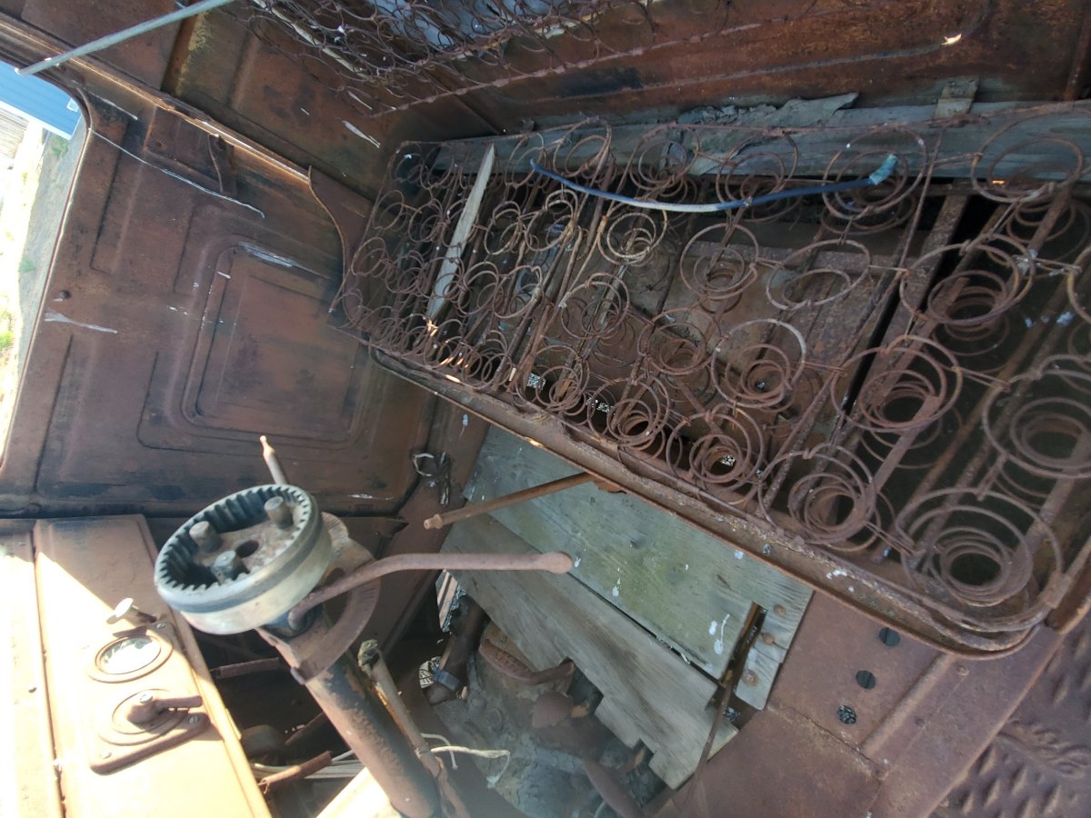

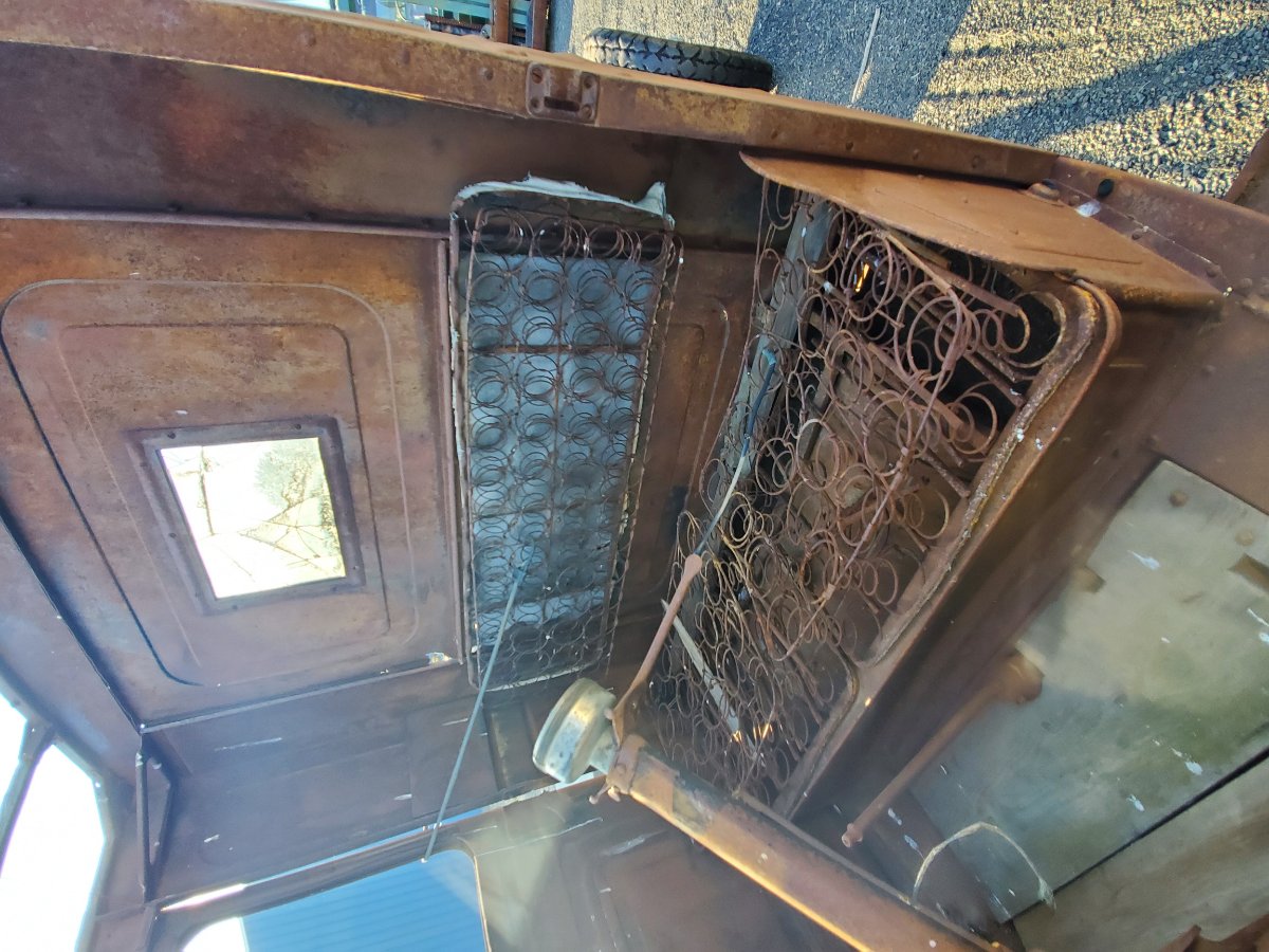

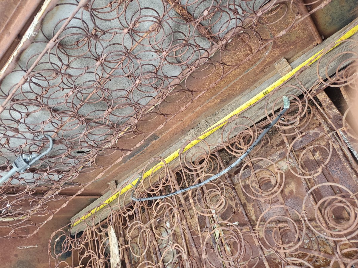

Posting measurements/pictures of the wood behind the seat of the TT for a member who emailed me.

Thank you for the pictures.

That board looks just like the one in my 26 TT. I posted measurements off of mine up here a month or so ago along with a diagram of it as well. The front edge is beveled. - Matt

Thanks Matt, my 26 TT is missing that board.

-Side note: I found the matching serial number from the block on the frame. Excited!

Re: Model TT id?
Good work on the serial number !
As Wayne mentioned, many of the box cabs were run with the doors removed, either
seasonally or permanently. Were it mine, I'd put the old dog back together and add
doors when you find them later. I am putting together a C-cab for a "someday" project,
because these big doors are kind of a PITA !

Re: Model TT id?
The frame on your TT appears to have been extended with a period correct extension to allow the Warford to be installed without shortening the drive shaft and radius rods, most likely part of the Warford setup (or "outfit" as I think was the term back then).
I think that is a plus as I don't think those extensions are all that common. I looked for many years before I found one for my TT, the one that Dallas has now, so that the 8in1 Bed would fit. Never found another one after that. Dave
1925 mostly original coupe.

Re: Model TT id?
I'm going to look at a couple doors tomorrow. They look pretty rough on the bottom.
d stroud, I found the Warford frame extension directions and operating manual online yesterday. I need to measure the extension to see if it matches.
-I'll post the link here if it's allowed? I'm sure others would find it useful.
Burger in Spokane, finding the matching serial number on the frame was exciting! This truck is a keeper. I need to whittle my project list down so I can start working on it.

Re: Model TT id?
I was pleased to find my numbers matched, as well. Many surviving Model T's
are actually assembled piles of parts as part of a restoration, if they did not get
an engine replacement back in their early life.
Do you know where this truck lived its original life ? Was it a local truck in 1930 ?
There may be photos of it back in the day, if you know where to look ....
