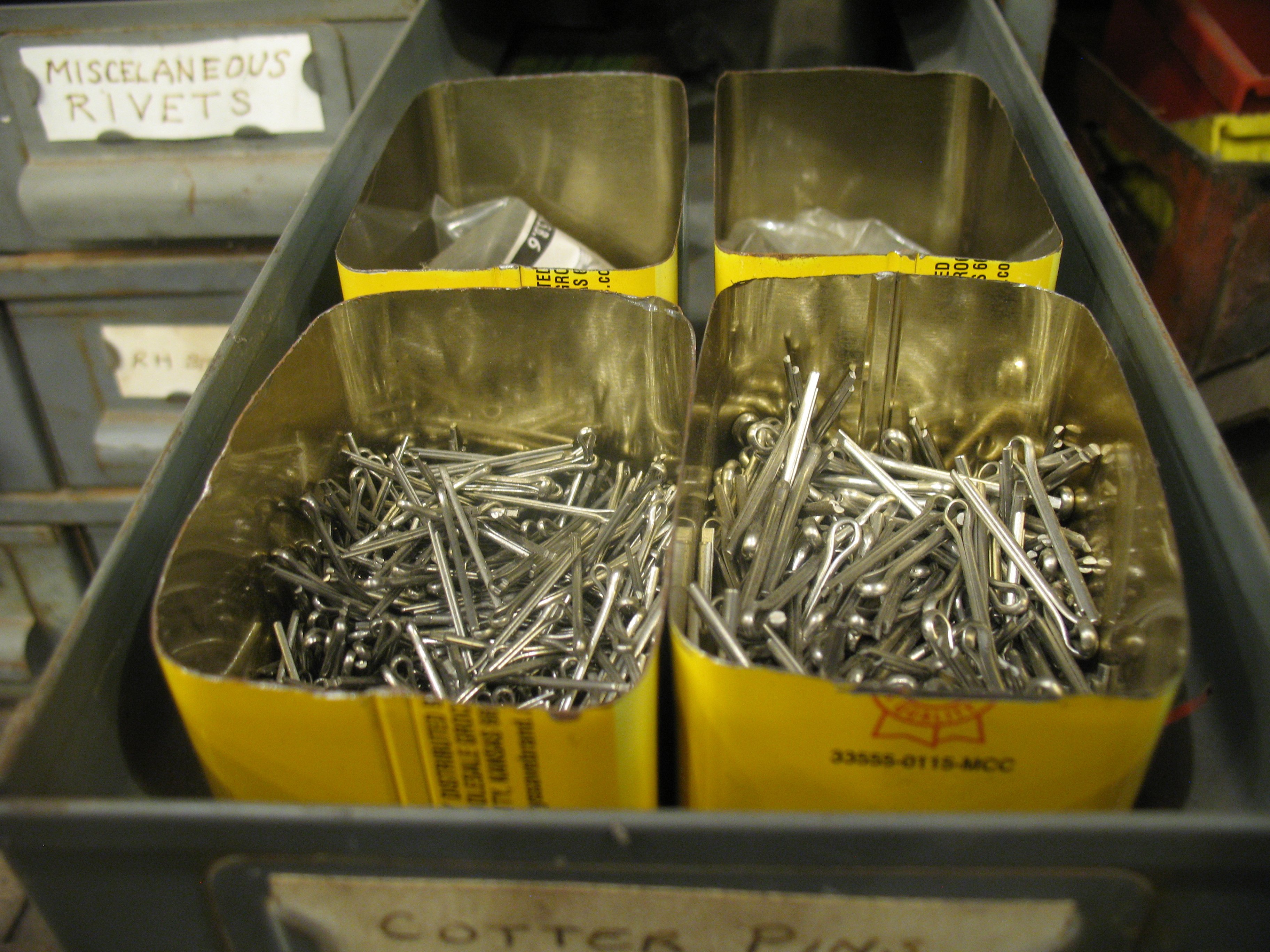

I use stainless. No rust. Some claim they're harder to remove than steel, but they seem about the same to me.
I was the one who bought them, so they can't be terribly expensive.

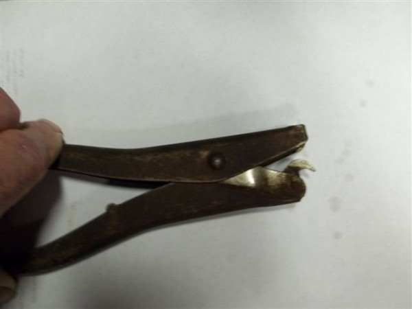

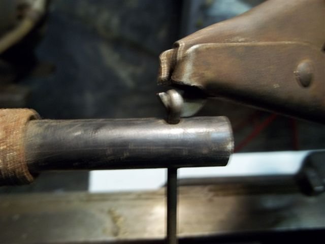

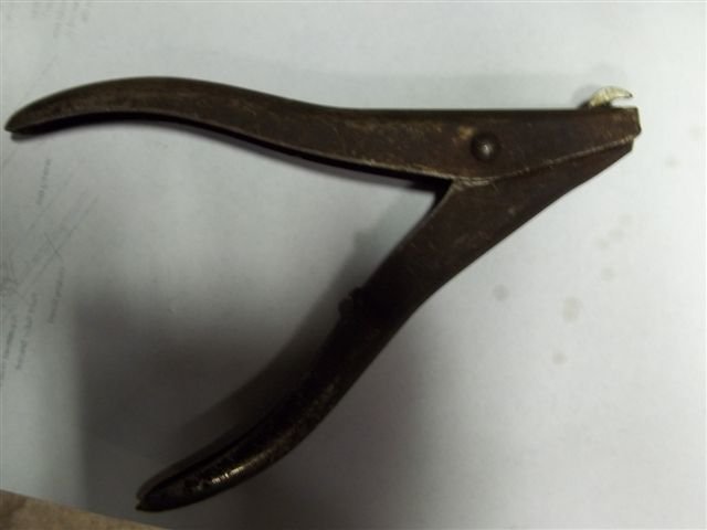

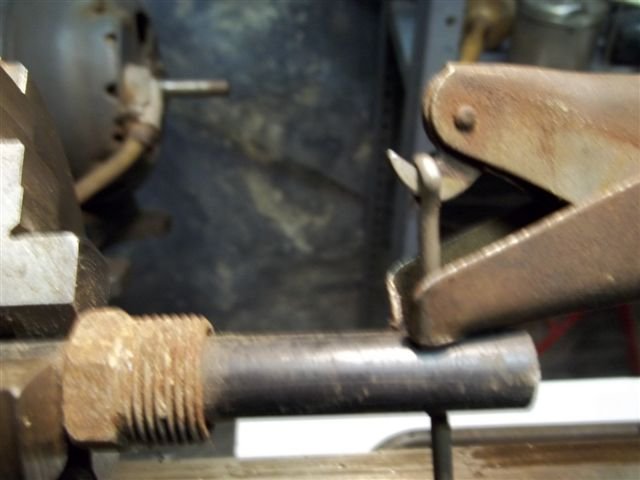

I've posted this in the past but here it is again. Found at a garage sale most likely. Jim

Inthegarage
Posts: 46
Joined: Sun Jan 06, 2019 4:05 pm
Last Name: Mosher
* REQUIRED* Type and Year of Model Ts owned: 1927 Roadster pick up
Location: Connecticut
Re: Cotter pins tips
Post by Inthegarage » Wed Oct 07, 2020 6:45 am
TFan wrote:
Tue Oct 06, 2020 10:52 pm
That’s a great for pins.

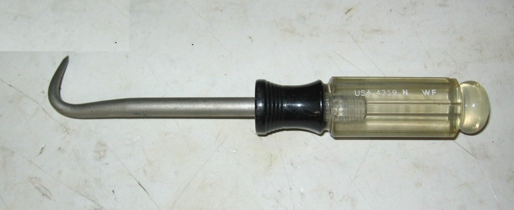

Bill, can you post a photo of the snap on one? Craftsman use to have one that looked like a bent awl. The one Jim posted is interesting, and looks like it could be effective. I also usually use side cutters. I really like Steve's ss pins.

Post by CudaMan » Wed Oct 07, 2020 9:10 am

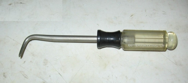

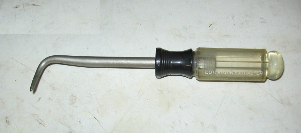

Here are photos of my Craftsman extractor. I hardly ever use it, I usually use the needle nose pliers first. :)

Post by RajoRacer » Wed Oct 07, 2020 10:00 am
I also have a Craftsman puller as shown - depending where on the T that I'm working, my dykes (side-cutter apparently is the proper term ?) pulls most all of them.

TFan
Posts: 408
First Name: Jim
Last Name: Riedy
Location: Sandusky,Ohio
Post by TFan » Wed Oct 07, 2020 11:37 pm
I should mention that tool I posted works well on newer or recent applications but if your working on something that has not been apart in 100 years or so they won't come out so easy. This is what I have had good luck with, I just back the nut that I'm working on off shearing the cotter off then I take a small drift and drive out the remaining parts of the pin, the remains usually show up as shiny metal against a rusty background. Jim

TFan
Posts: 408
First Name: Jim
Last Name: Riedy
Post by TFan » Fri Oct 09, 2020 11:17 pm
Mike, I finally dug it out haven't used it in awhile, it is made in USA and named Zim cotter pin puller. It looks as if it may have been plated at one time. Jim
