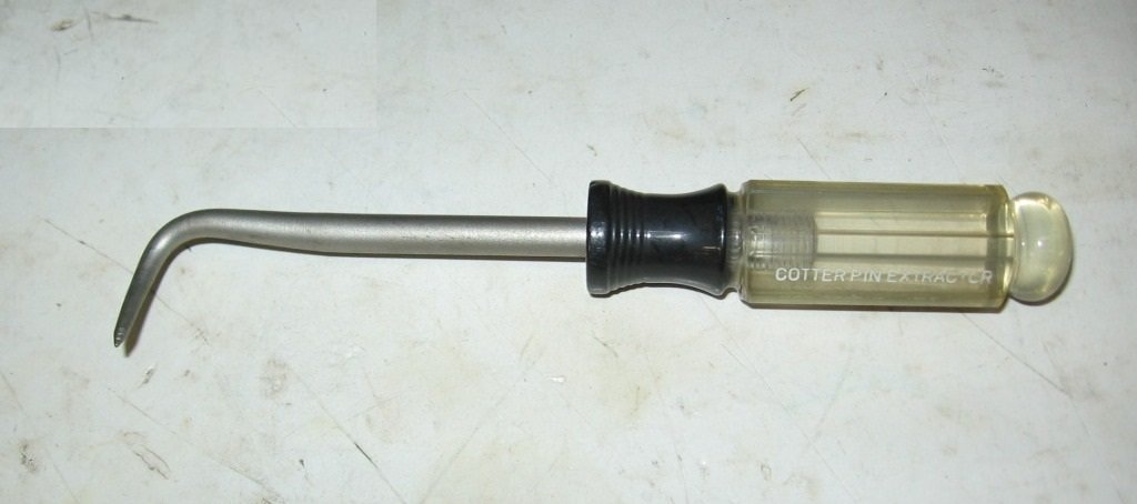

Here are photos of my Craftsman extractor. I hardly ever use it, I usually use the needle nose pliers first.

Re: Cotter pins tips
A friend that installed windshields always called that one a window installation tool! HA HA Anyway it worked well with the rubber.
I also have a Craftsman puller as shown - depending where on the T that I'm working, my dykes (side-cutter apparently is the proper term ?) pulls most all of them.
