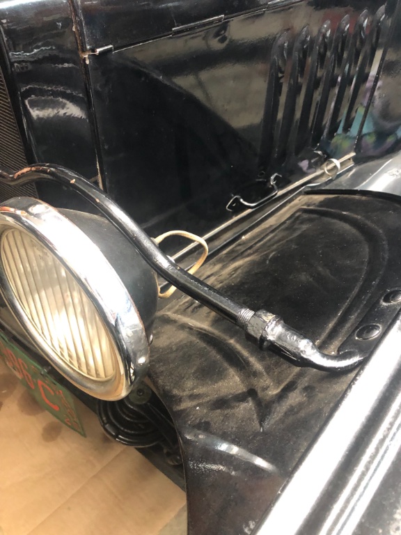

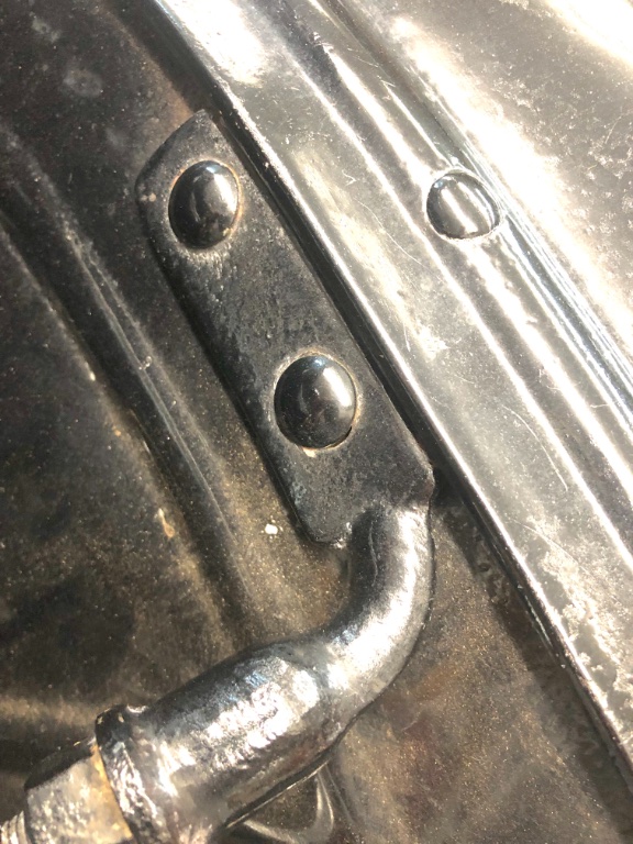

If you mean this type, ARG fender iron brace, the castings at each end have holes that are located over the two rivet heads to the fender/bracket. You chip off the ends of the rivets, drive them out, then place the brace over the holes. Secure with carriage head bolts on top, and lock washers and nuts under. The carriage bolt heads look like rivets.
Alden
Topic author - Posts: 19
- Joined: Tue Jun 22, 2021 10:06 am
- First Name: Bob
- Last Name: Smith
- Location: Troy, NH
Re: front fender brace mounting
That is it ! So no new holes have to be drilled. Excellent thank you all. Now I just have to find one.

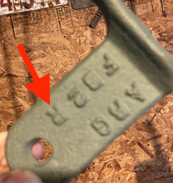

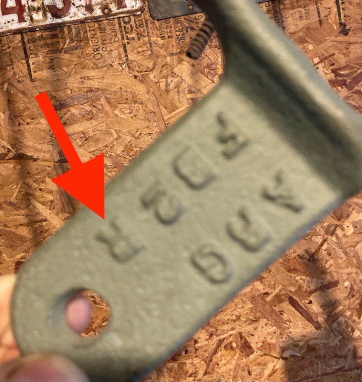

Agree, hard to find the ARG brand, these were made in Birmingham AL, perhaps had national sales, but likely found in the southeast.
I got the one for the '23 cut off barn T from Dan Hatch, who lives in Birmingham, perhaps he could round up another.
And, they made a Rear Fender brace.
Have a buddy in GA who has this Right hand brace, but needs a Left hand one too.....that rear brace will have the same markings but a "L" in the casting letters on the mounting leg.
ARG Rear
Looking for this style But with an "L" in the casting, not the R in this photo.
