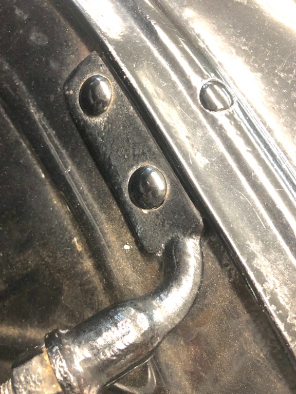

Post by DanTreace » Tue Sep 21, 2021 8:14 pm
Alden wrote:
Tue Sep 21, 2021 2:28 pm
I can't figure out how to post a picture, but I saw one of a brace the had two bump outs for the headlights. How do they mount, use existing riveted holes replaced by bolts or would you have to drill holes, (I wouldn't)
If you mean this type, ARG fender iron brace, the castings at each end have holes that are located over the two rivet heads to the fender/bracket. You chip off the ends of the rivets, drive them out, then place the brace over the holes. Secure with carriage head bolts on top, and lock washers and nuts under. The carriage bolt heads look like rivets.

Post by Alden » Tue Sep 21, 2021 8:25 pm
That is it ! So no new holes have to be drilled. Excellent thank you all. Now I just have to find one.

Post by DanTreace » Wed Sep 22, 2021 8:52 am
John
Agree, hard to find the ARG brand, these were made in Birmingham AL, perhaps had national sales, but likely found in the southeast.
I got the one for the '23 cut off barn T from Dan Hatch, who lives in Birmingham, perhaps he could round up another. ;)
And, they made a Rear Fender brace.
Have a buddy in GA who has this Right hand brace, but needs a Left hand one too.....that rear brace will have the same markings but a "L" in the casting letters on the mounting leg.
ARG Rear
Looking for this style But with an "L" in the casting, not the R in this photo.
