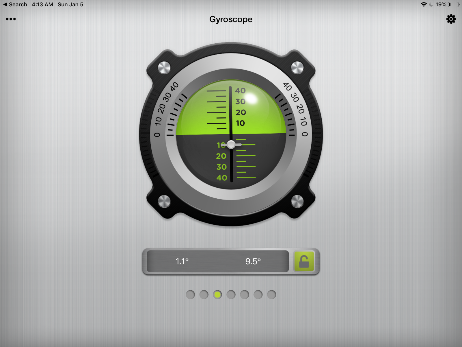

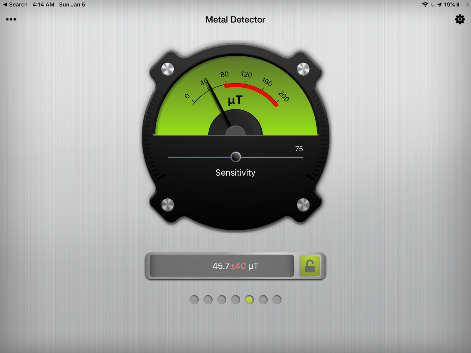

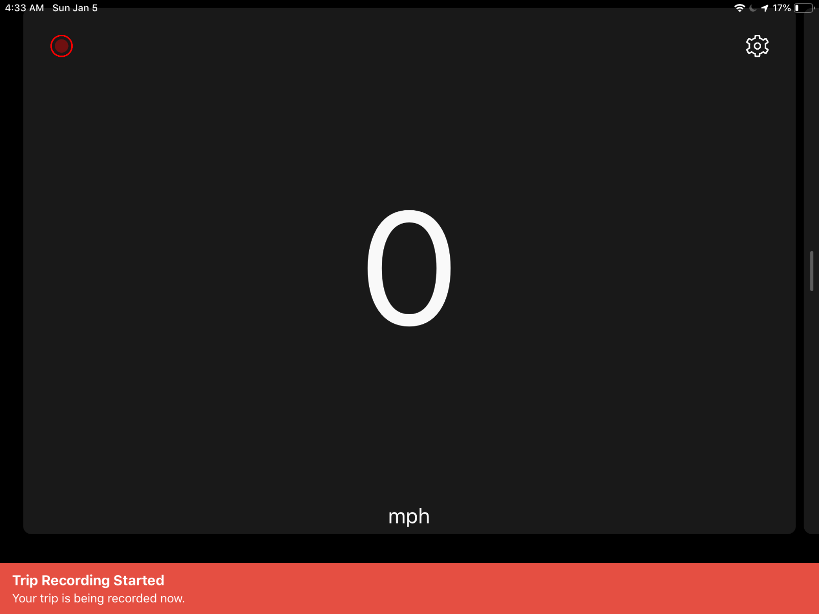

I just realized that you guys probably have not have discovered the true power of what's sitting in all your pockets. I was an early investor in GPS and Bluetooth chips that are in all your phones now, and I'm friends with the guy at HP who literally invented the GPS, so I take a lot of this stuff for granted. But I'll bet it's new to the vast majority of all of you. If needed, we can take this off topic, but it's really not. Read on.
The apps in your phones are really powerful. Start simple - There's a level app and after a lot of trial and error I finally found a decent magnometer app that's pretty accurate. Great for testing field coils on starters and generators.
Here are Other free apps I find very useful in this T hobby and I use a lot - these are the actual app names to search for in the Apple App Store. Not sure on Android but there should be equalivants, if not the exact same app:
Bubble Level - cool on many levels (!), swipe left or right for each app
Elevation - see how high you've climbed in your T. My hill is almost an 800' rise. Now you can see why I've burned so much Babbitt out of #1 rods driving up my hill day after day. But not anymore thanks to Hank's ultra cool Mountain Pan I just installed!
Speedometer - see how accurate your T Speedo is or how fast Brad Lusk's "stock" car really goes. (We hit 56mph and it was scary). This is a really great Touring app, even keeps track of where you went. Swipe to see all the screens. Hit the options button (always a gear icon) to set things up, then hit the record button to record your tracks while you drive.
It's boring until you start moving but it's 4am and I'm still in bed
Don't forget to "swipe" the screen to the left or right on apps to see other functions. Take your finger and press lightly on the left or right side of your phone screen and swipe the other way. You will be literally amazed at what these apps are capable of.
Precision? Are these precise? I can assure you that these apps are high quality and extremely accurate. I know the technology firsthand that sits in your phones. It's nothing short of amazing. An app is just a program that accesses data from the components in the phone and displays it in a useful way.
If you don't know how to get apps installed on your phone, go for a drive to any kindergarten school and find the first kid you see. Ask them and they will show you how. Or ask your grand kids. Or that totally clueless clerk at Walmart. They might not know how to work at Walmart but they know how to install apps. Trust me on this...
These remaining screenshots are all from one app- Bubble Level. Swipe the screen to see the next component in action.

Here's the "speedometer Simple"app written by Mikrasya. Search by author or by app name. I went for a drive yesterday and turned on trip record. Clicking on the gear icon and the trip history gives you this:
