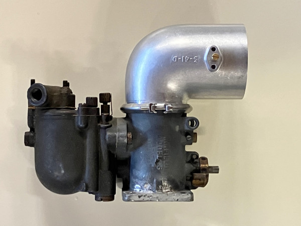

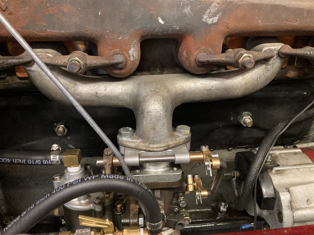

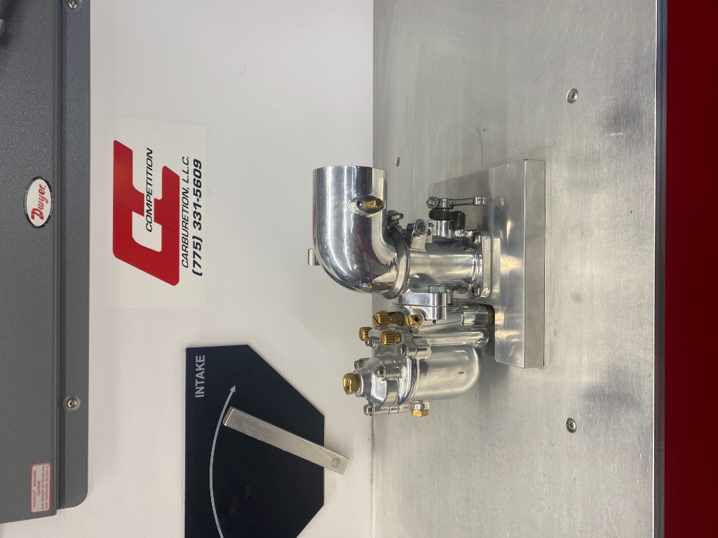

Had a chance to get away today and bring my new Winfield home from the carb guru. Here is a pic of the carb on the flow bench
This little carb did look a bit out of place amongst all the big dog 4 barrels in his shop... some of those monsters could have passed this thing right thru!

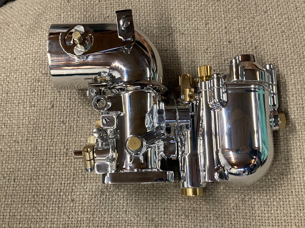

Had a fella work on the polish... now it’s wasaaaaay to nice to put on anything I own...

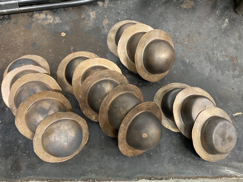

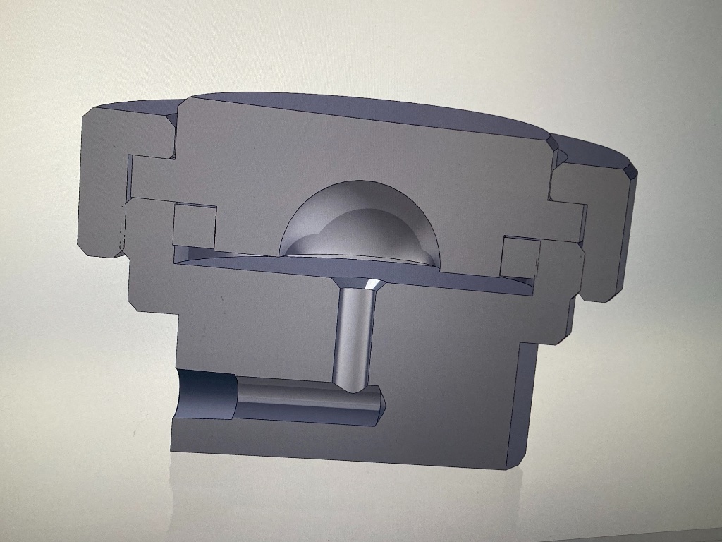

Guess it’s been a while since the Tulare swap...
The float project WORKED!!! Hydraulic forming was not near as simple as it sounds, but was able to develop a sound process involving several annealing steps that would ultimately yield good parts. A couple floats were soldered together and checked for proper weight and size.
Here is the hydraulic forming fixture concept; And after several hours of machine work; After several more hours of forming; And finally, after several minutes of soldering; Both float styles came out on size (that was the easy part), and on weight (a bit trickier). The full sphere Model S float weighs in at a whopping 30 grams, and the flat bottom Model SR a mere 22 grams.

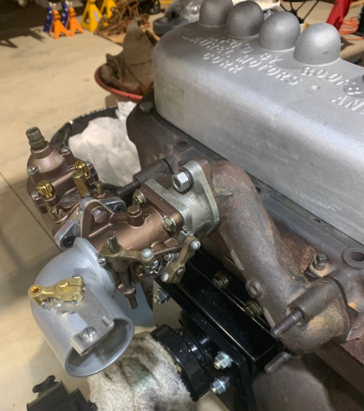

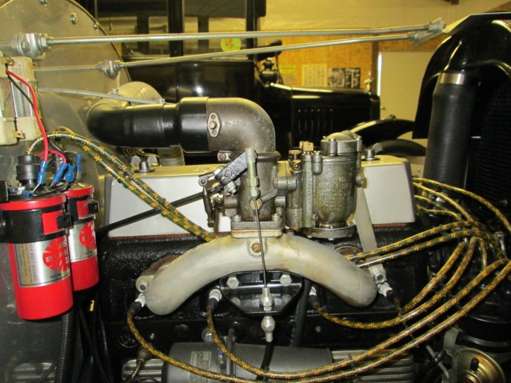

As seen in another thread, I installed a Model S-AA updraft on my touring car several weeks ago. This carb was mostly original, but had as many of my own components installed. Choke horn, choke linkage, V band clamp, carb adapter, throttle shaft, bushings, butterfly, float bowl cover, fuel inlet, and one of the new floats!
Since then we have driven bout 600 miles, made up from a number of local drives of various lengths, and a 450 mile adventure around the Olympic Peninsula in Washington state. Probably should note the 1600 miles on the trailer too. Thought I would pull the float cover off today to inspect the float and float lever for wear, tear, and corrosion.
It all looks beautiful! The float lever has a tiny polish point right where it should be, and the float ball has simply a bit of tarnish

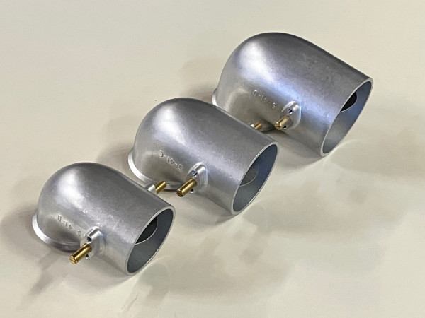

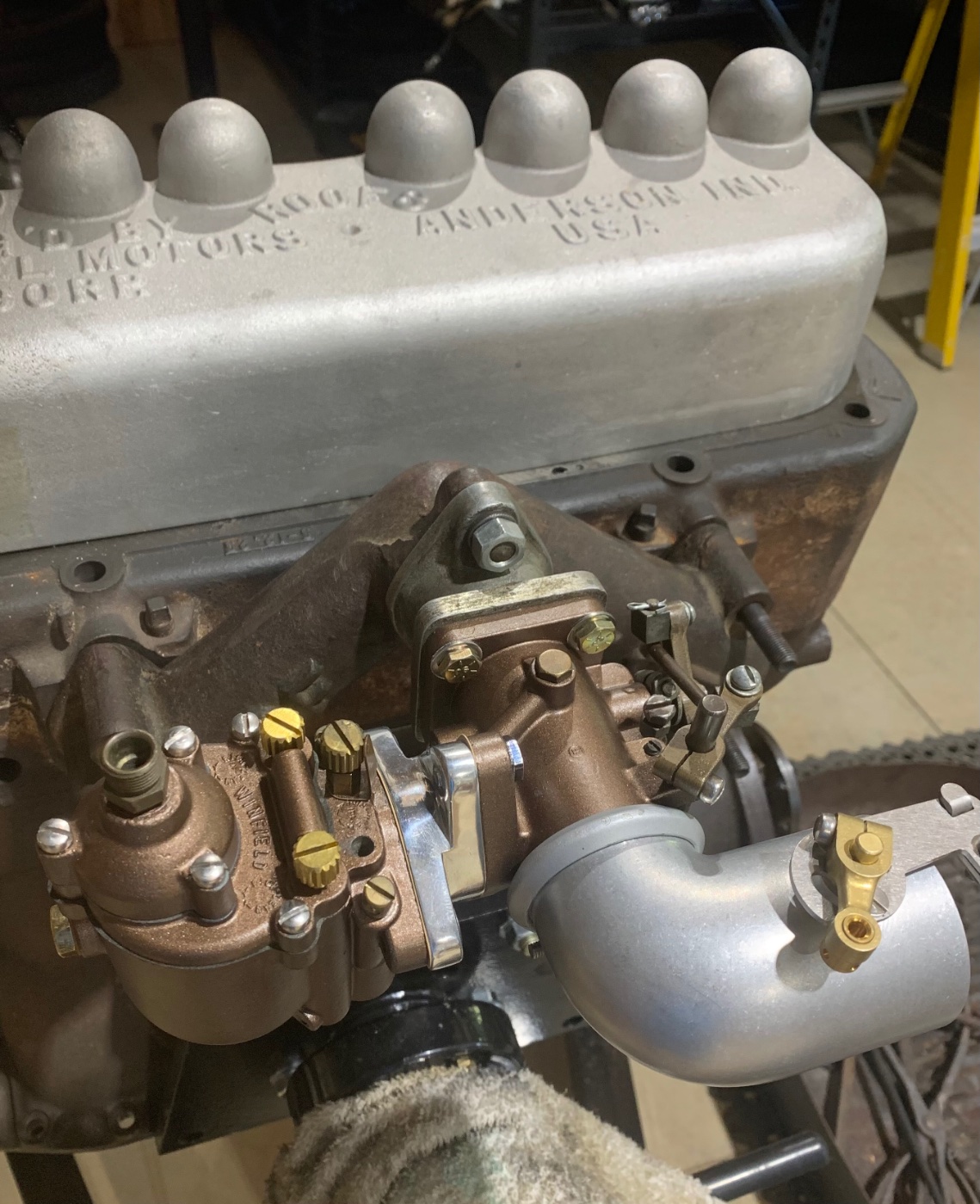

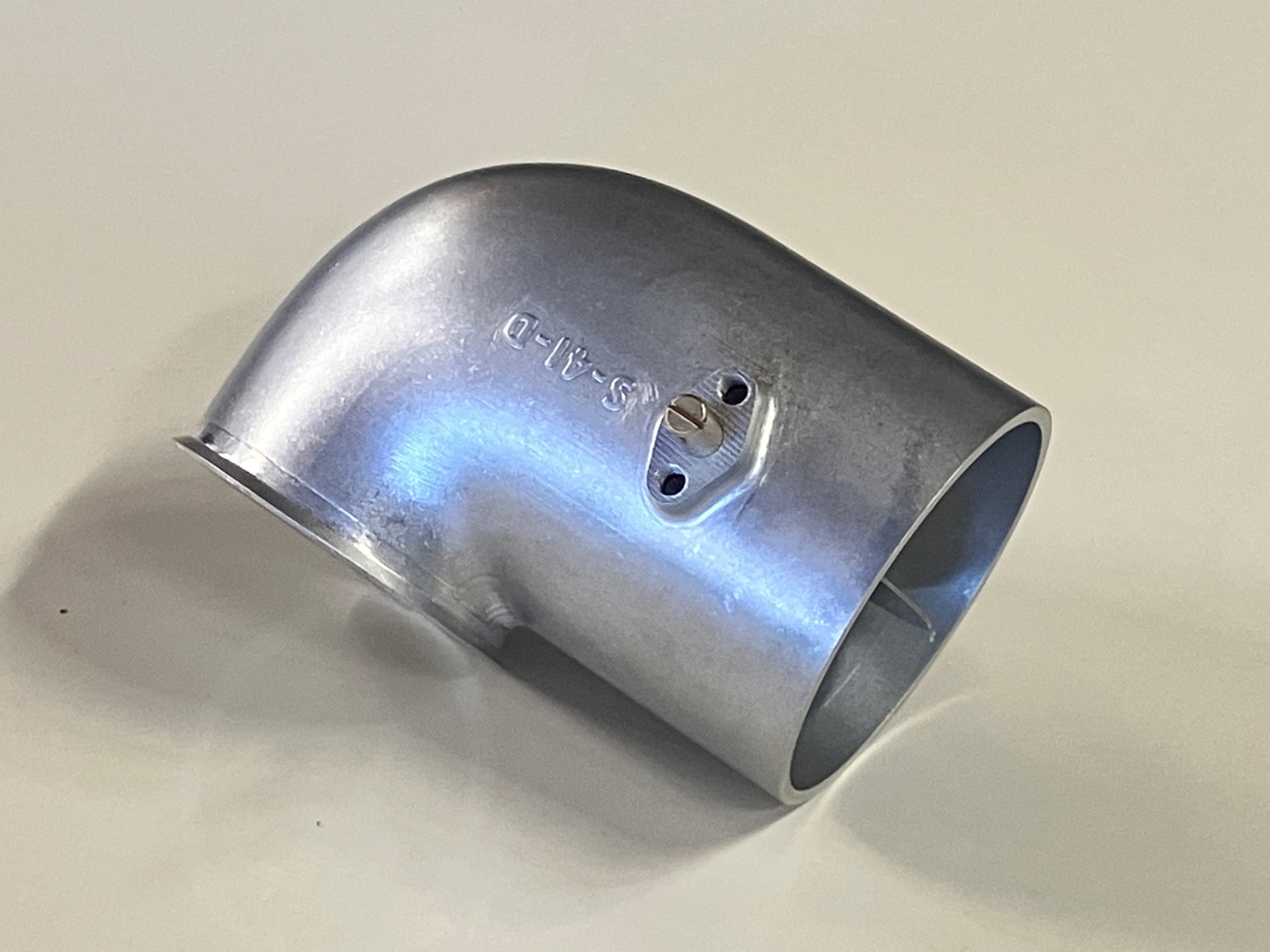

Been playing again…! This time a CC/D choke horn. It’s almost a complete collection

I just received a new choke horn assembly from Kevin to go on my SBU that has been converted to side draft for my Roof 8 speedster build. The parts fit great and look just like the original bits on my ‘27 Runabout with an iron RAJO and a SBD.
Thank you Kevin for making these hard to find parts available.
