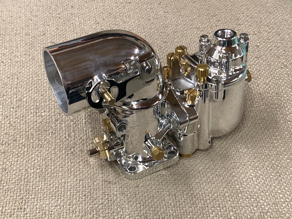

Post by Kevin Pharis » Thu Mar 31, 2022 12:46 pm
Had a fella work on the polish... now it’s wasaaaaay to nice to put on anything I own...😳😳

Post by Kevin Pharis » Thu Mar 31, 2022 9:16 pm
Everyone round here knows I’m carb crazy... My wife calls this project “the other woman”, the kids call it the “carb-inater”. After almost 2 years of obsessive designing and machining... it’s kinda like a part of the family now😉

Been playing again…! This time a CC/D choke horn. It’s almost a complete collection :D

I just received a new choke horn assembly from Kevin to go on my SBU that has been converted to side draft for my Roof 8 speedster build. The parts fit great and look just like the original bits on my ‘27 Runabout with an iron RAJO and a SBD.
Thank you Kevin for making these hard to find parts available.
