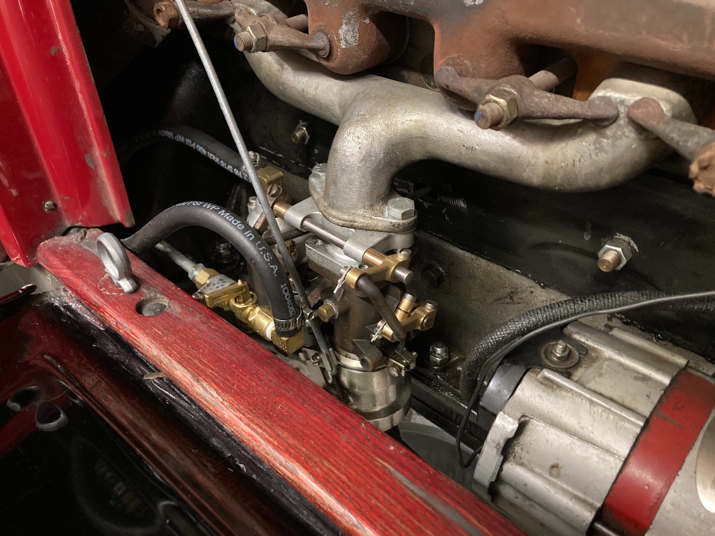

Had a chance to get away today and bring my new Winfield home from the carb guru. Here is a pic of the carb on the flow bench
This little carb did look a bit out of place amongst all the big dog 4 barrels in his shop... some of those monsters could have passed this thing right thru!😬

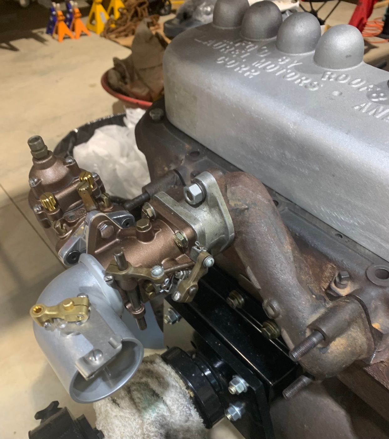

Post by Kevin Pharis » Sat Apr 16, 2022 11:22 am
Been working towards completing all the little trinket details before the Tulare swap meet.
A couple years ago I started making really intricate machined choke levers that looked like they had been folded up out of sheet metal just like the originals. Not sure if I ran out of patience, or maybe the project just wasn’t meant to be... but I scrapped the project the other day and started drawing up the earlier cast brass version. I’m glad I did, cuz the throttle stop, throttle arm, and choke arm all share similar design characteristics and so design and manufacturing went very smoothly for all.
I’m determined to make the pivoting choke cable clamp, and spring tab for the idle needle today. Then, all that’ll be left to make is the float ball...

Choke cable clamp DUN! Now for the idle screw spring...

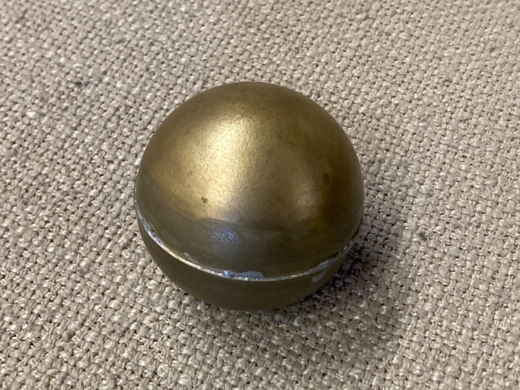

The float project WORKED!!! Hydraulic forming was not near as simple as it sounds, but was able to develop a sound process involving several annealing steps that would ultimately yield good parts. A couple floats were soldered together and checked for proper weight and size.
Here is the hydraulic forming fixture concept;
And after several hours of machine work;
After several more hours of forming;
And finally, after several minutes of soldering;
Both float styles came out on size (that was the easy part), and on weight (a bit trickier). The full sphere Model S float weighs in at a whopping 30 grams, and the flat bottom Model SR a mere 22 grams.
