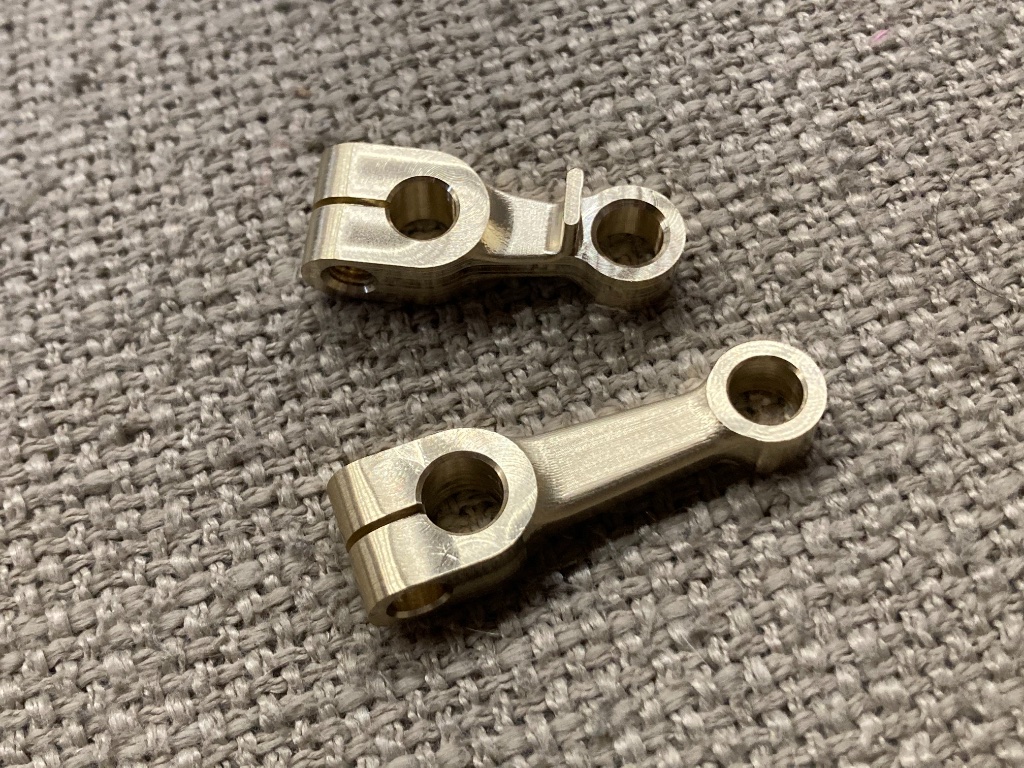

Been working towards completing all the little trinket details before the Tulare swap meet.
A couple years ago I started making really intricate machined choke levers that looked like they had been folded up out of sheet metal just like the originals. Not sure if I ran out of patience, or maybe the project just wasn’t meant to be... but I scrapped the project the other day and started drawing up the earlier cast brass version. I’m glad I did, cuz the throttle stop, throttle arm, and choke arm all share similar design characteristics and so design and manufacturing went very smoothly for all.
I’m determined to make the pivoting choke cable clamp, and spring tab for the idle needle today. Then, all that’ll be left to make is the float ball...

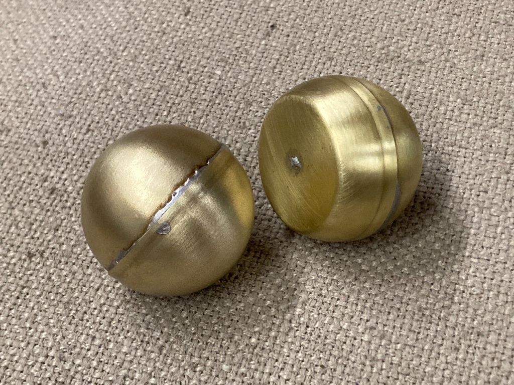

Guess it’s been a while since the Tulare swap...
The float project WORKED!!! Hydraulic forming was not near as simple as it sounds, but was able to develop a sound process involving several annealing steps that would ultimately yield good parts. A couple floats were soldered together and checked for proper weight and size.
Here is the hydraulic forming fixture concept; And after several hours of machine work; After several more hours of forming; And finally, after several minutes of soldering; Both float styles came out on size (that was the easy part), and on weight (a bit trickier). The full sphere Model S float weighs in at a whopping 30 grams, and the flat bottom Model SR a mere 22 grams.

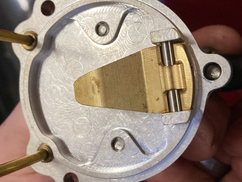

As seen in another thread, I installed a Model S-AA updraft on my touring car several weeks ago. This carb was mostly original, but had as many of my own components installed. Choke horn, choke linkage, V band clamp, carb adapter, throttle shaft, bushings, butterfly, float bowl cover, fuel inlet, and one of the new floats!
Since then we have driven bout 600 miles, made up from a number of local drives of various lengths, and a 450 mile adventure around the Olympic Peninsula in Washington state. Probably should note the 1600 miles on the trailer too. Thought I would pull the float cover off today to inspect the float and float lever for wear, tear, and corrosion.
It all looks beautiful! The float lever has a tiny polish point right where it should be, and the float ball has simply a bit of tarnish
