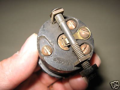

Here you go:
The head of the screw and the nut are very, very thin.
Keith

The photo above is not correct! The part in question is a screw, and is smaller than what is pictured. I detest people posting information like this! The originals were 6-32 X 1 1/2", raven finished. The nut is hex. I have several of these. I pick them up when at Hershey and other places.

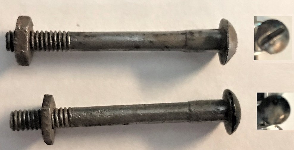

Larry, are either of these correct? Similar style screws but one is slotted and the other is slightly smaller head diameter and no slot. Also different thickness hex nuts. Both were in dirty horn buttons ThanksOriginal Smith wrote: ↑Tue Apr 05, 2022 11:01 amThe photo above is not correct! The part in question is a screw, and is smaller than what is pictured. I detest people posting information like this! The originals were 6-32 X 1 1/2", raven finished. The nut is hex. I have several of these. I pick them up when at Hershey and other places.

Thanks for posting the examples. Pictures are so helpful.

Your original response prompted me to see if I had a correct screw nut combination to match your description (The originals were 6-32 X 1 1/2", raven finished.) So are any of these parts not or screw correct.?Original Smith wrote: ↑Tue Apr 05, 2022 11:46 amWhat is nasty about posting correct information about a subject that will benefit everyone?

The first picture I posted was harvested off the interweb. I wish I could give the image owner credit.
I have seen both thin and thick nuts like in the image Frank posted. Mine has the thin nut (and its really hard to put it together!)
100% original.
Keep in mind that Ford sourced parts and fasteners from more than one supplier.

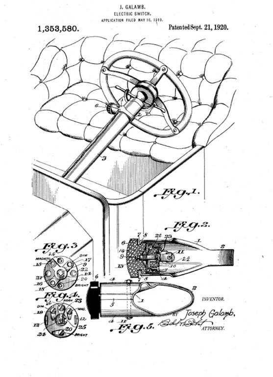

That sketch of the assembly is great KW.
