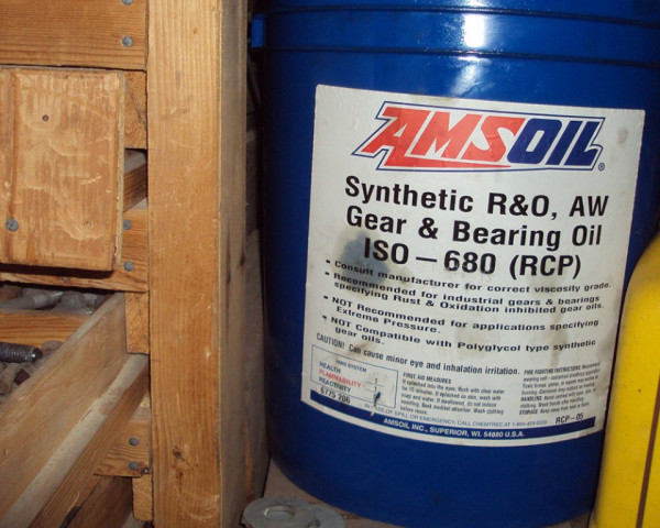

While I'm not a big fan of other synthetics I have been using this in my Differential as well as my Warford and other antique gear boxes and rear ends. It has worked well for 20 years or so and I have not discovered any ill effects. You want to have good seals. It likes to creep out but the new style axle seals hold it OK.

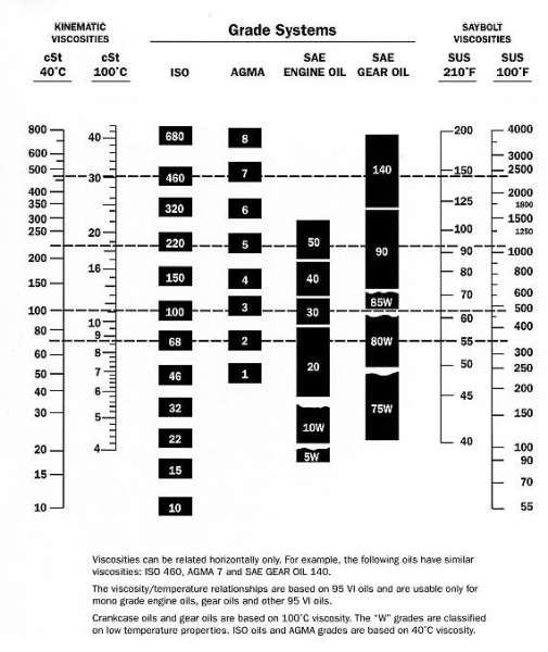

The Amsol & Penrite references seem aligned with the references to the differential fluid being 600W
SAE 140W gear oil appears to have a wide range of applicability and ISO 600 appears to be within its range.
From various sources
https://modelafordclub.co.nz/wp-content ... 0W-Oil.pdf "Everything I've found indicates 600W was mineral based gear oil, early Model T data talks about 600W Steam Cylinder Oil, which research showed having a viscosity of ISO600/ 680."
Penrite Transoil 250 is premium non EP, API GL-1 rated SAE 250 gear oil designed specifically for use in veteran, vintage and Edwardian gearbox, transaxles and selected spur and bevel type rear axles. It does not contain any aggressive load carrying additives that may cause corrosion damage to ferrous and non ferrous metal types used in these types of vehicles. It is suitable for use in rear axles of veteran cars of one, two and four cylinders. It contains a special additive to help the load carrying ability of the oil. Contact with any water or moisture should be avoided or seal degradation may occur. This oil is compatible with leather and synthetic rubber seals. Please Note: While this oil has the characteristics of the old 600W or steam cylinder oils, it MUST NOT be used as a steam cylinder oil.

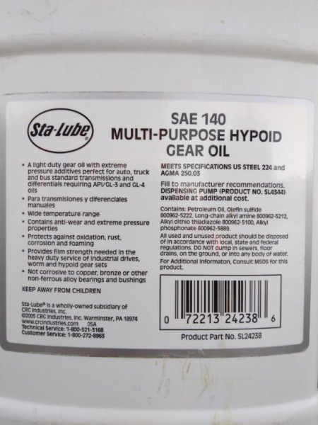

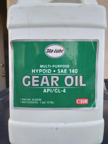

I've been using this stuff for years in both Ruckstells and stock rear axles. The label states that it is non corrosive to bronze. I have no idea as to whether other gear oils might be but I'd rather play it safe as to the bronze thrust washers.
