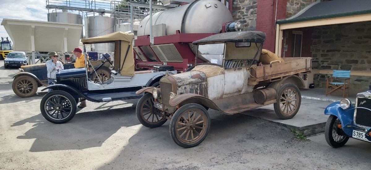

Post by Allan » Tue Apr 12, 2022 6:25 am
When returning my barn find Henrietta to the road after her 66 year slumber I checked the rear axle oil level as part of the procedure. I was surprised to find no oil, but did ring a copious amounts of grease. I put the plug back in and have driven her for 4 years as is. It will be interesting to see how it looks when I do have to rear it down.

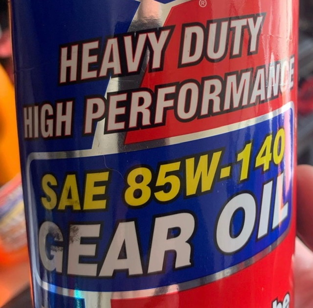

When it was time to pump out the old gear oil and put in something new, I strolled down to the local parts shop and went through their selection of gear oil. Almost everything was a multi-weight oil and I ended up selecting a Lucas oil 85w-140. I knew the 140 would be in the neighborhood of to 600 oil the T’s were recommended to have.
Would a multi-weight oil for the differential be considered similar to the common arguments on engine oil? As in, it’s a far better quality oil than anything they had back in the day, so you’re all good? Or does that multi-weight oil possibly pose a risk of not protecting your differential enough with the initial lighter weight characteristic of the oil? I believe a Model Ts differential is known to have a few drips… but I wonder if a multi weight oil results in excessive dripping as compared to a Lang’s straight 600 or SAE140 gear oil since it’s thinner when the T is parked for a while in a garage or parking lot.
