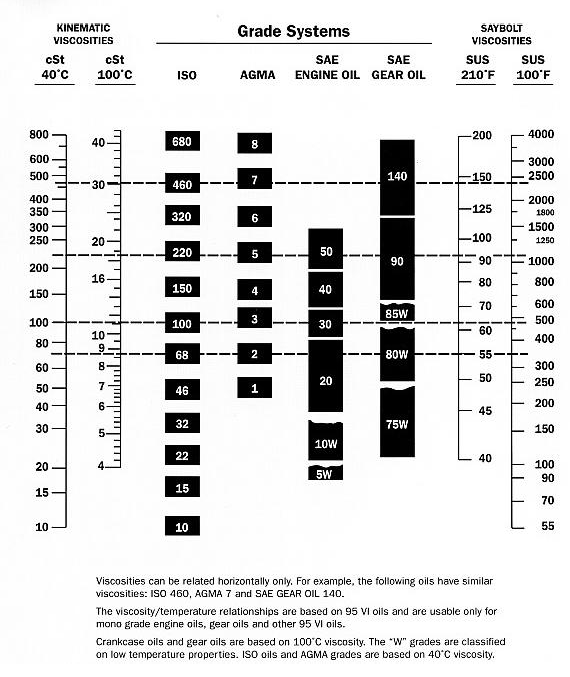

Gear grease, "pourable grease". gear oil, steam cylinder oil, oil or grease: just call it differential fluid so its not confused with engine oil or engine oil viscosity W
The Amsol & Penrite references seem aligned with the references to the differential fluid being 600W
SAE 140W gear oil appears to have a wide range of applicability and ISO 600 appears to be within its range.
From various sources
https://modelafordclub.co.nz/wp-content ... 0W-Oil.pdf "Everything I've found indicates 600W was mineral based gear oil, early Model T data talks about 600W Steam Cylinder Oil, which research showed having a viscosity of ISO600/ 680."
Penrite Transoil 250 is premium non EP, API GL-1 rated SAE 250 gear oil designed specifically for use in veteran, vintage and Edwardian gearbox, transaxles and selected spur and bevel type rear axles. It does not contain any aggressive load carrying additives that may cause corrosion damage to ferrous and non ferrous metal types used in these types of vehicles. It is suitable for use in rear axles of veteran cars of one, two and four cylinders. It contains a special additive to help the load carrying ability of the oil. Contact with any water or moisture should be avoided or seal degradation may occur. This oil is compatible with leather and synthetic rubber seals. Please Note: While this oil has the characteristics of the old 600W or steam cylinder oils, it MUST NOT be used as a steam cylinder oil.

I've been using this stuff for years in both Ruckstells and stock rear axles. The label states that it is non corrosive to bronze. I have no idea as to whether other gear oils might be but I'd rather play it safe as to the bronze thrust washers.

This topic can go on for ever and everybody has their own formula, when Model Ts came out of the factory there was grease in the differentials, they never used any oil.  There were no seals to prevent any leakage only dust covers to prevent dust from entering, so each to his/her own.
Grease comes in various weights from nearly liquid to almost solid from 000 up to #3. the differential housings did not have a drain plug only a fill plug, some early references call it an oil plug and many refer to it as a grease plug. Many have modified the differential housings and installed a drain plug, however a drain plug was never on the original housings. Some plugs were at the midway location and some near the top.

The early reference material calls for #2 grease this was the middle of the road weight of grease and got the cars rolling down the road.  In warm climates there would not be any issues but in colder climates lubrication may suffer some.  The term that, were used was  NON FLOWING GREASE.
In the day there were various standards for categorizing grease weights, however today the standard institute is the National Lubricating Grease Institute. Common grease weights used today are number 1.5 and number 2, with number 2 being most common in automotive stores. Marine stores do carry number 1.5 weight, it is better than the number 2.
A good test for nonflowing grease is to place some grease on a flat glass on a hot day and point it up like an ice cream it should just slump but not flow. With the tests I have done number 1.5 seems to be the better choice, however number 1 would be better but I was unable to find it. All the various weights of oil just flowed off the glass. Grease weights can be from 000, 00, 0, 1, 1.5, 2 and 3.
The ideal grease should have the consistency of creamy margarine and it should not flow out the end of the axles. Some people constantly say it will just cut a swath through the grease and not lubricate any thing. This would be true if you used too heavy a weight of grease, you can't just say grease and stop there. The proper weight must be used for the proper application.
The design of the Ford differential housings was to accommodate grease, there were no seals just dust covers. The outer bearings were lubed with grease cups, a heavier weight could be used for this application to reduce any run out. With a creamy non flowing grease in the housing the inner bearings would be adequately lubricated. The early reference calls for about 2 pounds of grease, there is no mention of "up to the bottom of the filler plug". Some filler plugs were at the top of the housing, some part way down and others in the center. For grease it didn't matter where the fill hole was. I have grease in my 15 and 26 and would not use anything else.
