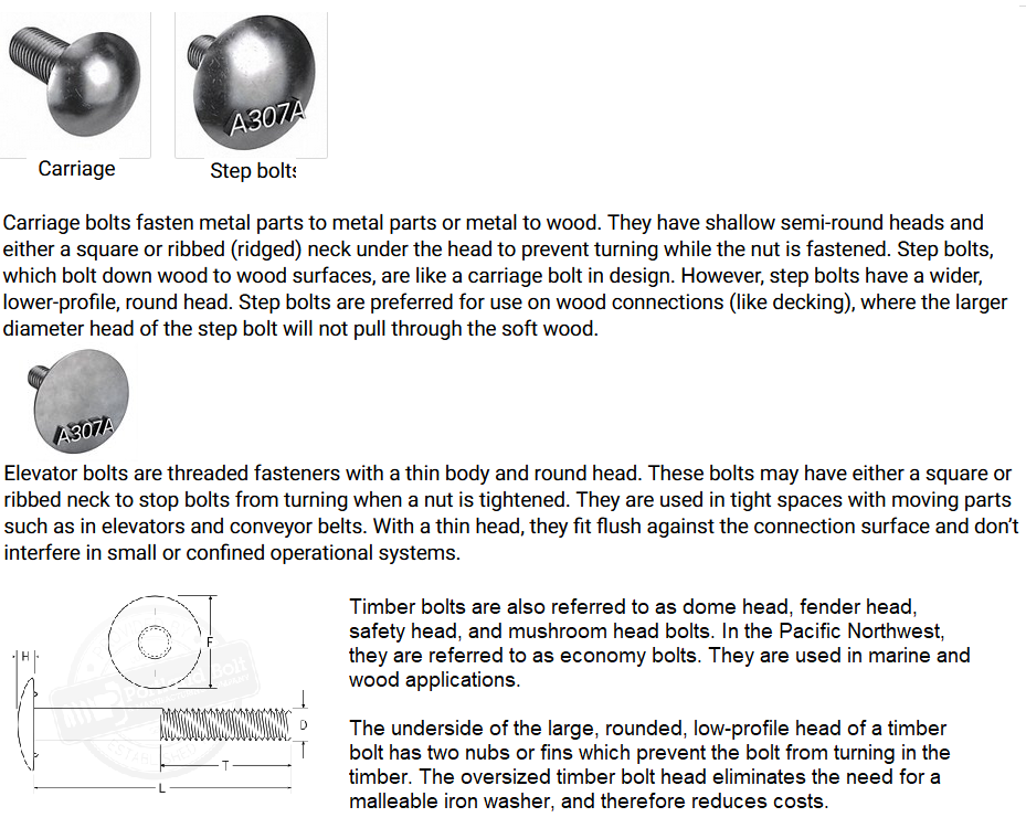

Try Grainger - & its step bolts that have the wider head
https://www.grainger.com/category/faste ... step-bolts
There are also Timber bolts but harder to find
They are different as the underside is not square https://www.portlandbolt.com/products/bolts/timber/

I would agree the STEP BOLTS are closer in appearance to the original. All the ELEVATOR BOLTS that I have seen used on conveyor equipment in grain elevators, have a large diameter head, but they are flat and not 'domed'.

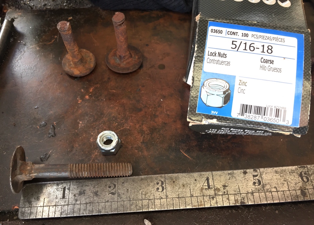

I started at Ace Hardware and asked the staff a while back and they said they didn’t have those. I recently met the “bolt guy” that actually stocks the bolts for all the stores he also confirmed that they don’t carry it. The guy actually mentioned that I could try other locations that may have old stock.
The project is stored offsite but here are two bolts (in top of photo) that I took off. I believe they were both used to hold a fender bracket. One has a square that you normally find under a carriage bowl. The other one barely has a rib. Is that a timber bolt? In any case one of them must’ve been replaced. Does anyone know what Martin Perry originally used? The originals were cut off by a previous owner. I happen to have one bolt that would work as a replacement. It is 2 1/4 inches long and 5/16 diameter.

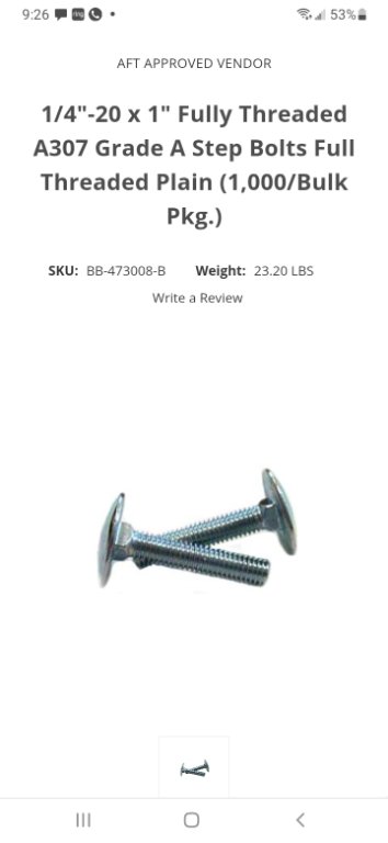

- Posts: 6712
Re: Where to buy extra large head carriage bolt
- Posts: 4631
Amazon has all kinds of step bolts.
