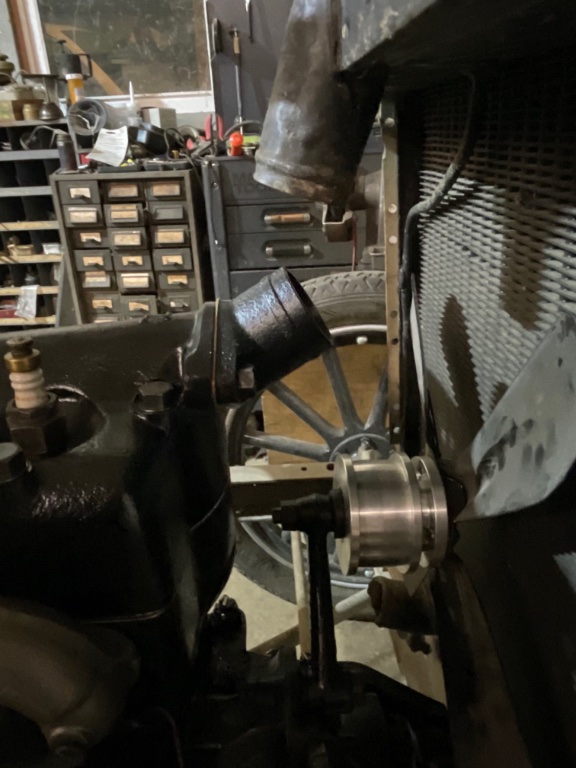

can I use a Z head on a 23 with a low radiator?
Post by Don ellis » Mon Nov 14, 2022 4:43 pm
What is the fix for the upper water neck? I don't think a hose will bend like that. Will a water neck for a high radiator work?

Don’t get the low head and high head mixed up with the low radiator and high radiator. The Z head is a high head and takes the head outlet to radiator used 1917-1925. It sounds like you may have a head outlet for a brass radiator car, the correct outlet should go up aprox 90 deg from the head not up at aprox 45 deg from head.

I have a low radiator, I want to use a high z head. Can I use a later outlet to make the radiator hose align better is the question.

In case I’m not explaining good enough

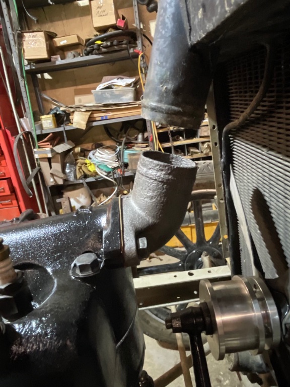

Post by Don ellis » Mon Nov 14, 2022 7:29 pm
Never mind, the later neck will make it work

Post by Kerry » Mon Nov 14, 2022 8:07 pm
Yes, that outlet is off a low head up to about 1917
