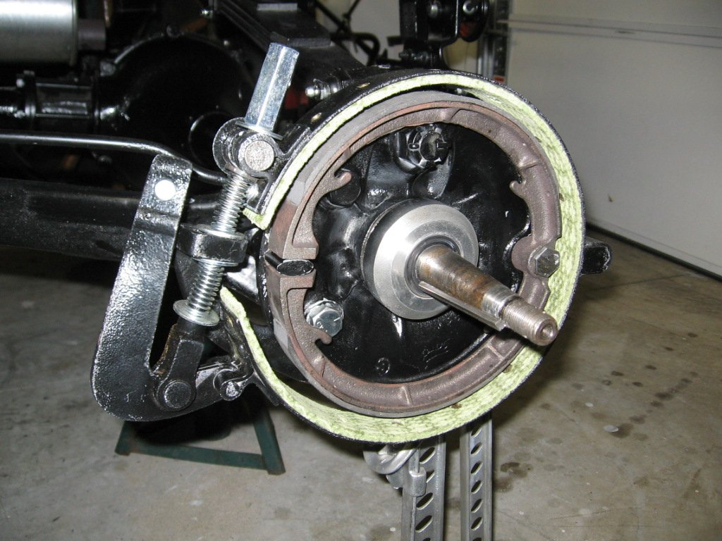

I assume you have a set of the original period AC brakes that were set up to use a cable, like mine in the first picture below?

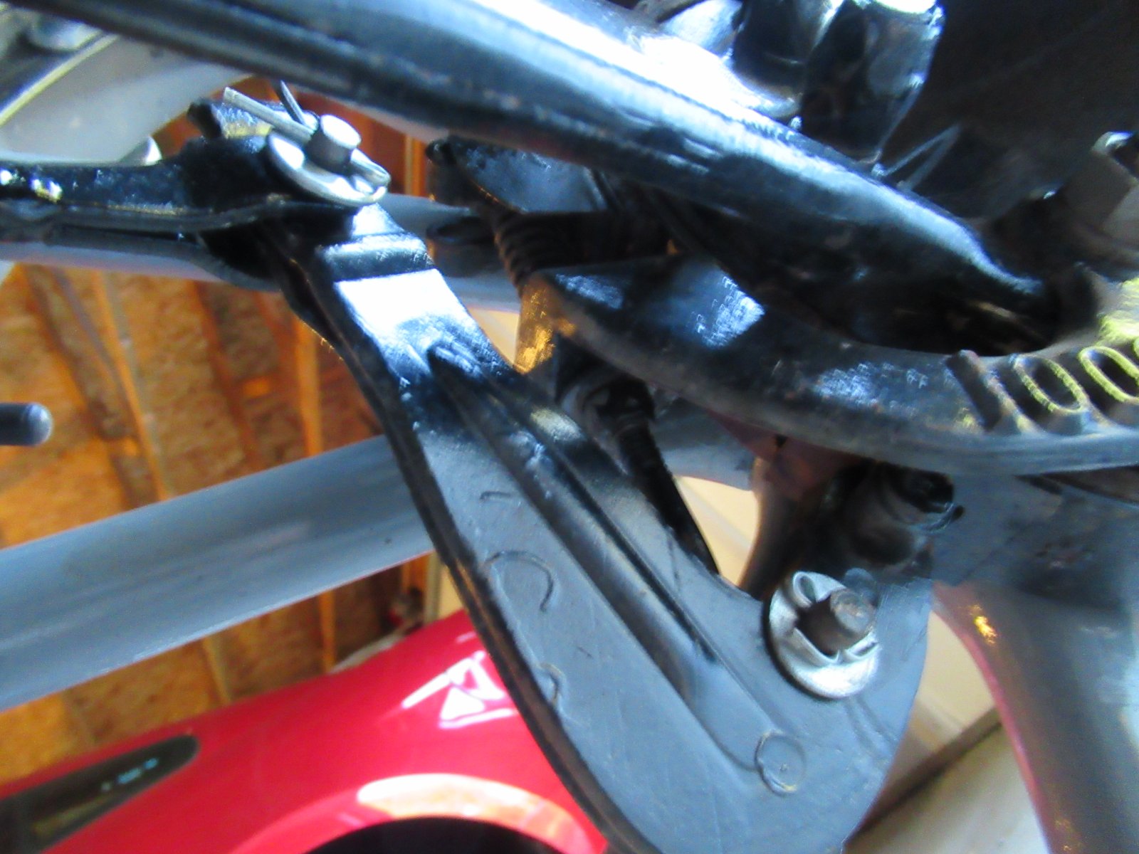

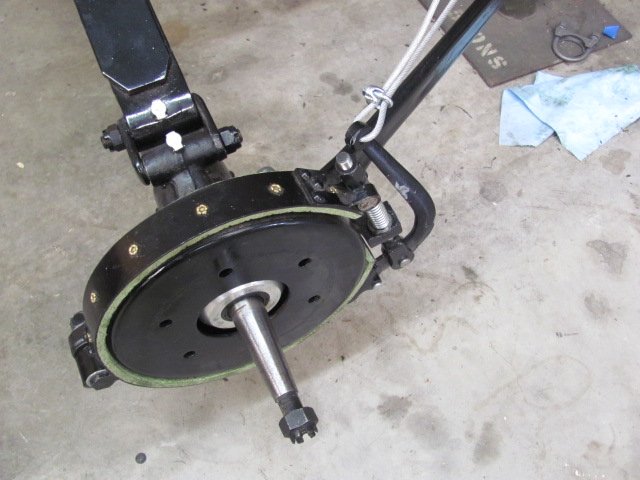

The "modern" AC brakes that were formerly available from Larry Sidmore were already designed to use rods, but the attached second picture from elsewhere in the forum shows someone looping a cable through the arm hole that can also accept a clevis from a rod setup.

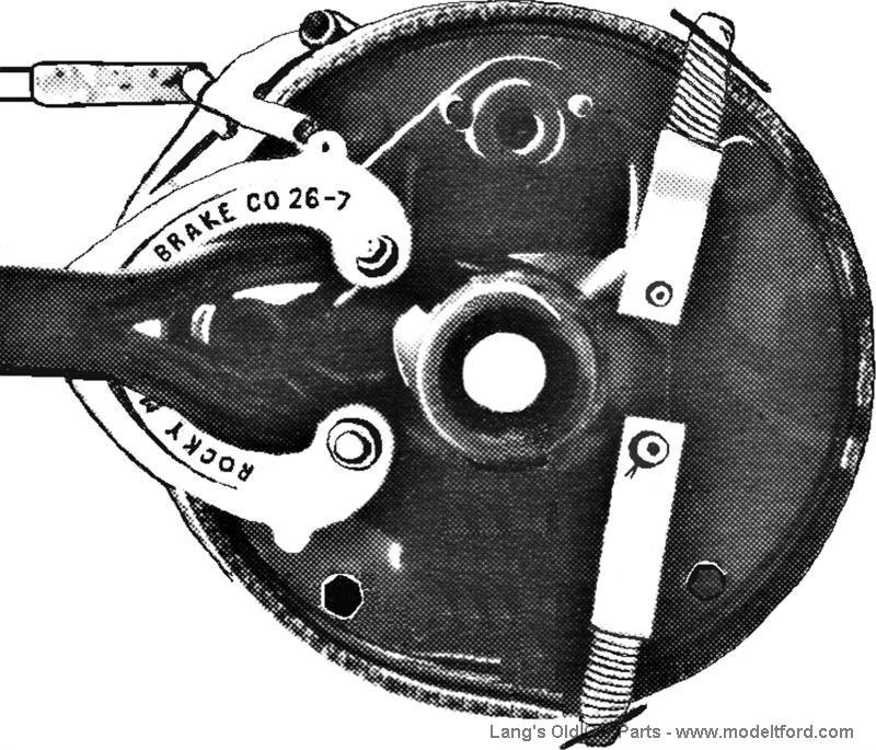

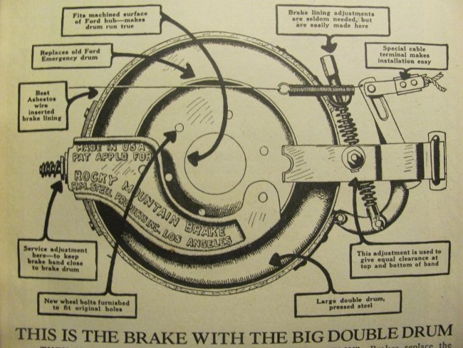

The bands on AC brakes and original and early reproduction Rocky Mountain brakes are anchored at the rear, so they stop just as well going backwards as forwards, see the first picture below.
The bands on the currently available reproduction Rocky Mountain brakes are anchored near one end of the band. This makes them more effective going forward, but less effective going backwards. The second attached picture shows this setup.

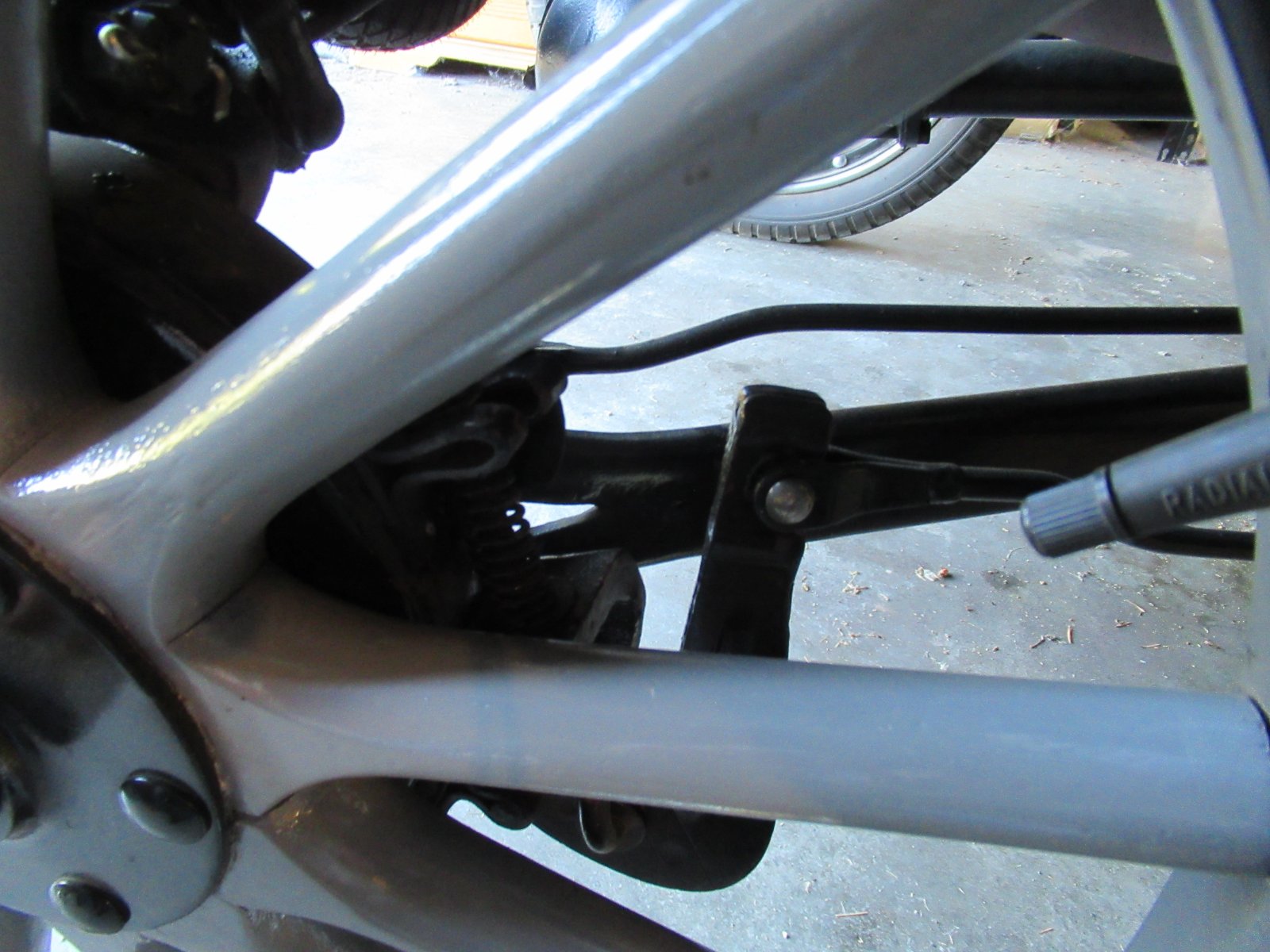

My concern is whether rods from the hand brake levers will work. Do they pass under the running board brackets, radius rods etc without interference?. Can I use the Fords clevises to connect the rods to the brakes or is a short license of cable a better option? Etc.

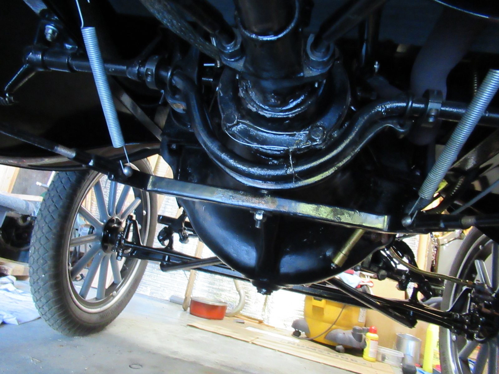

Here’s an original A-C setup that uses rods. Note that it still uses an equalizer, which imho is better than rod setups that do not.
