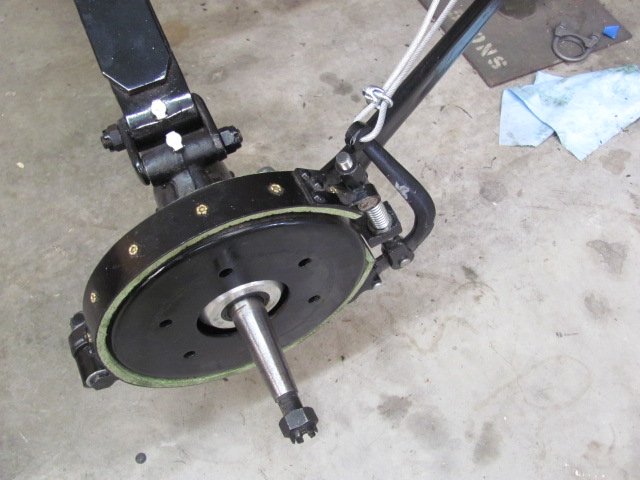

I assume you have a set of the original period AC brakes that were set up to use a cable, like mine in the first picture below?
The "modern" AC brakes that were formerly available from Larry Sidmore were already designed to use rods, but the attached second picture from elsewhere in the forum shows someone looping a cable through the arm hole that can also accept a clevis from a rod setup.
