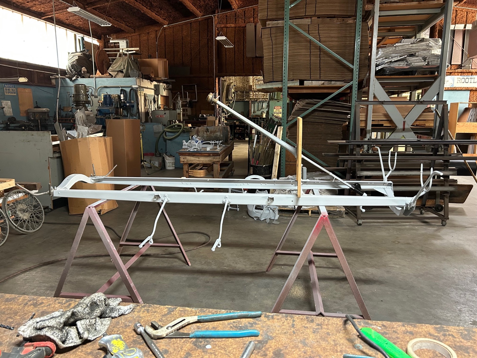

For the last 7-8 years I gathered parts in hope of building a Torpedo. So I thought it’s time to put the chassis together and we’ll think about a body later. So for now I brought what I have to the shop and started with riveting brackets to the frame, straightening and aligning said brackets and priming as I go.

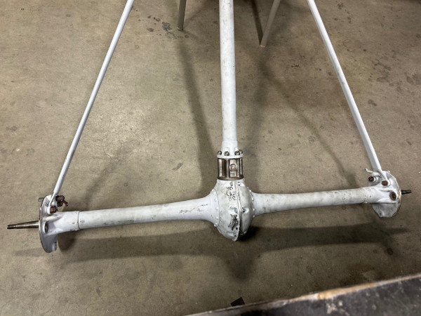

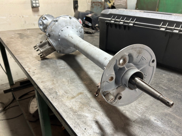

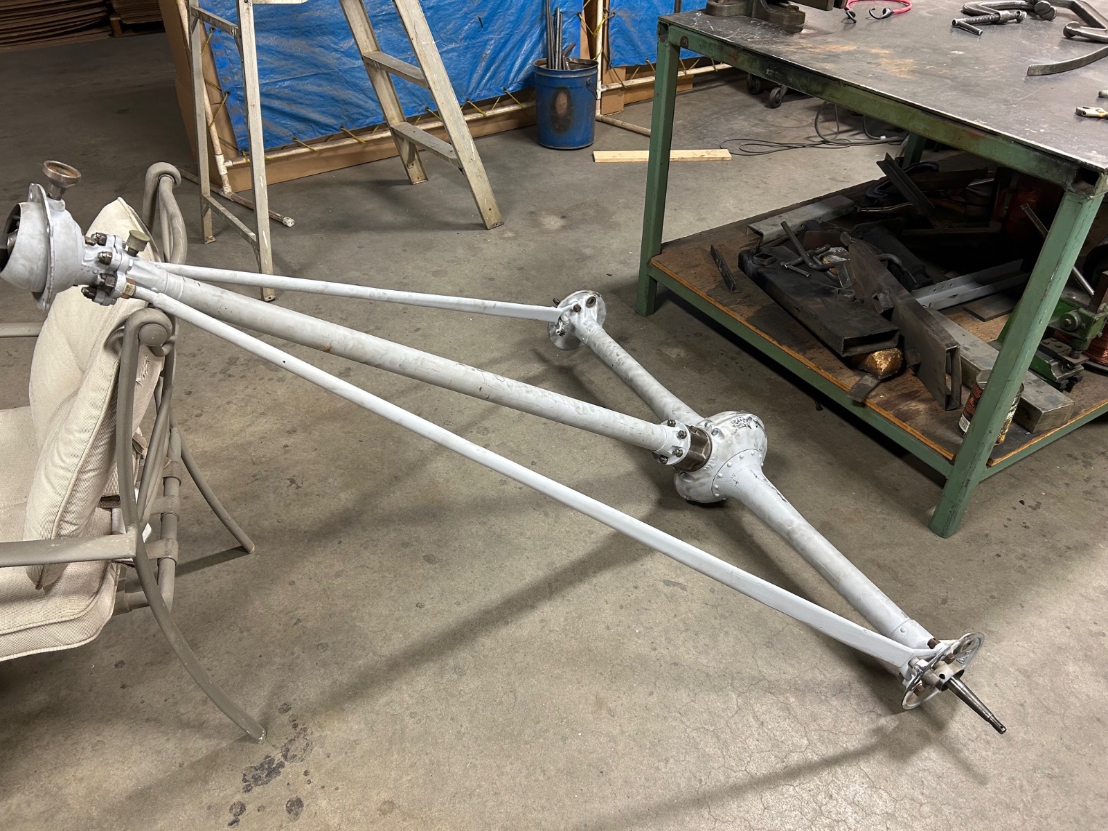

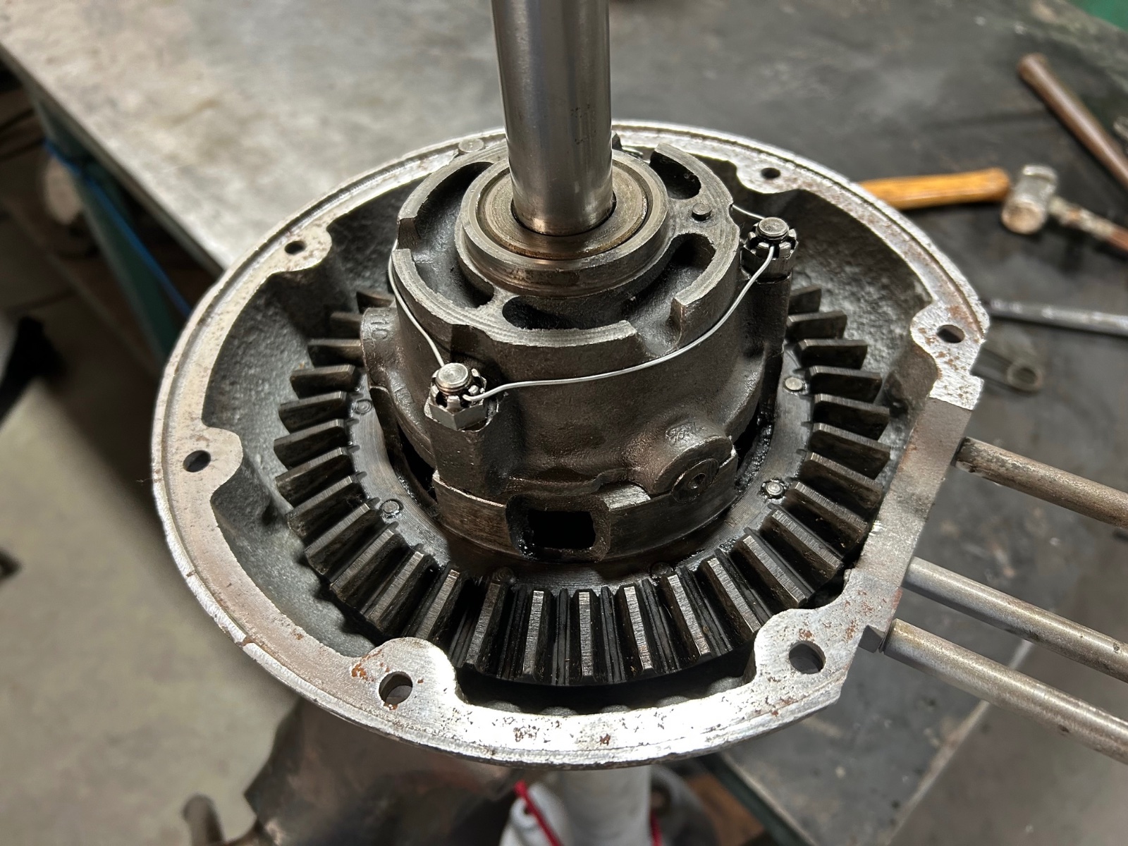

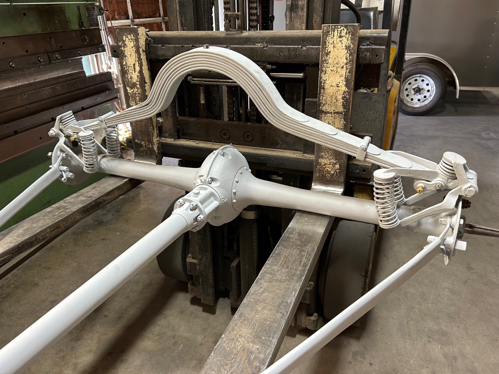

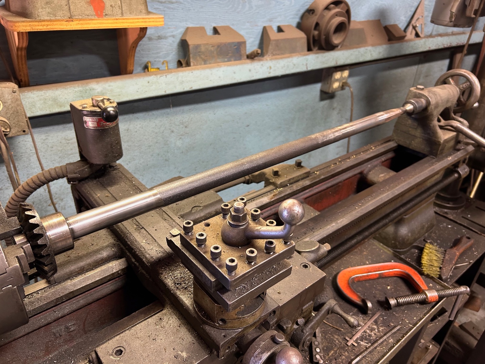

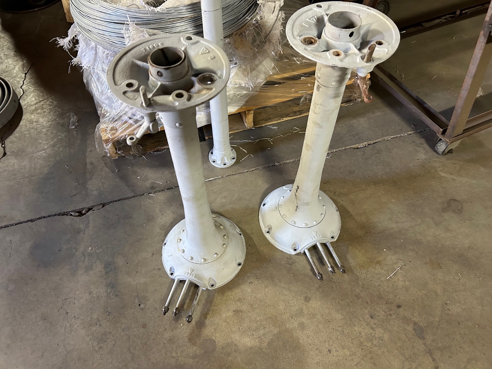

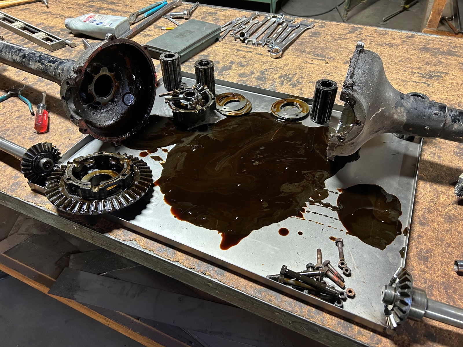

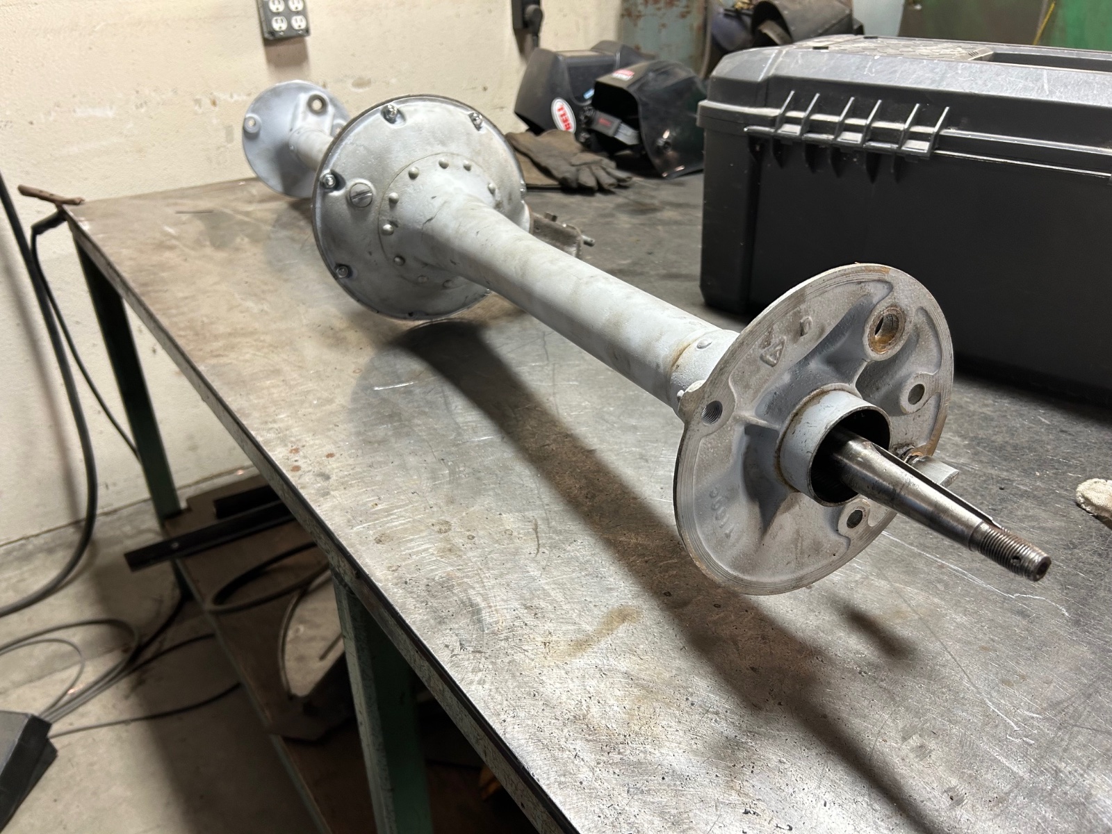

I have a pr. of housings, so I bought a donor rear end. Turns out the guts were very nice. Put tha axles in the lathe and arrow straight. Ring and pinion very nice also. Axles are centered, so no bent housings. The usual thrust washers and pins were replaced. I’m waiting for a driveshaft to set the pinion, but so far so good.

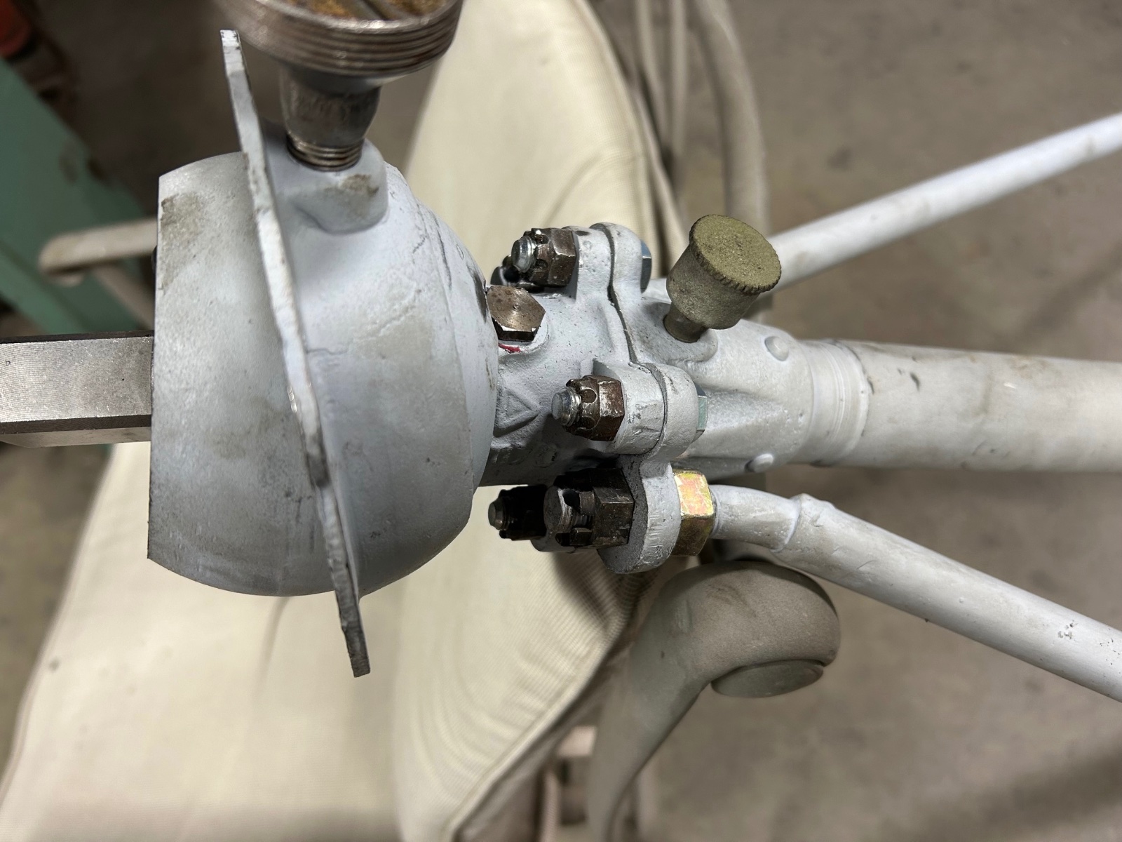

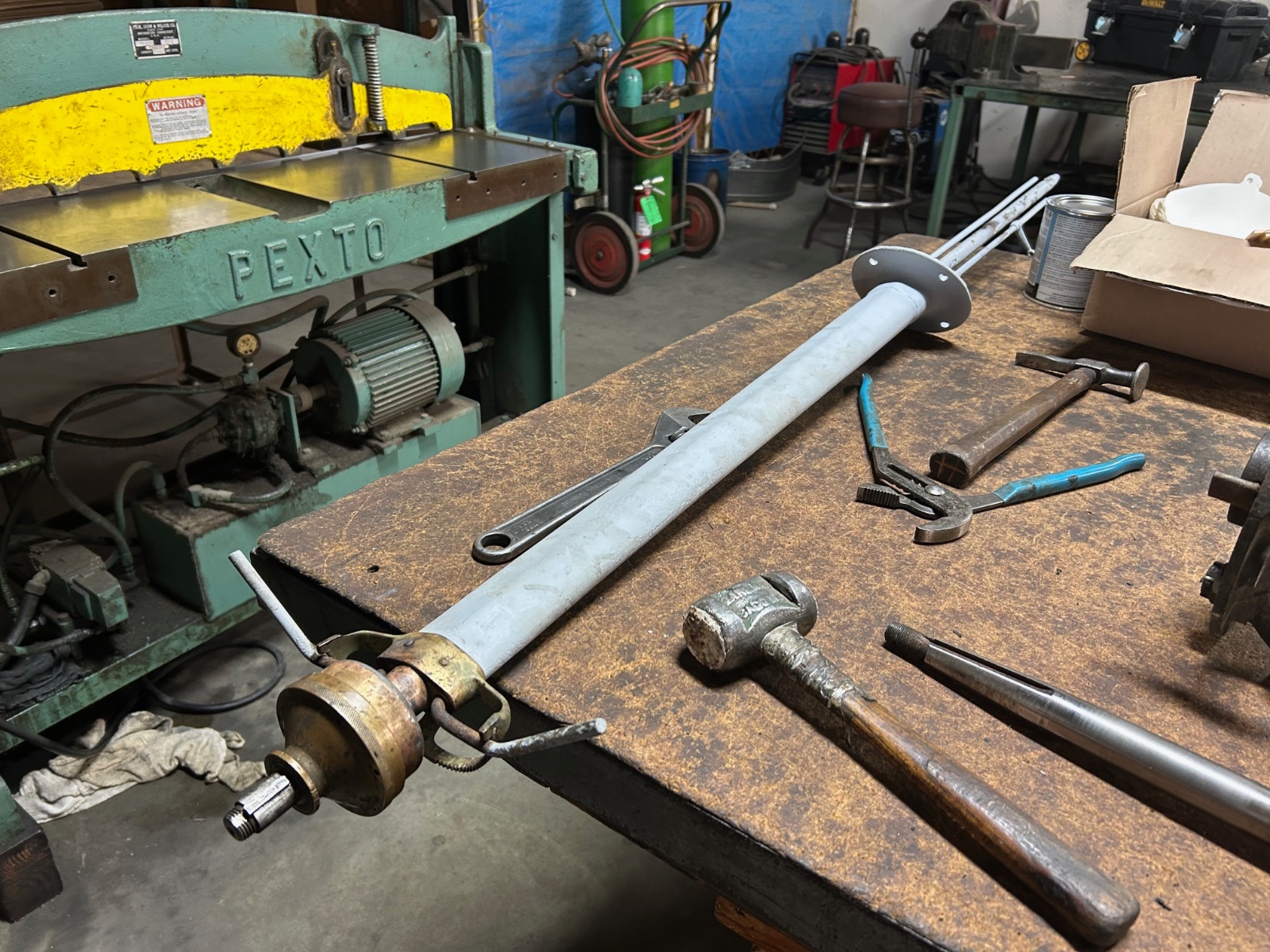

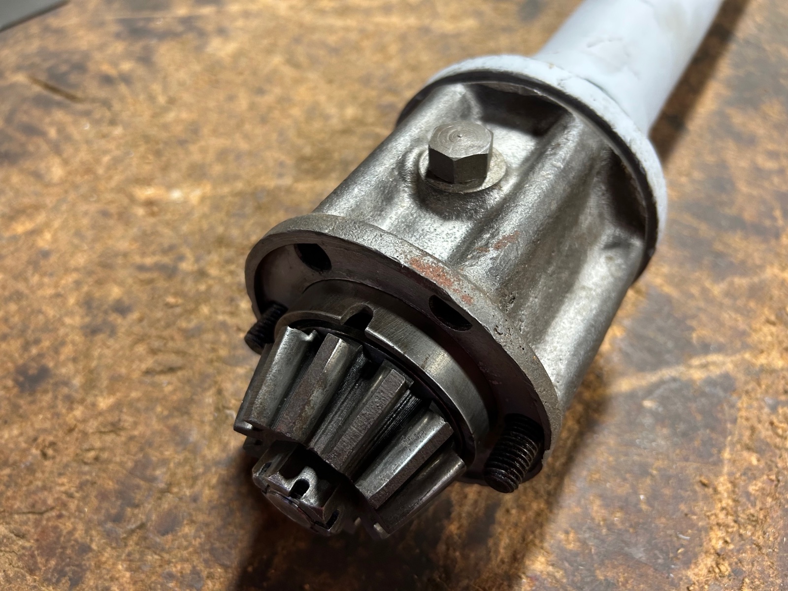

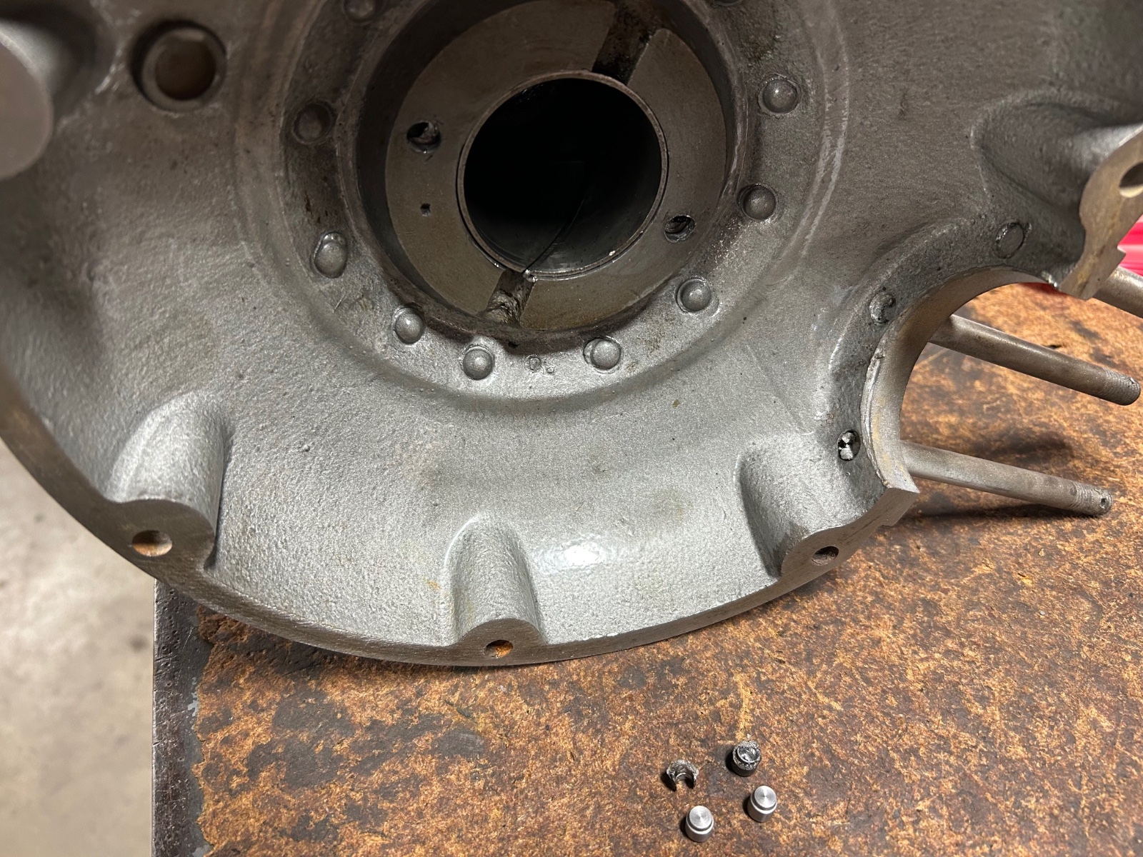

Torpedo column with a loose gear case on top, so I reset the rivets and silver soldered the joint. Now to clean the mess off.

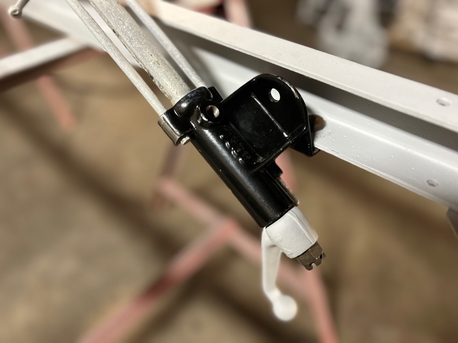

Cool, Tom.
Are those original torpedo dash brackets?

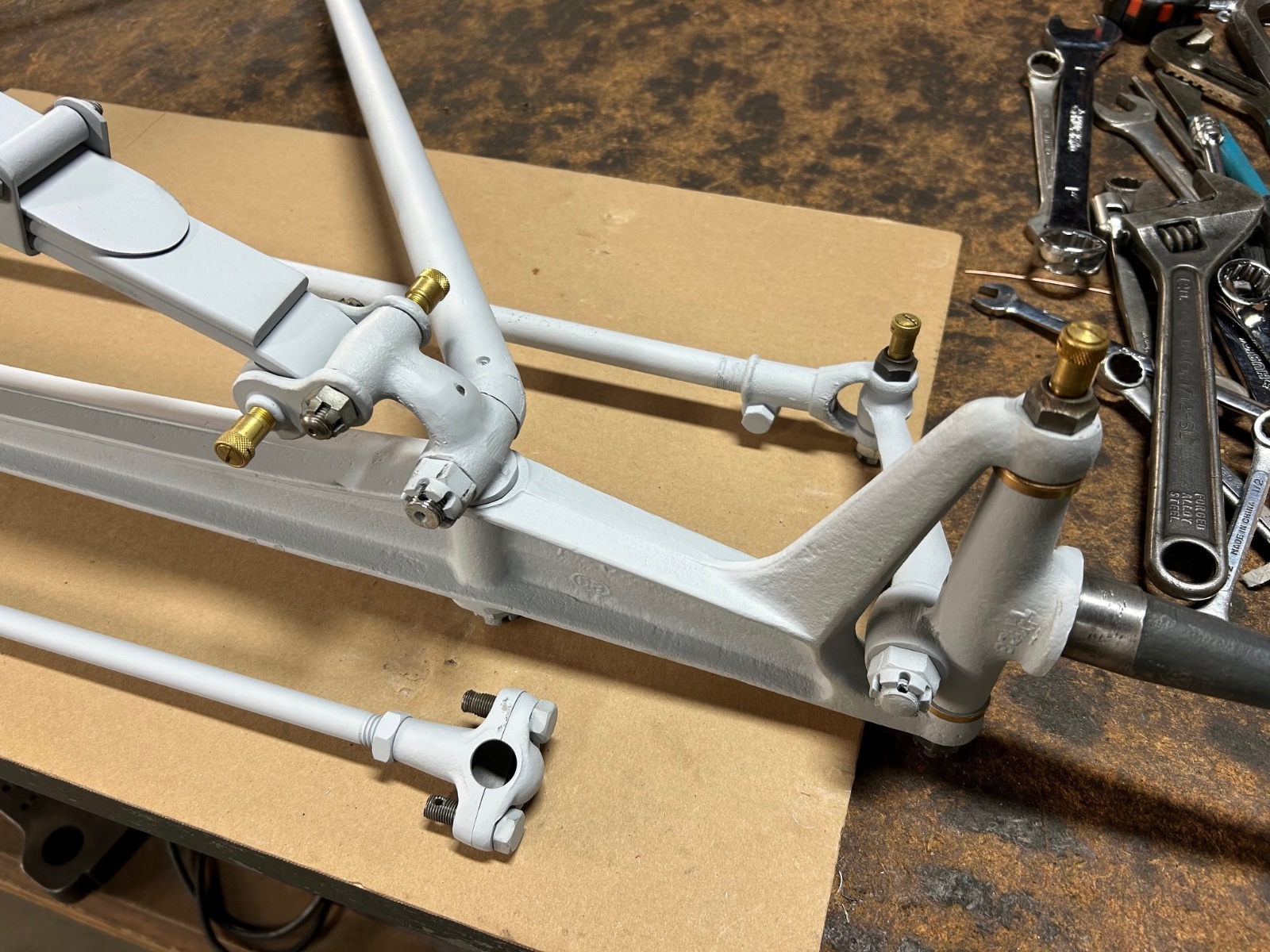

Thanks for the words of encouragement, they mean a lot from fellow builders. Jeff, I love machines that do stuff also. And Keith the brackets came from Tom Manochi probably 7 yrs. ago.
When I begin to gather parts I like to put together subassemblies to see if the parts fit, if there worn out and beyond repair and need replacing. If they are good I will sometimes rebuild pieces. Such is the case with the front end. I had it pretty much rebuilt but still rusty, so today I disassembled it.

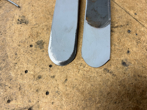

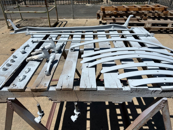

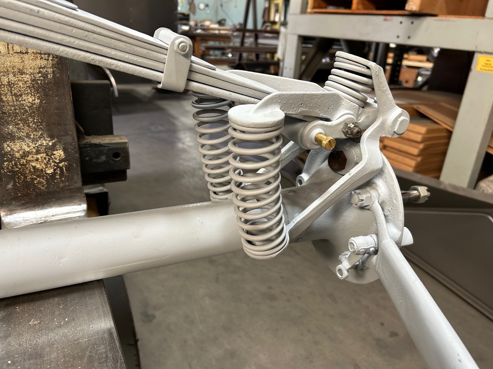

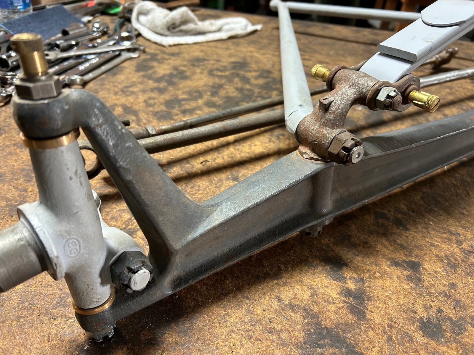

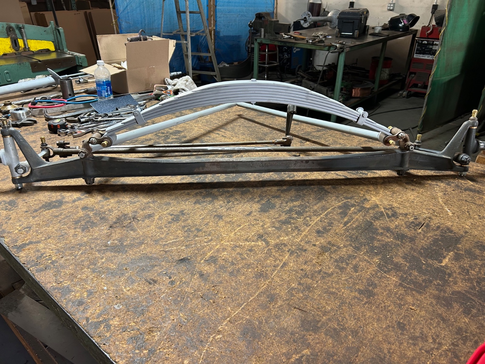

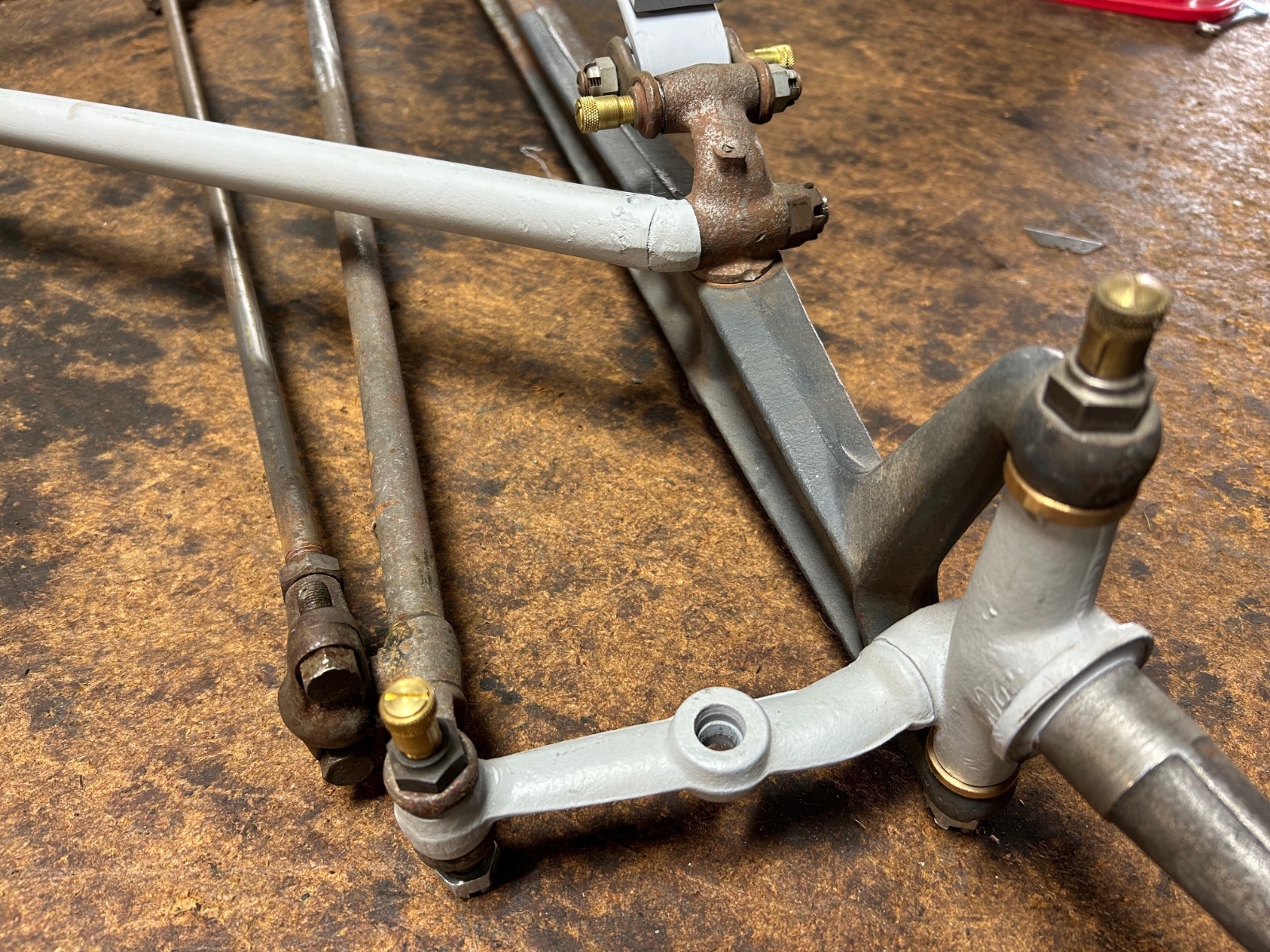

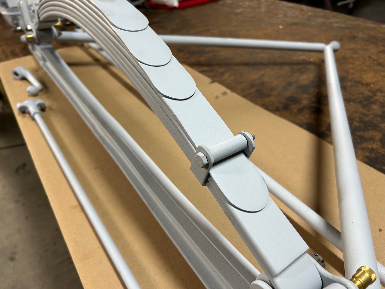

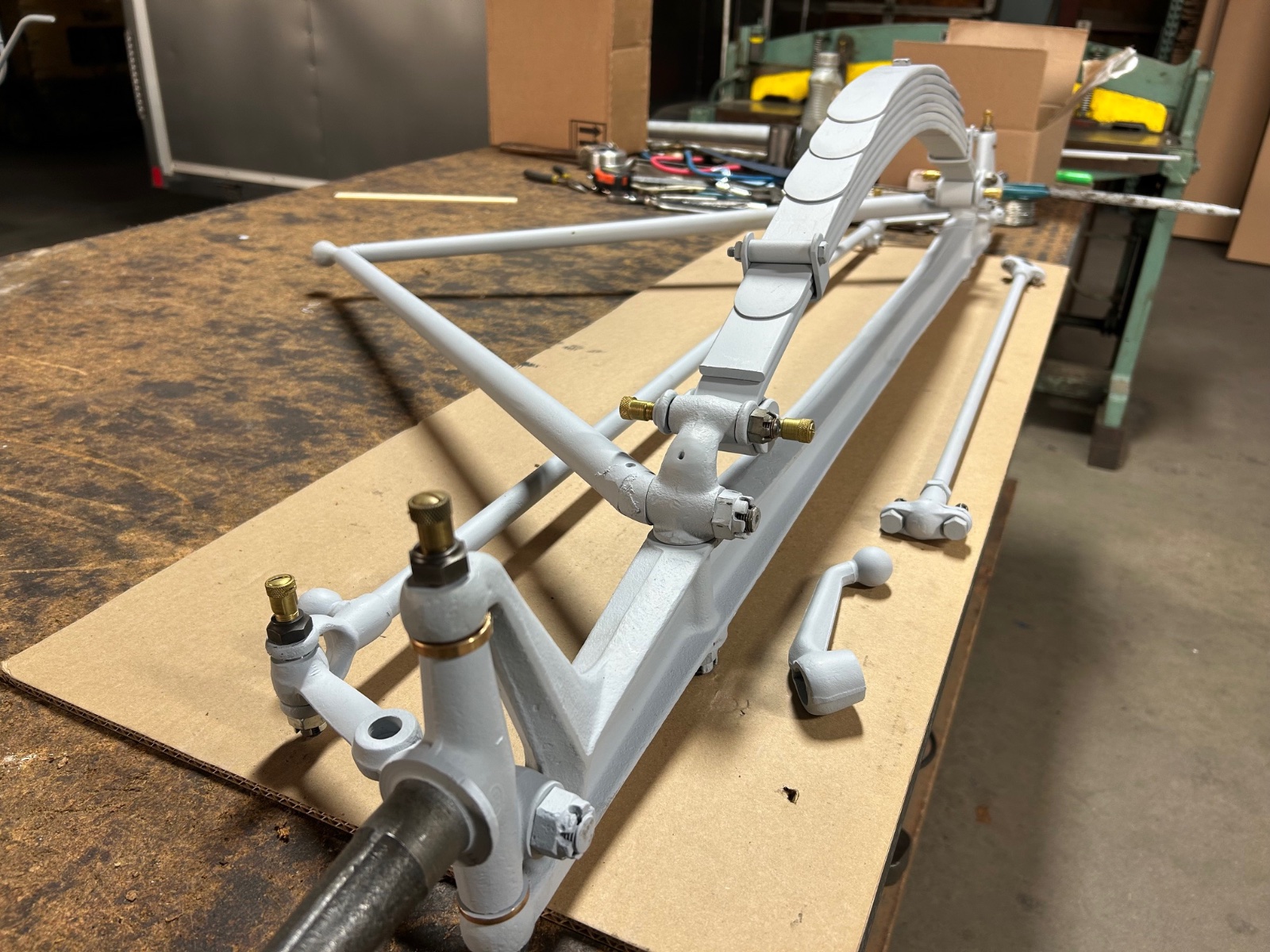

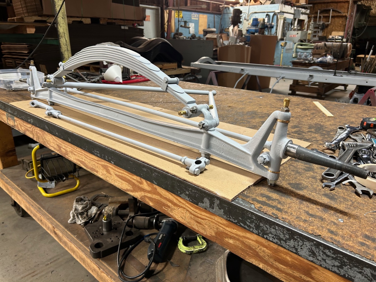

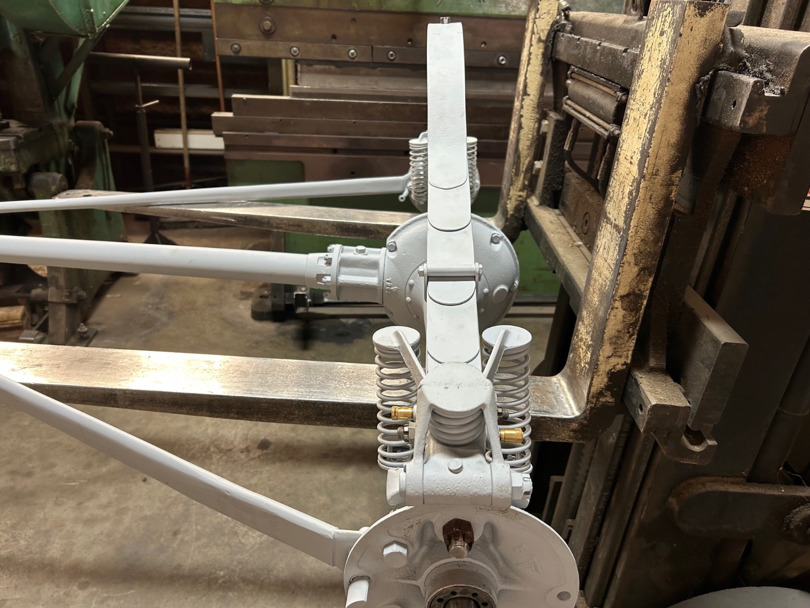

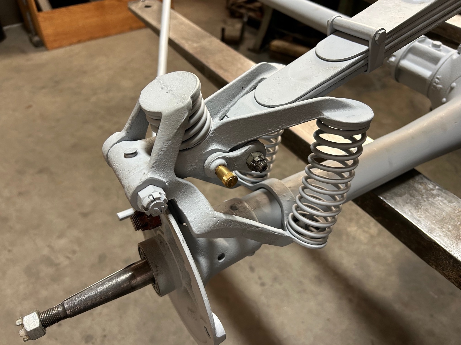

I used a new front spring and I didn’t care for the taper on the end of the leaves, so I reshaped and cleaned up the edges. Then took all the pieces to the sandblaster and then shot the parts with a sealer to keep them from rusting.
Posts: 3792
Re: New project.
Post by Dollisdad » Sat Jul 26, 2025 9:08 pm
Then reassemble the front end. Dry, no grease. It will come all apart for paint later and that’s when I will nit pick the finish on all the parts.

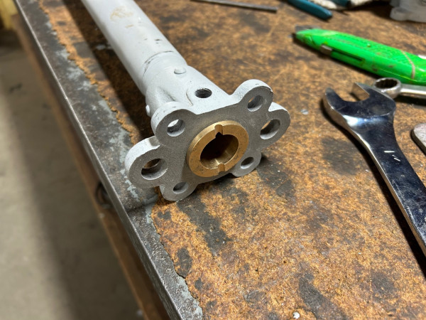

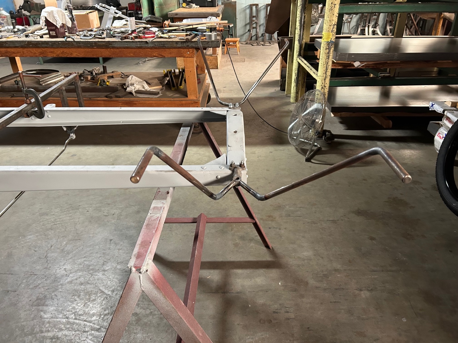

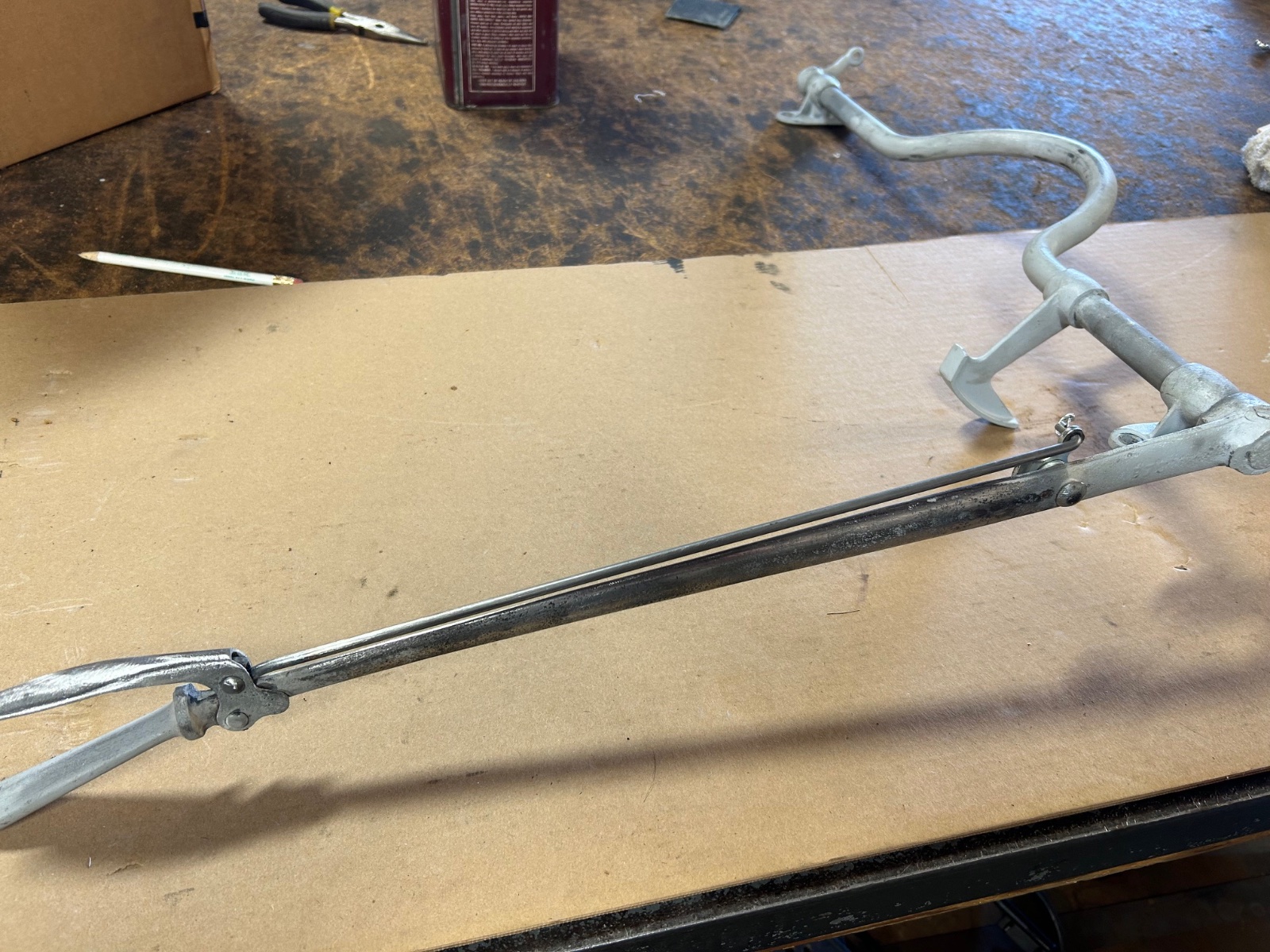

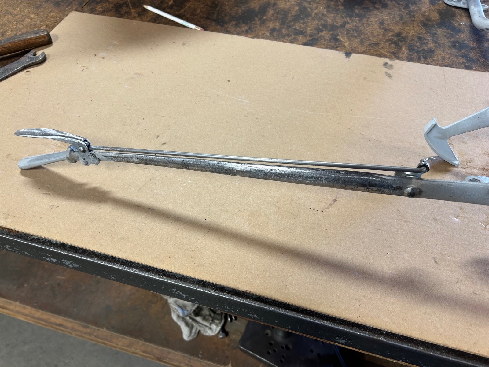

Put in new D/S collar bushing, while waiting for other parts.
Made new brake release rod after straightening hand brake lever.

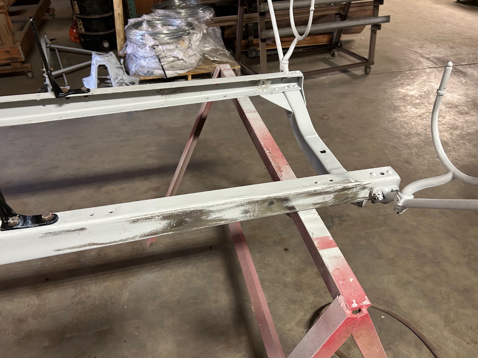

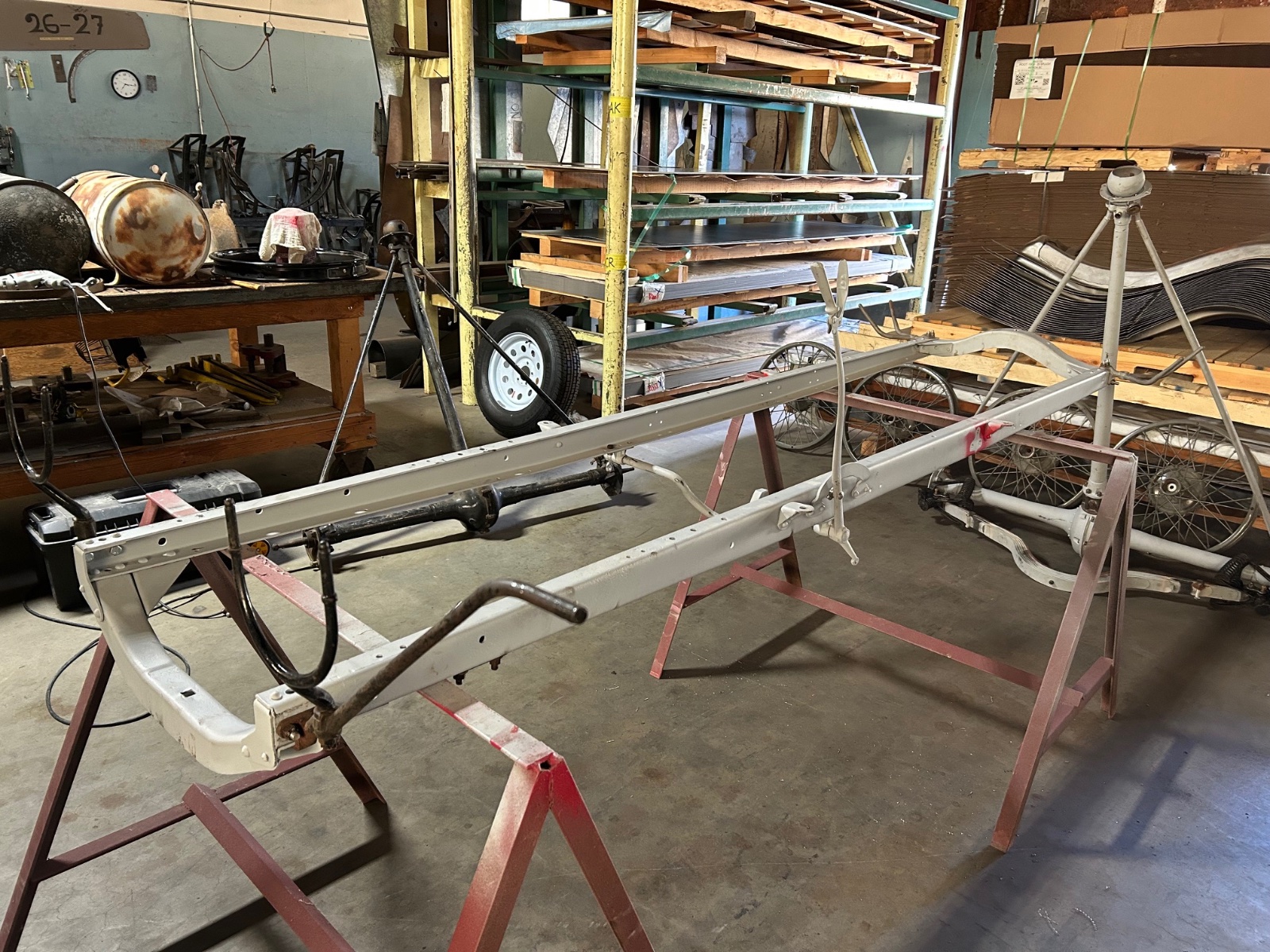

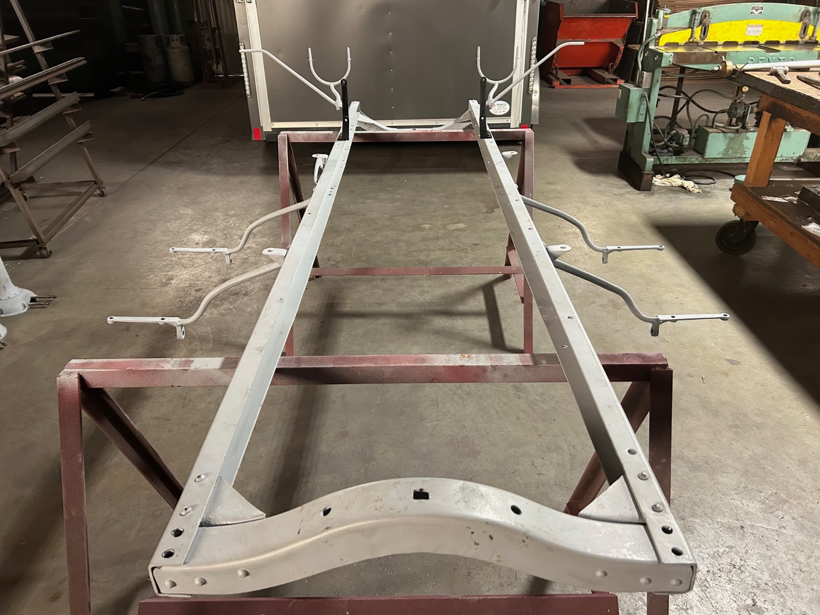

Post by Dollisdad » Wed Jul 30, 2025 5:56 pm

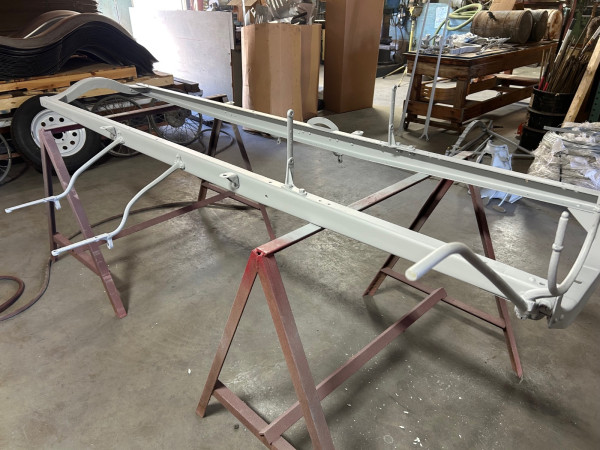

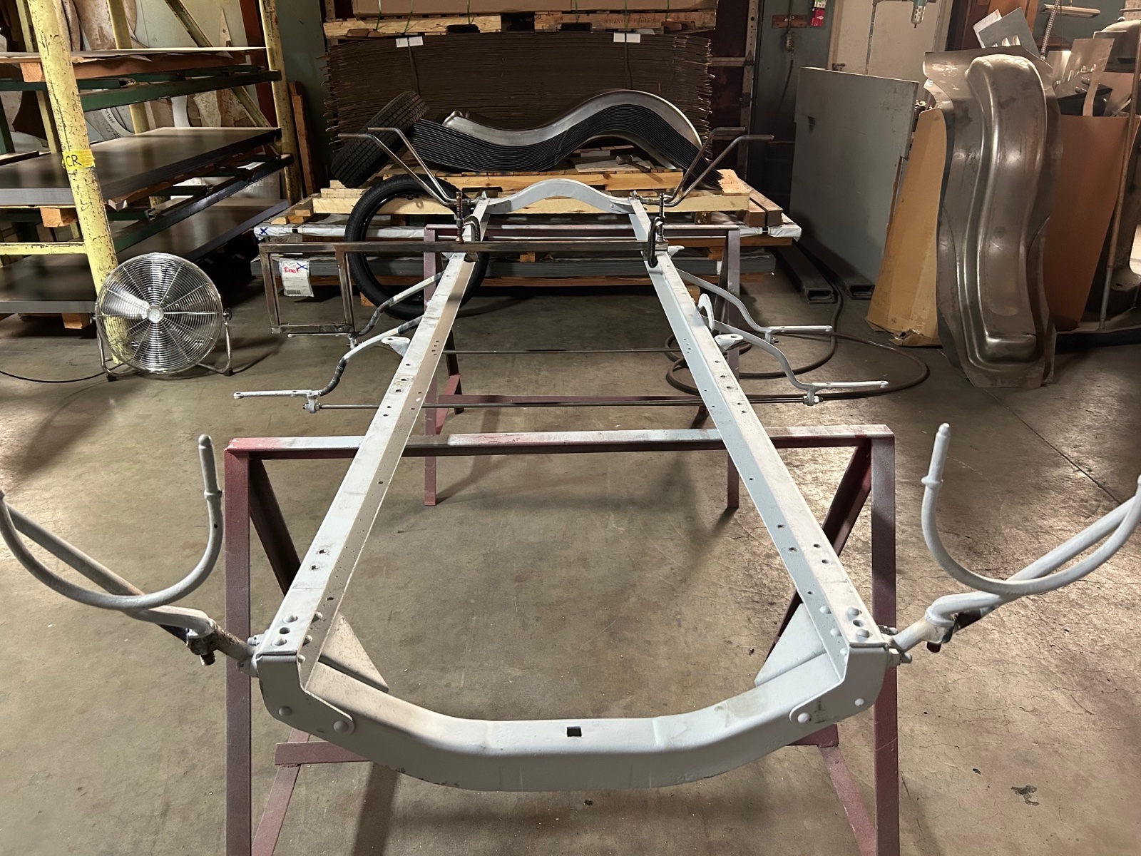

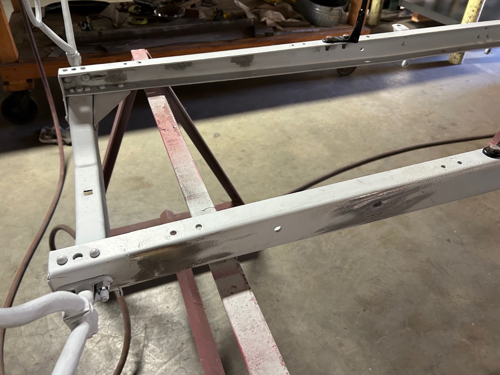

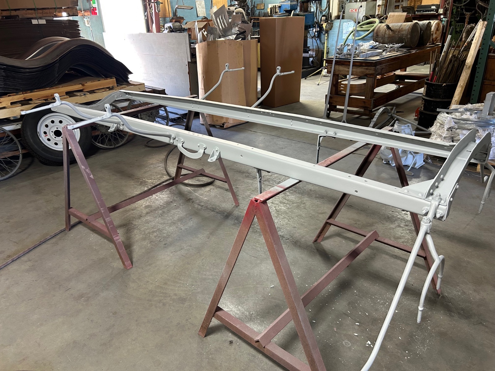

I think the frame was a farm trailer at some point. I welded up holes that shouldn’t be there.
Posts: 3792
Re: New project.
Post by Dollisdad » Sat Aug 02, 2025 6:51 pm
All holes welded up and finished off. Reprimed and ready to move along.

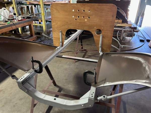

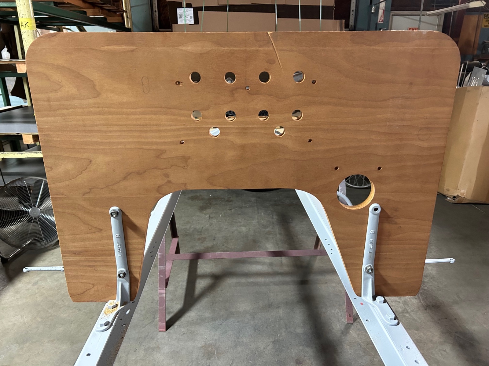

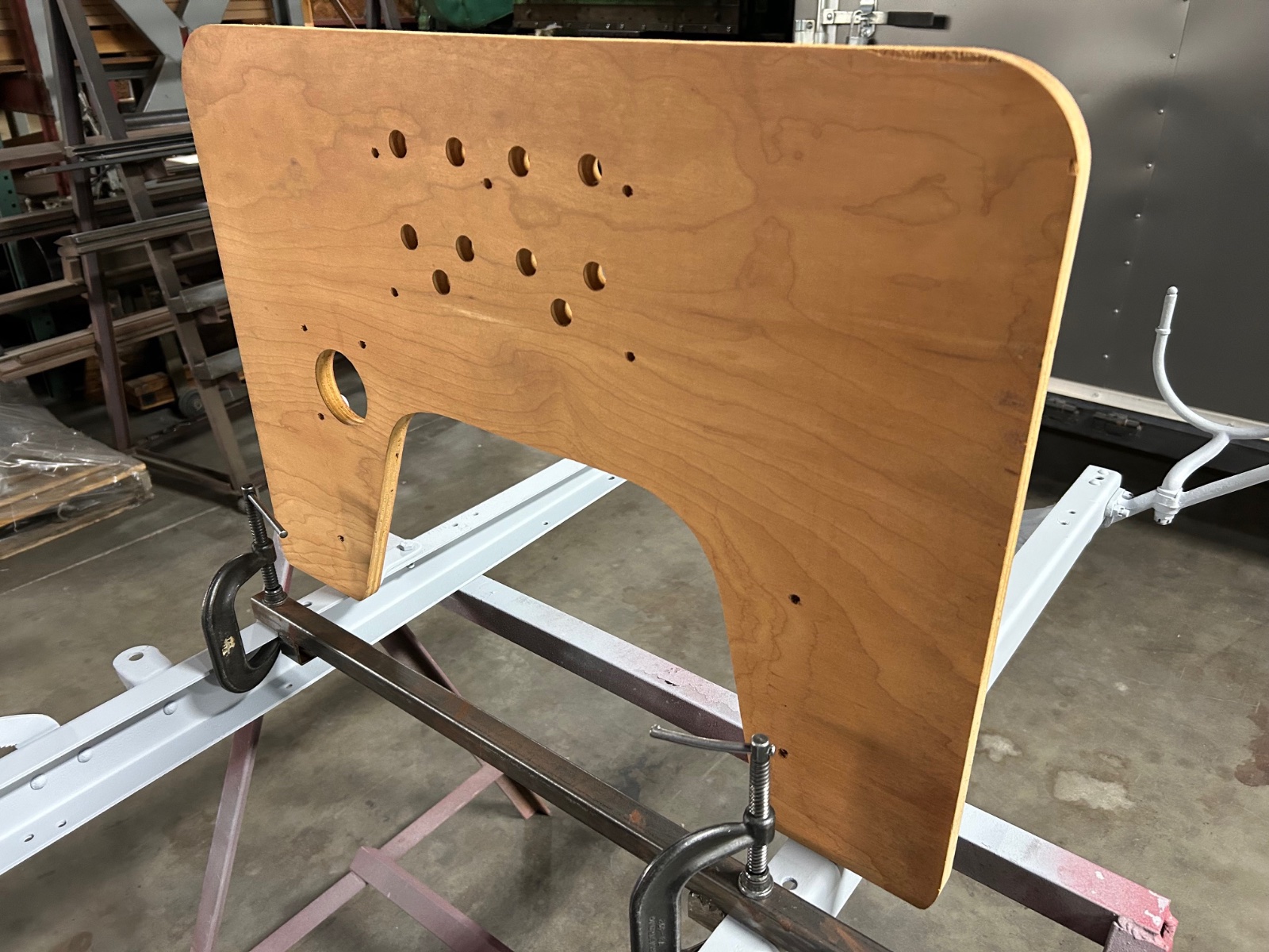

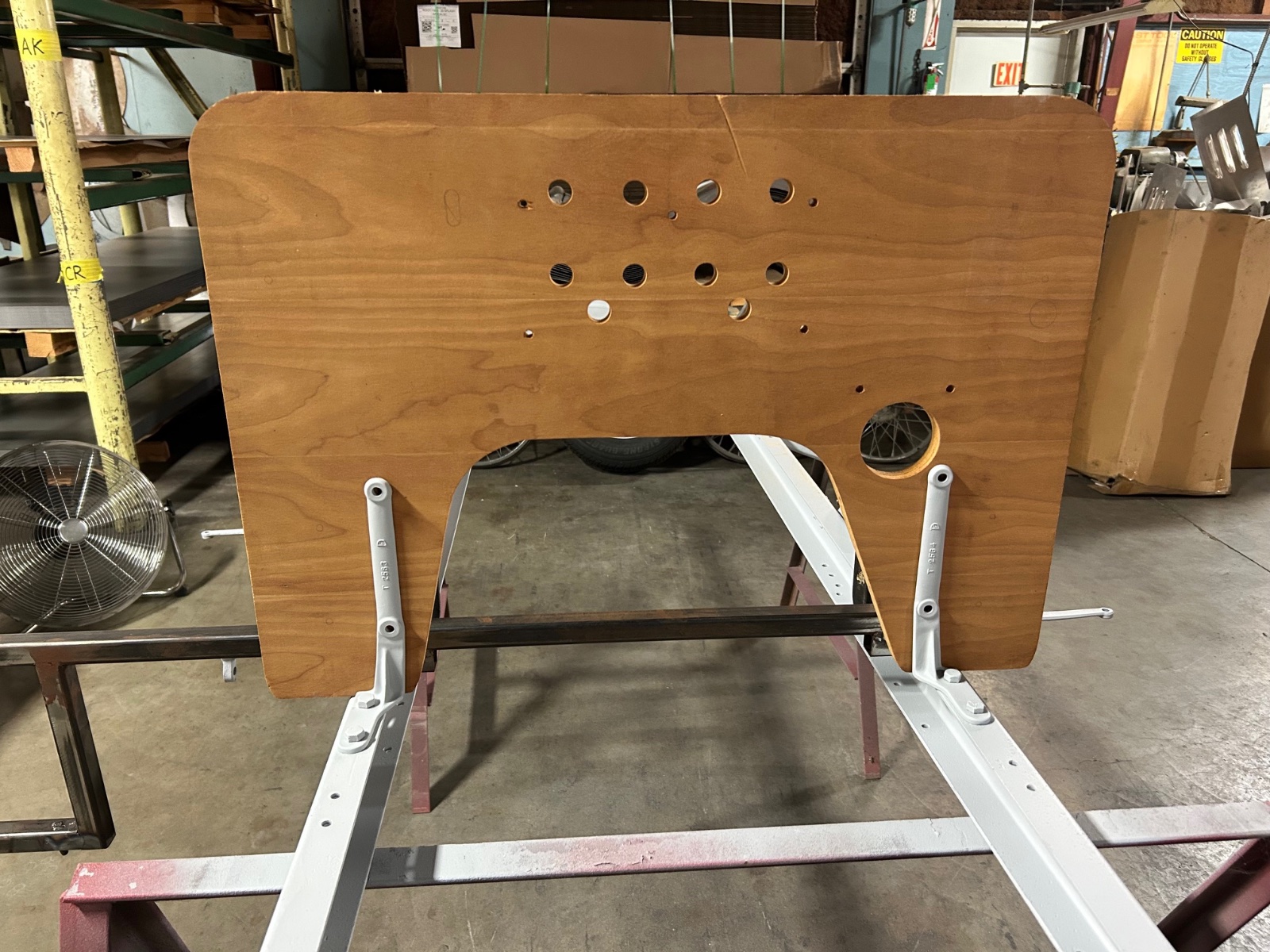

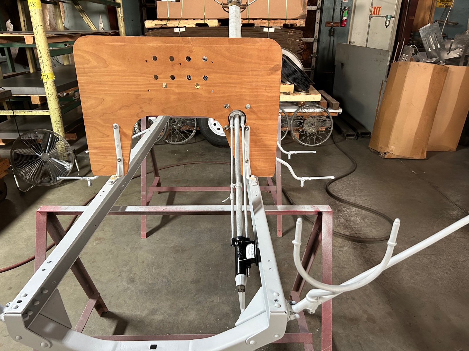

Found a Torpedo firewall in the wood shop. Looks to be a Seversons from 40 years ago. Some water stains that sanded off for the most part and a scare at the top that I think I can doctor. I used the r/b fixture to set the frame spacing ( 1/8” off ) and the pre drilled holes were very close.
Posts: 3792
Re: New project.
Post by Dollisdad » Sat Aug 02, 2025 7:17 pm

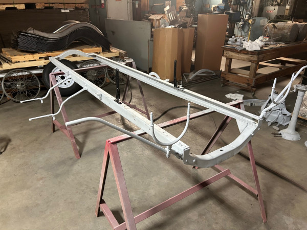

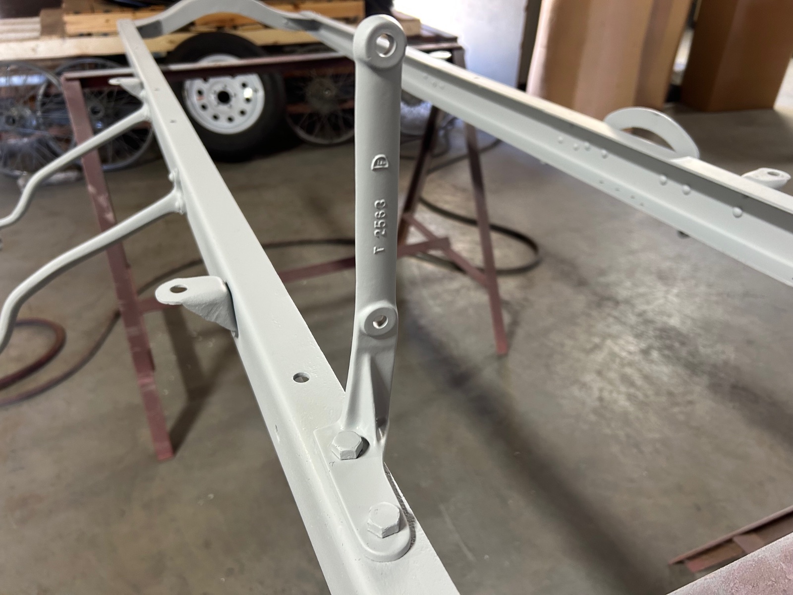

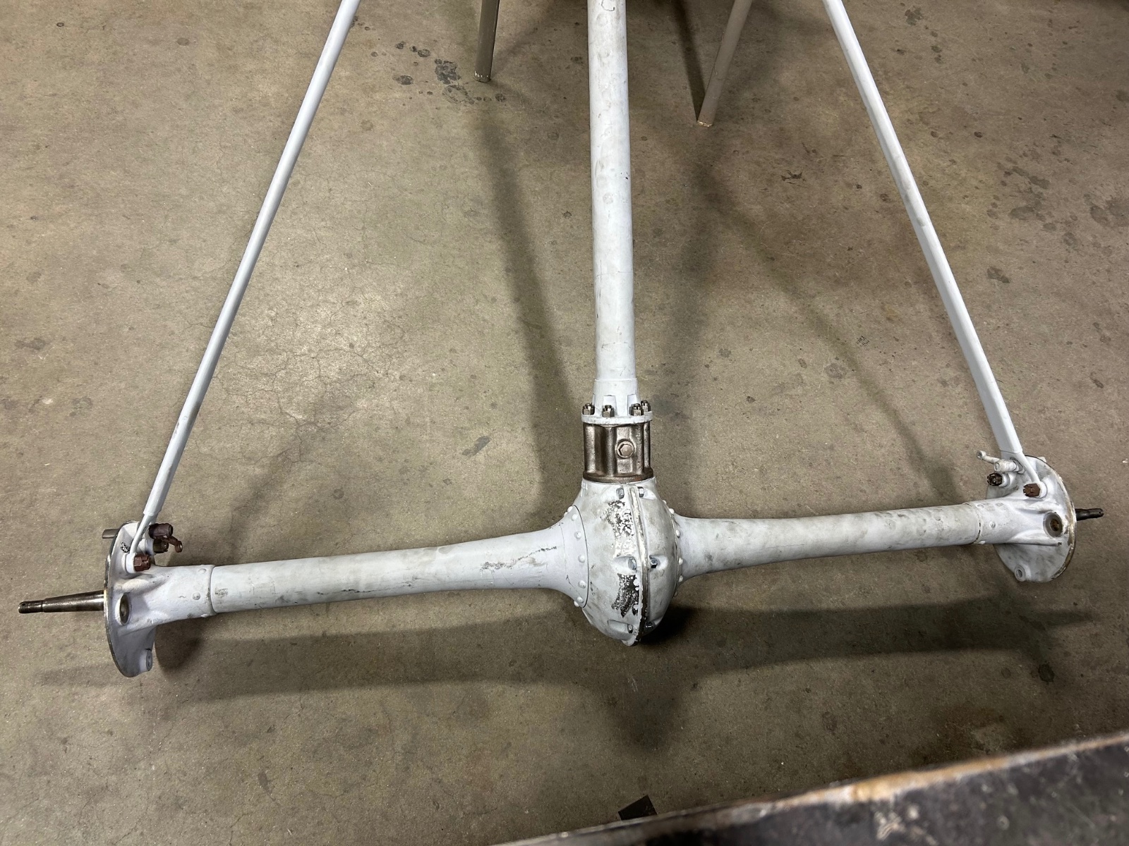

This keeps the top of the frame rails from flexing out or in. Now if I can just get the r/b truss rods I can start to mount the fenders and aprons. Then I can build the rest of the butterfly irons upward arms.

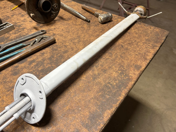

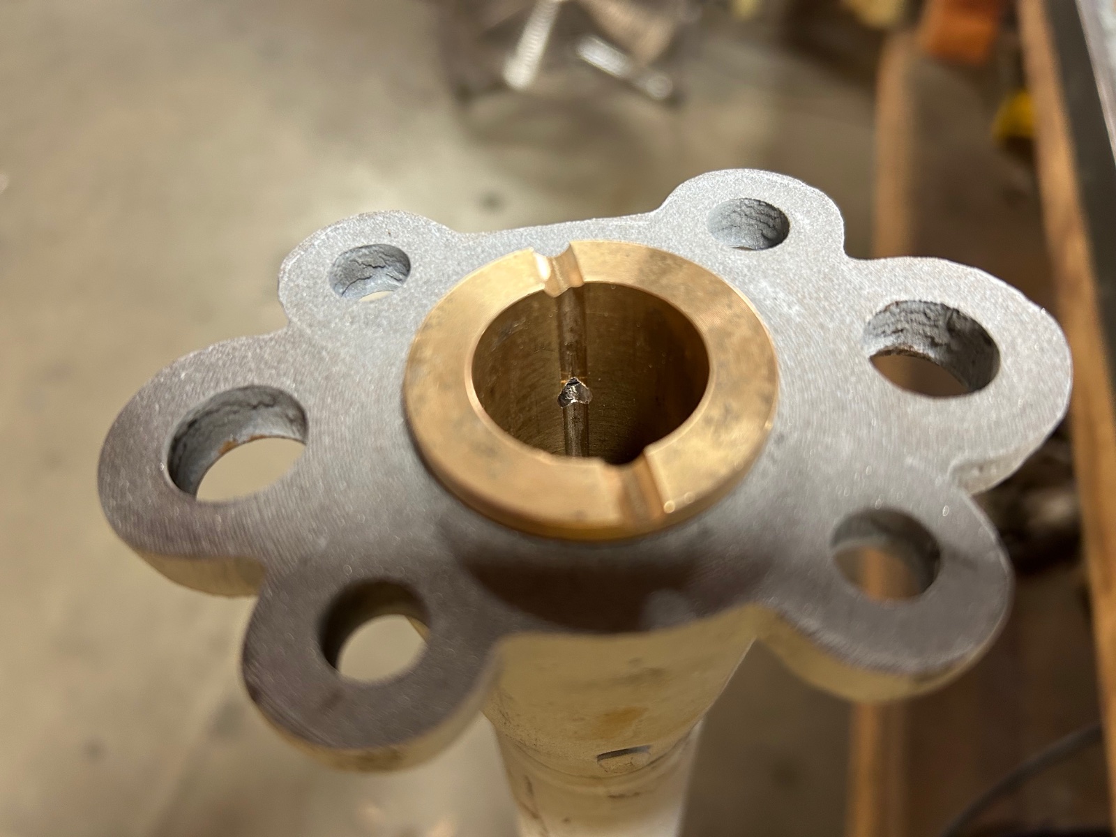

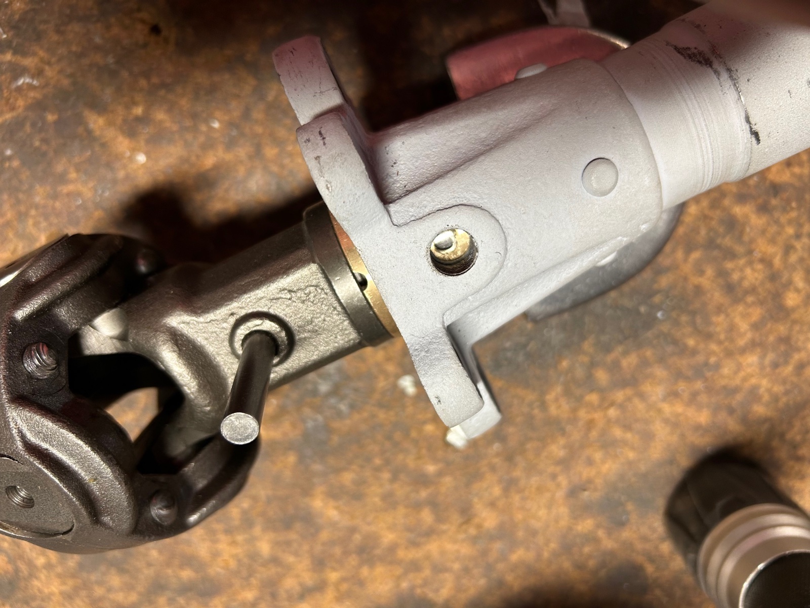

I got the bushing on the lower d/s. THE WORST JOB of this whole build. Fitting the U joint is simple. Put the axle back in the vice, split the halves, fit the pinion to the ring, removed the d/s. Siliconed the halves and bolted together leaving 4 front finger tight. Put the axle on the floor, siliconed the spool at the front and rear. Then dropped d/s over studs while guiding radius rods at top. Tighten everything up and wa-la . It is too heavy for me to lift so it will have to sit till Monday and the kids can put it back on the table.

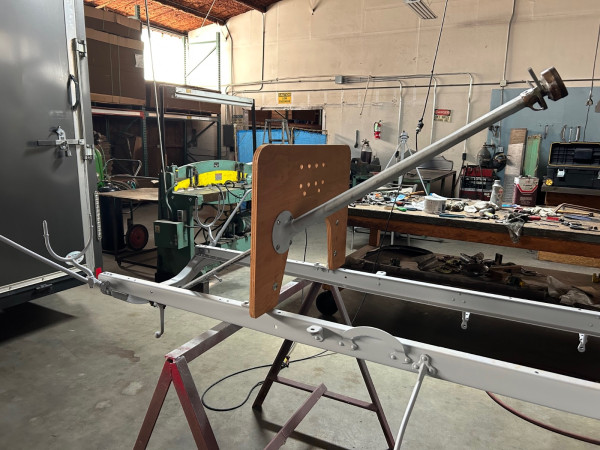

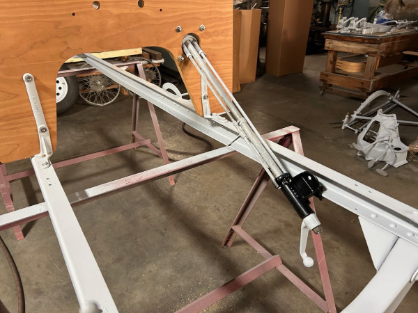

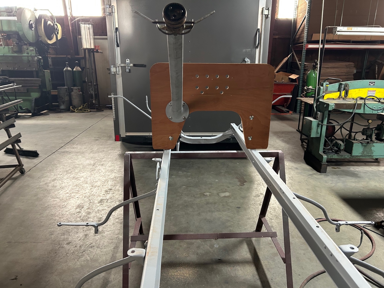

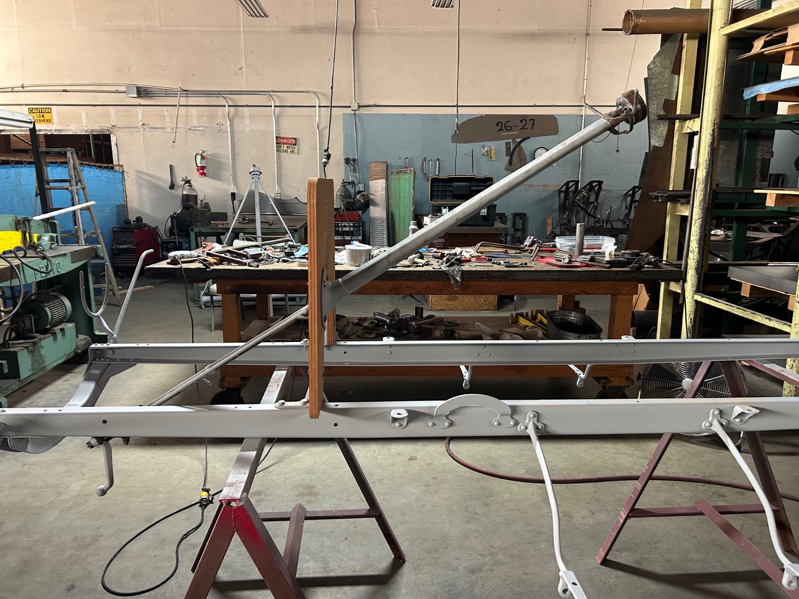

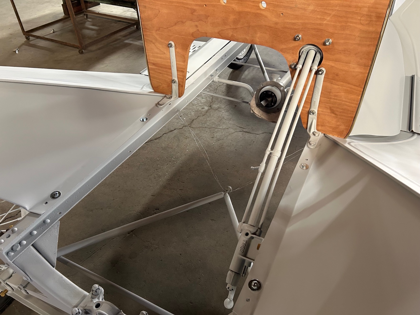

With the firewall in place I thought I might as well fit the steering gear in place. Center shaft was tight last 2” into housing, so I figured I got solder into the gear head opening. I’ll have to ream it when it comes back apart. Lower steering to frame bracket is another Tom Manochi piece. Fit beautiful.His parts are so nice.
Posts: 3792
Re: New project.
Post by Dollisdad » Sun Aug 03, 2025 2:35 pm
You really get a sense of how long the Torpedo column is when you step back and realize it’s length is more than half the length of the frame.

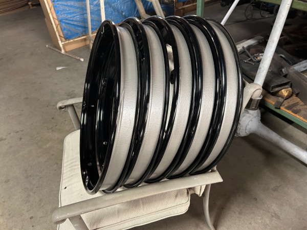

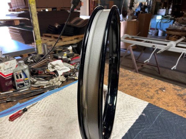

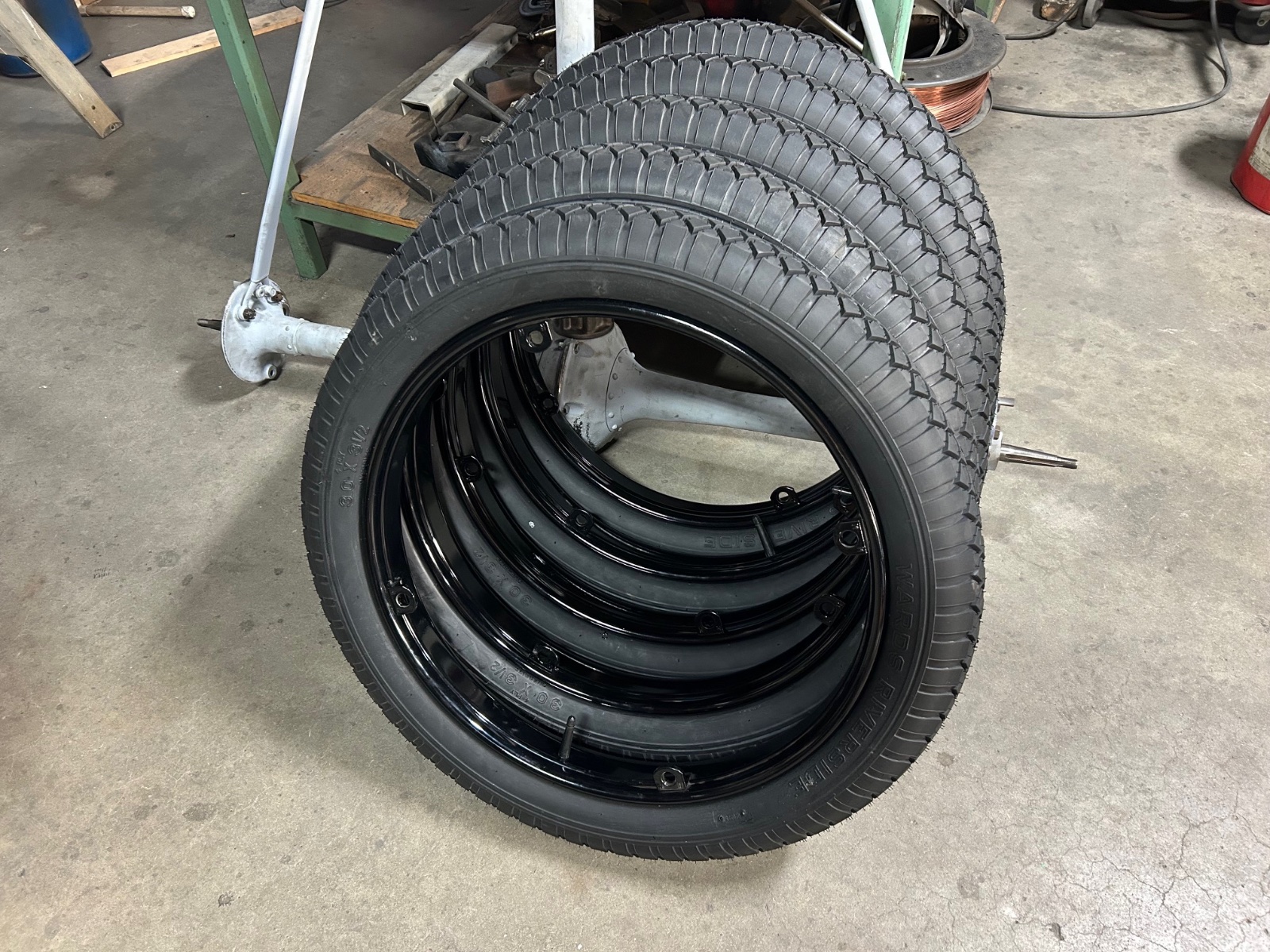

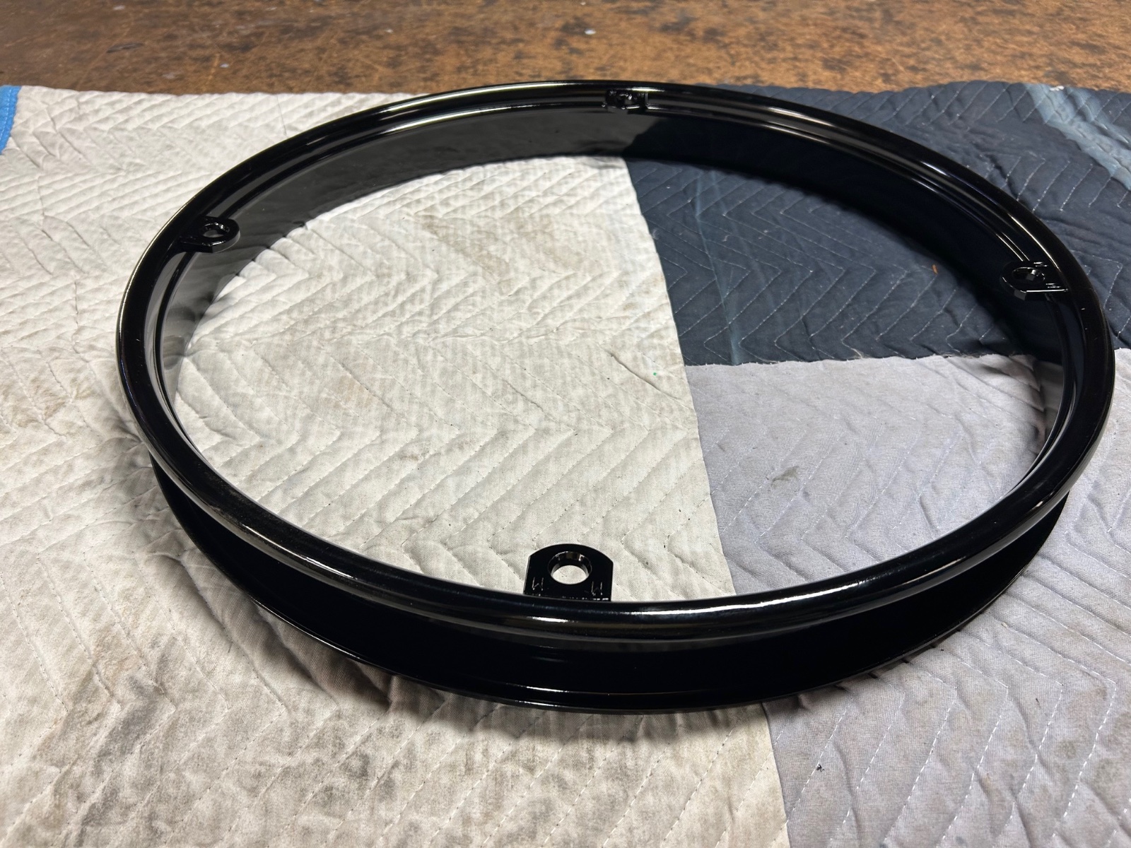

Thanks Art. Everyone’s favorite Sunday afternoon activity, mounting new tires. Some years ago I bought new rims, had them powder coated and stored away till now.
Was never a fan of flaps, so in the days before new rims I would wrap the inside with two layers of duct tape to keep the rough surface away from the tubes.
I guess old habits die hard.
The best part is when this is over. It helps setting them in the 95 degree heat to soften them up.

I have always liked the extra cushion you get from Float-A-Fords on the rear of a light bodied T, so I put them on this one.

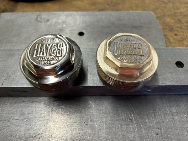

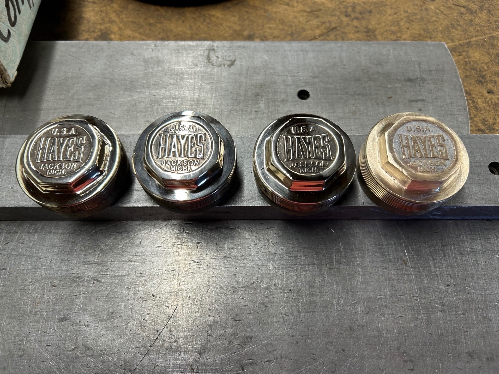

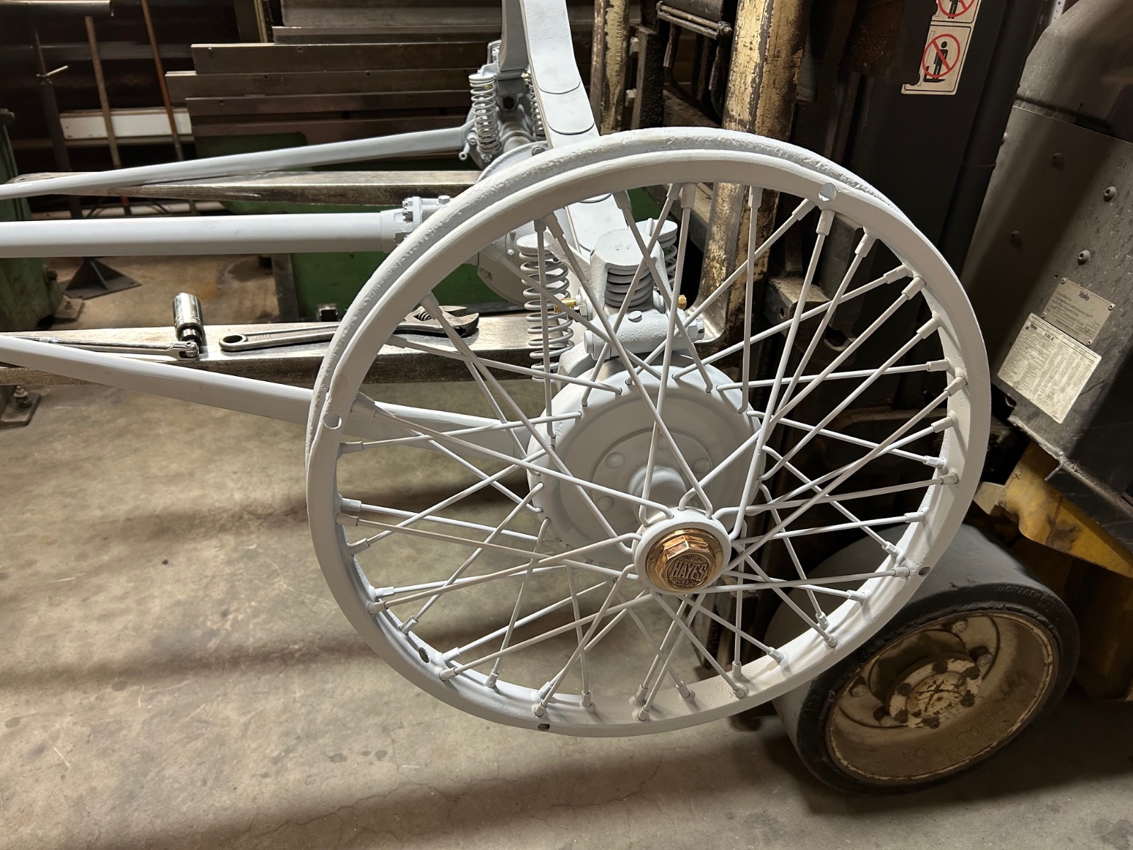

I picked up a set of Hayes Wire wheels from a fellow member on this forum. He was helping a widow sell surplus parts her husband had leftover. He said they looked pretty good, but didn’t really know anything about them. They looked to be in storage a long time. When I cleaned them I discovered they had been respoked and trued. They also came with a set of repo cast hubcaps, so I debured and polished them.

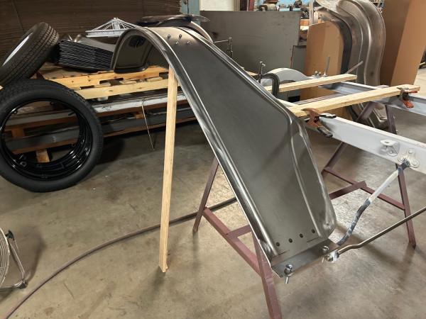

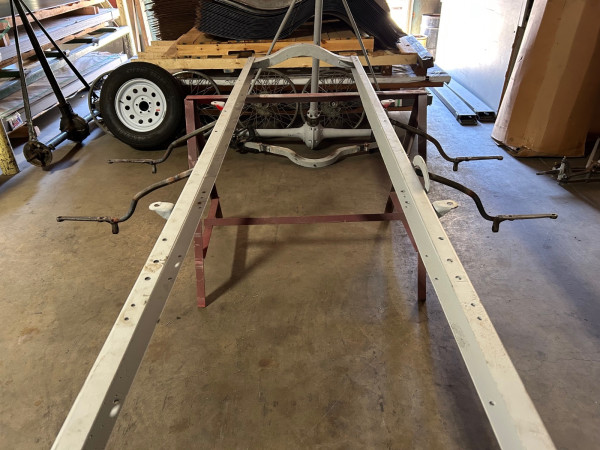

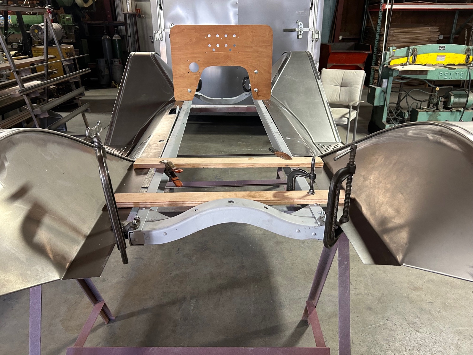

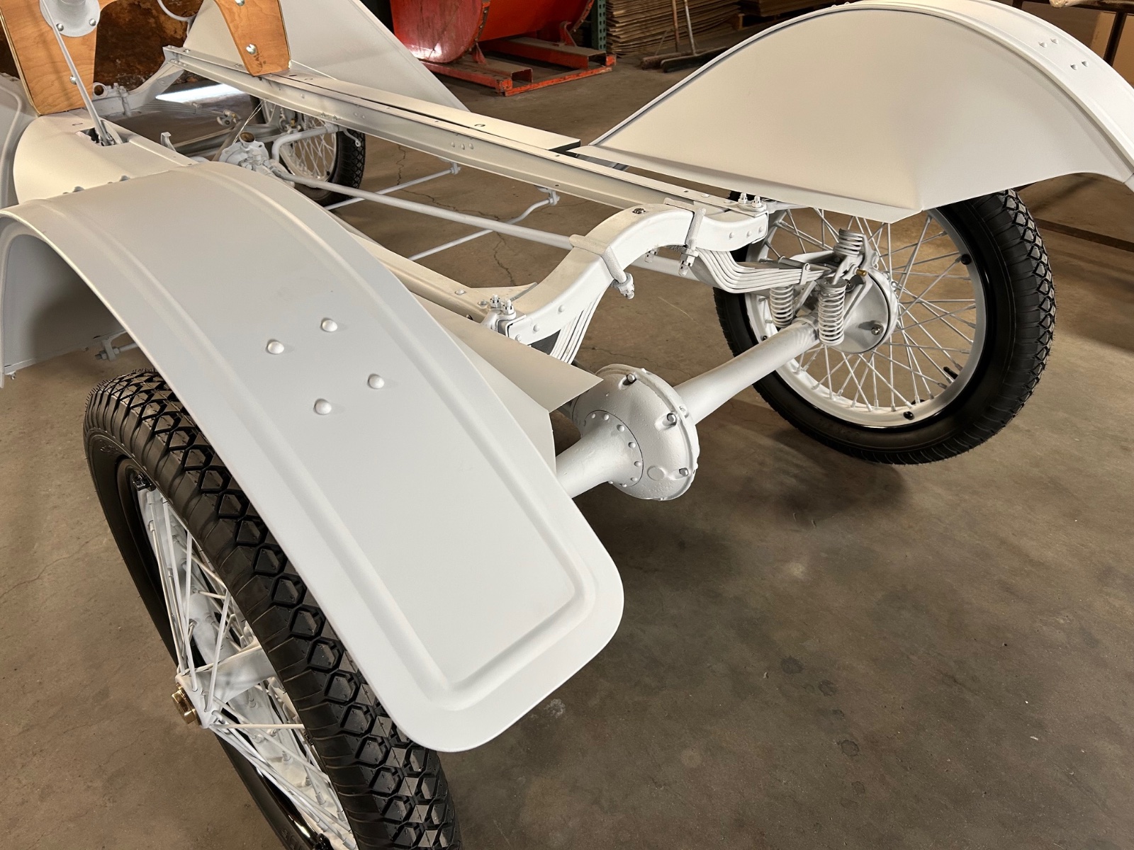

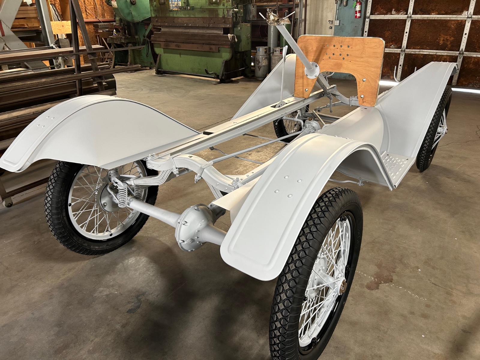

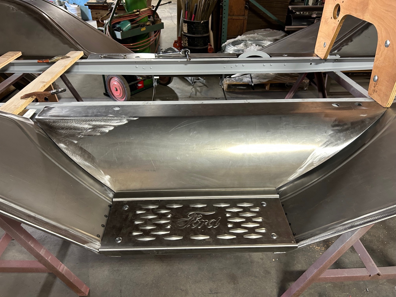

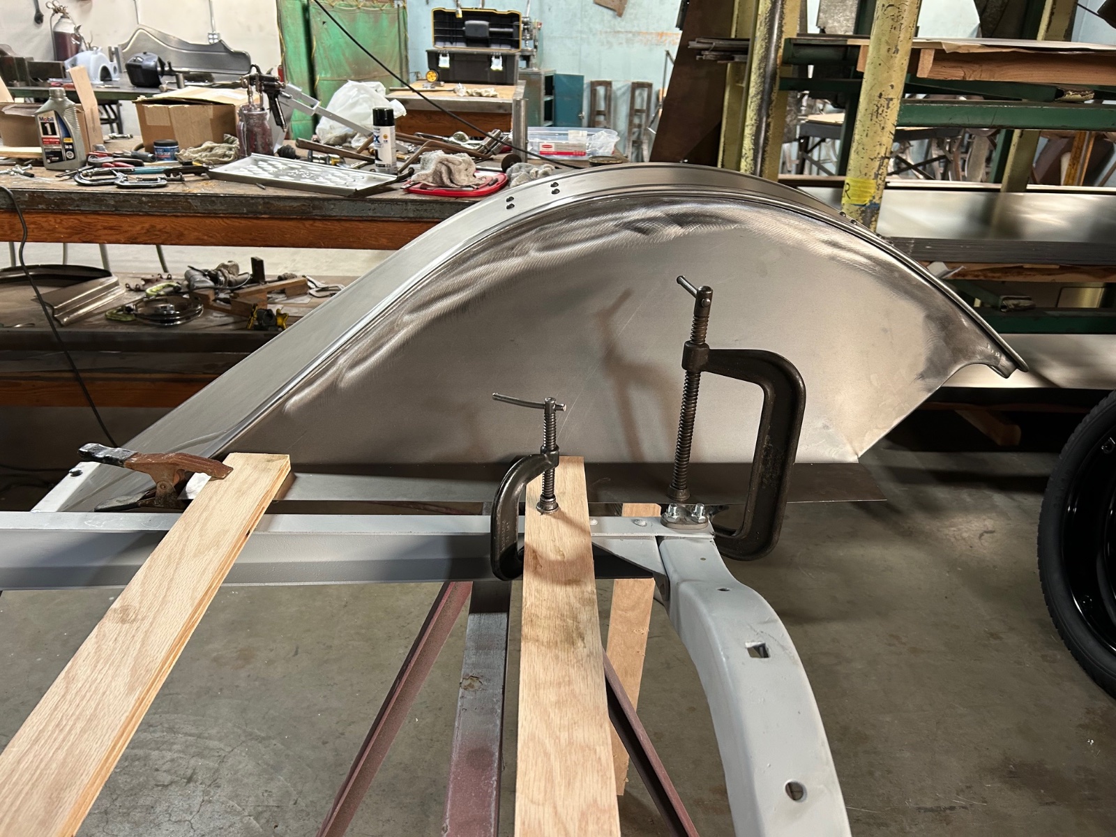

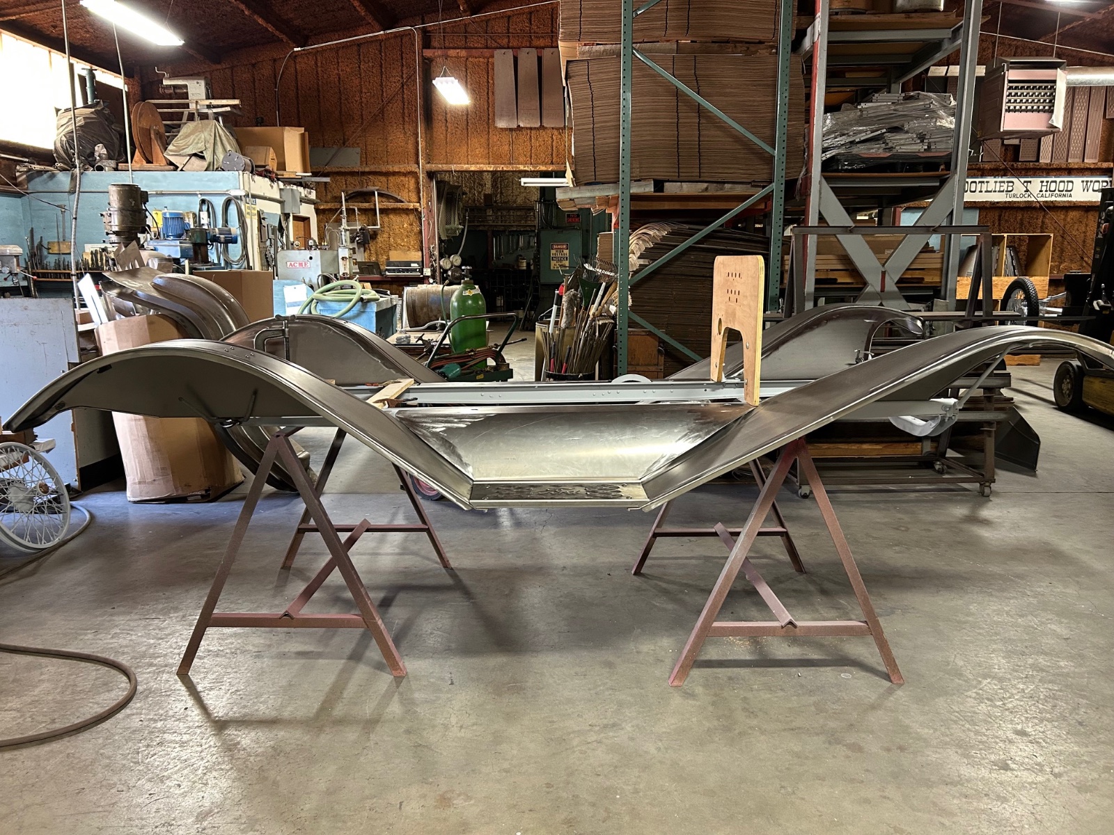

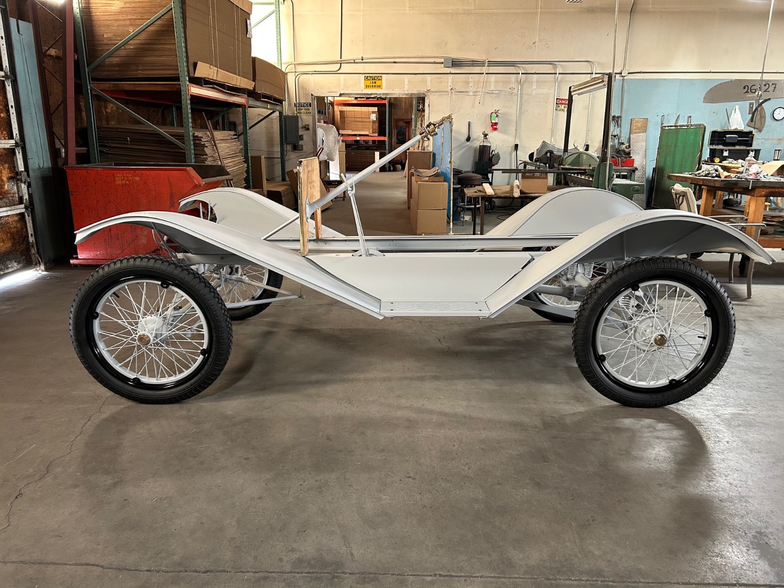

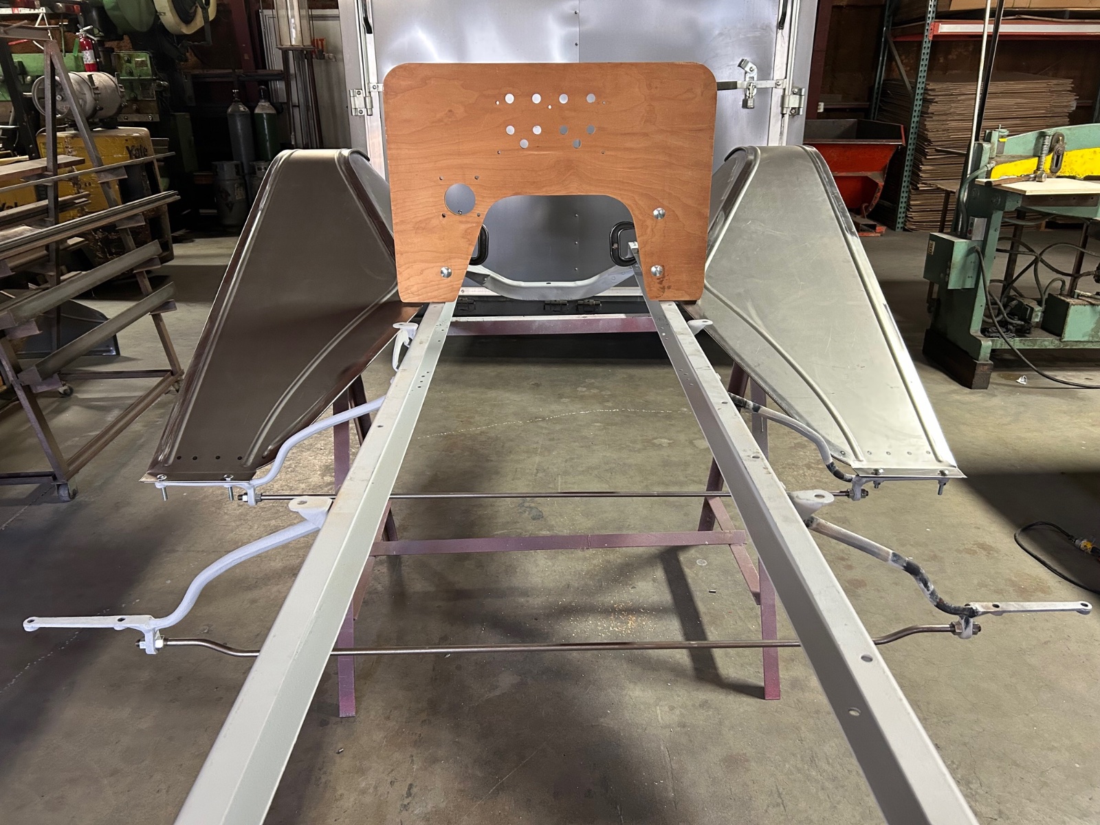

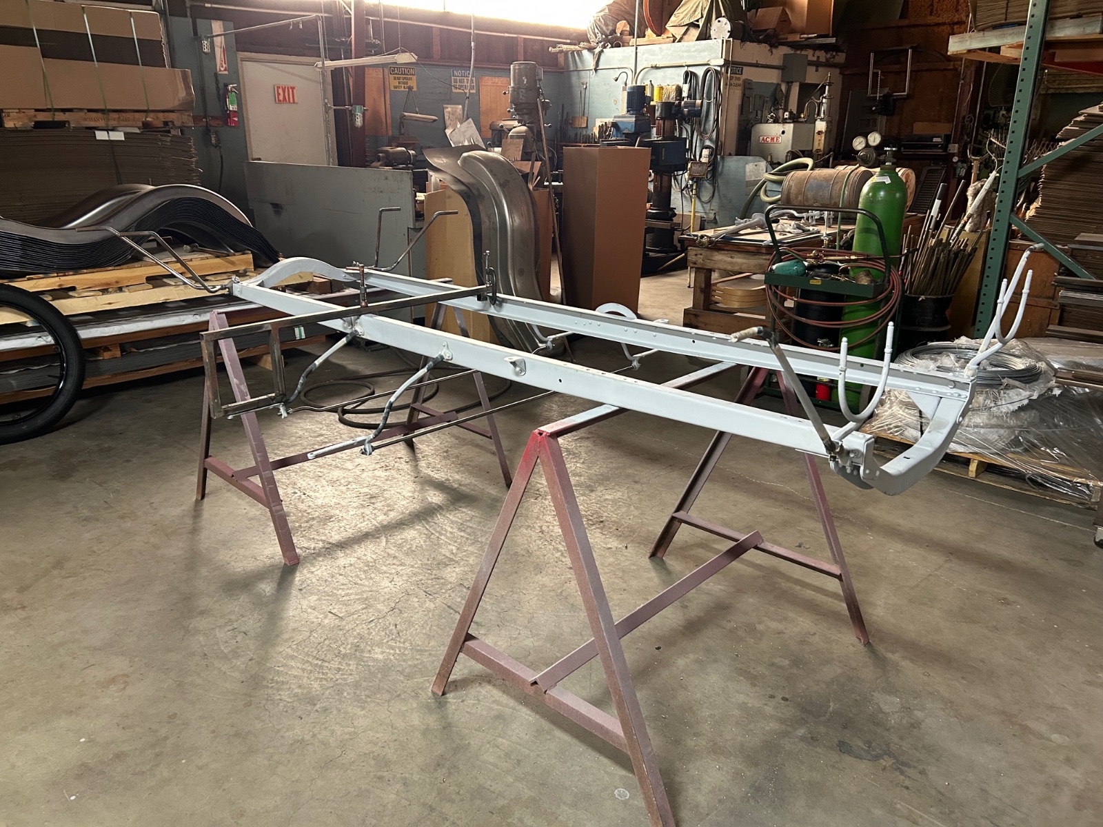

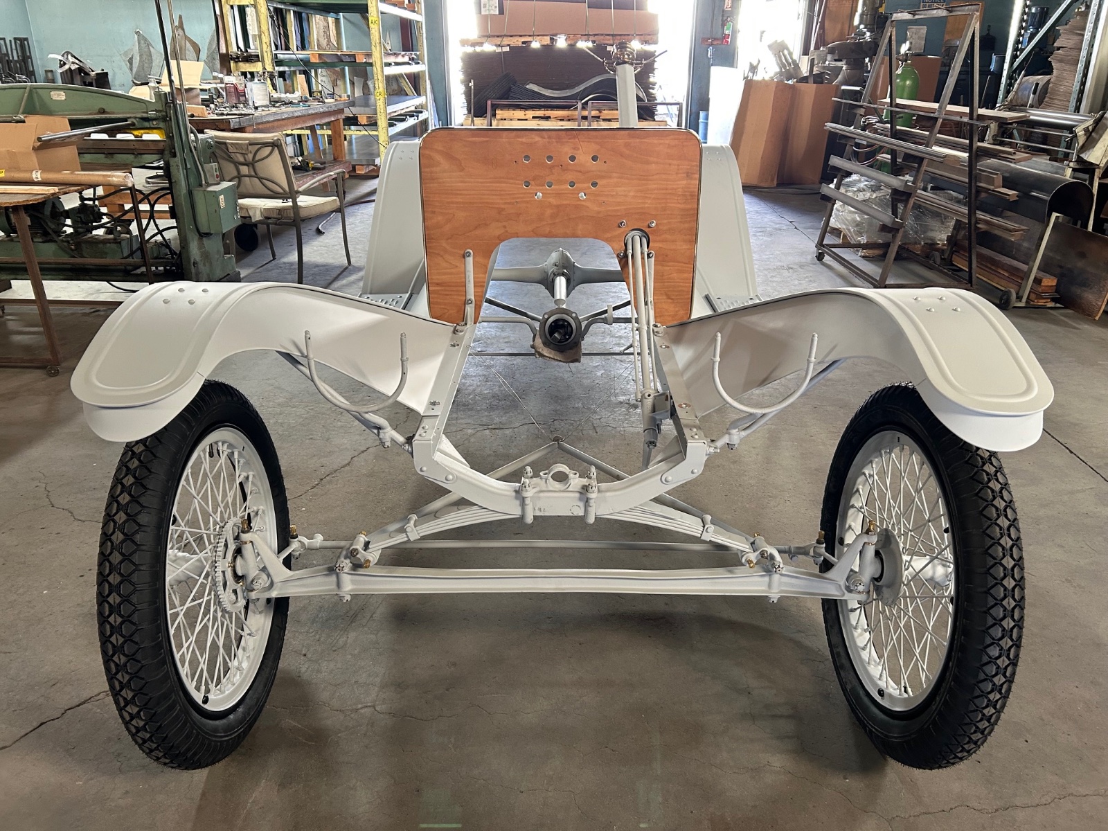

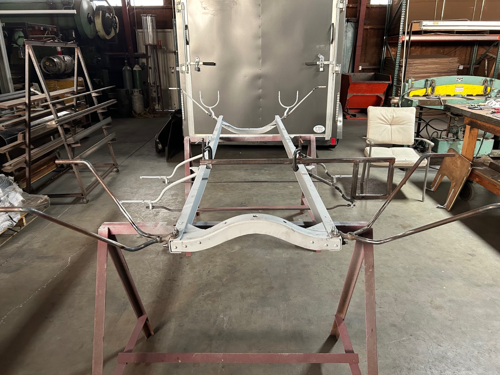

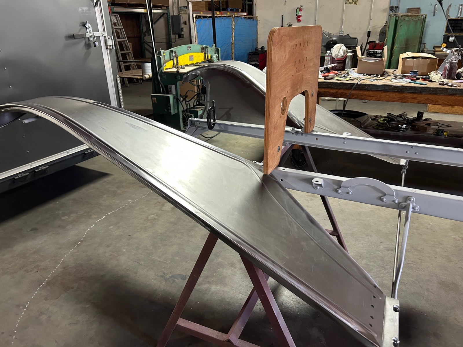

So finally starting to fit sheetmetal. Discovered the left frame rail was a 1/4” ahead of the right one, so we placed the frame catty-wampus between a 100 ton press brake and a forklift and with a few nudges we were back in square. The firewall has to be square or nothing fits.I will have to go back and check the running board brackets as well. But starting at the front, everything looks good.
Posts: 3792
Re: New project.
Post by Dollisdad » Sat Aug 09, 2025 5:18 pm

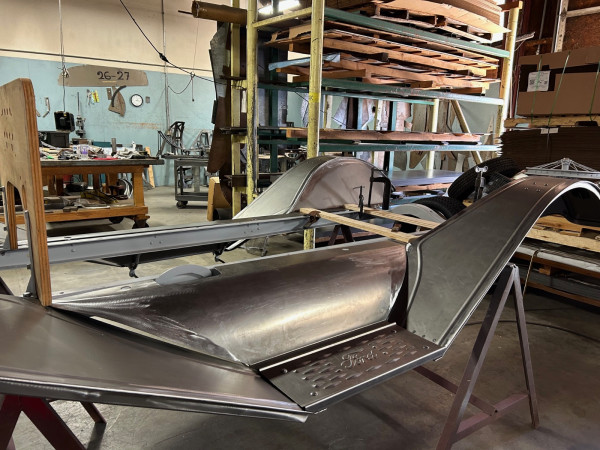

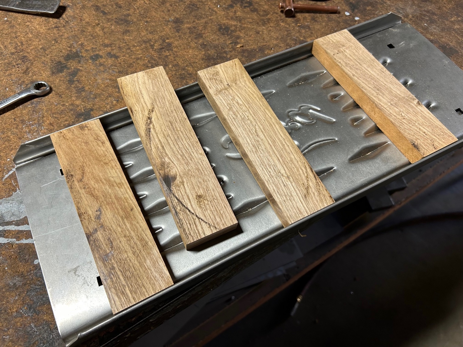

Then prop a rear fender into position. Then cut the running board blocks and drill them.
Posts: 3792
Re: New project.
Post by Dollisdad » Sat Aug 09, 2025 5:27 pm
With both rear fenders propped up and pre drilled for the running boards, you can put the running boards in position sandwiching the apron tail between the fender tab and the woodblock. They will come off and on half a dozen times for reshaping before they will sit fairly good.
Posts: 3792
Re: New project.
Post by Dollisdad » Sat Aug 09, 2025 5:37 pm

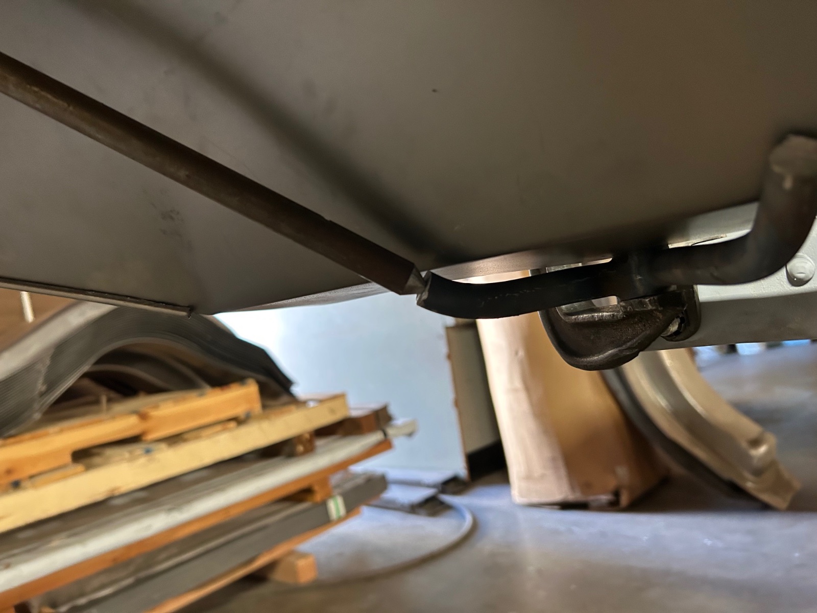

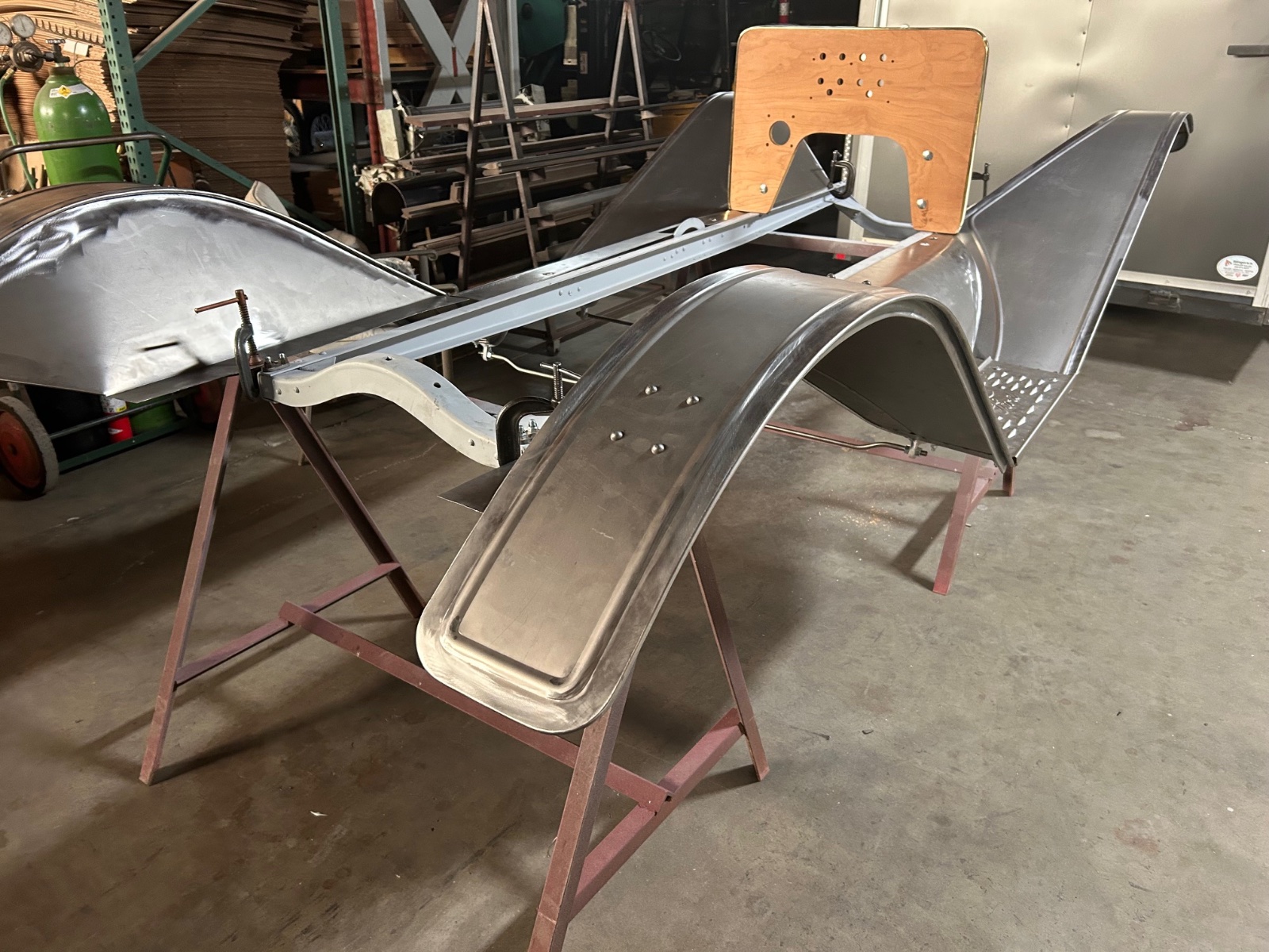

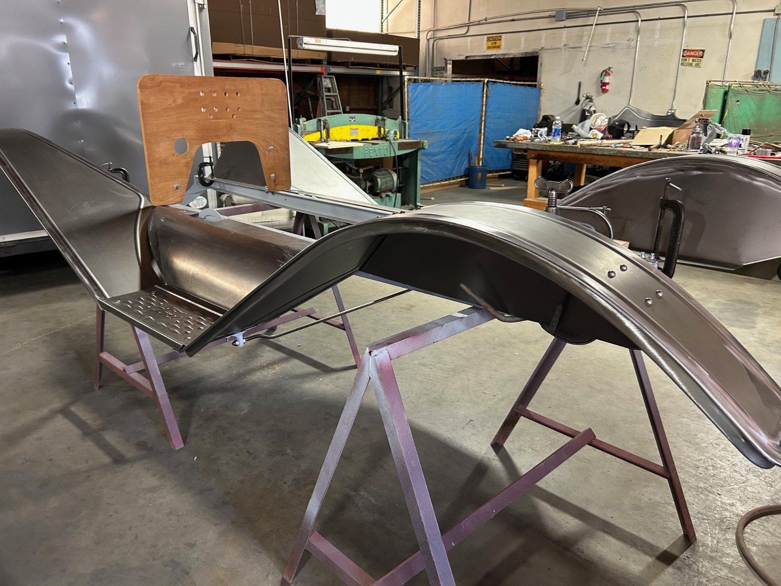

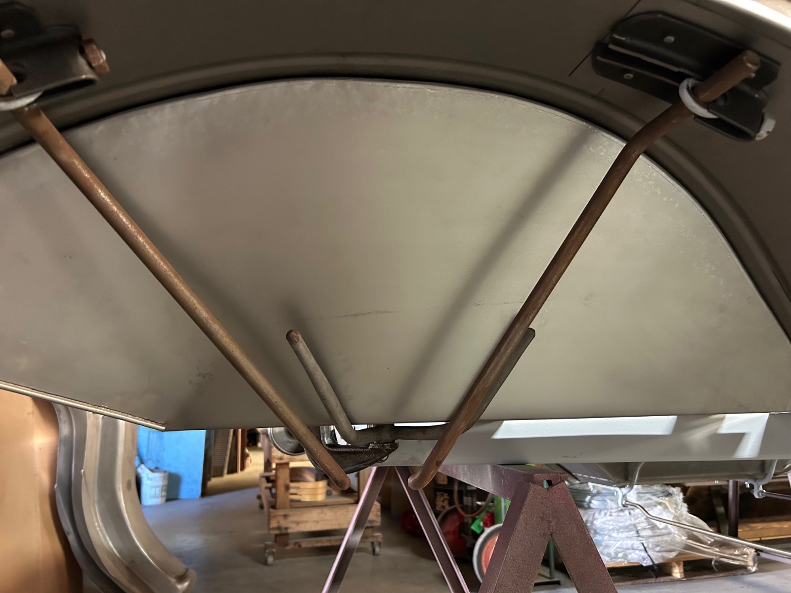

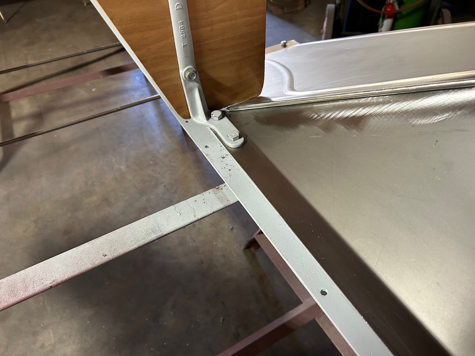

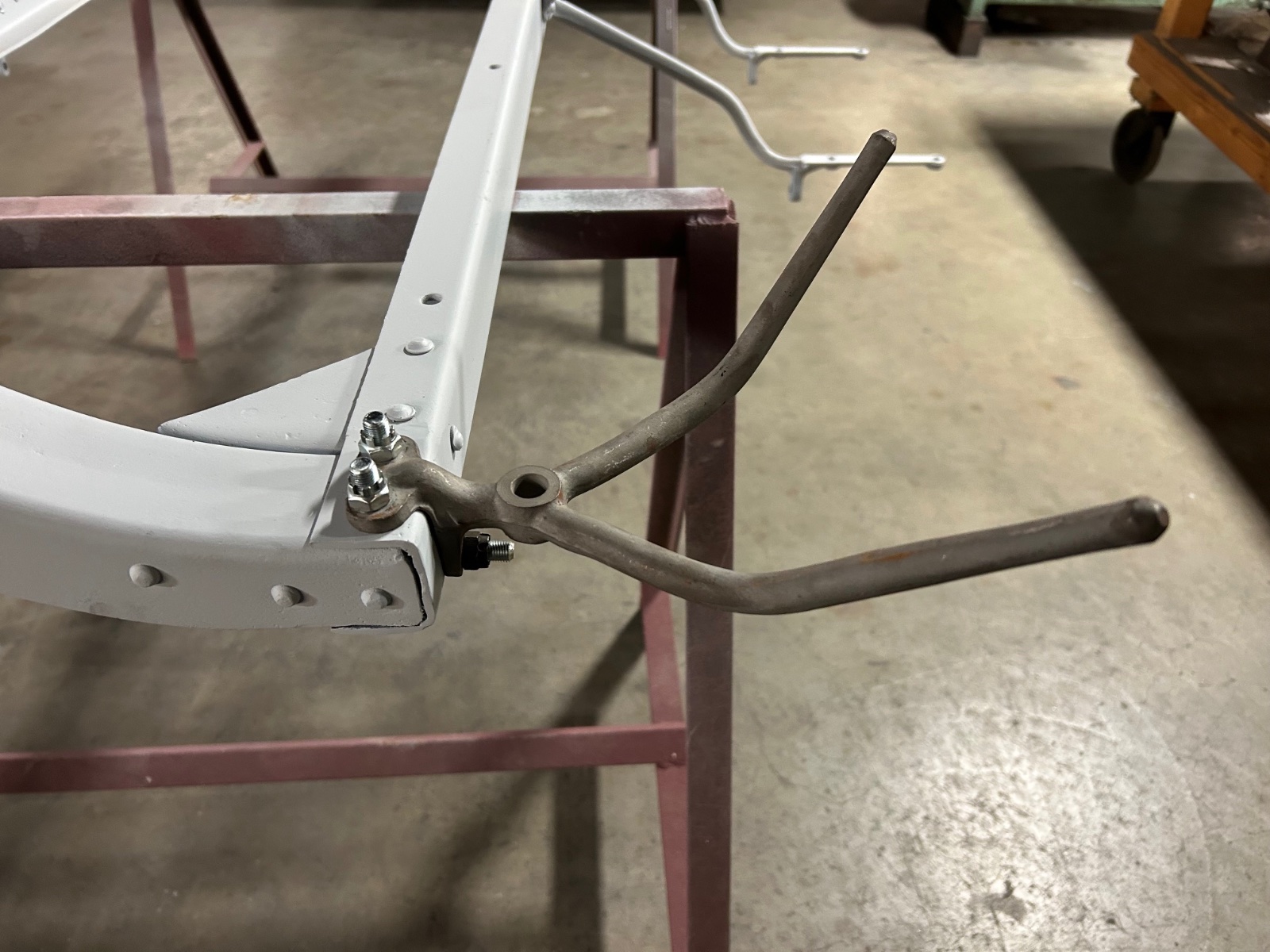

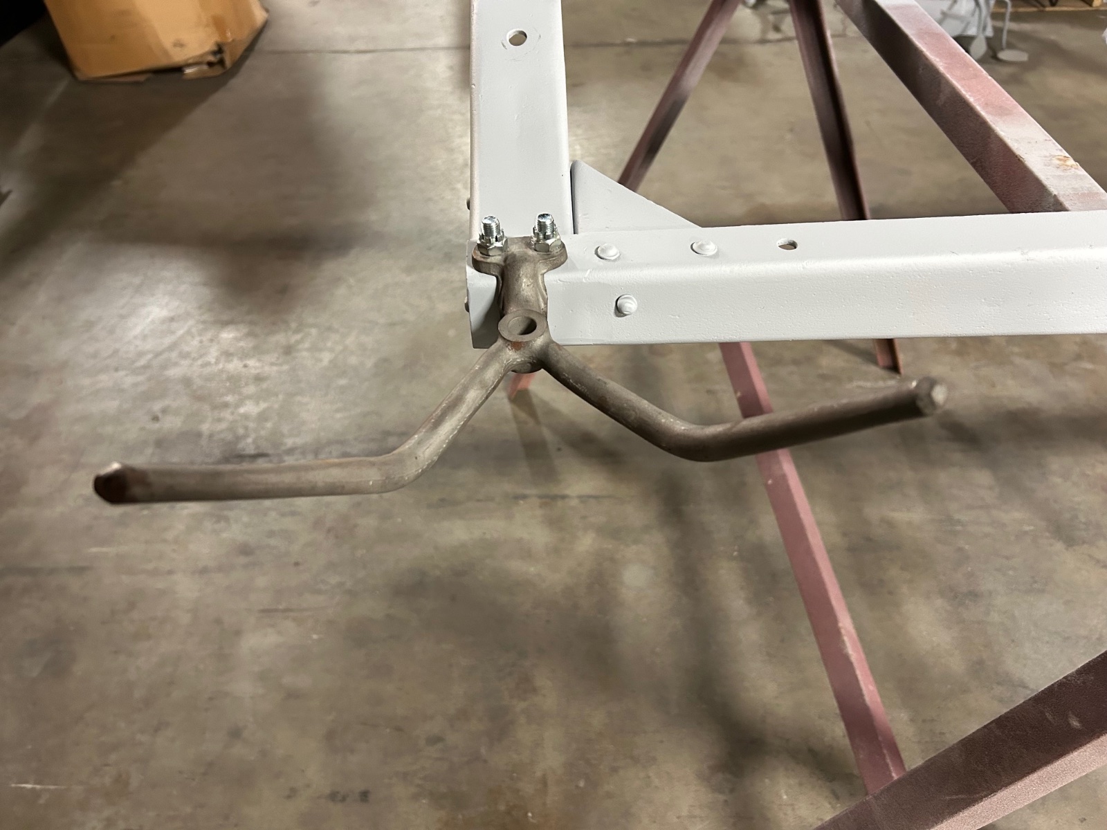

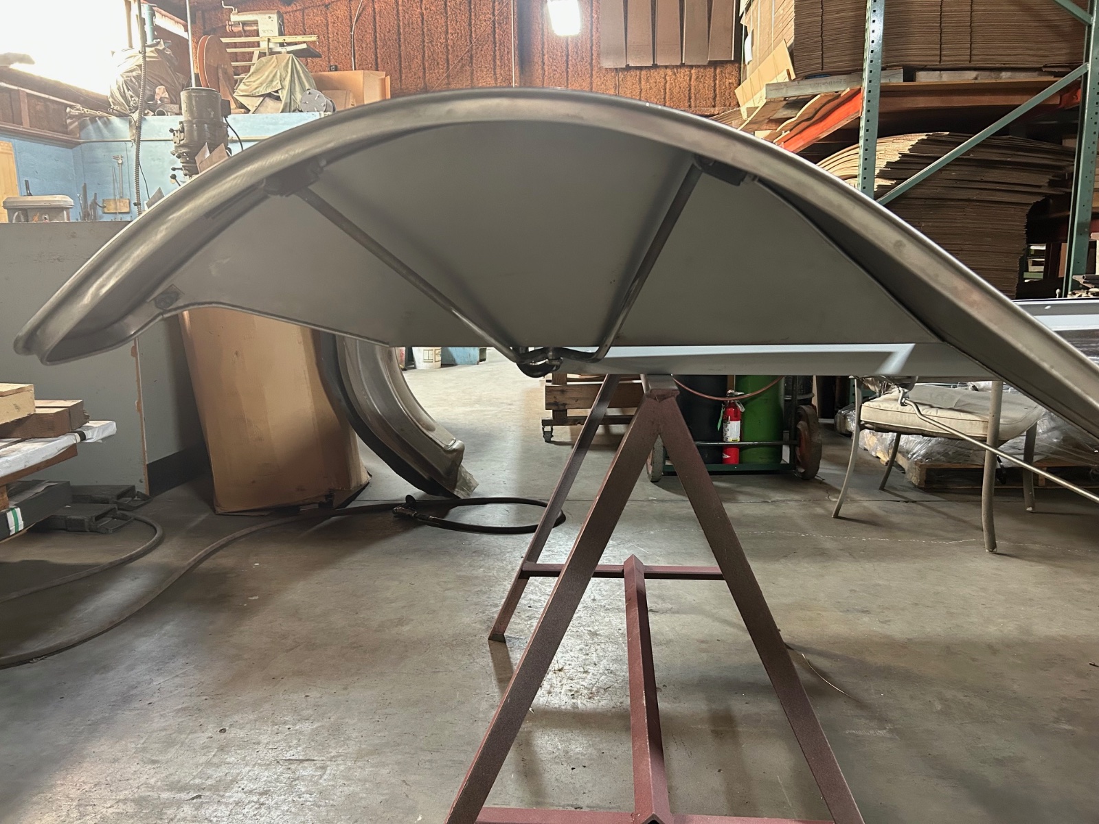

The last hurtle to getting the sheetmetal on the chassis is the rear fender irons. You can see the casting inside the rear fender well. Now we need to make the upper section of the iron that fits into the fender bracket and welds onto the casting at the other end. You need to have the fender exactly where you want it to stay so the the iron doesn’t pull it out of shape. Once these are made I will go back over all the brackets and fine tune by relieving stress and double checking alignment.
Posts: 3792
Re: New project.

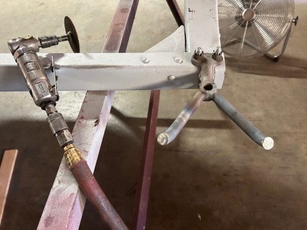

Post by Dollisdad » Sun Aug 10, 2025 9:21 pm

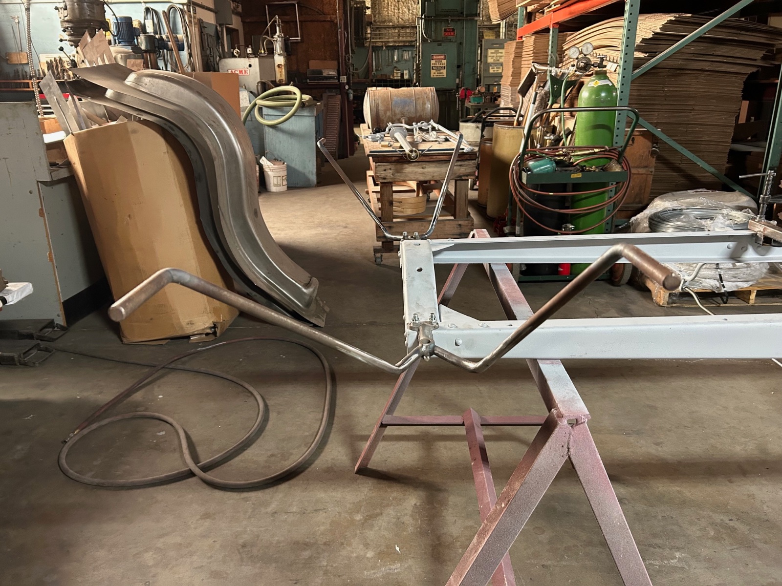

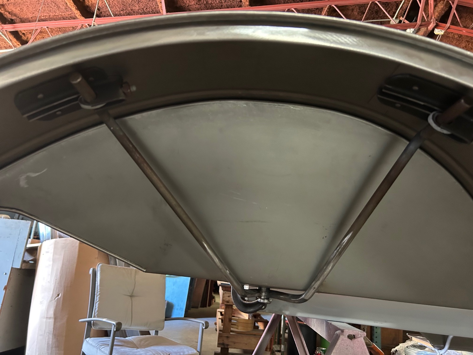

So I made the top arm extension pieces for the butterfly irons and bolted them into the fenders to see how they would mate up with the casting arms. I had to heat the casting arms and bend them down as they were rubbing against the skirt.
Next I cut off the casting arms where they turn upward with a cut off wheel.
Then reassemble everything, mark the extension to cut it off and grind it to a point.
Tac everything in place and carefully disassemble everything again. Off to the table to weld everything, then grind and buff the joints. Bolt the bracket on the frame and heat the end sections to be level and square and matched side to side. Mount the fenders again to see how they look. Usually takes some pulling, heating and relieving stress to get thing right.
Posts: 3792
Re: New project.
Post by Dollisdad » Sun Aug 10, 2025 9:27 pm
It took all day to do this. It’s 105 so I had to take some water breaks, but the good thing it’s done. I’m getting closer to finishing the first step in this build.
Should be on wheels in a day or two.

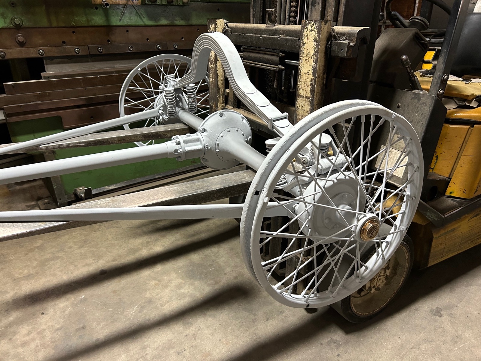

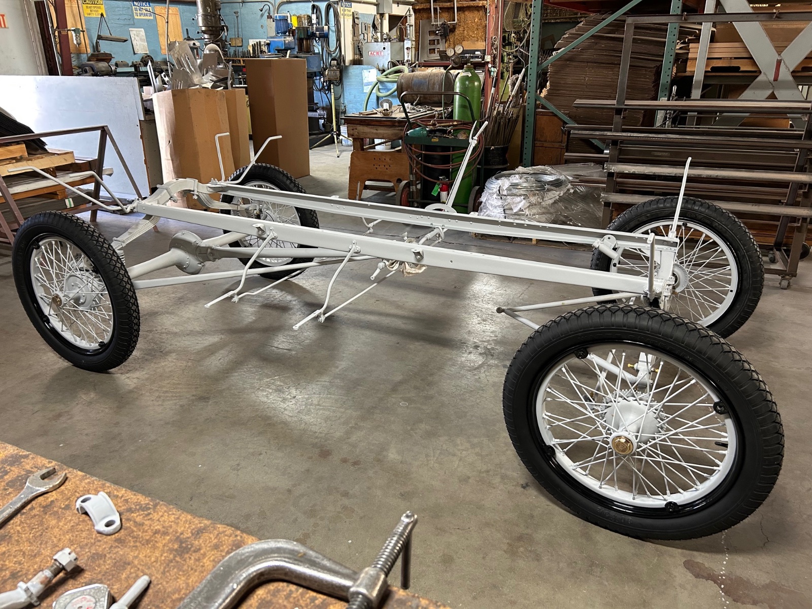

Posts: 3792
Re: New project.

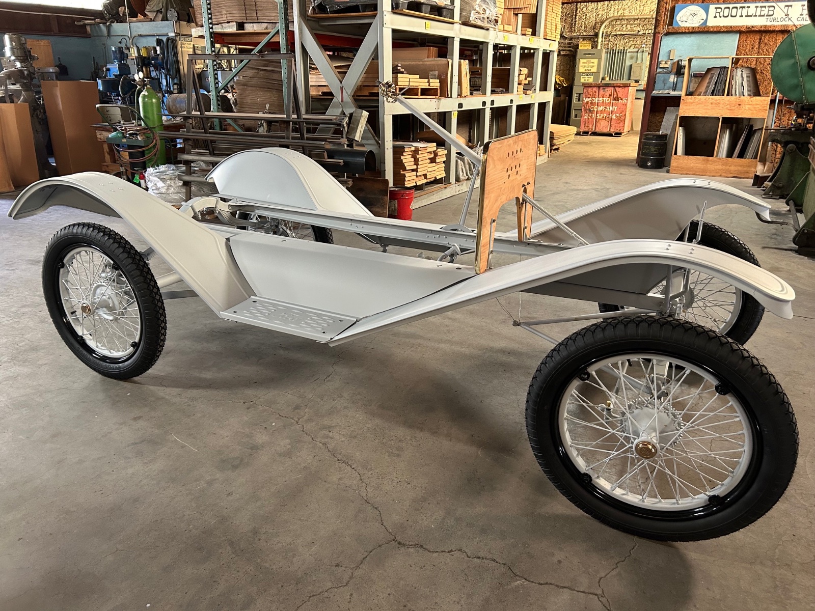

Post by Dollisdad » Tue Aug 12, 2025 8:00 pm
We’re rollin now!
Posts: 3792
Re: New project.
Post by Dollisdad » Wed Aug 13, 2025 12:55 pm
Ready to go in the trailer and head to Ohio. I am so glad to leave the heat.
