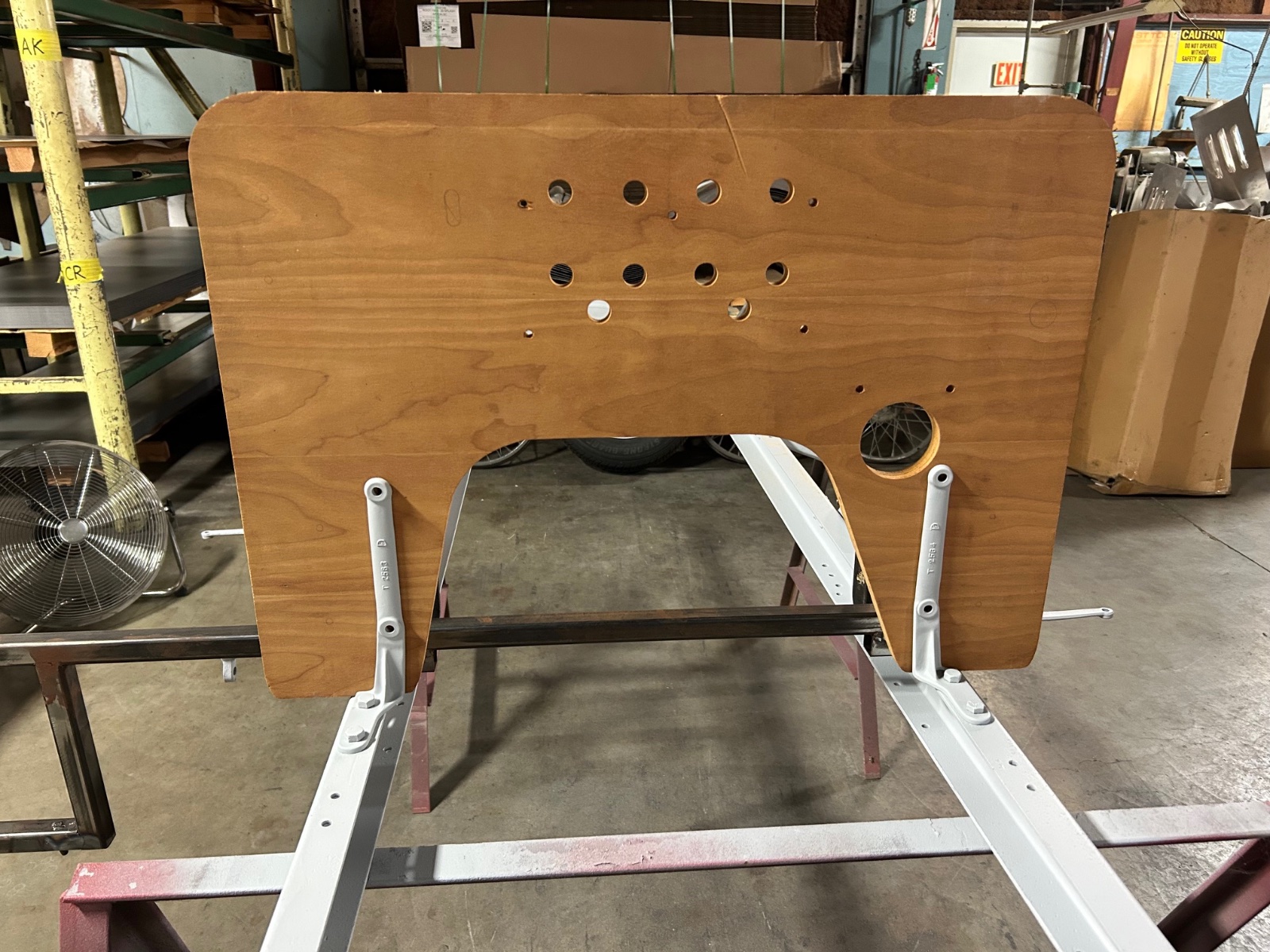

For the last 7-8 years I gathered parts in hope of building a Torpedo. So I thought it’s time to put the chassis together and we’ll think about a body later. So for now I brought what I have to the shop and started with riveting brackets to the frame, straightening and aligning said brackets and priming as I go.

Are those original torpedo dash brackets?

Thanks for the words of encouragement, they mean a lot from fellow builders. Jeff, I love machines that do stuff also. And Keith the brackets came from Tom Manochi probably 7 yrs. ago.

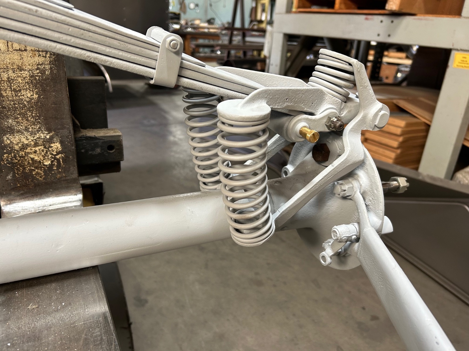

When I begin to gather parts I like to put together subassemblies to see if the parts fit, if there worn out and beyond repair and need replacing. If they are good I will sometimes rebuild pieces. Such is the case with the front end. I had it pretty much rebuilt but still rusty, so today I disassembled it.

I used a new front spring and I didn’t care for the taper on the end of the leaves, so I reshaped and cleaned up the edges. Then took all the pieces to the sandblaster and then shot the parts with a sealer to keep them from rusting.
Topic author - Posts: 3592
- First Name: Tom
- Last Name: Rootlieb
Re: New project.
Then reassemble the front end. Dry, no grease. It will come all apart for paint later and that’s when I will nit pick the finish on all the parts.
