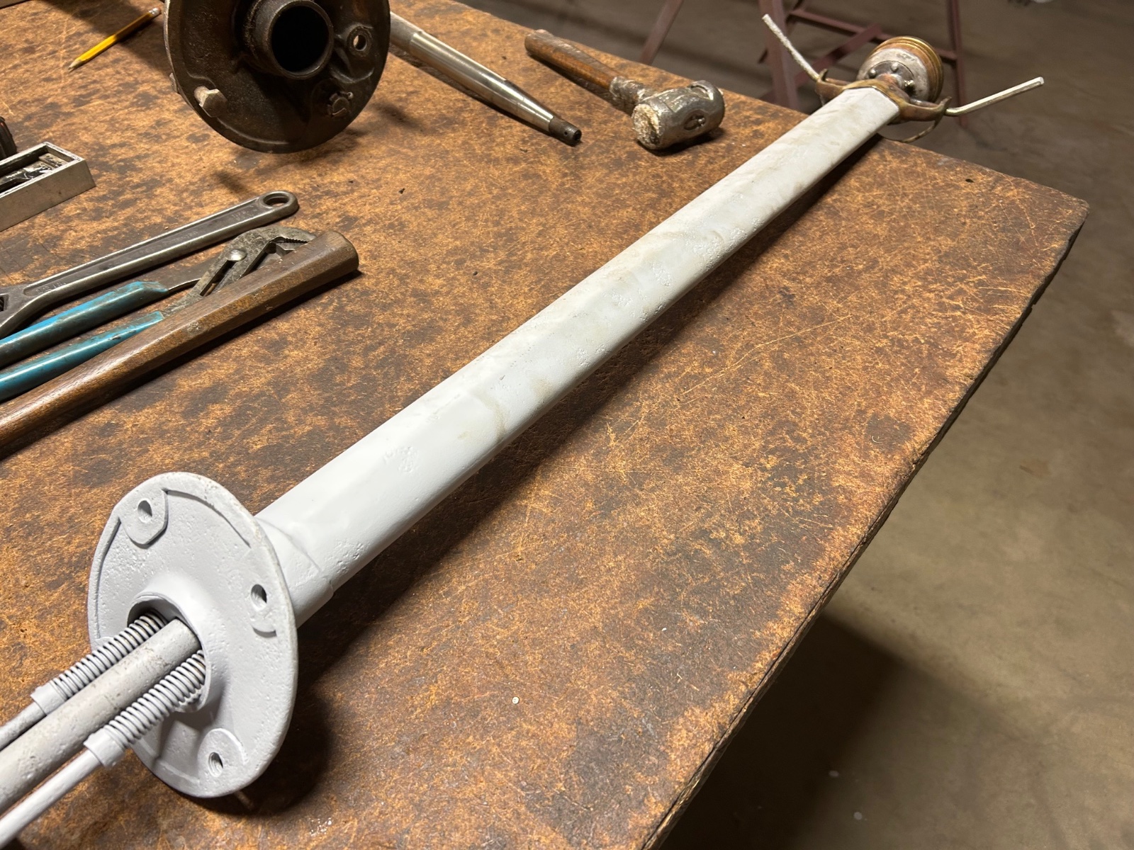

For the last 7-8 years I gathered parts in hope of building a Torpedo. So I thought it’s time to put the chassis together and we’ll think about a body later. So for now I brought what I have to the shop and started with riveting brackets to the frame, straightening and aligning said brackets and priming as I go.

I have a pr. of housings, so I bought a donor rear end. Turns out the guts were very nice. Put tha axles in the lathe and arrow straight. Ring and pinion very nice also. Axles are centered, so no bent housings. The usual thrust washers and pins were replaced. I’m waiting for a driveshaft to set the pinion, but so far so good.

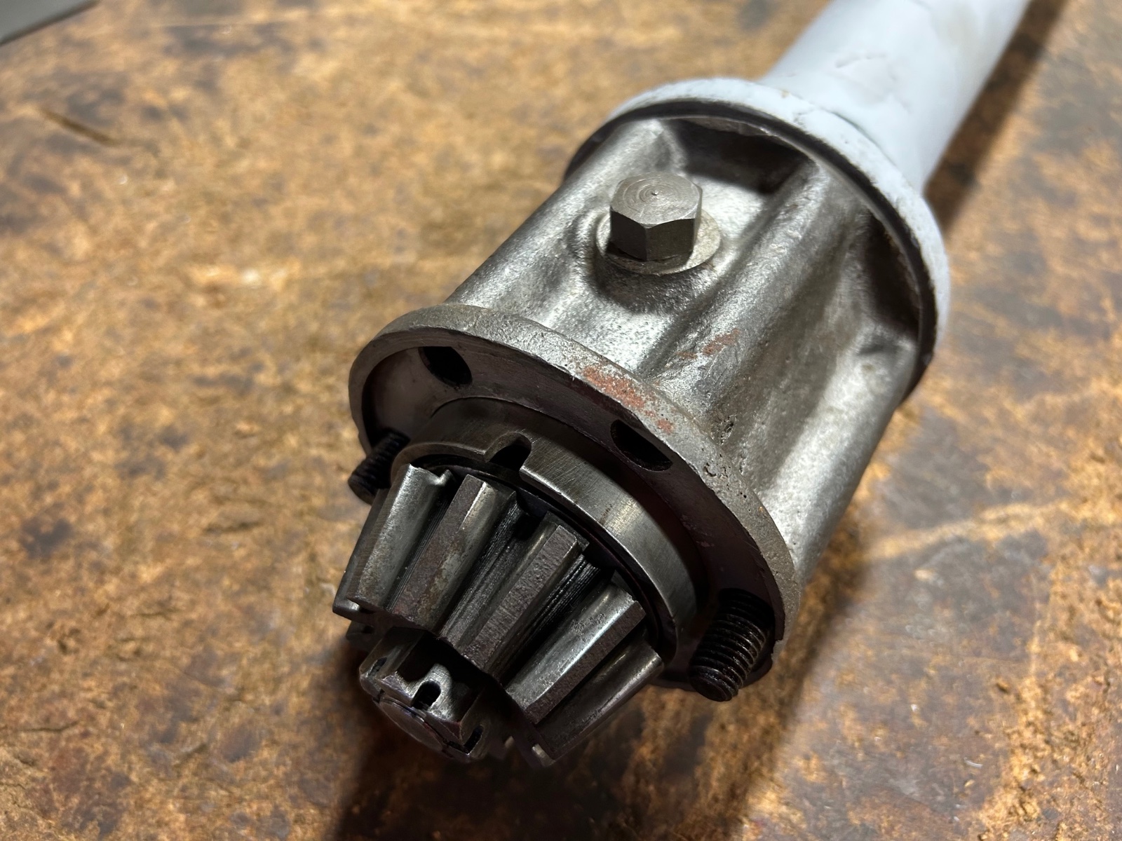

Torpedo column with a loose gear case on top, so I reset the rivets and silver soldered the joint. Now to clean the mess off.

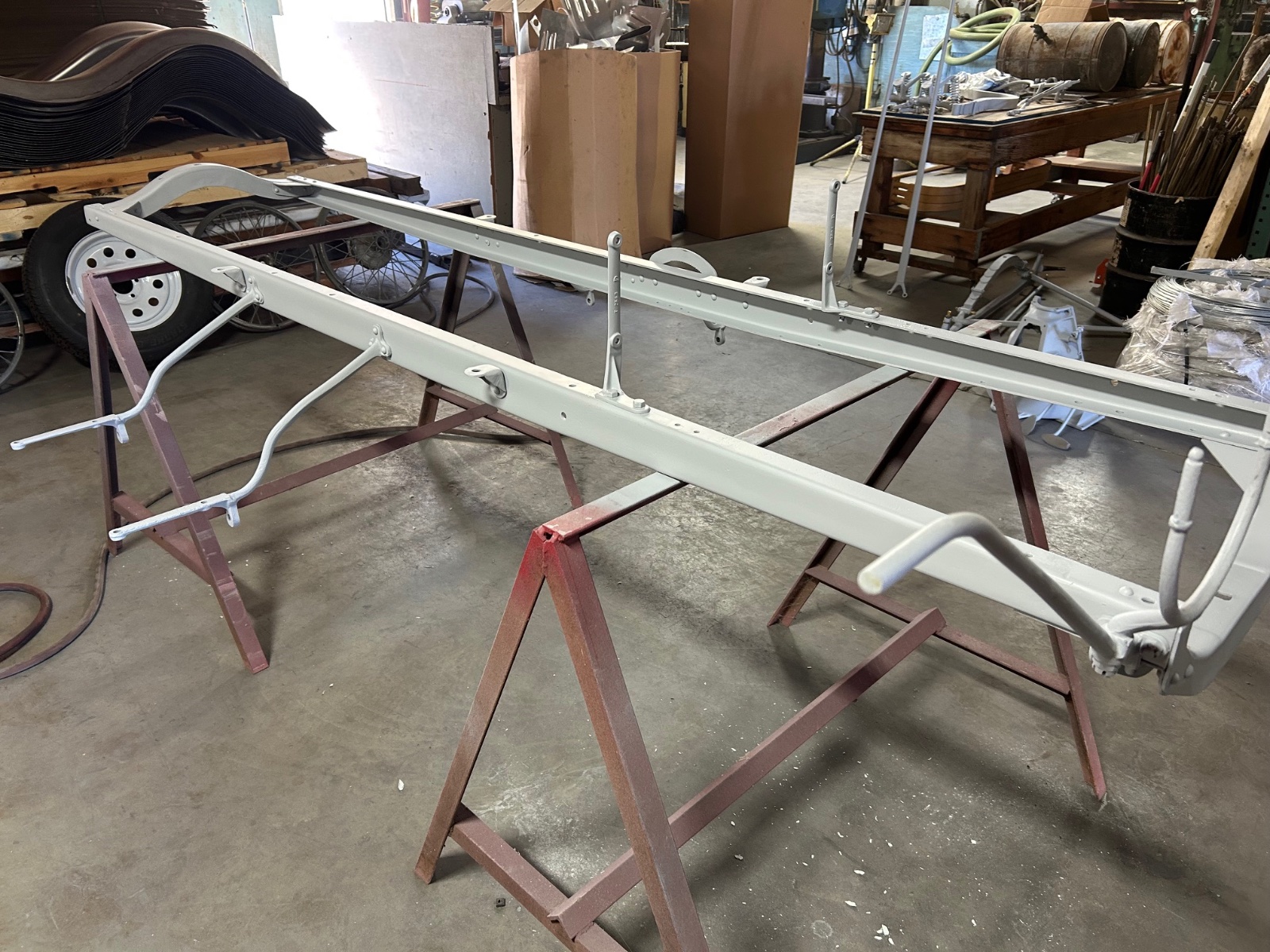

I think the frame was a farm trailer at some point. I welded up holes that shouldn’t be there.

All holes welded up and finished off. Reprimed and ready to move along.

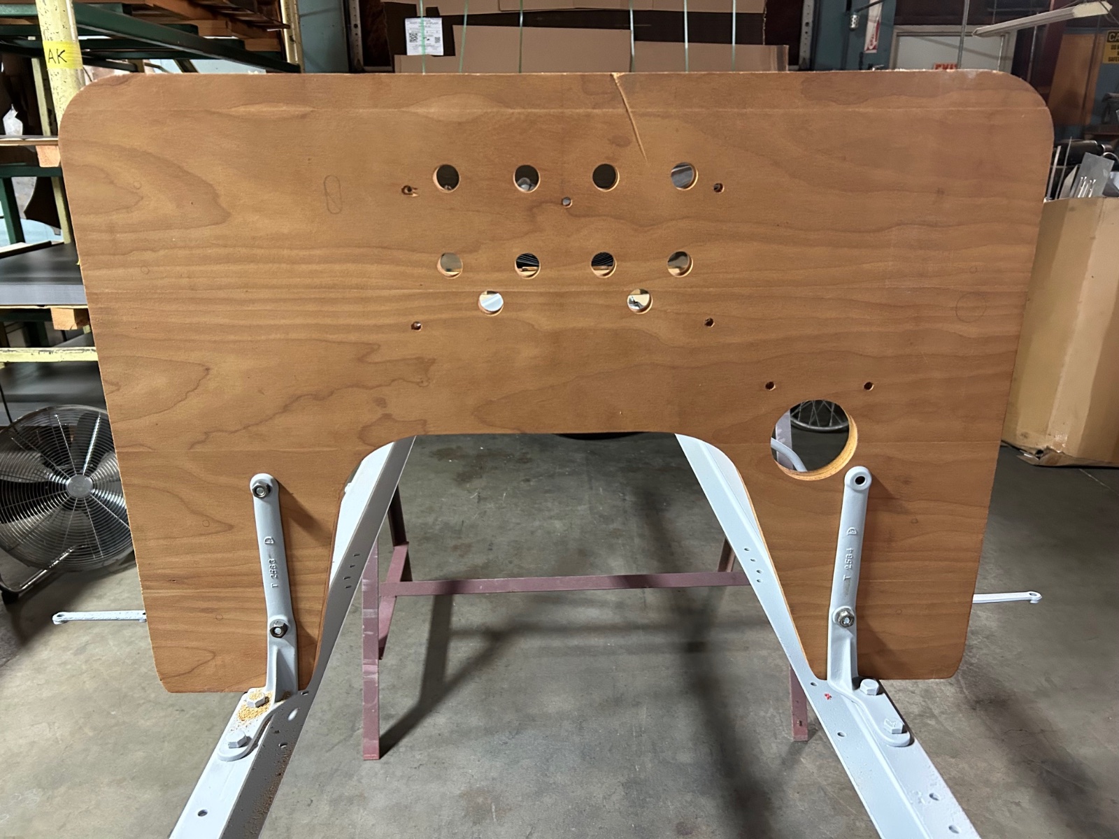

Found a Torpedo firewall in the wood shop. Looks to be a Seversons from 40 years ago. Some water stains that sanded off for the most part and a scare at the top that I think I can doctor. I used the r/b fixture to set the frame spacing ( 1/8” off ) and the pre drilled holes were very close.

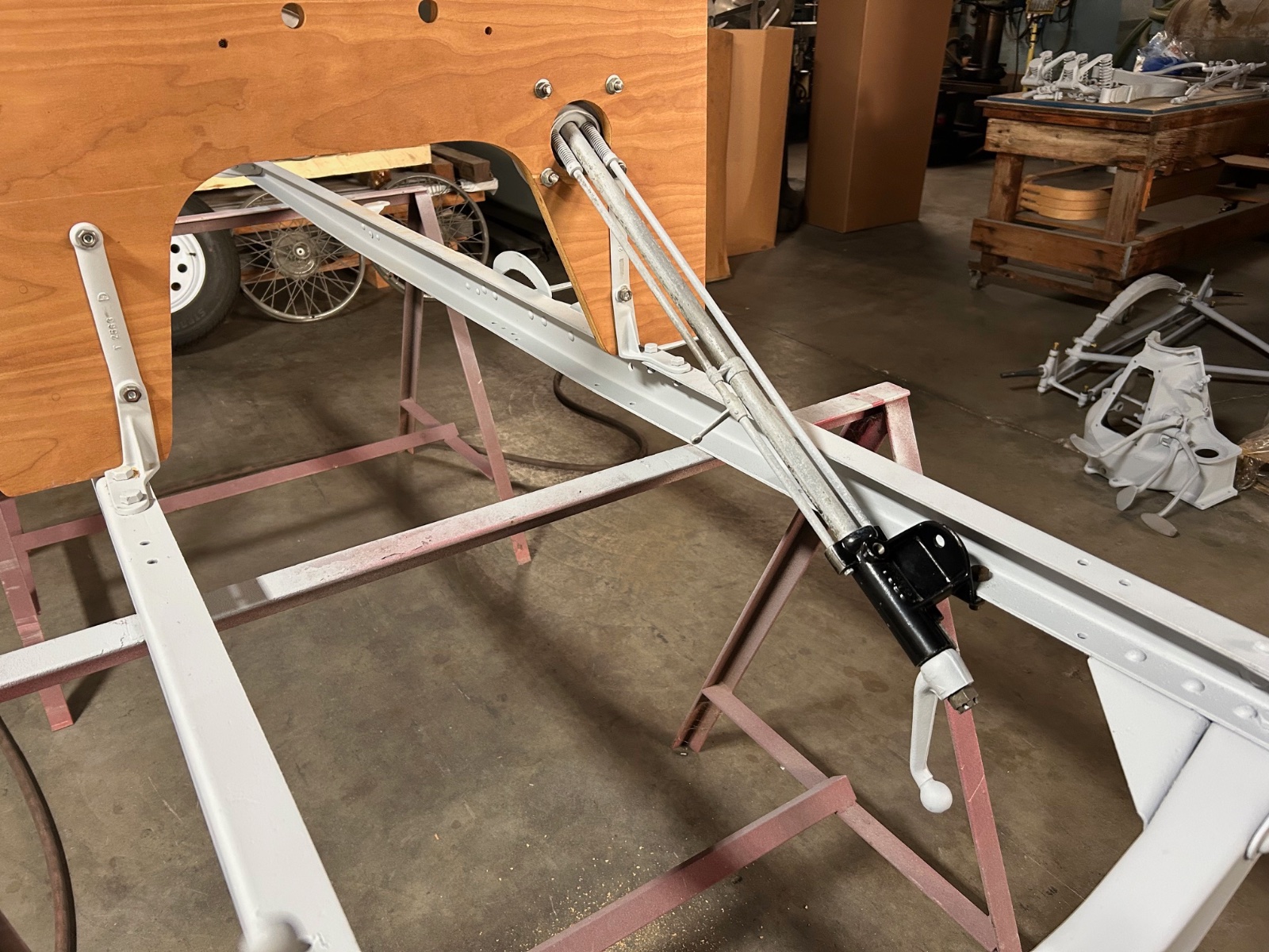

This keeps the top of the frame rails from flexing out or in. Now if I can just get the r/b truss rods I can start to mount the fenders and aprons. Then I can build the rest of the butterfly irons upward arms.

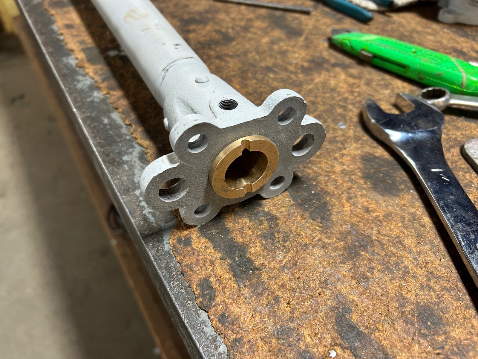

I got the bushing on the lower d/s. THE WORST JOB of this whole build. Fitting the U joint is simple. Put the axle back in the vice, split the halves, fit the pinion to the ring, removed the d/s. Siliconed the halves and bolted together leaving 4 front finger tight. Put the axle on the floor, siliconed the spool at the front and rear. Then dropped d/s over studs while guiding radius rods at top. Tighten everything up and wa-la . It is too heavy for me to lift so it will have to sit till Monday and the kids can put it back on the table.

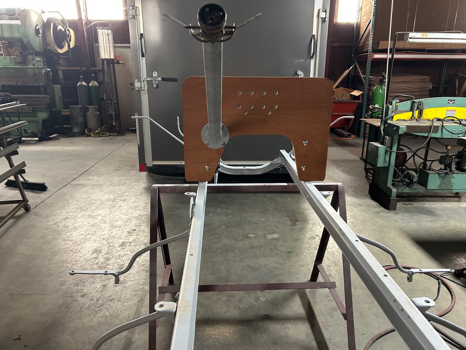

With the firewall in place I thought I might as well fit the steering gear in place. Center shaft was tight last 2” into housing, so I figured I got solder into the gear head opening. I’ll have to ream it when it comes back apart. Lower steering to frame bracket is another Tom Manochi piece. Fit beautiful.His parts are so nice.

You really get a sense of how long the Torpedo column is when you step back and realize it’s length is more than half the length of the frame.

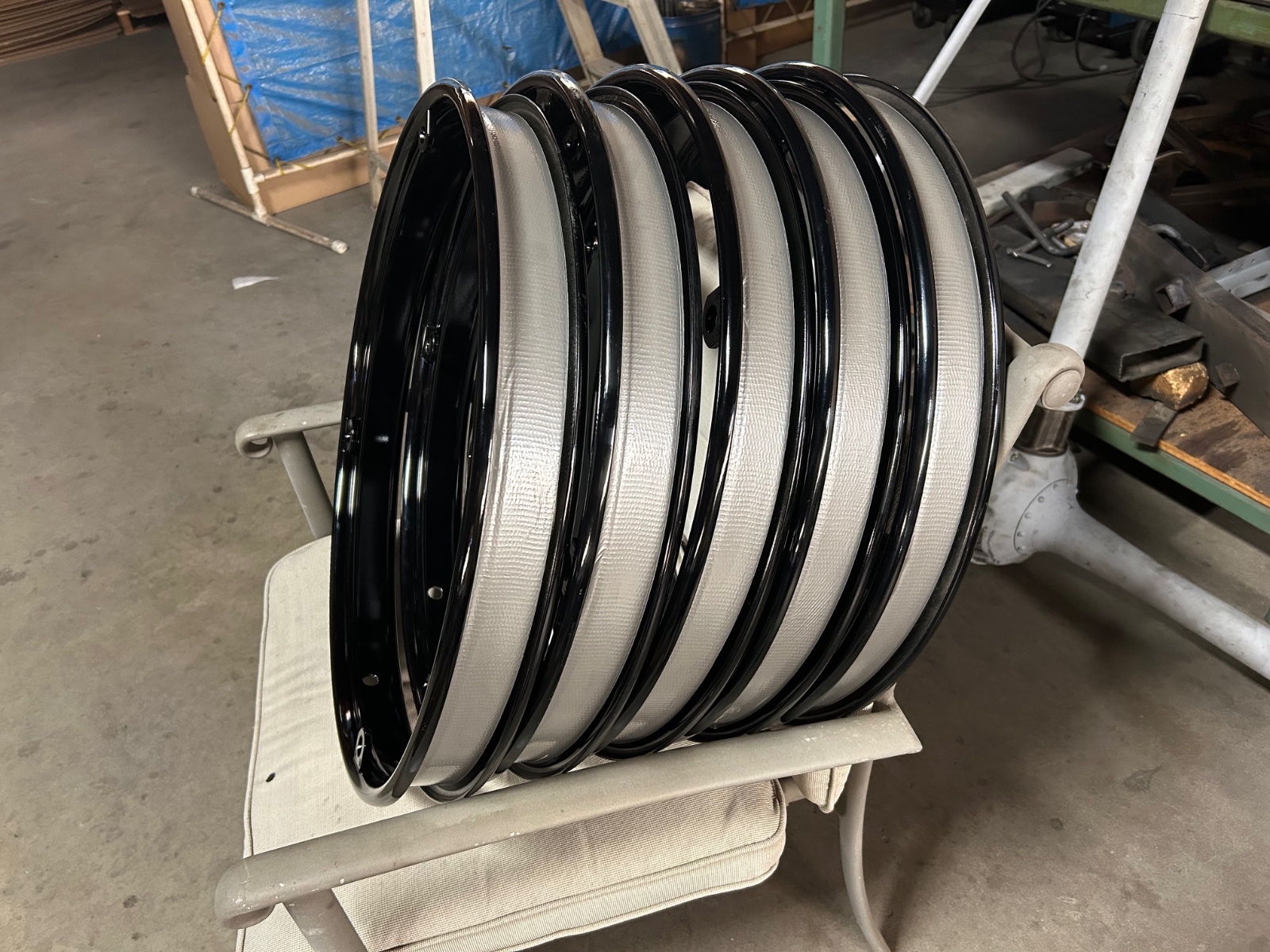

Thanks Art. Everyone’s favorite Sunday afternoon activity, mounting new tires. Some years ago I bought new rims, had them powder coated and stored away till now.
Was never a fan of flaps, so in the days before new rims I would wrap the inside with two layers of duct tape to keep the rough surface away from the tubes.
I guess old habits die hard.
The best part is when this is over. It helps setting them in the 95 degree heat to soften them up.

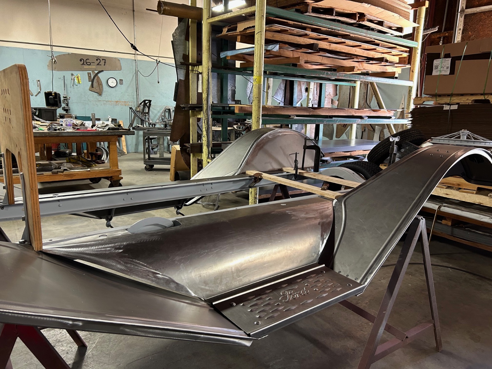

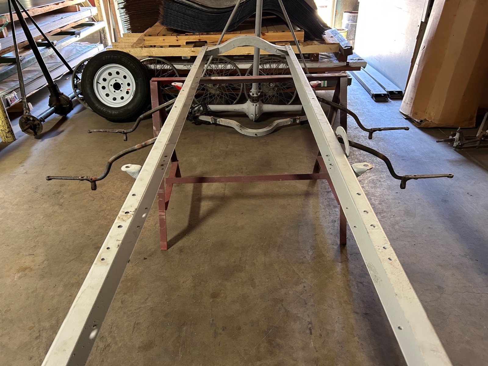

So finally starting to fit sheetmetal. Discovered the left frame rail was a 1/4” ahead of the right one, so we placed the frame catty-wampus between a 100 ton press brake and a forklift and with a few nudges we were back in square. The firewall has to be square or nothing fits.I will have to go back and check the running board brackets as well. But starting at the front, everything looks good.

Then prop a rear fender into position. Then cut the running board blocks and drill them.
Topic author - Posts: 3736
- First Name: Tom
- Last Name: Rootlieb
Re: New project.
With both rear fenders propped up and pre drilled for the running boards, you can put the running boards in position sandwiching the apron tail between the fender tab and the woodblock. They will come off and on half a dozen times for reshaping before they will sit fairly good.
