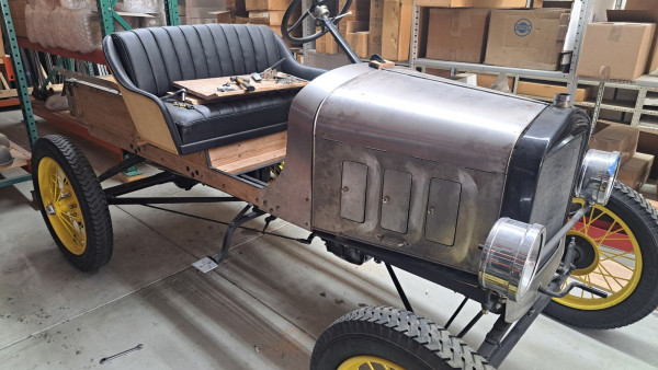

What head are you running there Mark? It looks pretty chunky?

The head is a cast iron original TURBO. I've only seen one other in my travels.

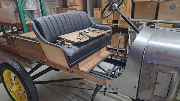

Moving right along!

Nice work Mark! I really like the hood you are using.

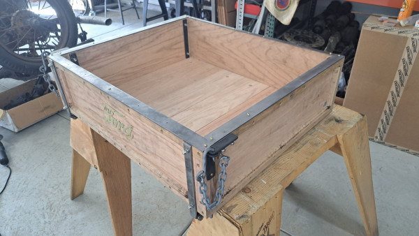

Mark Chaffin
Posts: 4369
Last Name: Chaffin
Location: Lake Elsinore
Re: Ranch Doodlebug Build

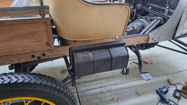

Post by Mark Chaffin » Fri Aug 08, 2025 12:41 am
Mark Chaffin
Posts: 4369
Last Name: Chaffin
Post by Mark Chaffin » Fri Aug 08, 2025 12:43 am

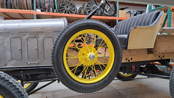

Last Name: Chaffin
Post by Mark Chaffin » Sat Aug 23, 2025 9:24 am

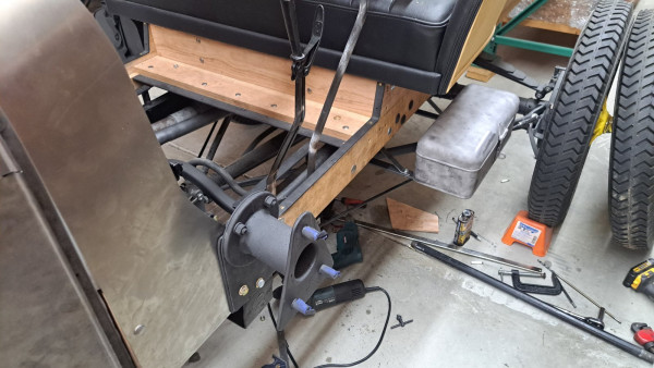

Installing cycle fenders and brackets.
Bills Auto Works
Posts: 290
Post by Bills Auto Works » Sat Aug 23, 2025 12:50 pm
Hey Mark,
That thing is coming along nicely from when I was there a few months ago! I don't know whether to be happy for you that you are making major progress or sad for myself since I can't seem to make any on my stuff. LOL I guess both! :roll:

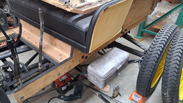

07 XLR-V
Posts: 1161
First Name: Adrian
Last Name: Whiteman
Post by A Whiteman » Sat Aug 23, 2025 5:17 pm
Thanks for the pictures mark, looking good.
Did you make the cycle guard mounting brackets? They are very neat and I am curious how they fit and how they are braced.
Would you mind sharing a few more details??
Thanks again
Adrian
Mark Chaffin
Posts: 4369
Last Name: Chaffin
Post by Mark Chaffin » Sat Aug 23, 2025 6:01 pm
Yes. The spindle brackets were made by hand. With two tabs welded on the plate to be mounted using the spindle arm. The spindle arm boss and nut were machined down 1/8" each to allow clearance. The rods are cold role steel threaded 1/2-20 at 4" Length for adjustment. The opposite end was turned down on a lathe to .425 for the fender eyelets. Once the brackets are attached to the spindle, a 1/4-20 short bolt was added front and rear to prevent the bracket from rotating. A few more pictures have been added to illustrate further.
Posts: 1161
First Name: Adrian
Last Name: Whiteman
Post by A Whiteman » Sun Aug 24, 2025 3:35 am
Thank you, that is a clever solution! I will salt that idea away :-)

Mark Chaffin
Posts: 4369
Last Name: Chaffin
Post by Mark Chaffin » Sun Aug 24, 2025 8:20 pm
Still another month or so from paint. I did already purchase the John Deere green paint though. :)
big2bird
Posts: 566
First Name: Jeffrey
Last Name: Hausey
Location: Anaheim, Ca.
Post by big2bird » Sun Aug 24, 2025 10:26 pm
Explains the yeller wheels.

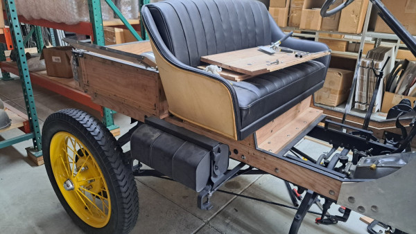

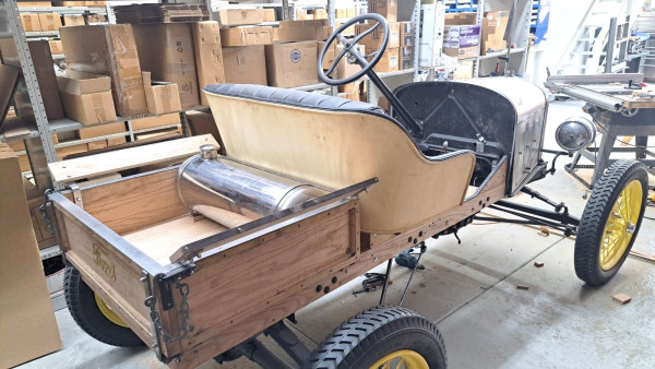

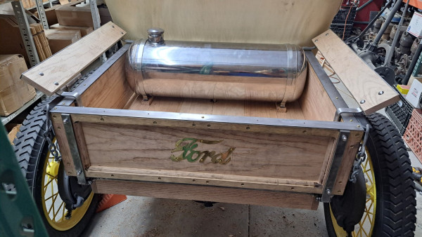

Post by Mark Chaffin » Tue Sep 02, 2025 6:27 pm
More progress. Almost ready for paint.
Ed Fuller
Posts: 823
First Name: Ed
Last Name: Fuller
Location: NJ
Board Member Since: 2012
Post by Ed Fuller » Tue Sep 02, 2025 6:31 pm
Wow, a winch!
That must be a serious ranch!
Progress looks great Mark.
Post by Shrshot » Thu Sep 04, 2025 7:32 am
Mark, That is absolutely fantastic! Really like the fenders and the winch set up. Can't wait to see it in paint. Hats off to you sir!

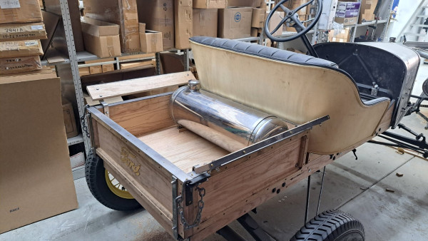

Do you have photo of way you attached the rear fenders to the rear axle?

Andrea. I'll take a few pics and add them on Monday.
Mark Chaffin
Posts: 4369
Last Name: Chaffin
Post by Mark Chaffin » Tue Sep 09, 2025 2:46 pm

Thank You Mark.

big2bird
Posts: 566
First Name: Jeffrey
Last Name: Hausey
Post by big2bird » Wed Sep 10, 2025 11:18 am
Mark. The Blockneys. Are they marked " Made in the UK."?
Mark Chaffin
Posts: 4369
Last Name: Chaffin
Post by Mark Chaffin » Thu Sep 11, 2025 7:25 pm
Made in Vietnam.
Posts: 6853
Post by Allan » Thu Sep 11, 2025 11:36 pm
Made in Viet Nam, to Blockley's own specifications. They have been supplying a large range of bias ply and vintage racing tyres for many years. They recognised there was a real quality problem with the quality of the tyres produced for our Ts, and set about rectifying this. What it needed was direction from the marketer for those better quality products. That better quality comes at a higher price, but as someone commented on the forum, if it leads to longer, better service, it is far better value over all.
Mark Chaffin
Posts: 4369
Last Name: Chaffin
Post by Mark Chaffin » Fri Sep 12, 2025 10:24 am
My opinion. Far superior to the other offerings. Especially, their tubes.
