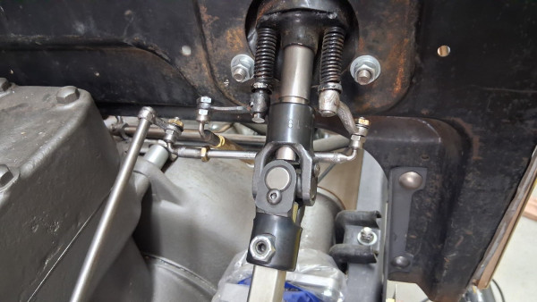

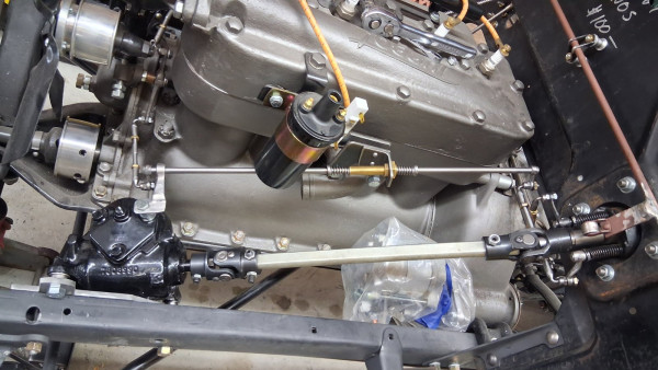

Post by Mark Chaffin » Fri Feb 28, 2025 3:08 pm
I thought I would share a couple pics of the Ranch Doodlebug build. Engine and Ruckstell are done. A huge shout out to Mr. Hank Lee for rebuilding my Zenith carburetor as I know it has been done right and also for modifying my Winfield intake manifold to ensure a proper fit. Hank is indeed an artist. Thanks Hank!

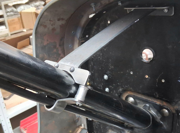

Post by Mark Chaffin » Sat Aug 23, 2025 9:24 am
Installing cycle fenders and brackets.

Thanks for the pictures mark, looking good.
Did you make the cycle guard mounting brackets? They are very neat and I am curious how they fit and how they are braced.
Would you mind sharing a few more details??

Post by Mark Chaffin » Sat Aug 23, 2025 6:01 pm
Yes. The spindle brackets were made by hand. With two tabs welded on the plate to be mounted using the spindle arm. The spindle arm boss and nut were machined down 1/8" each to allow clearance. The rods are cold role steel threaded 1/2-20 at 4" Length for adjustment. The opposite end was turned down on a lathe to .425 for the fender eyelets. Once the brackets are attached to the spindle, a 1/4-20 short bolt was added front and rear to prevent the bracket from rotating. A few more pictures have been added to illustrate further.

Post by A Whiteman » Sun Aug 24, 2025 3:35 am
Thank you, that is a clever solution! I will salt that idea away :-)

Post by AndreFordT » Sat Sep 06, 2025 1:32 am
Good morning Mark,
Great project, I would like to see the finished produced.
Do you have photo of way you attached the rear fenders to the rear axle?

Post by Mark Chaffin » Sat Sep 06, 2025 6:54 pm
Andrea. I'll take a few pics and add them on Monday.

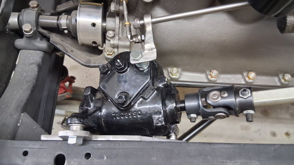

Mark Chaffin
Posts: 4377
Last Name: Chaffin
Location: Lake Elsinore
Re: Ranch Doodlebug Build
Post by Mark Chaffin » Tue Sep 09, 2025 2:46 pm

Mark Chaffin wrote:
Tue Sep 02, 2025 6:27 pm
More progress. Almost ready for paint.
Where did you get the cycle fenders & what are the dimensions? Been looking to get some
Mark Chaffin
Posts: 4377
Last Name: Chaffin
Post by Mark Chaffin » Sat Oct 04, 2025 12:44 pm
I made them. About a 24" radius. Modified early fender brackets front and rear and attached with threaded rivits.
