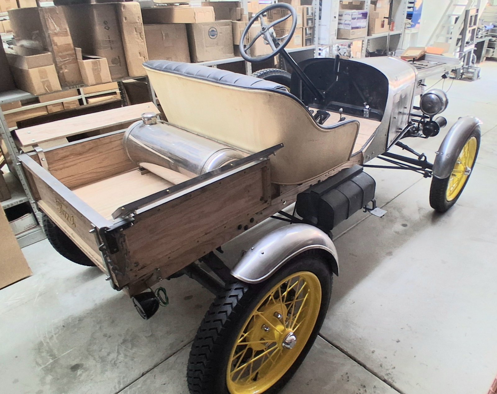

I thought I would share a couple pics of the Ranch Doodlebug build. Engine and Ruckstell are done. A huge shout out to Mr. Hank Lee for rebuilding my Zenith carburetor as I know it has been done right and also for modifying my Winfield intake manifold to ensure a proper fit. Hank is indeed an artist. Thanks Hank!

Looks like it’s coming along nicely since
last months visit. Sounds like you have some more shop space now or will shortly.

Installing cycle fenders and brackets.

Did you make the cycle guard mounting brackets? They are very neat and I am curious how they fit and how they are braced.
Would you mind sharing a few more details??

Yes. The spindle brackets were made by hand. With two tabs welded on the plate to be mounted using the spindle arm. The spindle arm boss and nut were machined down 1/8" each to allow clearance. The rods are cold role steel threaded 1/2-20 at 4" Length for adjustment. The opposite end was turned down on a lathe to .425 for the fender eyelets. Once the brackets are attached to the spindle, a 1/4-20 short bolt was added front and rear to prevent the bracket from rotating. A few more pictures have been added to illustrate further.

Thank you, that is a clever solution! I will salt that idea away

More progress. Almost ready for paint.

Mark, That is absolutely fantastic! Really like the fenders and the winch set up. Can't wait to see it in paint. Hats off to you sir!

Do you have photo of way you attached the rear fenders to the rear axle?
Andre

Andrea. I'll take a few pics and add them on Monday.
