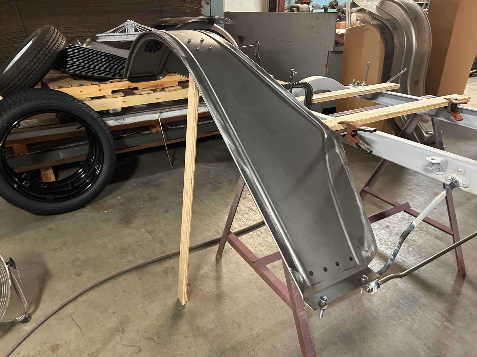

So finally starting to fit sheetmetal. Discovered the left frame rail was a 1/4” ahead of the right one, so we placed the frame catty-wampus between a 100 ton press brake and a forklift and with a few nudges we were back in square. The firewall has to be square or nothing fits.I will have to go back and check the running board brackets as well. But starting at the front, everything looks good.
Topic author - Posts: 3792
- First Name: Tom
- Last Name: Rootlieb
Re: New project.
Then prop a rear fender into position. Then cut the running board blocks and drill them.
- First Name: Tom
Re: New project.
With both rear fenders propped up and pre drilled for the running boards, you can put the running boards in position sandwiching the apron tail between the fender tab and the woodblock. They will come off and on half a dozen times for reshaping before they will sit fairly good.

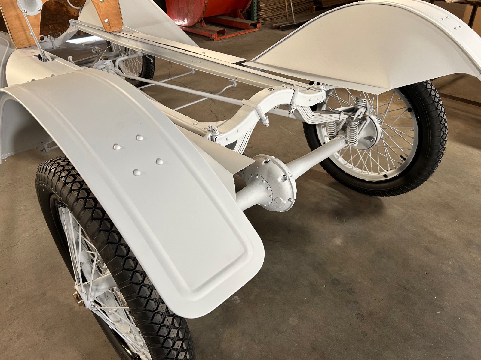

We’re rollin now!

Re: New project.
Ready to go in the trailer and head to Ohio. I am so glad to leave the heat.
