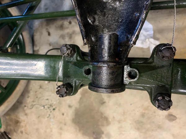

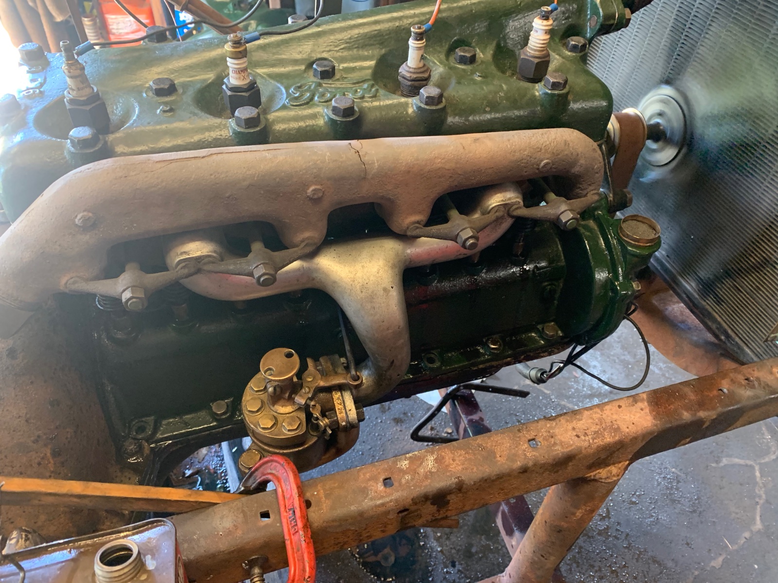

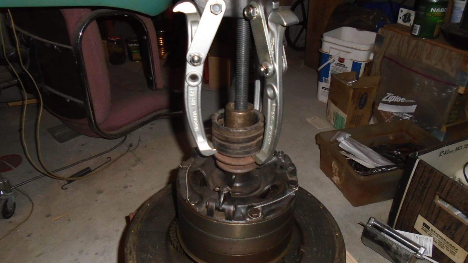

Many of you have been following my adventures restoring the 1909 Touring. Well this last week I have been trying to get it started.
Way back in 2017 after the motor was rebuilt I did actually use a later flywheel and hogs head and had the engine running. Not for long but it seemed ok.

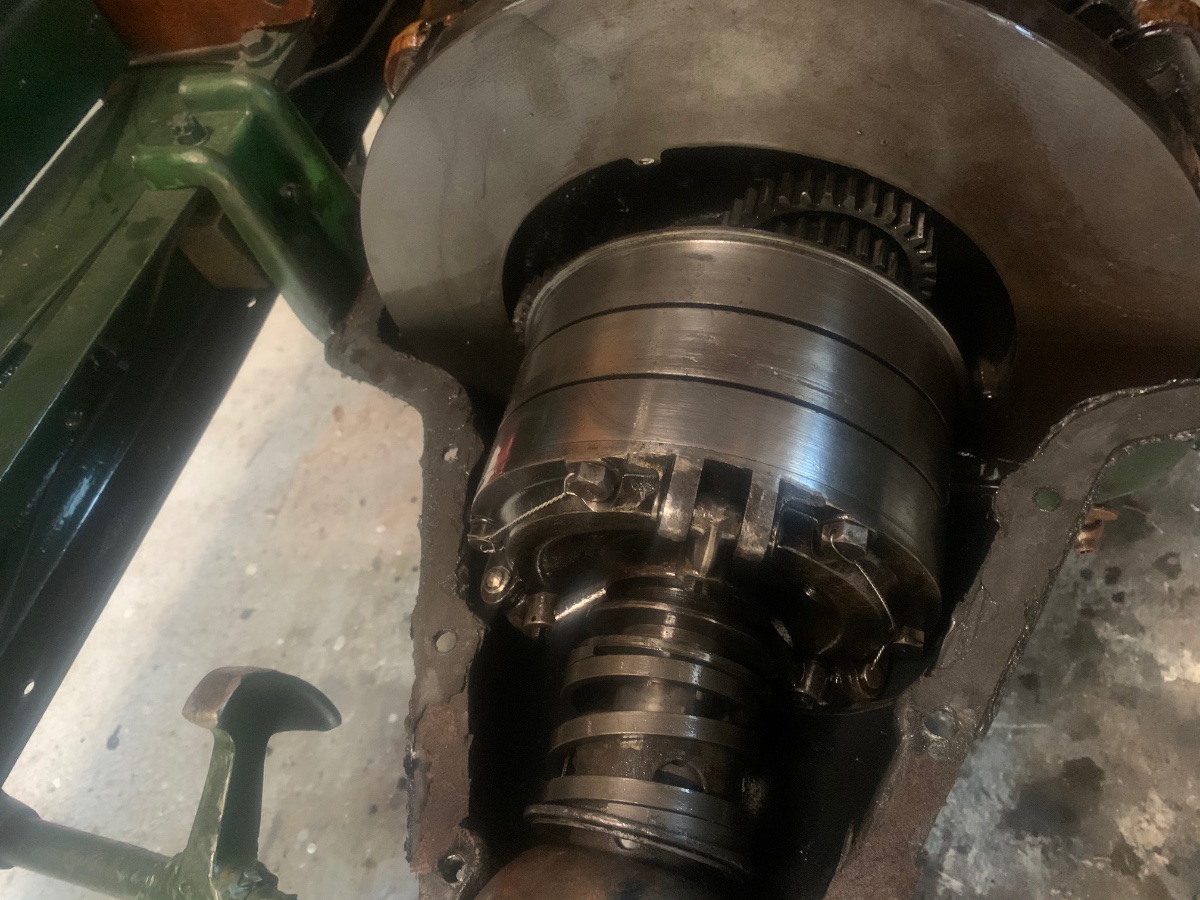

Now after all the bodywork and other items are completed, time to crank the motor. It was very very stiff. After a few false efforts, mainly the timing being off 180 degrees we towed it and in less than 100 yards it was running.
After the usual mixture and timing adjustments it seemed to run well. However after I stalled it in reverse, we still couldn’t crank it. So we towed it again and I drive it home to the barn where it stalled again in low band.

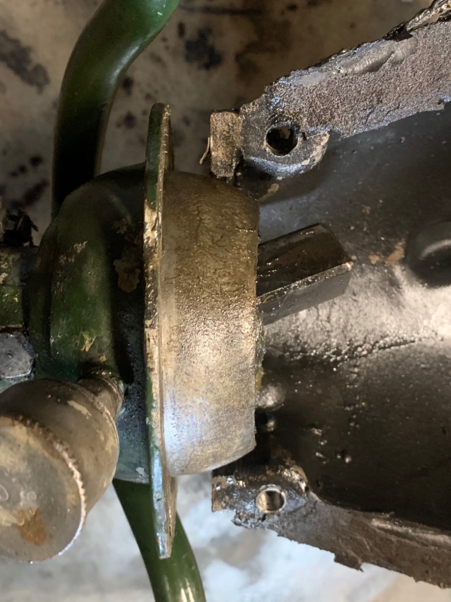

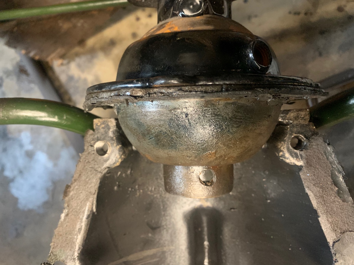

So the motor runs but there is still lots of friction. I decided the transmission is faulty. So I removed the hogs head, all three bands and the three clutch adjustment screws. Now the engine rotated fairly well but when I turn the rear wheels all three drums rotate. They rotate a different speeds.
This seems wrong to me. I would expect the brake drum to rotate but surely the other two should be stationary. When I hold either reverse or low drum, the back wheel lock up.
Any idea what’s wrong with my transmission?

Not wrong, turning the rear wheel drives the brake drum drive plate so all drums will rotate through the triple gears and slip at the clutch plates.
Kerry
- Posts: 1464
- Last Name: van Ekeren
Re: Hard crank on my 1909 touring.

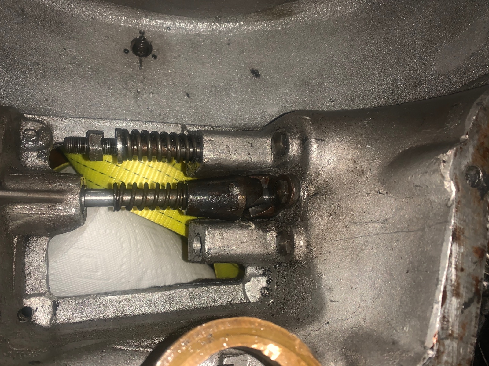

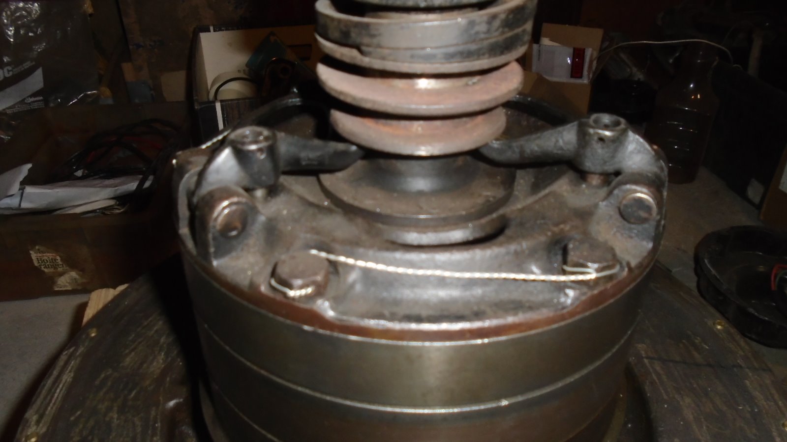

After blowing up your photo I see your problem, the clutch fingers are not adjusted correctly, the cotter pins are missing and the screws are backed out. The clutch is dragging so you can't crank.
Kerry
I mentioned in the text that I removed the screws so there was no pressure on the clutch plates. With the screws in place I couldn’t turn the rear wheels.

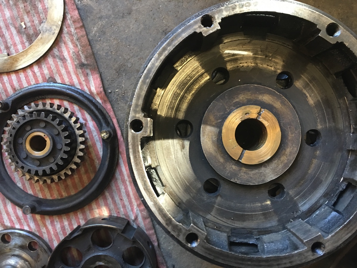

Could it be a mismatch between early and late parts that has taken up all of the play between the clutch and brake drums? I seem to recall that early transmissions had a different shim pack than the later ones.
Tony simular issue with current motor
Taken tranny apart to the clutch drums spin free and correct drum will turn if spinning the rearwheels or crand
Only thing i see is my clutch plates are hanging up on the
Shoes of the brake drum
So looks like i have new brake drum in my future.
Only thing i notice on my trans is clutch fingers screws
are out pretty far from other trannies i put together
I have in the past left two clutch dics out 23 not 25 worked just fine
Mark yes there is
Early uses a brass trust pkate no longer availible
Later uses threee steel thrust dics
Also difference in clutch baskets
I'm not sure but ive seen difference in the push rings 1/16 or about thickness of a clutch dics
I would suspect miss match parts getting my common
I was wrong in thinking only the brake drum should turn, after reading the MTFCA transmission book they are operating correctly.
So either the bands were hanging, or the Clutch was not releasing. Being an early hogs head with the small square hole it’s tough to see and measure. Also I guess the plates could be hanging.
I’ll put the hogs head back on with no bands and no screws. So there should be no pressure on the clutch and no band friction
I rather suspect the clutch plates are catching
Possibly when the engine was rebuilt the tolerances were too tight. If it were me I would add some extra oil and run it in for a few hours. Might be all it needs.
- Posts: 6809
Tony
with those 3 screws released, your high speed clutch is fully engaged. Any cranking you do will be fully transmitted to the rear wheels.
with the hog's head off as it is, I believe you ought to lift the rear end or at least one side, and crank the engine (with ignition off!). If it is AS stiff as it was before, then you just have a tight engine
Sorry Tony, missed that you backed off the screws, as posted, the early clutch packs had a thick spacer to stop the first clutch plate from slipping inbetween the drum and clutch hub, could be hanging up on that.
Scott_Conger wrote: ↑Sat Feb 08, 2020 9:25 pmTony
Are you sure about that???
I believe that with the screws removed there is no pressure on the clutch plates and then the plates are free to rotate.
I know that when the clutch slips, the solution is to tighten the screws clockwise. Therefore taking the screws out (counter clockwise) will remove all pressure.
After thinking about it overnite I believe there are at least three possible sources of friction:
1 the clutch plates are catching on grooves in the brake drum
2 for various reasons I used demountable bands even though they cannot be removed thru the inspection hole in the hogs head. These bands are thicker than the non demountable bands and they may be trapped between the hogs head and the drum
3 the early drum notches do not reach the very full length of the brake drum so the first plate is extra thick. I cannot remember what I installed. If I used regular disks, they will get trapped and cause excessive friction.
That 09-16 spacer that looks like an extra thick clutch disk (part #3330) can become jammed between the brake drum and the clutch drum if the face of the brake drum is sufficiently worn. In my case that put the car in permanent high gear. Maybe it's possible for the spacer to jam partially, allowing the clutch to turn with drag. My temporary solution was to spot weld an extra clutch disk to the spacer, making it too thick to jam between the two drums. Later I installed a better brake drum.
A few years ago I worked on a friends newly acquired '13 chassis that he purchased with a "rebuilt" engine and transmission. The engine was so tight that standing on the crank would barely turn the engine over. I found the problem to be that the genius that replaced the pedal cams on the aluminum hogshead installed the bolts from the outside with the castle nuts on the inside. With the hogshead installed the castle nuts pushed down on the bands so hard that it prevented the engine from turning over. Tony, I know you've been playing with Ts for years and the possibility is quite remote but could it be that that is the trouble?
I just checked the three bolts. The thin heads are all on the inside.
If you still have the bands out, and the engine/transmission is still in the car, with rear wheels jacked up, how does it turn? If still tight it is the engine, 4th main or the differential which is causing the bind. If it turns easily in high gear all drums should move at the same speed. I would suspect the problem could be the clutch or a dragging band. it also could possibly be one or more tight bushings either in triple gears or the hubs inside the gears.
I have been very reluctant to offer any suggestions because I am not familiar with the very old models. The oldest one I have worked on is a 14.
I wish you well in your endeavor to find and correct this problem.
Tony another thing check how thick are the bands
What type bands
Had a guy put in set of bands .030 thicker then other set i had and after we swap them car cranked easier
With the bands out how does it crank?
Could be bands, clutch dics drag/ hangup, miss aligned pan
What type bands

What am I missing here, if I compress the spring the clutch will disengage, if I release the spring the clutch will engage, if I remove the finger screws the clutch remains engaged. The only way this transmission will disengage is when I compress the spring. What am I missing?
( I don't know why the first photo is duplicated.)

Adam
- Posts: 1608
- First Name: Adam
- Last Name: Doleshal
- Location: Wisconsin
David, I looked closely at your photos and it appears that the 3 dowel pins on your clutch push ring that come thru the driving plate cover are sticking out a bit too far. Normally, on most Model T’s, when you remove the 3 adjustment screws, the ends of the arms will bottom out on the flange of the driving plate shaft and there will be slight clearance between the arms and the push ring dowel pins, thus fully releasing the clutch. This is not happening on your transmission. It may or may not be something that requires repair. I can think of few reasons this could be occurring, but in most cases if your transmission is running and driving okay there probably isn’t anything that would really require immediate repair.
Altair
- Posts: 384
- Joined: Thu Jan 17, 2019 11:52 am
- First Name: David
- Last Name: Menzies
- * REQUIRED* Type and Year of Model Ts owned: 1926 Touring and 1915 Touring both Canadian models
- Location: British Columbia
- Board Member Since: 2012
This transmission was assembled with 13 small thrust plates and 13 large thrust plates plus a distance plate as per the 1915 parts book. I know some later units have only 12 small, 13 large and no distance plate. With one less small clutch plate and no distance plate would allow a greater distance for the fingers to travel and would probably allow the clearance you are talking about. This 1915 transmission is an original and is assembled as per the 1915 parts manual. I had a lengthily discussion with a reputable transmission re-builder as to the number of plates in a 1915 transmission and he was of the opinion that it had 13 large and 12 small and no distance plate as this was the way he had always assembled them. I brought his attention to the 1915 parts book and he was not aware that it was 13,13 and a distance plate. I went to a swap meet at Bakersfield and a vendor was selling transmission parts by the 5 gallon pails full and there was a pail full of clutch discs I asked the vendor if he had a distance plate for a 15 and transmission and he had never heard of the part. I started digging through the 500-600 discs and fortunately I found the only distance plate he had, and he said he had never seen one.
I saw some photos of a newly assembled 1915 transmission and when assembled the tops of the finger adjusting screws were near the bottom of the slots therefore only allowing about one turn of residual adjustment. This appeared somewhat incorrect to me, I contacted the assembler and questioned the assembly and I was informed that he had been doing this for 40 years and he was sure it was correct.
I further persevered with my inquirey to his frustration until he examined a non molested transmission and found it to have 13 small, 13 large and a distance plate with the adjustment screws well above the tops of the fingers.
With this configuration the only way to release the clutch pressure is to compress the spring. With the 12 - 13 disc arrangement less the distance plate I would agree that removing the adjusting screws would release the pressure on the discs. I have a 1926 transmission and there is no pressure on the discs when the adjusting screws are relaxed, however not so on the 15.
In Chaffins parts book it shows part nos 3328/29 clutch disc set, original, steel (09 27) (25 piece).
They are not the same from 09 - 27 and there is no mention of the distance plate, part no. (3330) and there are 27 pieces up to about 1917 and 25 pieces in later units.

In describing the problem to some friends we found this picture of the brake drum of the 09 during assembly.
As you can see the lugs are in excellent condition so the plates are not hanging on them. However the lugs do not reach the back of the drum so it does require the thick drum. I honestly cannot remember if I did indeed use a thick plate........

Kerry
- Posts: 1464
Looks like the spacer in the top left corner of your photo, so it must have had your attention at some stage.
jab35
- Posts: 1037
- Last Name: Bartsch
- Location: Dryden, NY 13053
The lugs appear to have been filed, maybe more than once, do the the plates still bear equally against all six lugs? It's tricky to hand file these to exactly match the plates. Not a criticism of your work, just something to consider, best, jb
- Posts: 7411
If the #3330 spacer is missing, that will let disks jam between the drums. That would be my second guess, after thick bands being compressed by the hogshead. Let us know what you find.
TonyB
Topic author - Posts: 663
- First Name: Tony
- Last Name: Bowker
- Location: La Mesa, CA
Kerry, the only thick clutch plate I remember seeing was a large plate with the cut outs on the outside of the ring.
Tony Bowker
La Mesa, California
La Mesa, California
modeltbarn
- Posts: 346
- Joined: Sun Jan 06, 2019 6:59 pm
- First Name: Gary
- Last Name: London
- * REQUIRED* Type and Year of Model Ts owned: 1911 Touring
- Location: Camarillo
I agree with Kerry, that looks like the distance plate in the picture, not a clutch disc.
I have had an interference problem with removable bands. It's been some years, I know I was able to correct it with a little careful grinding. I'm thinking it was on the removable ear itself, it may have been on the reinforcing web inside the hogshead. This would have been on an aluminum hogshead, but not the early one with a square cover. I caught it during assembly because the band wouldn't completely release.
I also agree with Steve; if the distance plate is catching you're screwed......
If you've got the hogshead off and still have a problem turning the car over by hand, and if you can move the bands around the drums, then it's not the interference issue. At that point it seems like your best course is to pull it apart and recheck everything (and every measurement) in the transmission. You'll know for sure if you used the distance plate.....and you want to know! I know this is obvious, but as you assemble make sure everything rotates freely at each step. I just don't see a good alternative; you don't want to take a chance of wreaking an early block.

This afternoon I had an hour to spare so I installed the hogs head with just the low transmission band. The low band was the style with the long thin ear and measured thicker than the more common button style. There is a little more drag but both ears appear to be quite loose until the pedal is depressed.
So I don’t think the hogs head is trapping the band onto the drum.

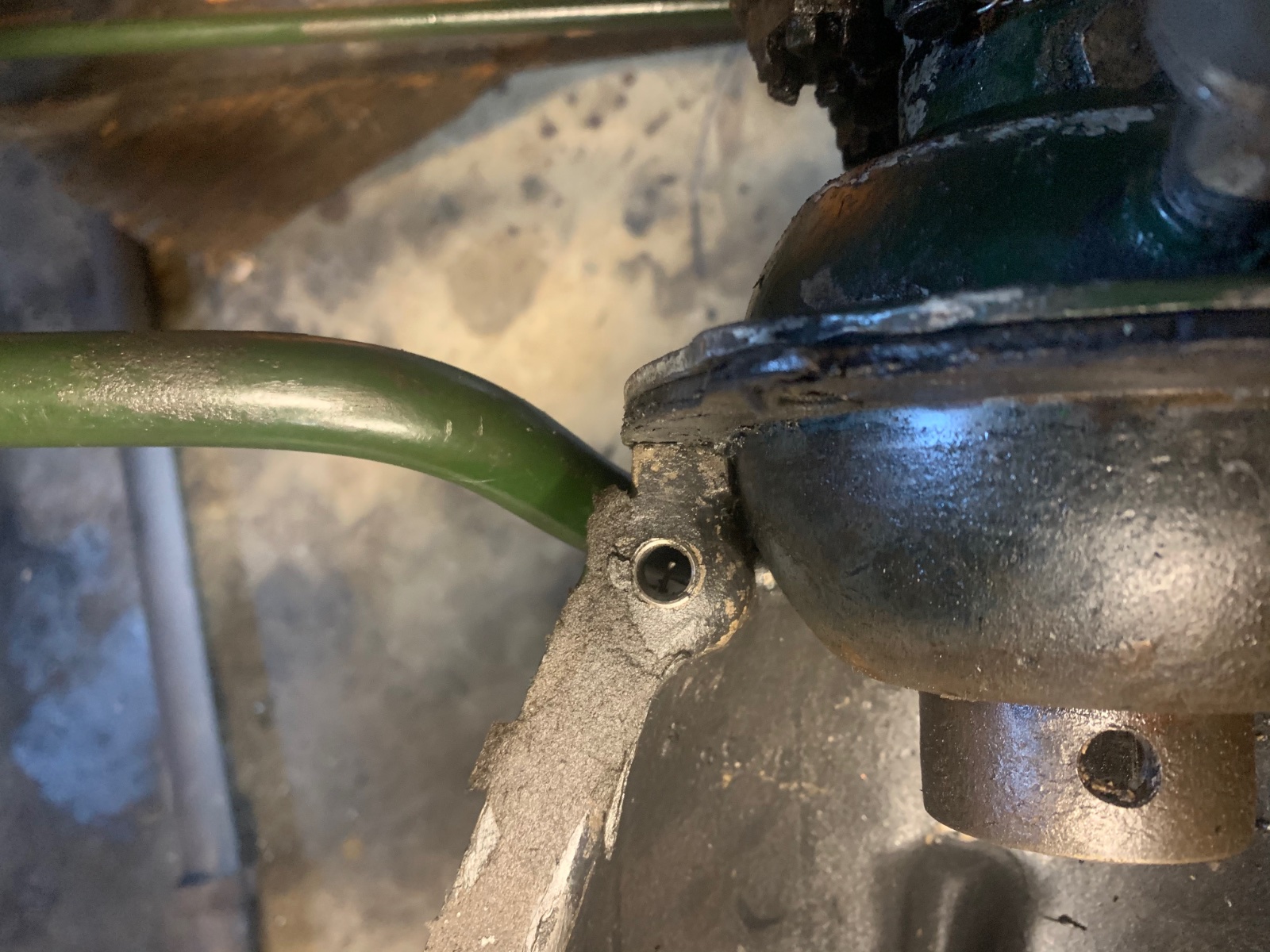

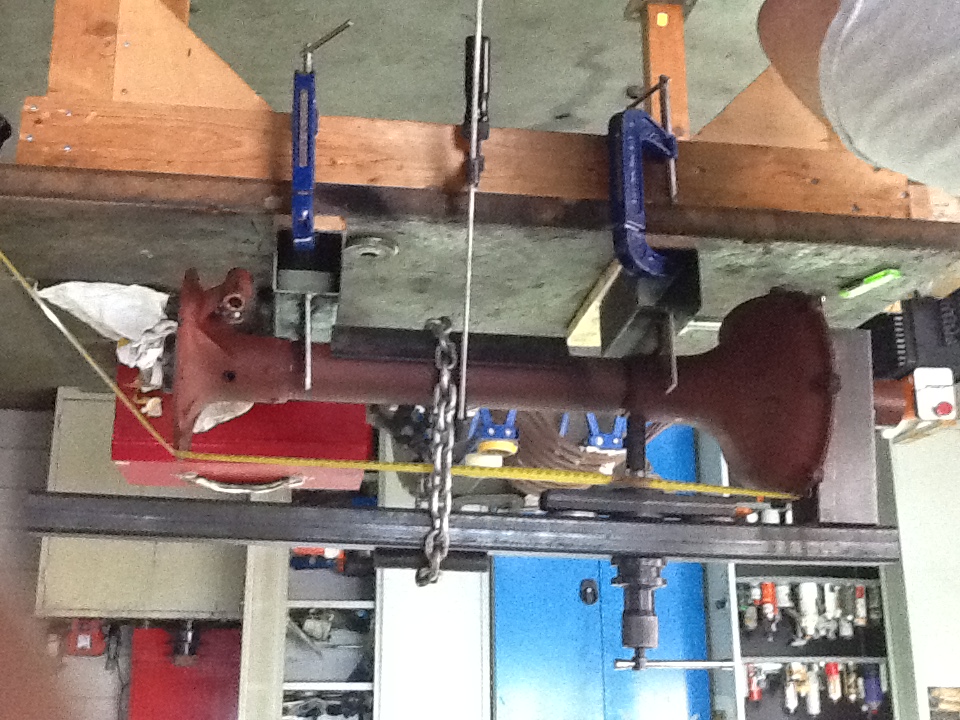

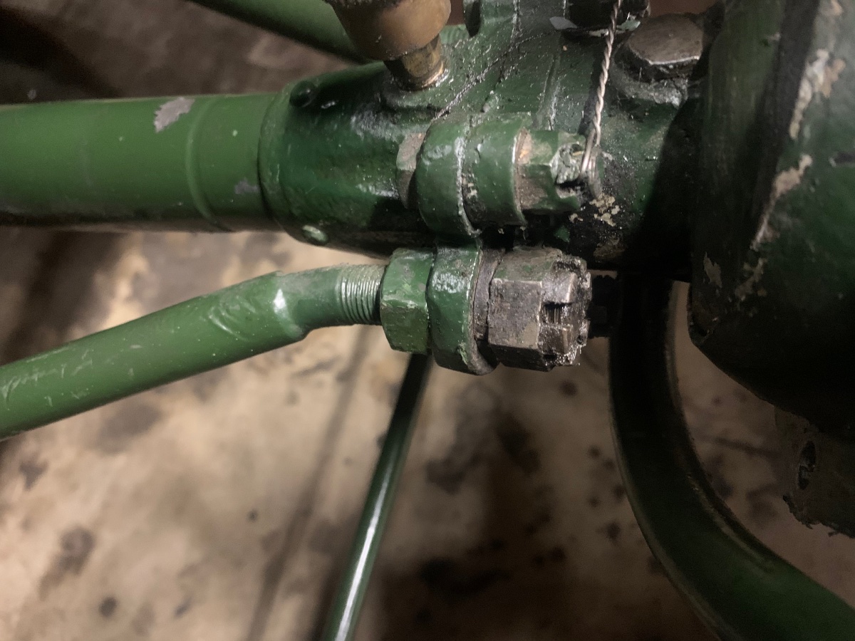

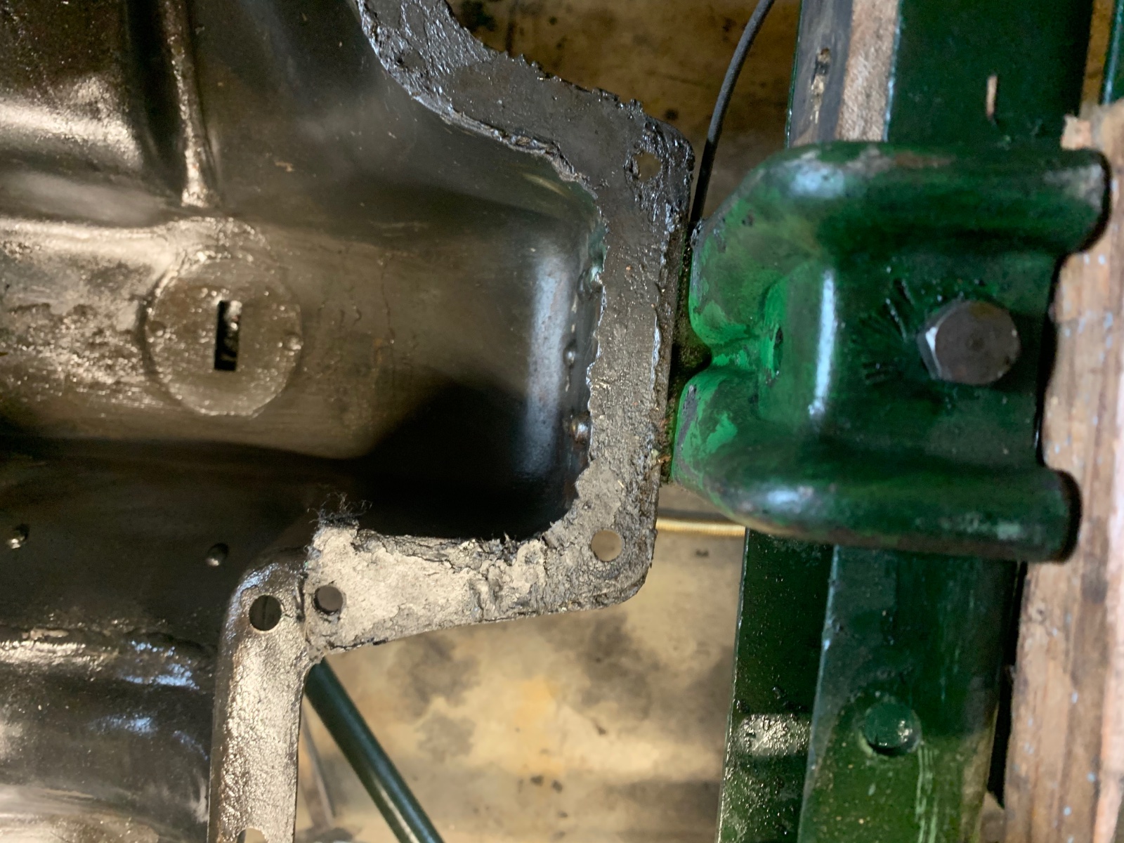

Well after a couple of weeks poking around I believe I have located the problem.
In the course of the work I removed the motor, more later. While it was out I replaced the hogs head and flywheel with a starter version and ran the motor. It turned fine and after a little adjustment of the five ball carb it runs well. I also checked the transmission and clutch, both are just fine.
Now back to removing the motor. When I loosened the front two bolts, after the initial tightness I can usually remove the screws with my fingers. Not this time. As I loosened the bolts, the bridge kept rising keeping pressure on the bolts. Odd. So I pushed the motor down and removed the screws and let go of the motor. The nose rose up about three inches. Yes I’ve never seen this before and most of you doubt me but it happened. When I removed the four bolts at the UJ the back axle moved back about half an inch. When I pull the hand brake the axle moves forward until it touches the pan. The force of the misplaced axle could lift the nose of the engine. This believe was bending the pan and causing the hard cranking.
Just in case any doubters question the pan location, the pictures below show the nose and arms of the pan during the test. Prior to assembly the pan was straightened on a fixed by a renounced mechanic who has all the equipment for these early cars. As a check, the wheel base of the vehicle was compared to the 24 coupe and the 14 touring and sure enough it is about half an inch longer.
The present plan is to run the motor in over the next few weeks while the location of the axle is investigated. The plan is to have it completed by May in time for a local car show in Fallbrook.
Tony Bowker
La Mesa, California
La Mesa, California
- Posts: 4694
It would be interesting if others on the forum who have an 09 could measure the wheelbase and the length of the driveshaft to see if it might have possibly been shortened in later production? A question for Tony, did you check whether your frame was level and straight while the body was off? Is it possible that the frame sags at the rear engine mounts? It would also be interesting to check the crankcase on a fixture. I don't personally know who in southern California might have one? This would determine whether your problem is in the crankcase.
Good luck Tony. Your problem is perplexing.

2nighthawks
- Posts: 407
- First Name: Harold
- Last Name: Schwendeman
- Location: Seattle
Tony - First of all, thanks so much for taking the time and making the effort to keep us "updated" with the "write-up" and excellent photos of your finding thus far. Quite a unique set of circumstances so far. Has to be frustrating after all of your efforts in connection with a long and tedious but very thorough and beautifully done restoration.
The variation in wheelbase is certainly an "oddity"! I can't help but wonder if that half inch variation in wheelbase length was determined with rear spring firmly affixed in the rear crossmember, and with the spring perches tightened normally. Wondering if perhaps the spring might have been slightly "cocked" when the U-bolts were tightened, especially if there was some kind of cushioning pad installed between spring and crossmember. Or could one of the perches be slightly bent and somehow mis-aligned,.....altho' that seems even more "far-fetched" than the whole rear spring being slightly "cocked" in the crossmember when U=bolts were tightened. Just sort of,...."thinking-out-loud" Tony. Whatever the case, it sounds like you're getting the source of the problem narrowed down, and you'll find it,......harold

Scott - my theory on the the axle being too far back is that the torque tube is at an angle so it pulls the motor, which is normally horizontal, pulls the motor to the same angle, thus raising the nose. When the nose is constrained by the front bolts, the early pan bends causing excess friction.

Today rather than packing for Chickasha, I checked the rear spring on the 1909. Man that thing is heavy.
My thought was to just reverse it and see how the gap changed. After three hours pushing and shoving, the gap is exactly the same.
So the problem is not the spring.
Before the rebuild, I checked the chassis for flatness and it was within 1/8” along both sides
I wonder if the cross member at the rear is distorted??

One other thing which I have thought of since my last post: The possibility the spring has either sagged or is too tall? The length of the wheel base changes as the spring is compressed. When the spring is sitting tall, the rear wheels are closer to the fenders, but as the spring is compressed, it gets farther away. So that could explain the difference in wheelbase.
In at least one of the pictures, it looked like the ball was to one side of the pan. Is it square with the rear of the transmission now?

As usual with these complex problems, the cause and therefore solution was staring me in the face but I was too focussed to see it.
Look at the nuts on the radius rods. Notice how close the it is to the end of the thread. Yes it’s about 3/8” along the rod than normal. The early axle housing is bent.
I’m told by an expert in these early cars that it is a common problem and 1/2” out of line is quite usual. So the differential housing is bent backwards compared to the axle ends
I would have expected it to bind up being so far out of line but these early axle housings are so flexible that they continue to function even when bent.
Next problem is how to straighten it, maybe I can find a fixture somewhere. The alternative is to carefully measure a later axle and adjust this 09 until the dimensions match.
Watch this space.

My T must have been T-boned from the right sometime in the past, the right radius rod was bent in and the right half of the rear axle was bent forward. it turned out the bend was right close to the diff housing, I decided to try and straighten it myself.
This is the contraption that i came up with, its jury-rigged but it worked and it was made with what i had on hand in the shop;
first i found a piece of thick walled tube that fit snugly into the old bearing sleeve and was long enough to support the length of the diff housing all the way in to the rivets.
Next i found a piece of square tubing big enough to drill a hole in to slide the pipe through, then a piece of heavy square tubing across the top with a hole drilled so my hydraulic puller fitted through so i could use it as a press, and last a piece of heavy chain and a piece of scrap angle iron to spread the load from the chain and have the axle housing bend where I wanted it to bend
some pressure added and carefull use of the torch to heat the place where the tube had to stretch and presto !
I checked for straightness by measuring from housing flange to brake backplate on top and bottom, if both are the same the housing must be straight.
After about five cycles of pressure, heat and cooling down i got it right, after assembly of the axle the shaft is just under a tenth inch off center, good enough for me,
Good luck !
Good luck !

Should have mentioned the two pieces of square tubing are only welded on th outside so the piece of big square tube with the pipe through it can flex away from the pressure point otherwise the whole setup would be rigid and won't work
The clamp in the middle is just there to prevent the whole setup from rolling off the table, its kind of top heavy so that was an issue but the clamp is only just tight enough to prevent that from happening without distorting anything, only "fingertight"

Tony, the lock washer goes against the rear nut, not the castle nut. The castle nut has a cotter pin to keep it from loosening. The other nut needs a lock washer.

Remove the lock washer and the castle nut will be about where it’s supposed to be. I wonder if that is indeed the issue...

I was wondering the same thing in thinking that moving the split washer to the backside, it would look pretty normal...and If the rear axle is really bent to the extent that it has been explained, I would have thought that putting in the outer axle bearings would have been quite a wrestling match. And if it was, that memory would likely stick with me even if I didn't understand the significance of it at the time. All speculation I suppose and truely hope Tony shares the final results...I'm pretty sure he will.

Well after nearly three months of messing around, we found the cause of the hard cranking on the 09.
You may remember that when we disconnected the drive shaft it cranked easily so we deduced the problem lay in the position of the rear axle was about 3/8” too far back. Eventually I installed a later rear axle, thanks to the Klecan’s, which we believed was fairly straight and sure enough the UJ was still about 1/4” from the pan indicating either spring or rear cross member was bent. I reversed the spring with absolutely no change so the know that the rear cross member is definitely bent.
Next the choice was to removed the body and rework the cross member or to add a shim. I chose the shim.
Then I re-installed the original axle and it was still about 1/8” from the UJ so we deduced the axle housing was a little bent which we corrected by adjusting the two radius rods. The axle still function nicely.
Now the axle just touches the pan perfectly. Job done.
I would just like to thank everyone who helped and commented during the thread, keep safe during these difficult times.
