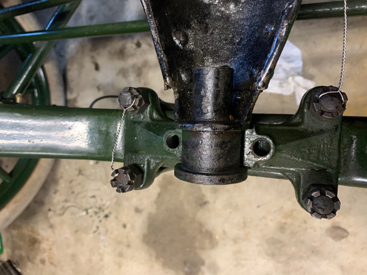

I just checked the three bolts. The thin heads are all on the inside.
Three cam bolts
Three cam bolts
Thanks for the idea.

Post by TonyB » Wed Mar 11, 2020 4:30 pm
Well after a couple of weeks poking around I believe I have located the problem.
In the course of the work I removed the motor, more later. While it was out I replaced the hogs head and flywheel with a starter version and ran the motor. It turned fine and after a little adjustment of the five ball carb it runs well.
1909 motor running.
1909 motor running.
I also checked the transmission and clutch, both are just fine.
Now back to removing the motor. When I loosened the front two bolts, after the initial tightness I can usually remove the screws with my fingers. Not this time. As I loosened the bolts, the bridge kept rising keeping pressure on the bolts. Odd. So I pushed the motor down and removed the screws and let go of the motor. The nose rose up about three inches. Yes I’ve never seen this before and most of you doubt me but it happened. When I removed the four bolts at the UJ the back axle moved back about half an inch.
Gap between pan and rear axle
When I pull the hand brake the axle moves forward until it touches the pan. The force of the misplaced axle could lift the nose of the engine. This believe was bending the pan and causing the hard cranking.
Just in case any doubters question the pan location, the pictures below show the nose and arms of the pan during the test. Prior to assembly the pan was straightened on a fixed by a renounced mechanic who has all the equipment for these early cars.
Nose of the 1909 pan
Arm of the 1909 pan
Arm of the 1909 pan
As a check, the wheel base of the vehicle was compared to the 24 coupe and the 14 touring and sure enough it is about half an inch longer.
The present plan is to run the motor in over the next few weeks while the location of the axle is investigated. The plan is to have it completed by May in time for a local car show in Fallbrook.

Posts: 4684
Re: Hard crank on my 1909 touring.
Post by Norman Kling » Wed Mar 11, 2020 5:10 pm
It would be interesting if others on the forum who have an 09 could measure the wheelbase and the length of the driveshaft to see if it might have possibly been shortened in later production? A question for Tony, did you check whether your frame was level and straight while the body was off? Is it possible that the frame sags at the rear engine mounts? It would also be interesting to check the crankcase on a fixture. I don't personally know who in southern California might have one? This would determine whether your problem is in the crankcase.
Good luck Tony. Your problem is perplexing.

Post by 2nighthawks » Wed Mar 11, 2020 7:03 pm
Tony - First of all, thanks so much for taking the time and making the effort to keep us "updated" with the "write-up" and excellent photos of your finding thus far. Quite a unique set of circumstances so far. Has to be frustrating after all of your efforts in connection with a long and tedious but very thorough and beautifully done restoration.
The variation in wheelbase is certainly an "oddity"! I can't help but wonder if that half inch variation in wheelbase length was determined with rear spring firmly affixed in the rear crossmember, and with the spring perches tightened normally. Wondering if perhaps the spring might have been slightly "cocked" when the U-bolts were tightened, especially if there was some kind of cushioning pad installed between spring and crossmember. Or could one of the perches be slightly bent and somehow mis-aligned,.....altho' that seems even more "far-fetched" than the whole rear spring being slightly "cocked" in the crossmember when U=bolts were tightened. Just sort of,...."thinking-out-loud" Tony. Whatever the case, it sounds like you're getting the source of the problem narrowed down, and you'll find it,......harold

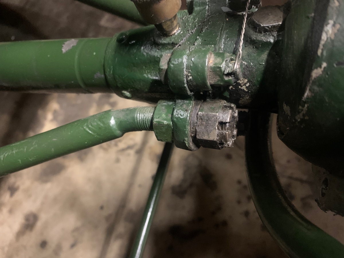

Post by TonyB » Fri Mar 20, 2020 2:14 pm
As usual with these complex problems, the cause and therefore solution was staring me in the face but I was too focussed to see it.
Look at the nuts on the radius rods.
Nut on radius rod
Nut on radius rod
Notice how close the it is to the end of the thread. Yes it’s about 3/8” along the rod than normal. The early axle housing is bent.
I’m told by an expert in these early cars that it is a common problem and 1/2” out of line is quite usual. So the differential housing is bent backwards compared to the axle ends

Tony, the lock washer goes against the rear nut, not the castle nut. The castle nut has a cotter pin to keep it from loosening. The other nut needs a lock washer.

Remove the lock washer and the castle nut will be about where it’s supposed to be. I wonder if that is indeed the issue...

Adam
I was wondering the same thing in thinking that moving the split washer to the backside, it would look pretty normal...and If the rear axle is really bent to the extent that it has been explained, I would have thought that putting in the outer axle bearings would have been quite a wrestling match. And if it was, that memory would likely stick with me even if I didn't understand the significance of it at the time. All speculation I suppose and truely hope Tony shares the final results...I'm pretty sure he will.
Good luck Tony!

Here's my simple solution to a similar mis-alignment. This can be done with the axle still in the car (water and a fire extinguisher always at the ready).
Not seeing any problem with your radius rods at the torque-tube, other than previously noted lock washers on the wrong side of the mounting flange.
Distance from the axle threaded ends to the center of the torque-ball needs to be equal. Use the radius rod nuts to jack screw these as needed, then lock down and cotter pin them. Threaded radius rod lengths forward of the mounting flange may or may not be equal assembled length...not a problem.
Regards,

Well after nearly three months of messing around, we found the cause of the hard cranking on the 09.
You may remember that when we disconnected the drive shaft it cranked easily so we deduced the problem lay in the position of the rear axle was about 3/8” too far back.
09 axle before adjustments
Eventually I installed a later rear axle, thanks to the Klecan’s, which we believed was fairly straight and sure enough the UJ was still about 1/4” from the pan indicating either spring or rear cross member was bent. I reversed the spring with absolutely no change so the know that the rear cross member is definitely bent.
Next the choice was to removed the body and rework the cross member or to add a shim. I chose the shim.
Then I re-installed the original axle and it was still about 1/8” from the UJ so we deduced the axle housing was a little bent which we corrected by adjusting the two radius rods. The axle still function nicely.
Now the axle just touches the pan perfectly.
09 axle after adjustments
Job done.
I would just like to thank everyone who helped and commented during the thread, keep safe during these difficult times.
