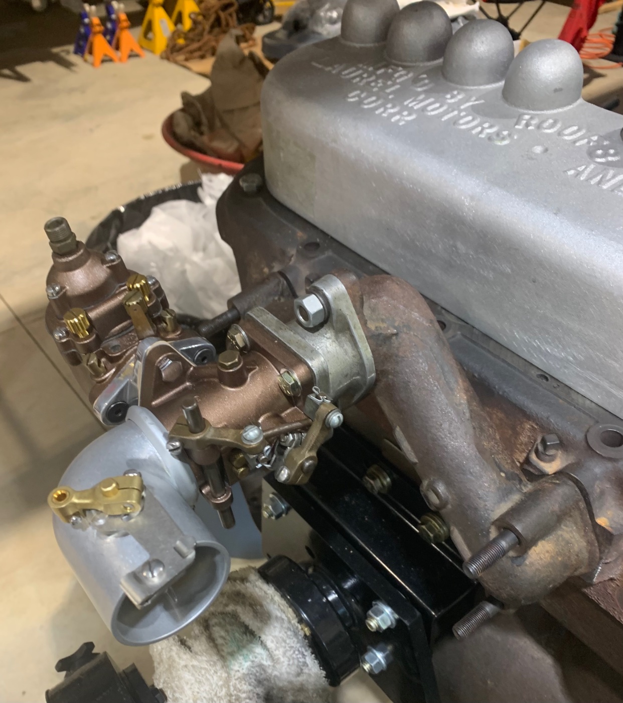

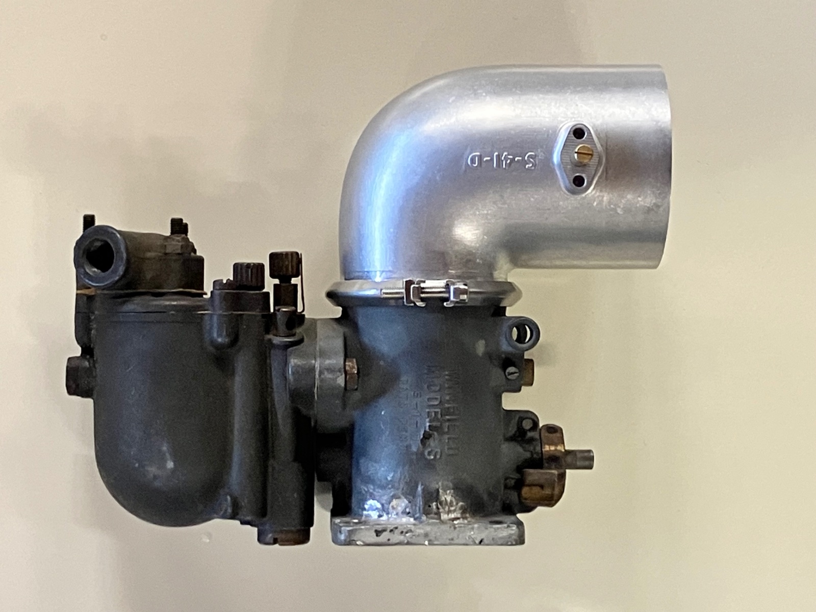

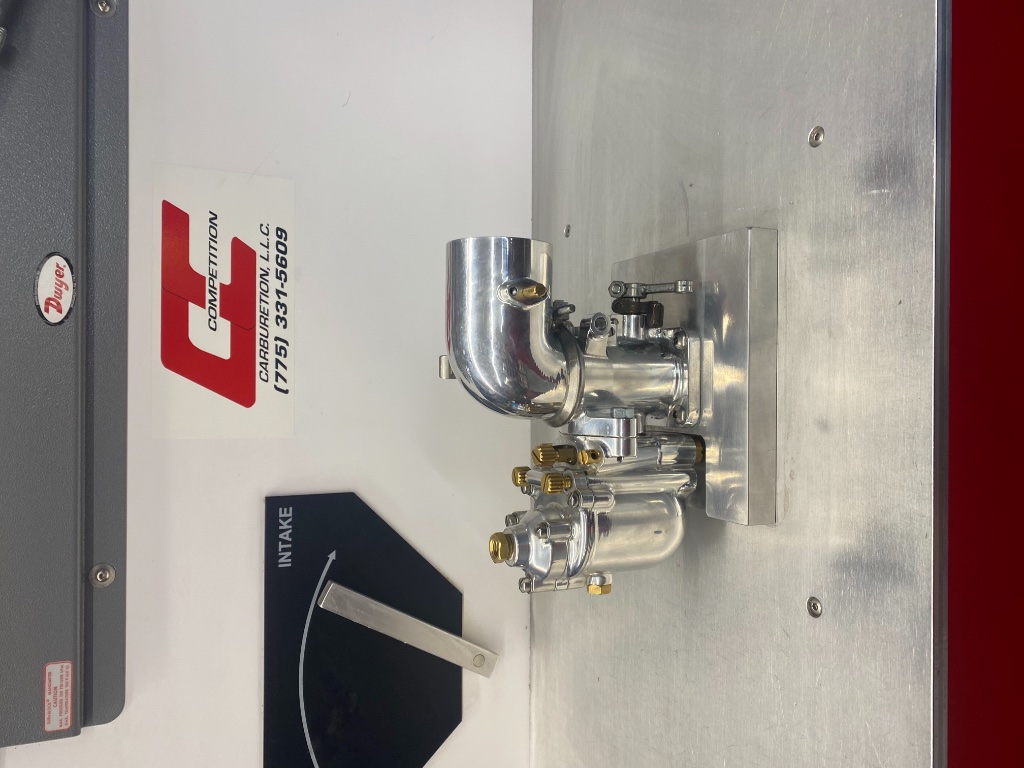

Had a chance to get away today and bring my new Winfield home from the carb guru. Here is a pic of the carb on the flow bench
This little carb did look a bit out of place amongst all the big dog 4 barrels in his shop... some of those monsters could have passed this thing right thru!

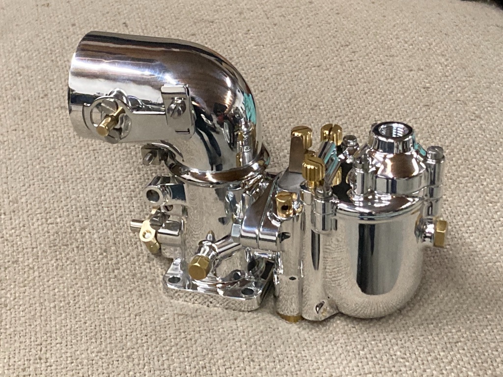

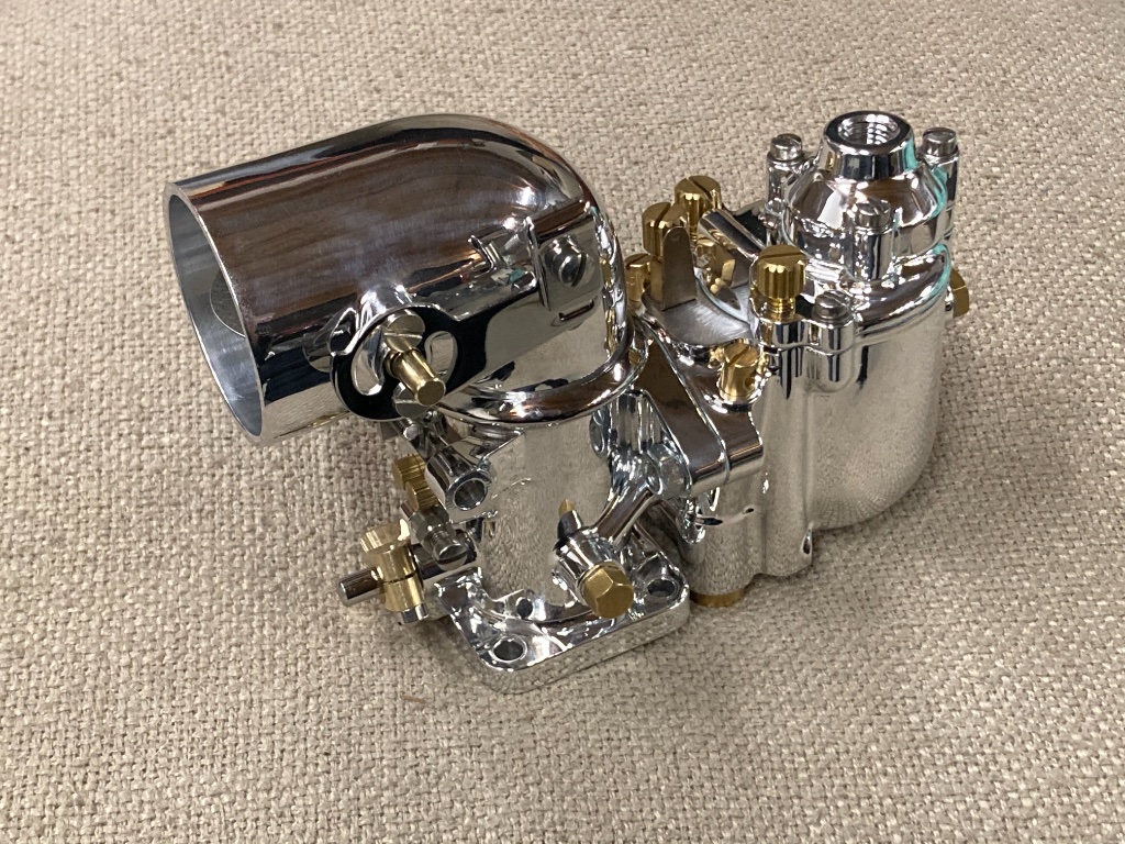

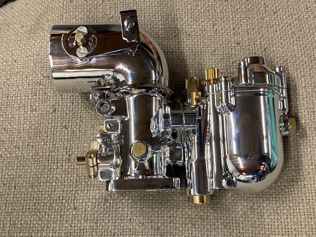

Re: Playin in the shop today...
Had a fella work on the polish... now it’s wasaaaaay to nice to put on anything I own...
Kevin
that really is nice

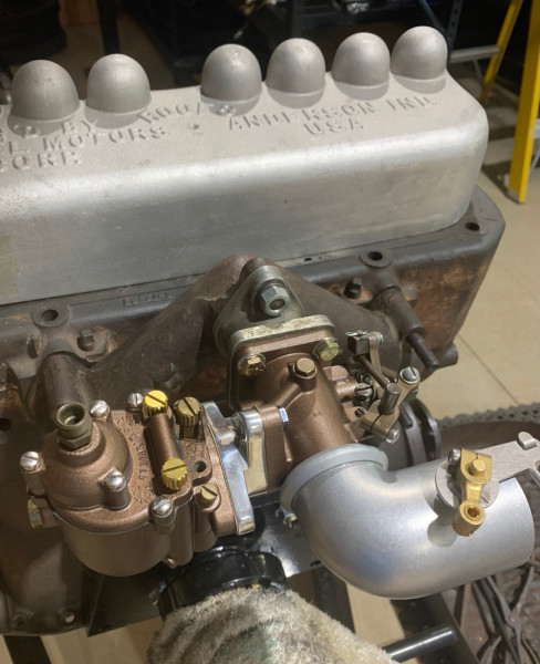

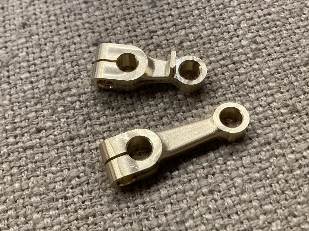

Been working towards completing all the little trinket details before the Tulare swap meet.
A couple years ago I started making really intricate machined choke levers that looked like they had been folded up out of sheet metal just like the originals. Not sure if I ran out of patience, or maybe the project just wasn’t meant to be... but I scrapped the project the other day and started drawing up the earlier cast brass version. I’m glad I did, cuz the throttle stop, throttle arm, and choke arm all share similar design characteristics and so design and manufacturing went very smoothly for all.
I’m determined to make the pivoting choke cable clamp, and spring tab for the idle needle today. Then, all that’ll be left to make is the float ball...

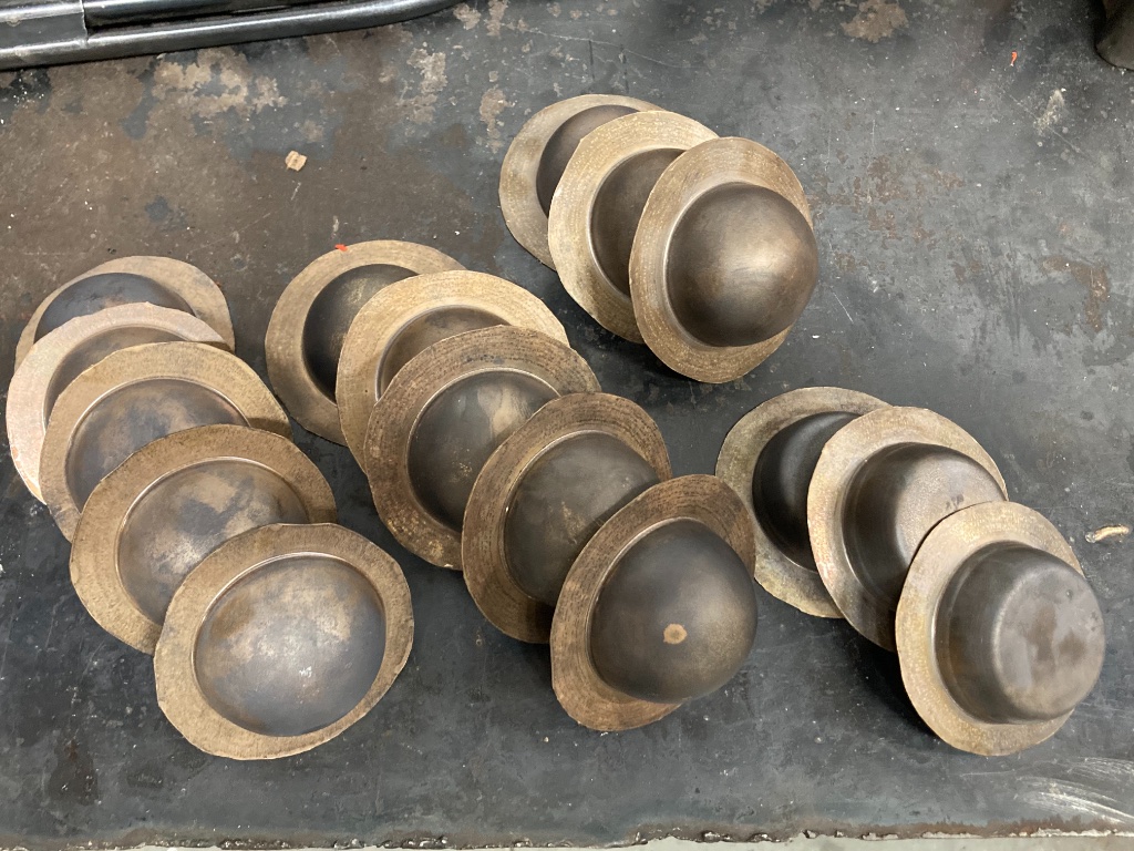

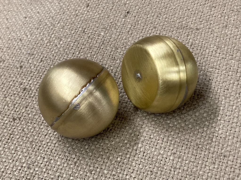

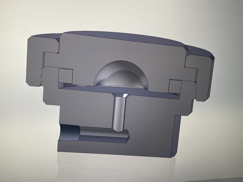

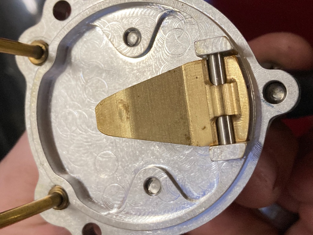

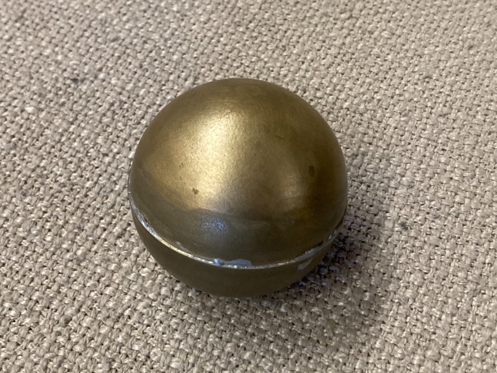

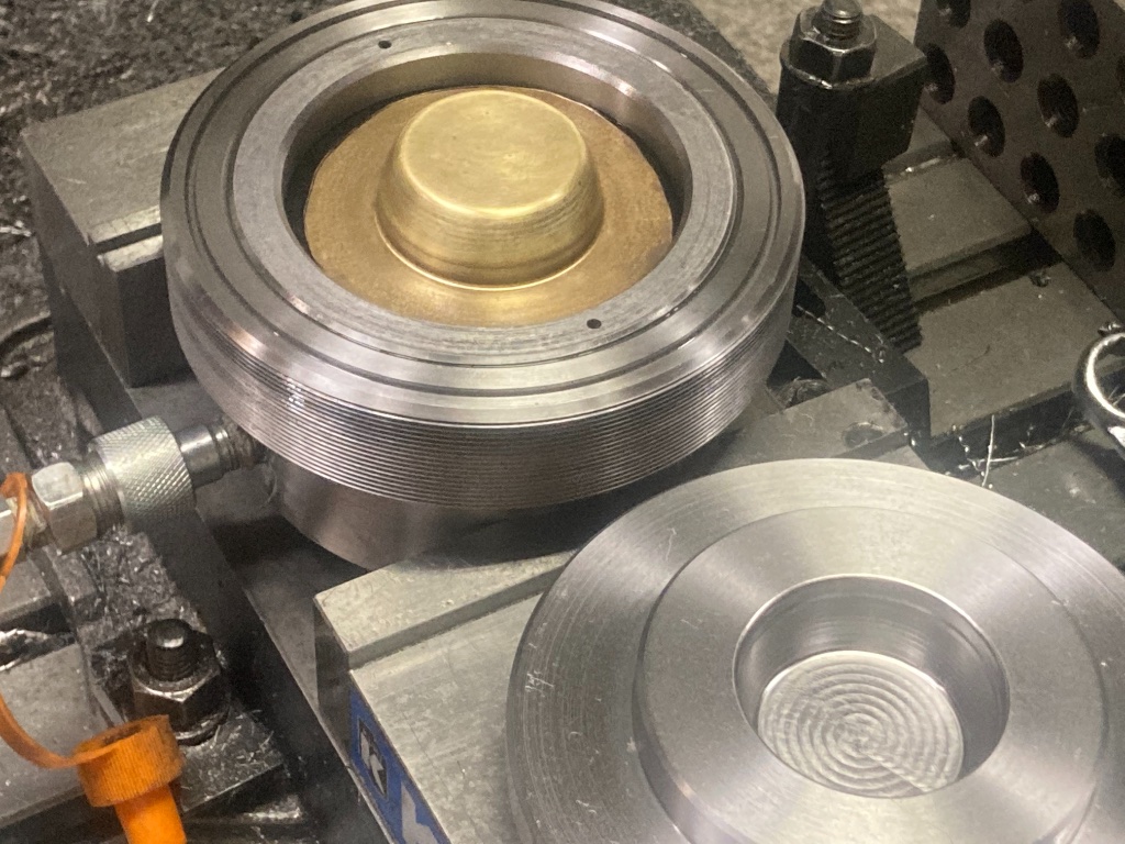

Guess it’s been a while since the Tulare swap...
The float project WORKED!!! Hydraulic forming was not near as simple as it sounds, but was able to develop a sound process involving several annealing steps that would ultimately yield good parts. A couple floats were soldered together and checked for proper weight and size.
Here is the hydraulic forming fixture concept; And after several hours of machine work; After several more hours of forming; And finally, after several minutes of soldering; Both float styles came out on size (that was the easy part), and on weight (a bit trickier). The full sphere Model S float weighs in at a whopping 30 grams, and the flat bottom Model SR a mere 22 grams.

Kevin Pharis
Topic author - Posts: 1656
- First Name: Kevin
- Last Name: Pharis
- Location: Sacramento CA

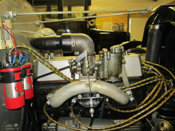

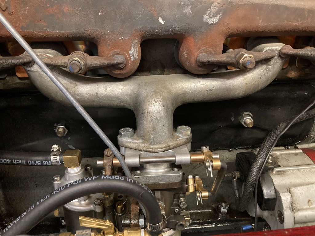

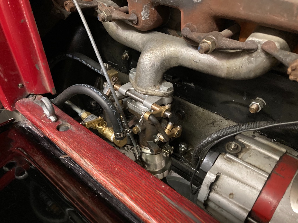

As seen in another thread, I installed a Model S-AA updraft on my touring car several weeks ago. This carb was mostly original, but had as many of my own components installed. Choke horn, choke linkage, V band clamp, carb adapter, throttle shaft, bushings, butterfly, float bowl cover, fuel inlet, and one of the new floats!
Since then we have driven bout 600 miles, made up from a number of local drives of various lengths, and a 450 mile adventure around the Olympic Peninsula in Washington state. Probably should note the 1600 miles on the trailer too. Thought I would pull the float cover off today to inspect the float and float lever for wear, tear, and corrosion.
It all looks beautiful! The float lever has a tiny polish point right where it should be, and the float ball has simply a bit of tarnish

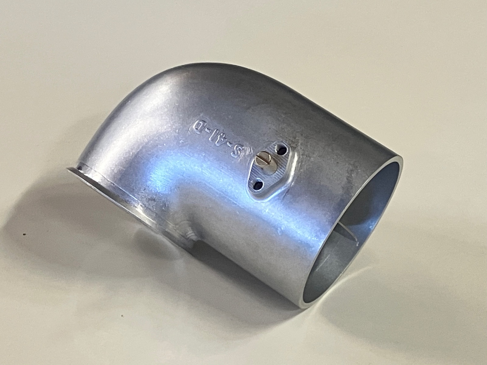

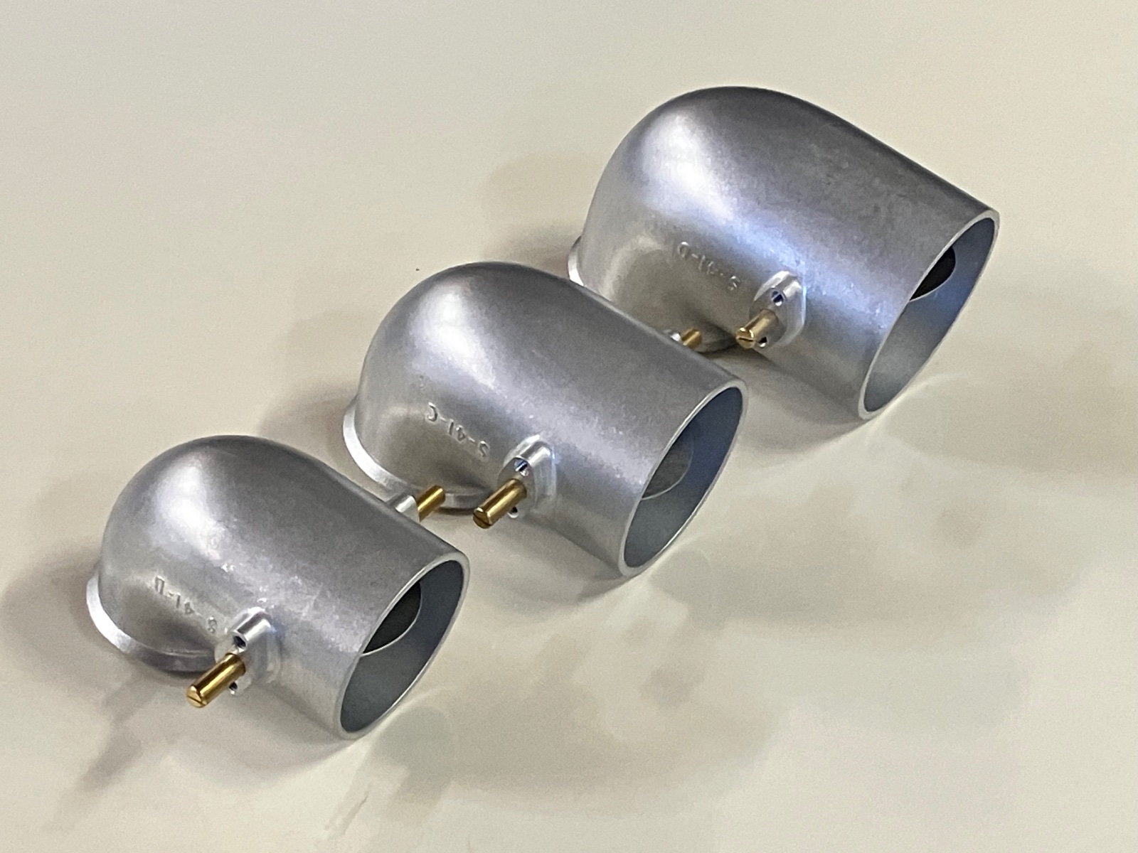

Been playing again…! This time a CC/D choke horn. It’s almost a complete collection

I just received a new choke horn assembly from Kevin to go on my SBU that has been converted to side draft for my Roof 8 speedster build. The parts fit great and look just like the original bits on my ‘27 Runabout with an iron RAJO and a SBD.
Thank you Kevin for making these hard to find parts available.

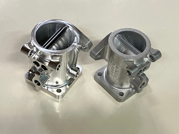

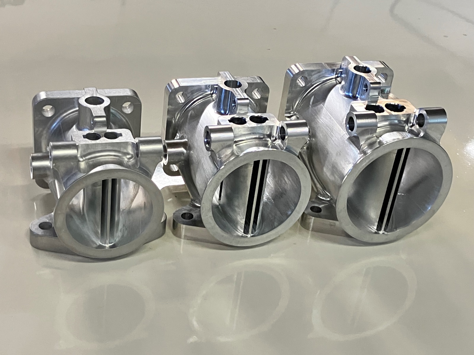

Just finished machining this new S-C barrel. Here it is compared to a B. About 50% more air flow!

Now you’re just teasing. There’s only a couple guys on this forum who could run a C on their T.

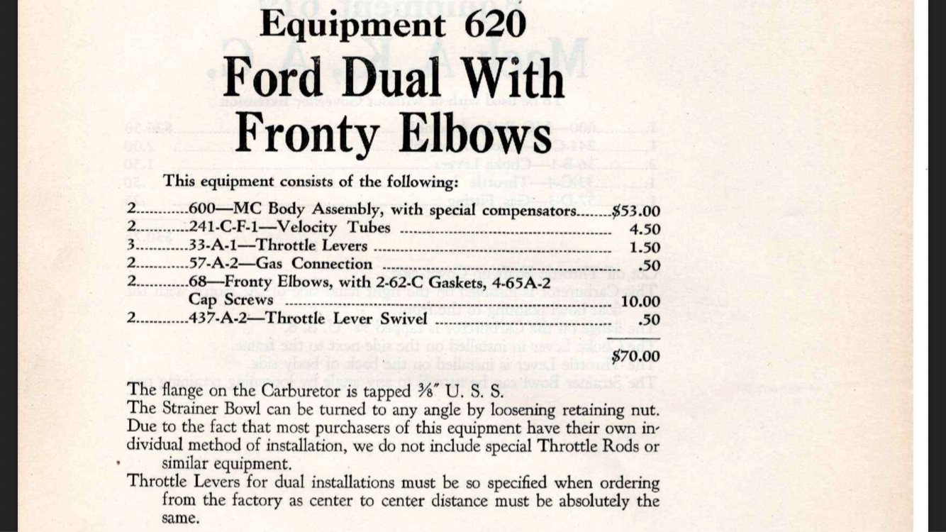

Straight out of the book, dual port Fronty and RAJO are to use 2 size C carbs. Maybe we aren’t driving em hard enough…?

I wonder what the specs were for the "special compensators".Kevin Pharis wrote: ↑Wed Dec 24, 2025 4:40 pmStraight out of the book, dual port Fronty and RAJO are to use 2 size C carbs. Maybe we aren’t driving em hard enough…?![]()
"... But here is the difference: the drilling of compensator holes are different in each size; the wall thickness is also different." (Winfield Catalog, 1930, General Information, p. 3)

With the C barrel out of the way, I was able to make progress on the D barrel. Just a few finishing touches to the barrel and butterfly and should be able to make some noise with it!
New S-B, S-C, and S-D barrels

I have been tracking Model S INT and HIGH compensators as they come available. The only consistency with the INT compensators is inconsistency. Not sure if some have been modified, but hole diameters are all over the place. However, there is a slotted style that are quite consistent. These are the type I chose to remake, and have documented almost all sizes.ewdysar wrote: ↑Wed Dec 24, 2025 6:35 pm
Keep crankin',
Eric
The HIGH compensators don’t seem to suffer the inconsistency.
Special compensators for dual applications I imagine would simply displace a bit of fuel from the accelerator charge. That note is from the model M section, will have to look if the same is in with the S/SR…
