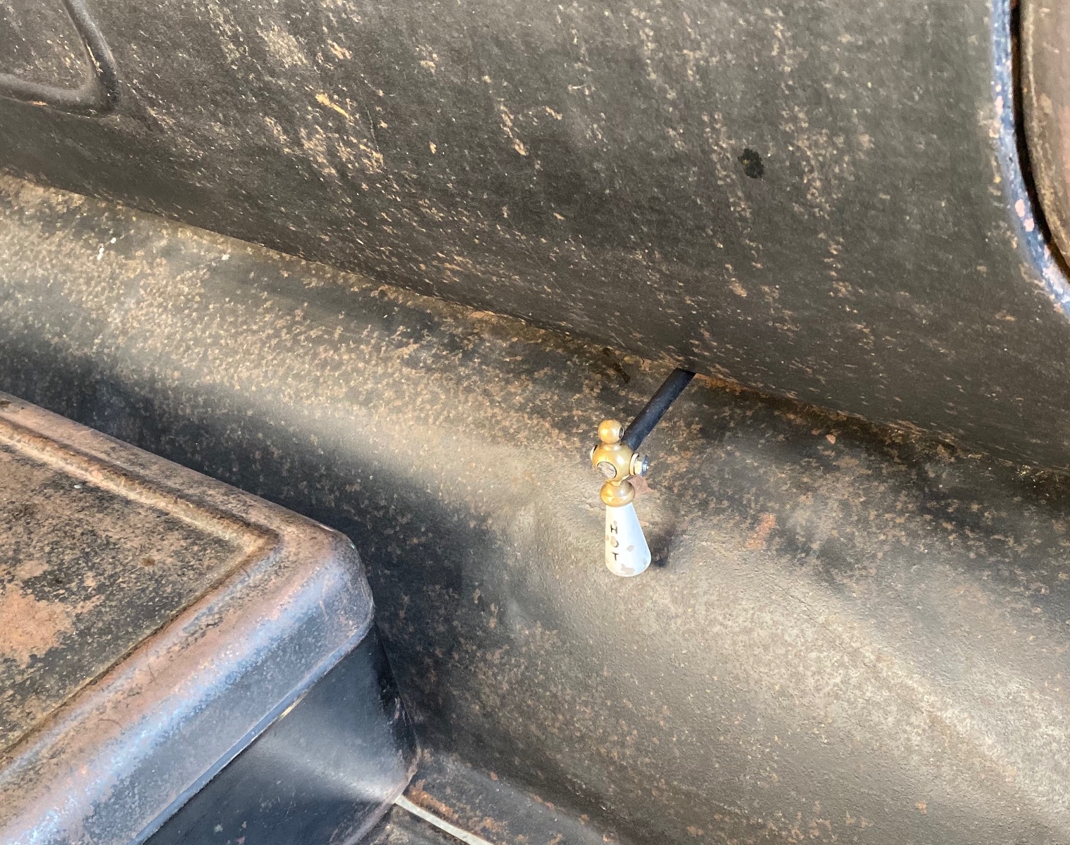

Yesss! Great to know that Fun Projects coil box kit has breathed new life back into your 24! :)
The 18 is 3rd in line here for the Fun Projects kits. 18 Tin Cup works OK but getting a bit less than OK. A 40 yr old wood kit.

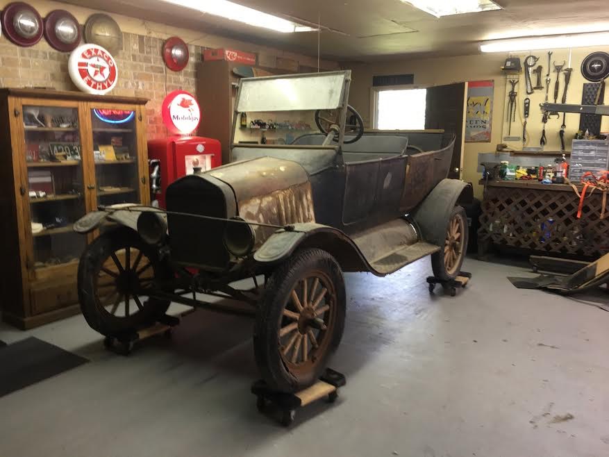

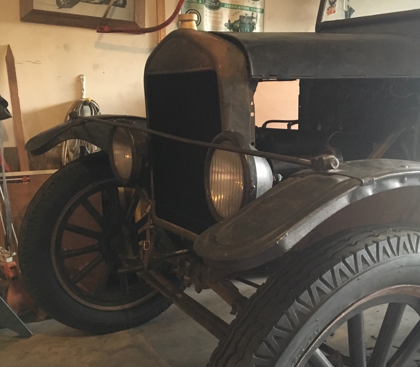

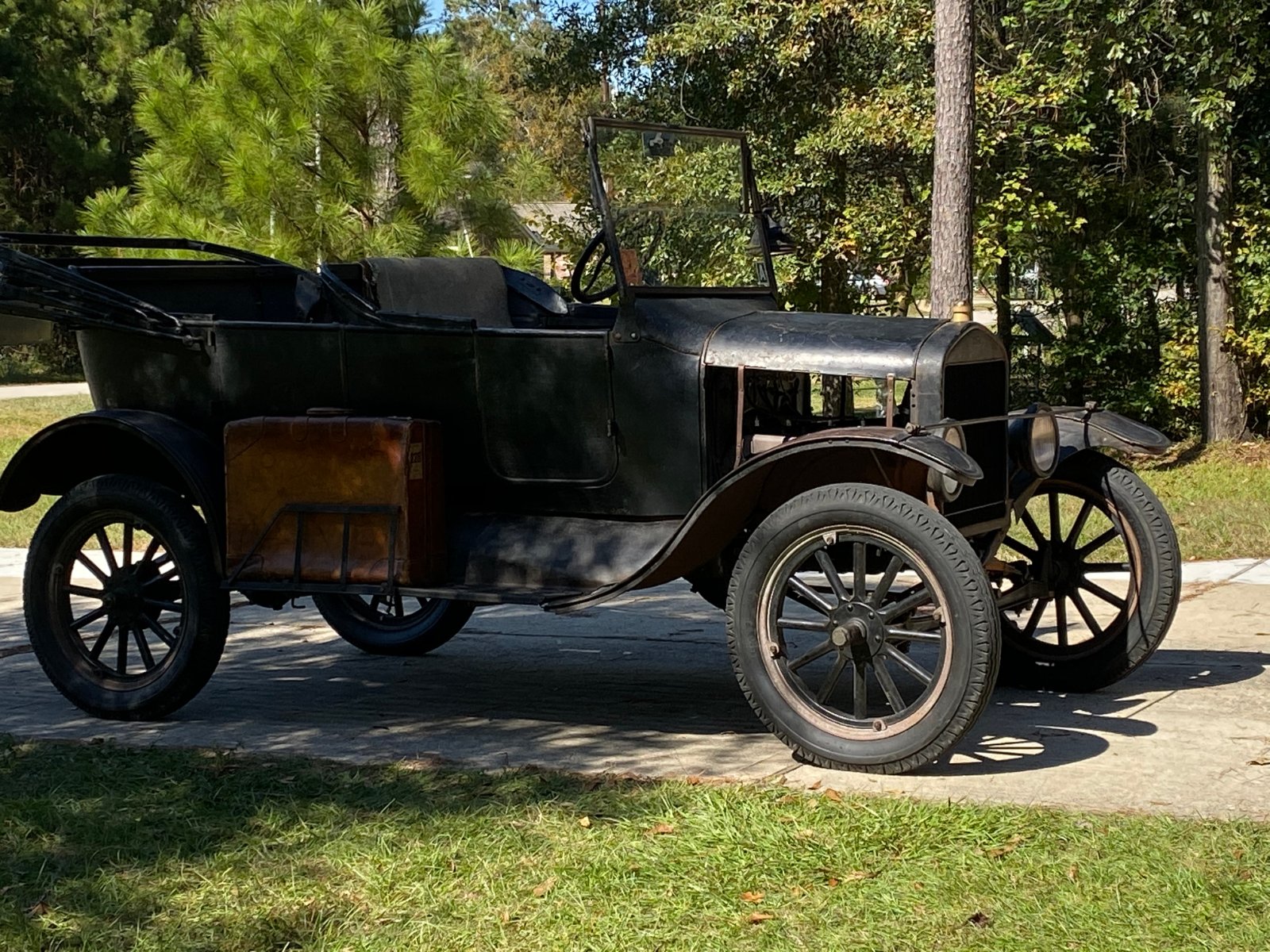

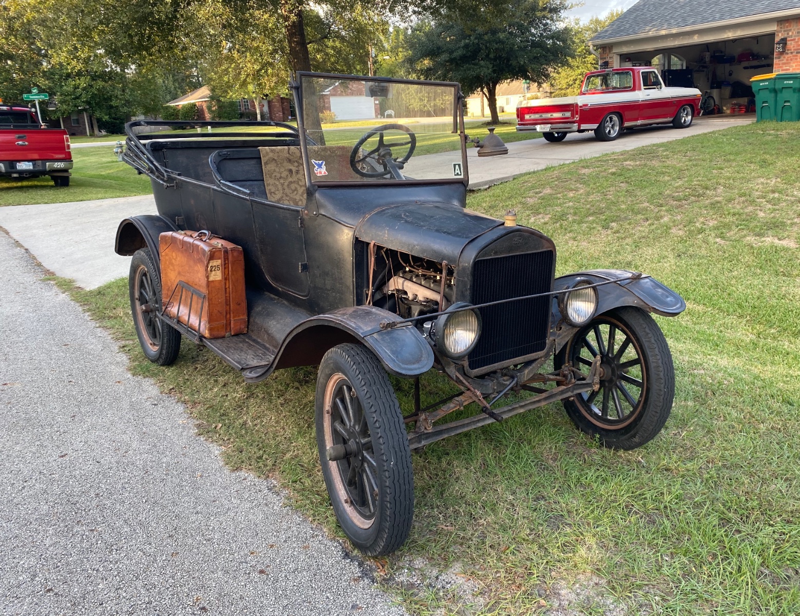

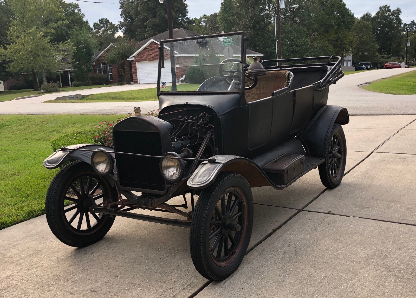

My new Berg’s radiator arrived and I couldn’t resist setting it in place.
My car now has the “face” that a high radiator black T should have. This weekend should fun...I have lots of little jobs to do on the T and then I’ll be able to take it for a ride without a leaking radiator for the first time.

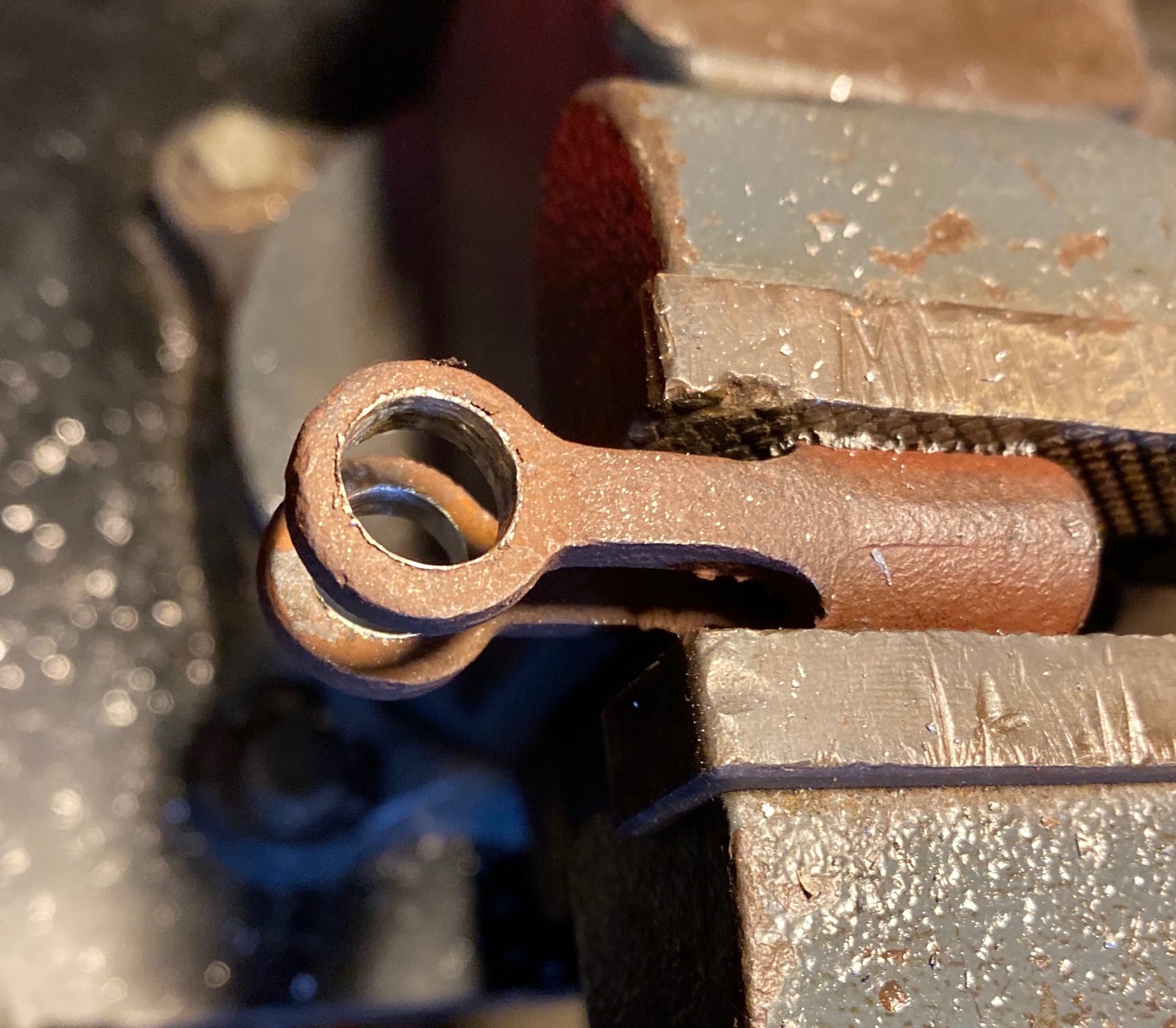

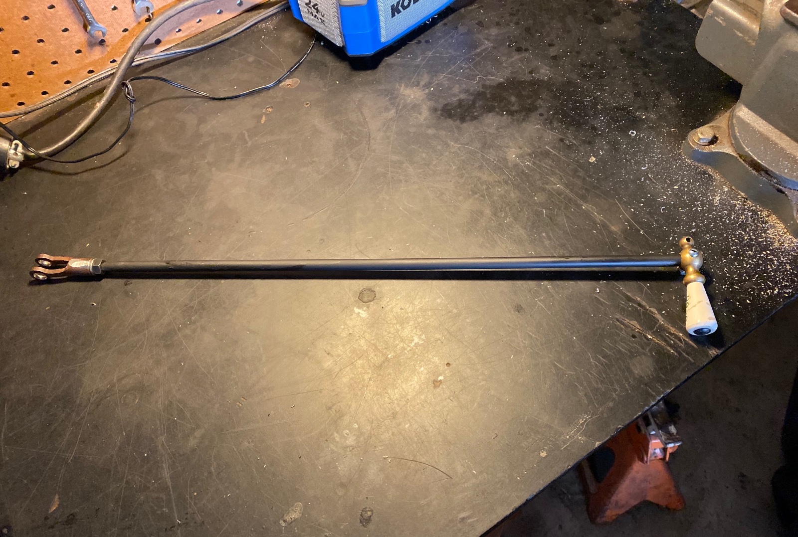

Post by RustyFords » Fri Oct 11, 2019 9:27 am

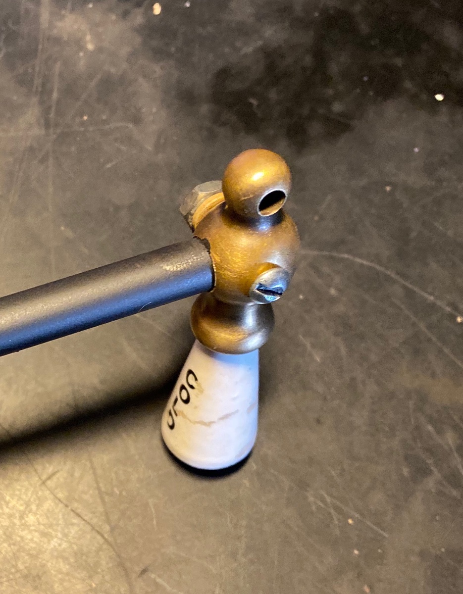

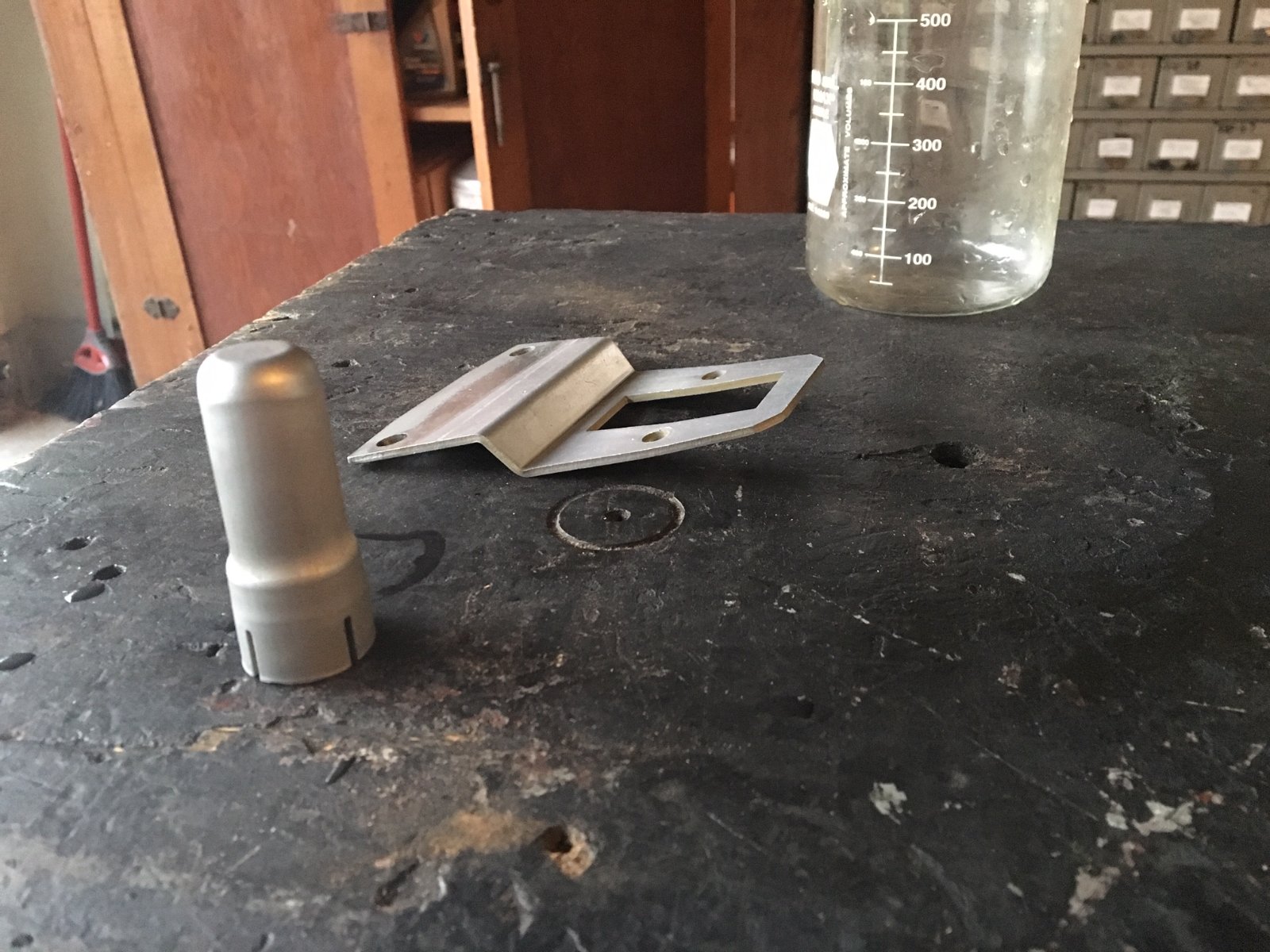

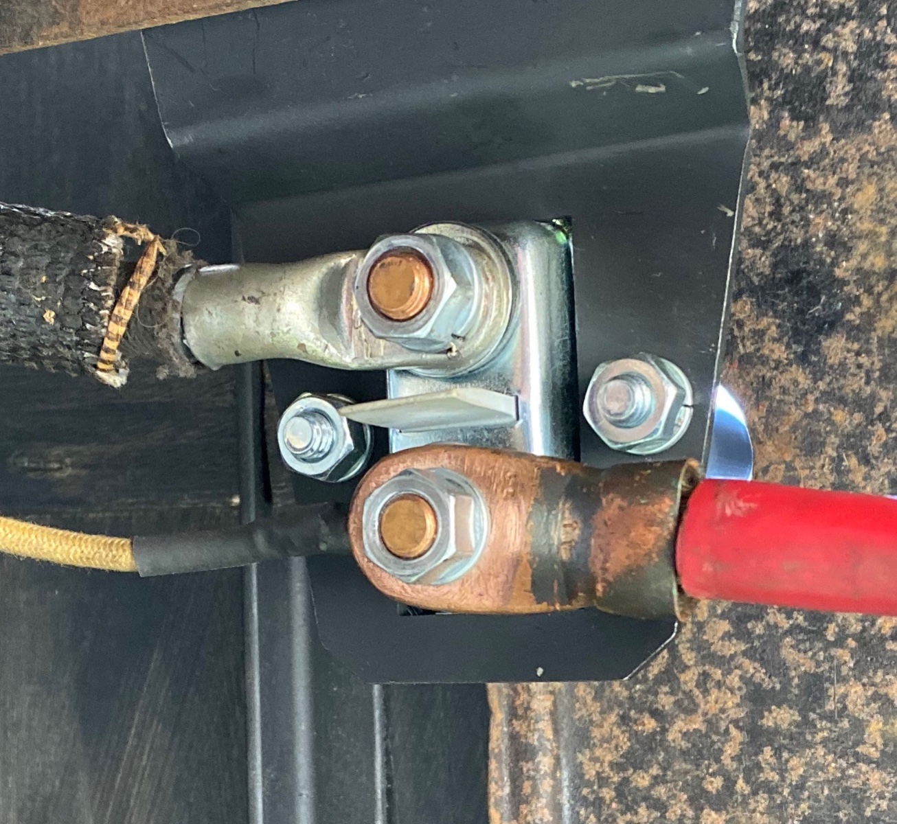

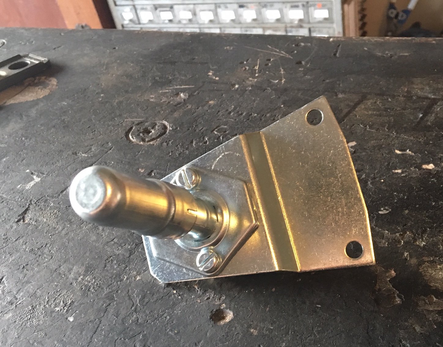

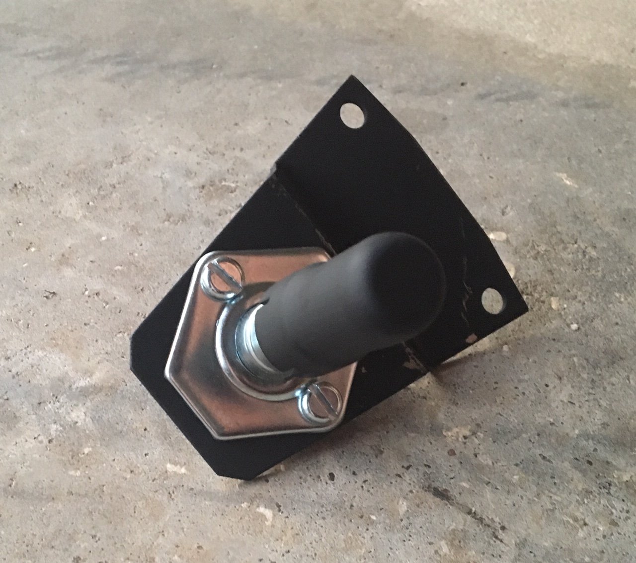

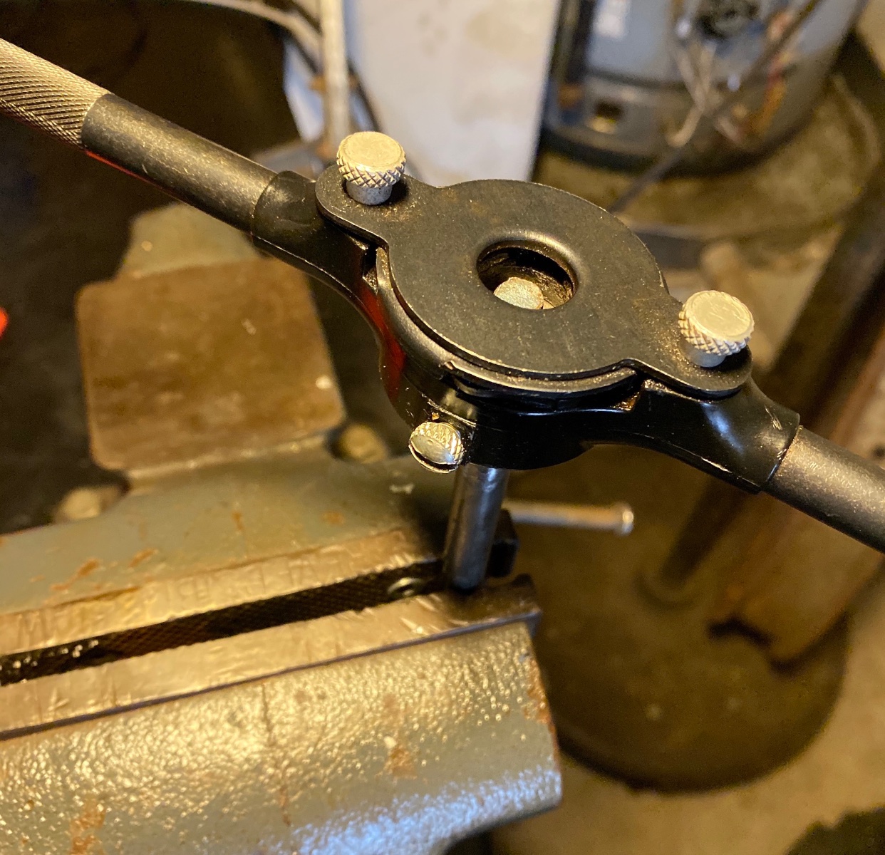

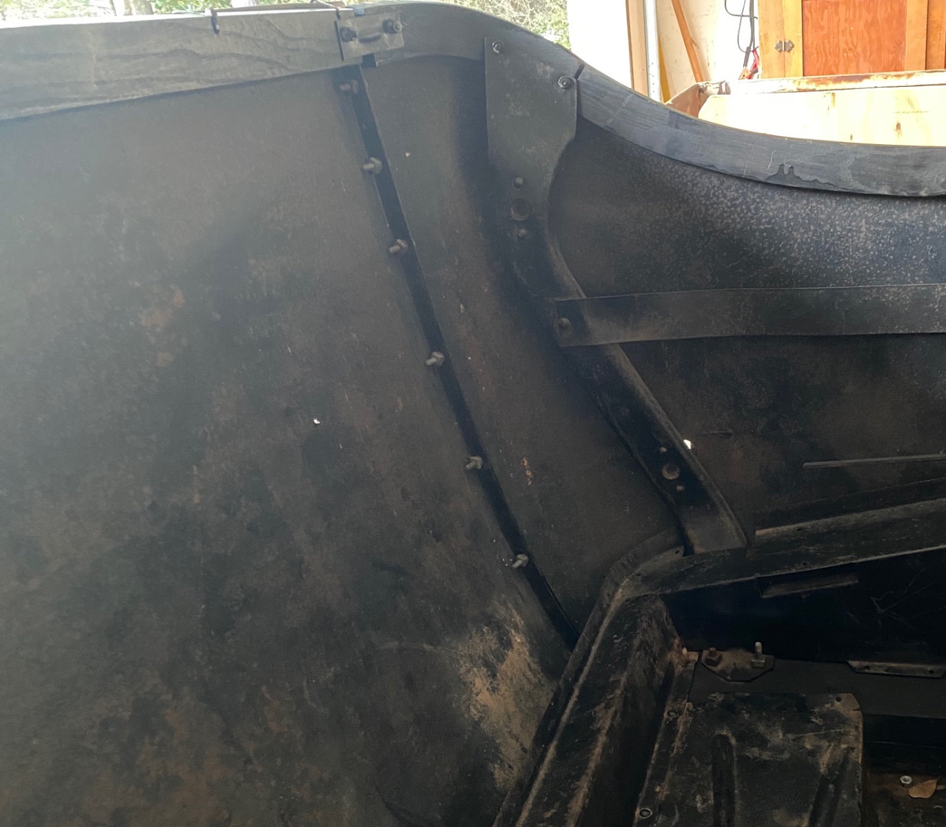

Had about an hour of available fun-time after work yesterday so I worked on an easy little project.
The starter button that came with my car wasn't a Model T button. Who knows what it started life as, but it wasn't for a T. It was attached to the seat frame and was sort of flopping around, making the car hard to start and not doing the seat frame any favors.
A new one was ordered from Langs and it seems like a nice quality piece. The only problem was how shiny it is....can't have a shiny starter button sticking through the floor on my car. What would the neighbors think! ;)
So...the non electrical bits (the mounting bracket and extension) got a quick bath in hydrochloric acid to remove the zinc plating, then were rinsed and received a nice coat of flat black. While I had the HCl out, I also dipped the new radiator hose clamps. They now have a nice bare steel look that I'm sure will start to rust pretty quick. I'll let that happen to a mild extent then I'll stop it with penetrol.
I'll install it this weekend along with the following:
- reworked hood shelves
- new radiator, hoses, clamps, radiator shell
- new/correct fuel line (old one is homemade...and leaking)

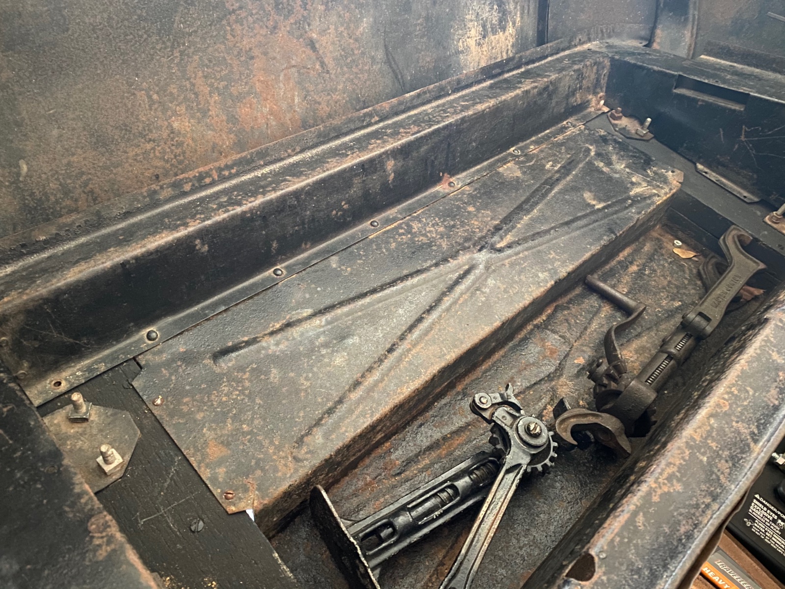

I also have a plan to reinforce the front floorboard (the big one where the lever is). It's just a bit too narrow and sometimes slips down. Can't have that.

I think Freddie Prinze said this way back in the day on Chico And The Man with Jack Albertson. Loooking goood! :)
Up here, 1st coil box for me was Mayor Keith's 25 TT. Been done for months but both of us are too darned busy to put it in!
Shoot, I'm just gonna ask. What is HCI used for otherwise? Man that worked nice to de-plate! Brain fart and head wrapped around other things right now. I want to say toilet bowl cleaner that actually works but... :oops:
Hydrochloric (muriatic) acid is commonly found in batteries and has a variety of other uses. It is excellent at stripping plating and rust but it will also do a number on flesh and it can release chlorine gas compounds, so care is best taken when using it.

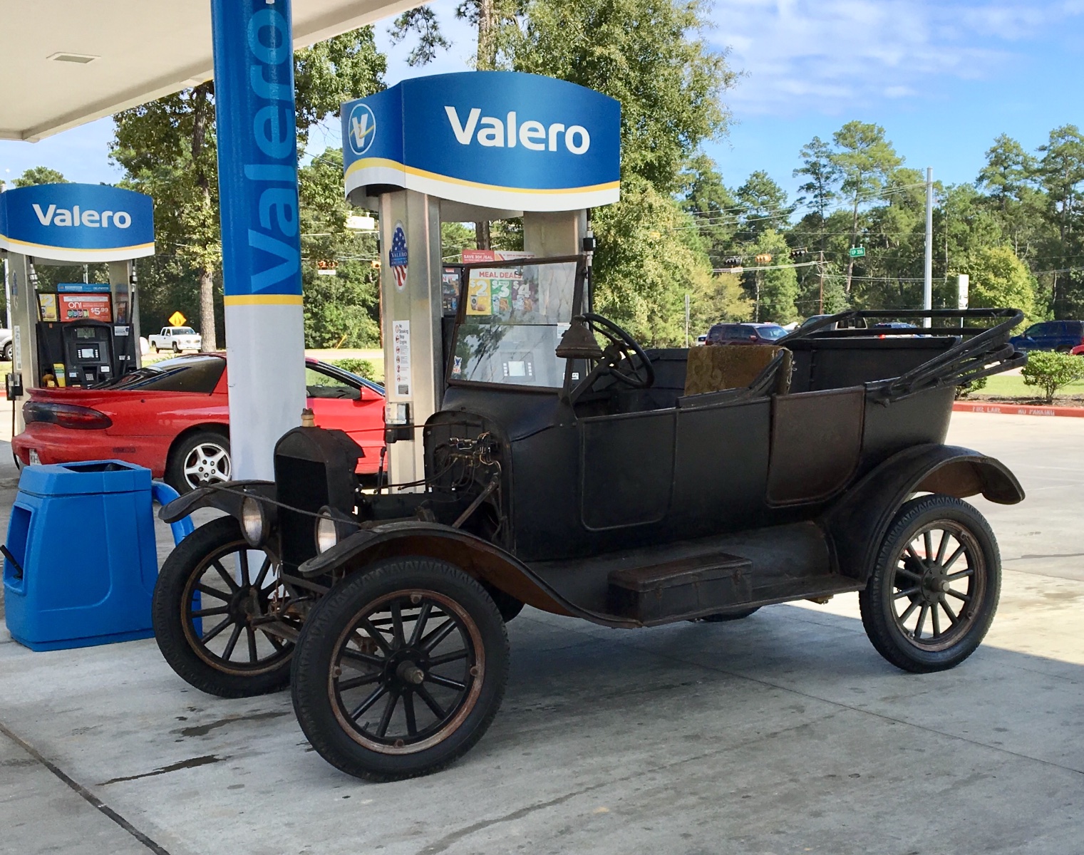

Re: 24 Touring Barn Car Revival - Part 3

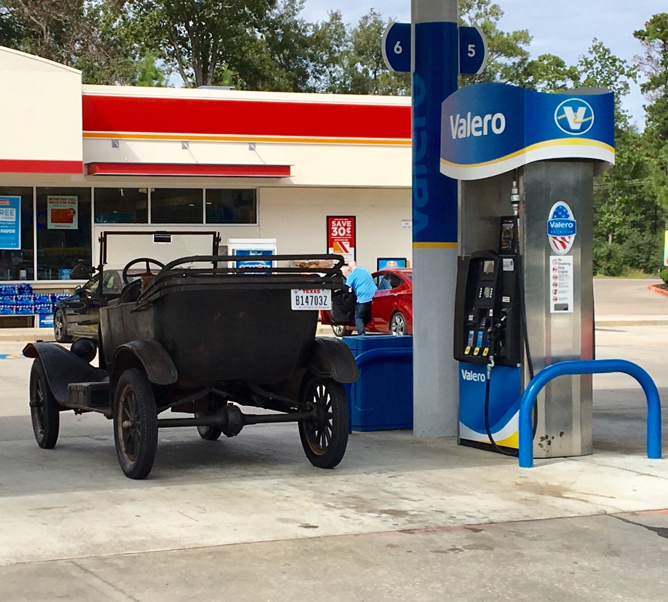

Post by RustyFords » Sun Oct 13, 2019 4:36 pm

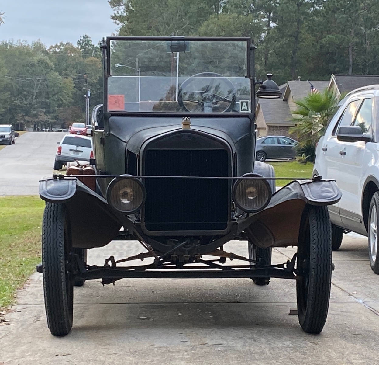

Another red letter day for the T.
First trip to the gas station since the 1960’s. This station is about 3 miles from my house.
1924 Touring

I drove it pretty much all day today. Longest trip was down to the I-45 frontage road from my neighborhood, which is about 5 miles on a road with a 45 mph speed limit.
I probably put roughly 75 miles on the car total today.
To say that I’m pleased would be a big understatement.
Based on the exhaust pipe and one plug that I pulled, it’s running a bit rich. I have the mixture screw set at one complete turn out...I guess it wants less than that.
Temps were in the low 80’s today and even leaving it idling for 15 minutes, the new Berg’s radiator didn’t even think about getting hot.

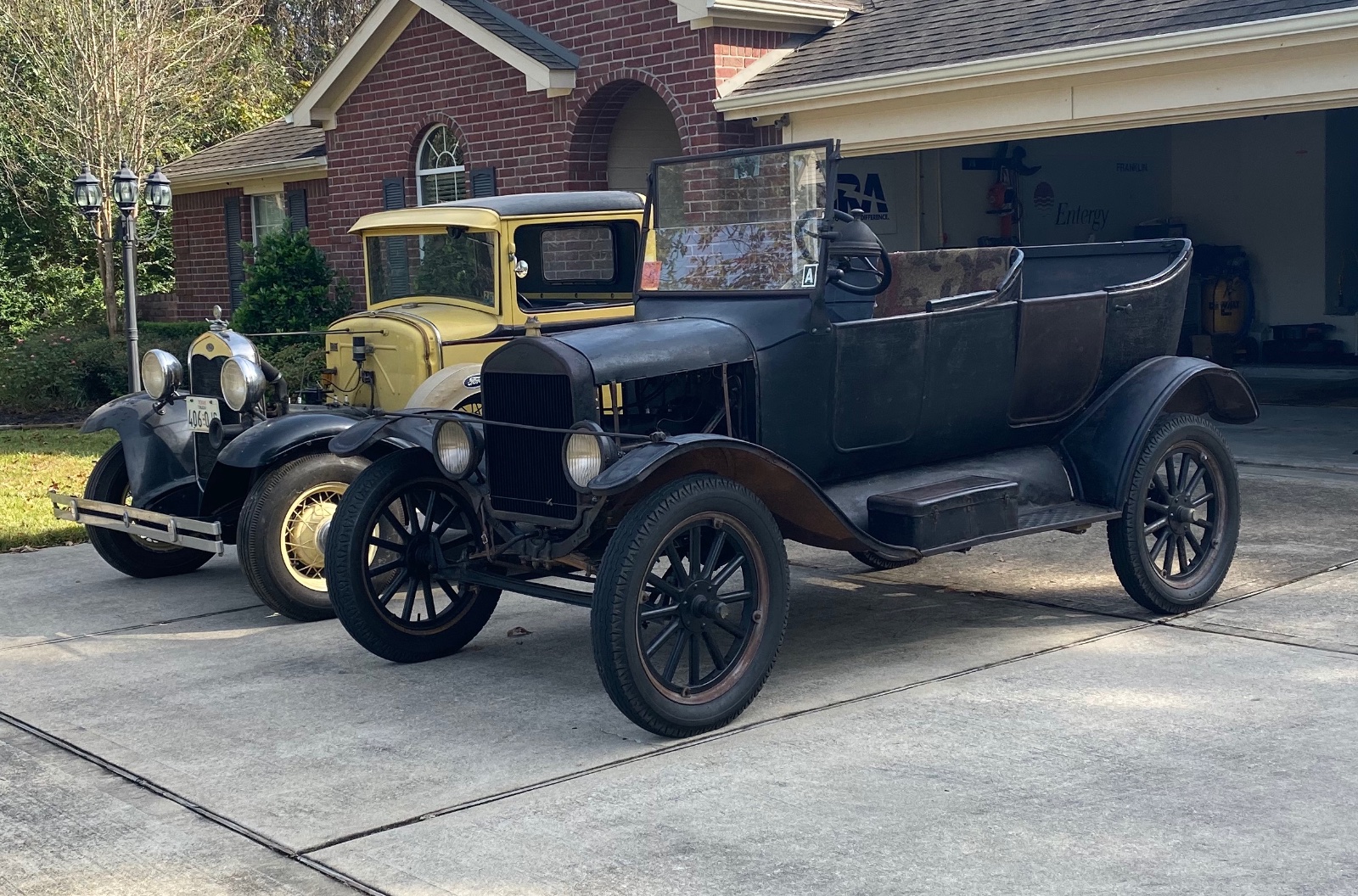

Here’s a contrast for you:
My friend’s 73 F100 with Crown Vic front suspension and a supercharged Ford Lightning engine putting out just under 600 hp (and too many other mods to list).
And...my T ...rated at less than 600 hp. :D
I helped him with the build. It was his deceased brother’s truck and was a thoroughly worn out long-bed when he started in on it.

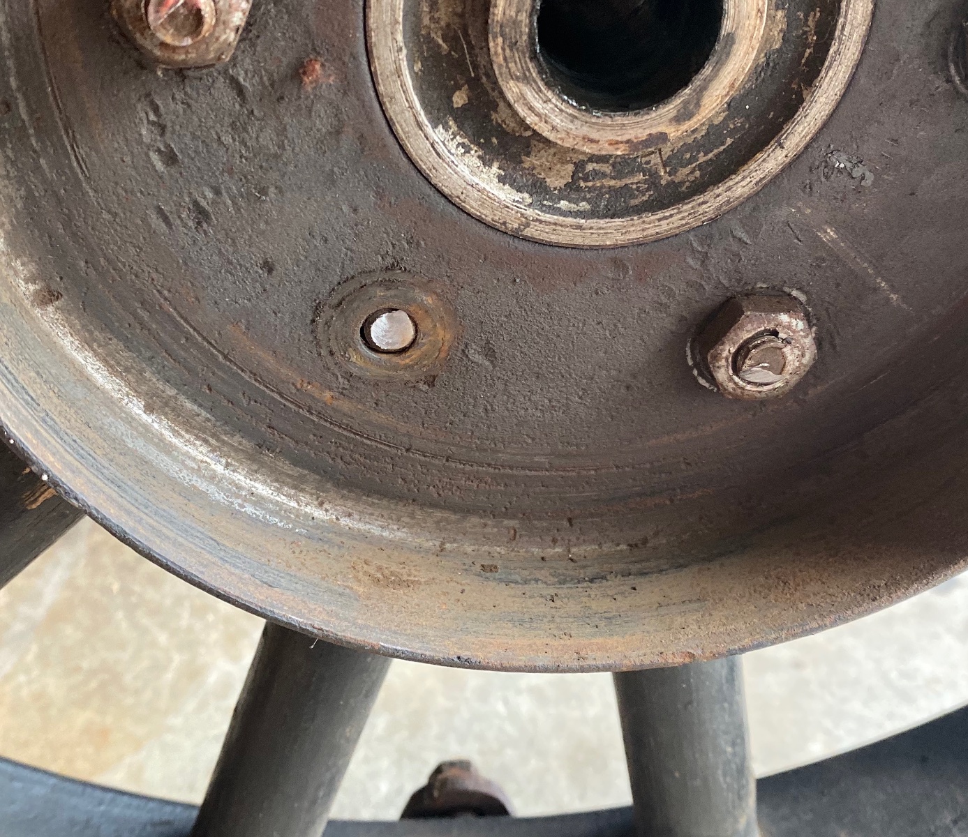

I had the T out again today and drove it even further...about 10 miles from home. At a gas station, a young mother asked if her kids could stand beside it to take a picture and instead I let them all get up in the car and honk the horn. Then back in the neighborhood, a dad waived me down to ask about the car and I ended up giving him and his kids a ride around the block a few times. This is why I wanted this car...not for awards, not for car shows but to enjoy it along with other people and to drive it.
I worked on my high gear shifting and was getting better until I messed up and had one particularly clunky shift and heard a metallic pop from under the car after which I could hear a metallic whining/scraping that got worse the faster I went.
It’s not present when sitting still and the engine starts right up and runs just fine.
So...I’m thinking maybe a broken axle....who knows. I immediately drove it back to my garage (about a quarter mile).
It drives just fine, and other than the metallic whining/scraping sound, nothing seems to be wrong. I had to put the car away and go to a family event, so I didn’t get a chance to examine it, but I will tomorrow.

Post by RustyFords » Sun Oct 20, 2019 9:49 pm
Happy news.
It was just a hub bolt that had snapped off. I had some spares and replaced it in a jiffy.
I was so happy that I went tearing down the road like a madman at breakneck speed which resulted in the local gendarmes pulling over. 😉

Post by Scott_Conger » Sun Oct 20, 2019 10:04 pm
Don
check wheels very carefully for loose spokes (do I remember you rebuilt them, or not?)
anyway, the bolts are not peened over the nuts...bad news
if original spokes am wondering if they "clocked" over a little and the bolt gave up
Like I said...looke everything over carefully and invest in new, quality repro bolts...you've proven that the originals have little life left.

Post by RustyFords » Mon Oct 21, 2019 1:08 pm
Scott
The wheels are some originals that I bought a couple years ago. They're very solid. I can't get any of the spokes to even think about budging no matter how hard I tug on them. The previous owner removed the large brake drums to use with his new wire wheels.
Then I installed my own drums...so...these old OEM bolts have had the nuts on and off a few times...which contributed to one of them giving way, I'm sure. Out of curiousity, I looked at the hub bolts on the front wheels and sure enough, they're peened.
As soon as I get the new bolts I ordered from Lang's, I'll install them and peen them in place. I took a good look at the spokes and they don't appear to have been "clocked". I think I narrowly averted disaster.

Post by RustyFords » Tue Oct 29, 2019 10:07 am

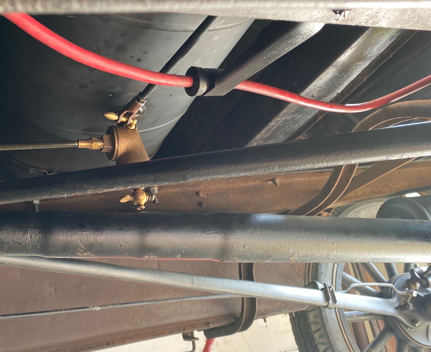

Good advice Scott....thanks. One thing I love about Model T's is how you can actually feel the engine operating with your foot. These cars are as close to being alive as anything mechanical I've ever come across.
Next little project for me will be a remote fuel shutoff valve. I'm not as "advanced" in years as some of yall, but have noticed that getting up and down on the concrete floor then sliding under a car is not nearly as easy at 50 as it was at 15. :|
I have a nice little vintage porcelain water faucet handle that I'll use for this.

The T is running exceptionally well and I’m getting pretty good at using all the misc controls so I decided to take the next step and drive the T to downtown Conroe, a large suburban town about 10 miles from my house. The trip required multiple stops, in traffic, with lots of cars all around.
Fortunately, there is a route that is almost entirely neighborhood streets.
I focused on safety and what the drivers around me were doing and it went off without a hitch. The biggest challenge, I’ve discovered, after driving this car for several weeks, is the person coming alongside while you’re moving, to take photos. You never really know what that person is going to do.

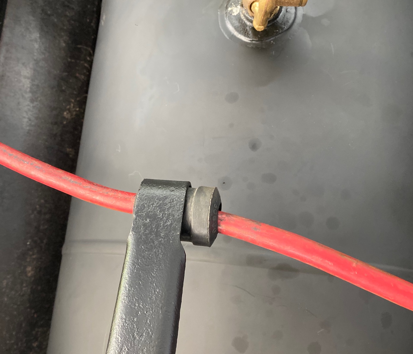

This evening I cleaned, rerouted and reconnected all the starter button connections.
It was kinda clunky when trying to start. That’s gone now and the starter engages immediately.
I also trimmed the positive battery cable to a more correct length, installed a new battery terminal on it and used an old shock absorber grommet to run the cable through the cable holder.
Both minor things, but it’s the little fussy bits and attention to detail that go a long toward making a reliable trouble free antique car, regardless of make/model.

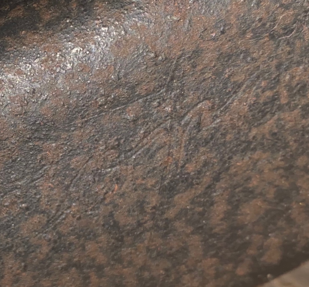

Post by RustyFords » Thu Nov 14, 2019 12:16 am

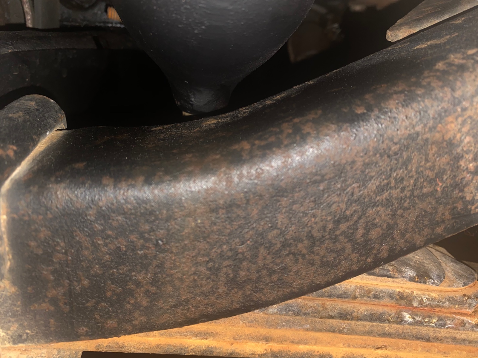

Just noticed this tonight...the Ford stamp on the front crossmember.
Further evidence suggesting that this car is wearing original paint. This faint stamp would’ve almost certainly been filled in by a respray.

You might want to check with some of the other posters. I think your new battery red battery cable should be souldered instead of crimped.
RustyFords
Posts: 1559
First Name: Don
Last Name: Allen
Location: Houston, TX
Post by RustyFords » Sun Nov 17, 2019 9:05 am
John l wrote:
Sun Nov 17, 2019 8:41 am
Certainly couldn’t hurt.

After building a number of electric car conversion in the ‘90s with lots of cable connections, the consensus is that battery cables should be properly crimped as a mechanical connection, once crimped, the lug can be soldered as well, but if the lug is the right size for the cable gauge and properly crimped, the solder doesn’t add much value. Battery/starter cables, because the the amps involved, should not rely on solder alone, the mechanical connection is required. We all know that if a wiring connection gets loose, it warms up, and with primary battery cables, that heat can unsolder your lug faster than you think. Corrosion can also increase resistance (which will cause the lug to heat up), so I also heat shrink all battery cable lugs after crimping.
When I pulled the diesel motor out of my old 30’ sailboat and converted it to electric 10 years ago, I found this wiring source on the internet http://www.genuinedealz.com/ Their tinned cable is much higher quality than the plain cable that you can get at most local sources (hardware stores and the big box places) and is usually cheaper. For anything other than a quick one-off repair, I would go to them for materials. That said, for my Model T wiring projects, I think cloth wrapped wire looks better and is worth the effort to source it. My go-to place for that is http://www.riwire.com/
Keep crankin’
Eric
RustyFords
Posts: 1559
First Name: Don
Last Name: Allen
Post by RustyFords » Sun Nov 17, 2019 3:06 pm
Interesting food for thought Eric...thanks.

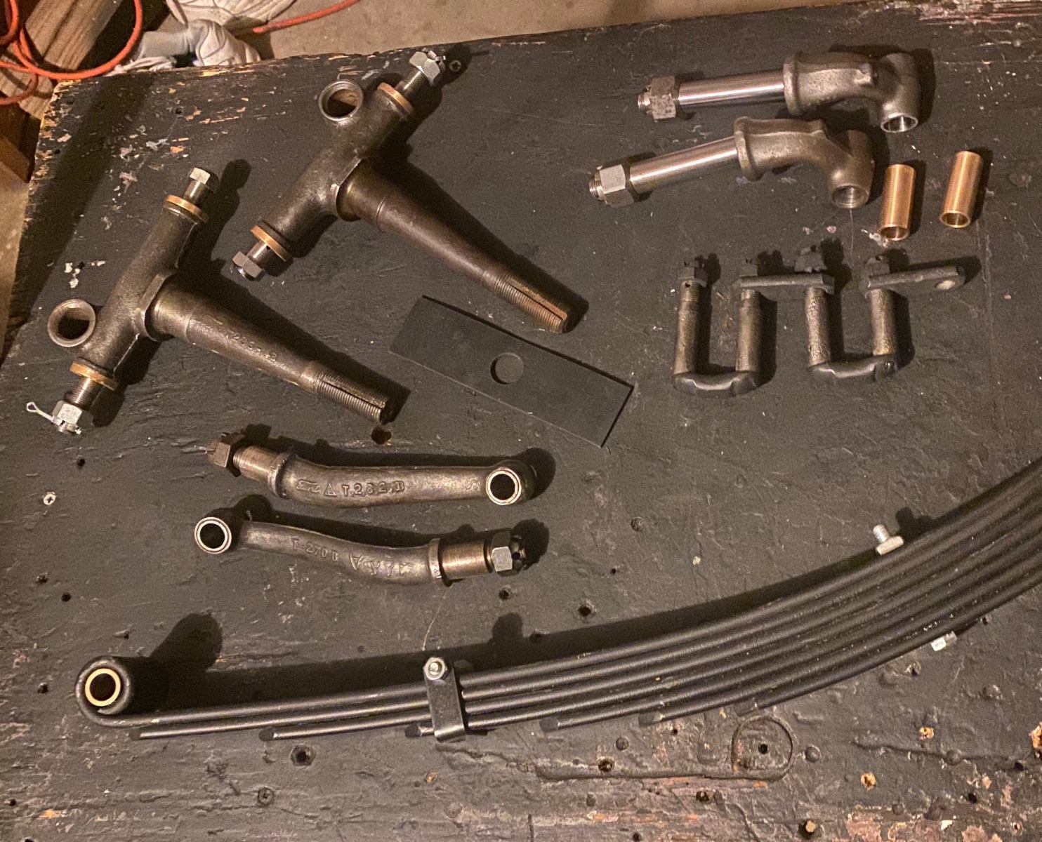

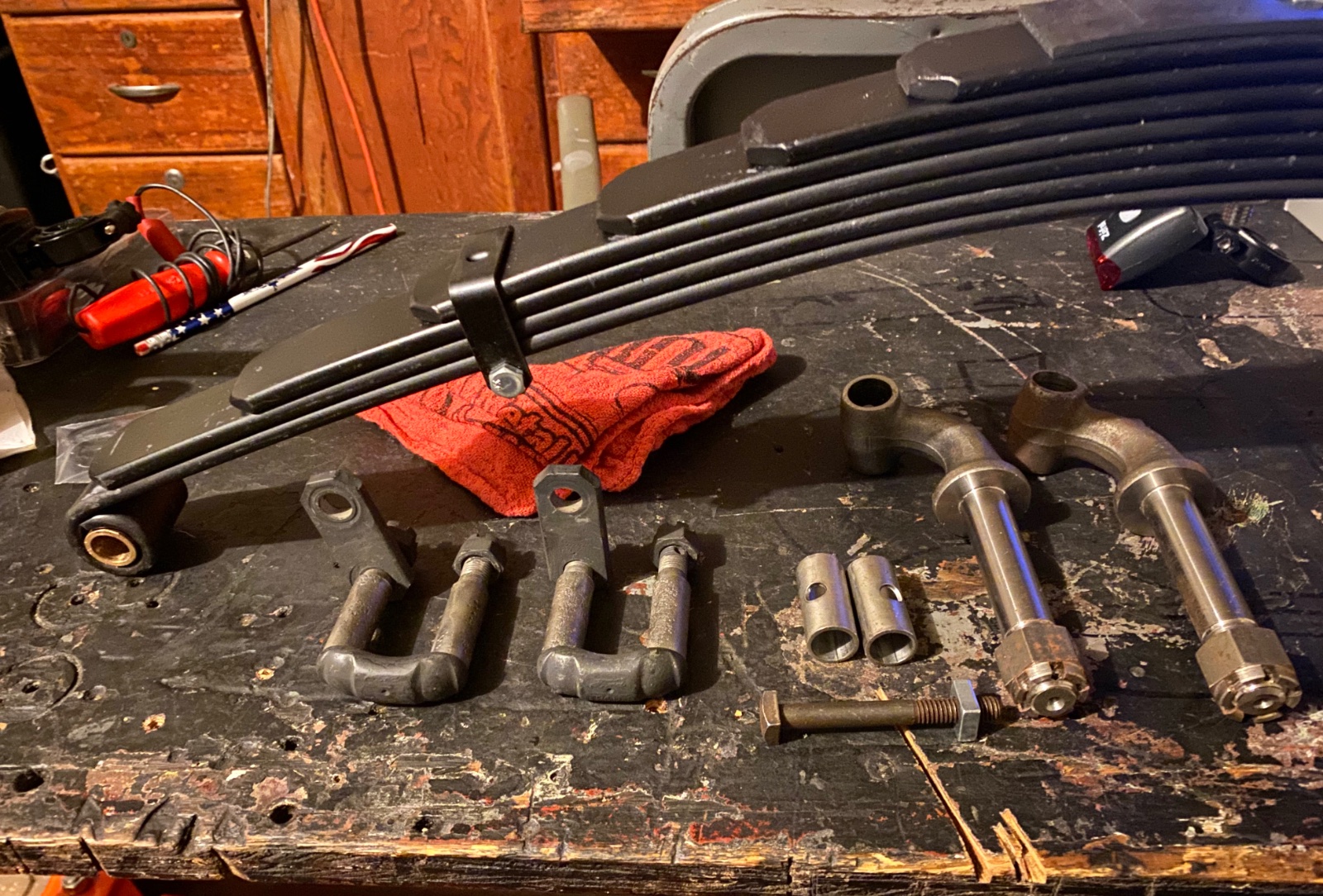

Posts: 1559
First Name: Don
Last Name: Allen
Post by RustyFords » Sun Nov 17, 2019 3:13 pm
Another good day of T’ing.
Took the T to Sonic. The route I took was about 25 miles each way. Fun, fun, fun!

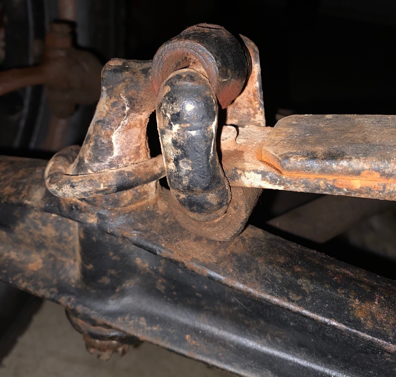

I am however, going to have to choose a time soon to install my new front springs, perches, shackles, spindles, etc. That’ll take it off the road for a short time.

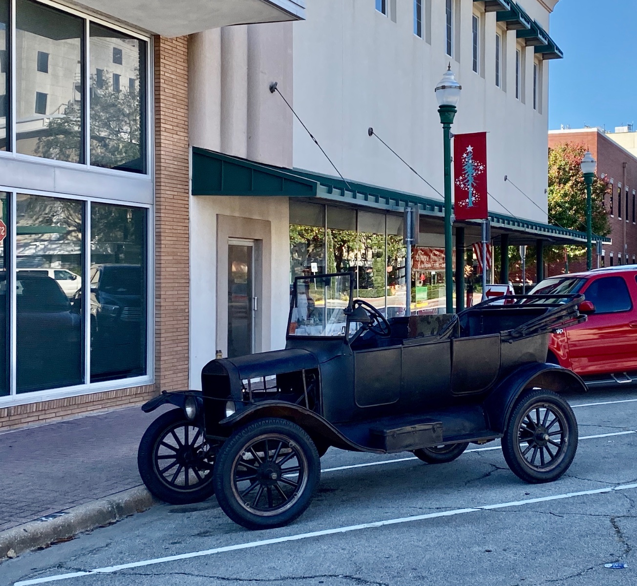

Neighbor just inherited his grandfather’s Model A. I was asked to help him learn to set the timing, etc.
I figured why not drive the T over and get a family photo.

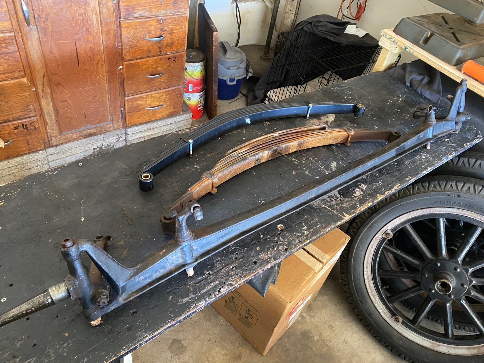

Santa (the mailman) delivered the last of the bits I need to replace my front spring and perches.
Now to set aside a Saturday to do it.
1924 Touring

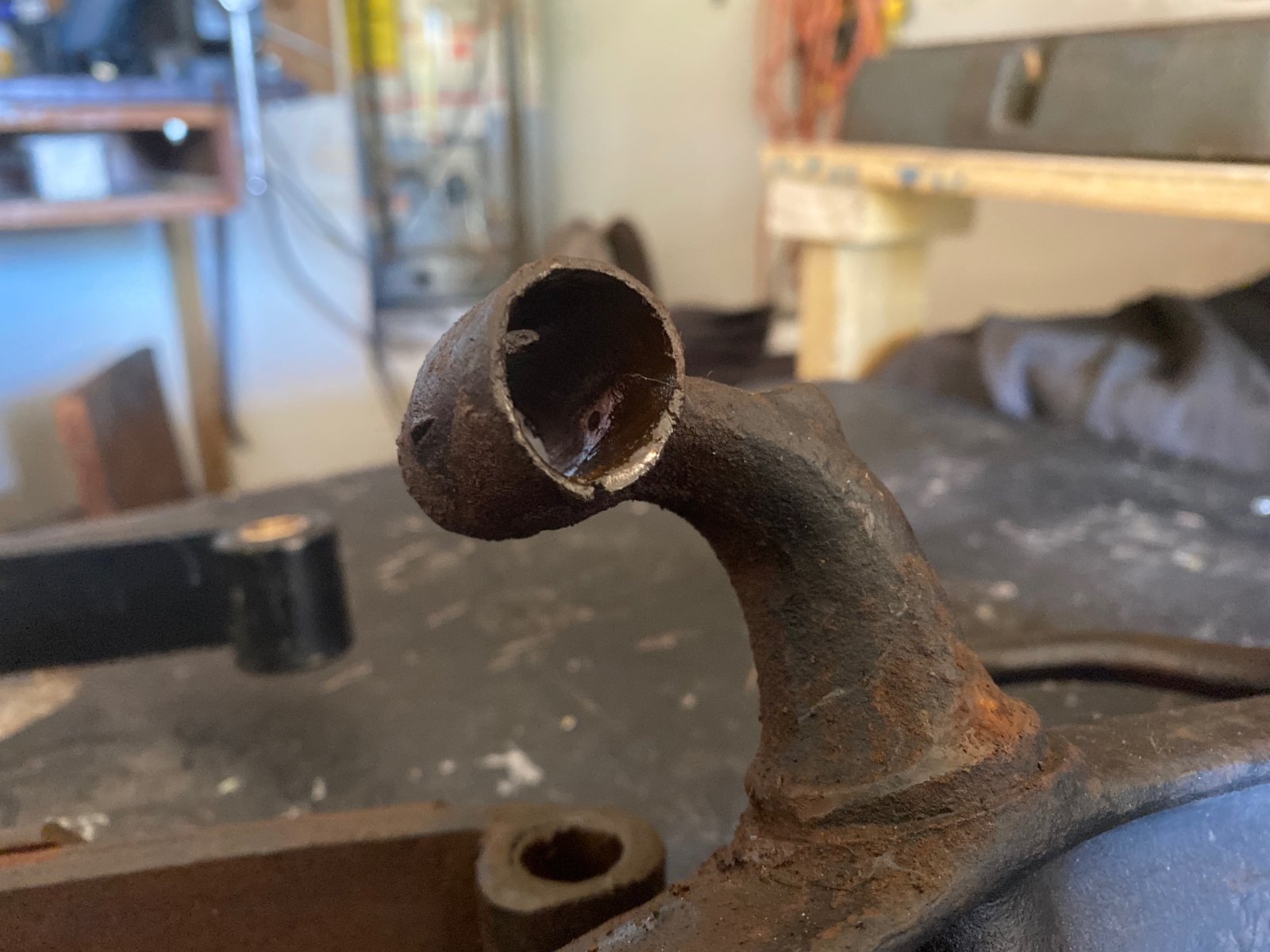

Post by RustyFords » Wed Nov 20, 2019 10:52 pm
As you can see...things are pretty much shot to hell in that department.
1924 Touring

Jeez, that looks worse than the 24 here! I am glad you're enjoying this car as he is.
Even new/fresh perches! Woohoo!

Hey Eric, thank you on my end for that bit about lugs on the end of cables! Didn't even know Don had a problem...
Point is: At work, right now, we have 500 Amp potential (fuse) going thru some of our cables and I need to address a co-worker and his practices with our cables on an electric unit we build. I like to crimp and solder. I must ask tomorrow what he actually does....

I’ve been driving the wheels off of the T and having a blast doing it.
I think I’m going to use the holiday break to install the new spring, shackles, etc.

Post by RustyFords » Sat Nov 30, 2019 6:05 pm
Remote Fuel Shut-Off
Climbing under the car to turn on/off the gas was getting to be a drag so I engineered and installed a remote shutoff valve today.
I bought a two foot long piece of 7/16” steel rod and threaded the end to match a spare brake rod clevis (5/16x24). I also drilled out the two ends where the arm of a fuel bulb just barely fit through.
Then I attached the clevis and a lock nut.
On the other end, I drilled a hole in the rod and matching holes in an old water faucet handle, then secured it with a machine screw and nut.
1924 Touring
RustyFords
Posts: 1559
First Name: Don
Last Name: Allen
Post by RustyFords » Sat Nov 30, 2019 6:17 pm
Here it is installed. It works great. Since both ends come apart, it’s easy to put the rod in place.
I think the old water faucet handle compliments the old paint on the car.
The next project will also be fuel related. I’ll be replacing the fuel line with a factory spec line. The current line is leaking slowly.
1924 Touring

That fuel shut-off turned out super neat/cool! You'd warned us about that faucet handle. Ding! Winner!

Post by RustyFords » Tue Dec 03, 2019 10:44 pm
I’ve laid out some $$ for new or rebuilt steering and front suspension components. I want this car to be solid at speeds over 30mph and it’s currently not. and has some very worn, probably dangerous components that are giving it a noticeable wobble.
My aim is for every component of these two subsystems to be either new or rebuilt. When we hit a stretch of very cold wet weather (which we typically do around here in January or February) I’ll tear down and install.
I still need to locate a NOS/new/rebuilt drag link and pitman arm. I think Lang’s has the pitman arm new...not sure about the drag link.
I also need to have my axle reamed and bushed.

As I was pulling into the driveway today, after a quick lap around the neighborhood, I noticed an Exxon Valdez level oil gusher coming from the engine. Yikes.
A quick inspection revealed that 3 of the 4 bendix cover screws were gone. Again...yikes.
Fortunately, there was still plenty of oil in the engine and no harm done.
When I installed the starter, I didn’t use split washers because I was trying to be “correct”. No more of that degree of nonsense for me. I had some extra screws and they were installed with split washers.
Before you gasp in horror, I’m still resolved to not use Phillips screws anywhere on this foolish carriage 😉. So...I haven’t completely gone to the dark side.

Don, Did you ever get any photos of the inside of the rear seat area? I am looking for photos with out the rear upholstery. George
RustyFords
Posts: 1559
First Name: Don
Last Name: Allen
Post by RustyFords » Sun Dec 22, 2019 11:16 pm

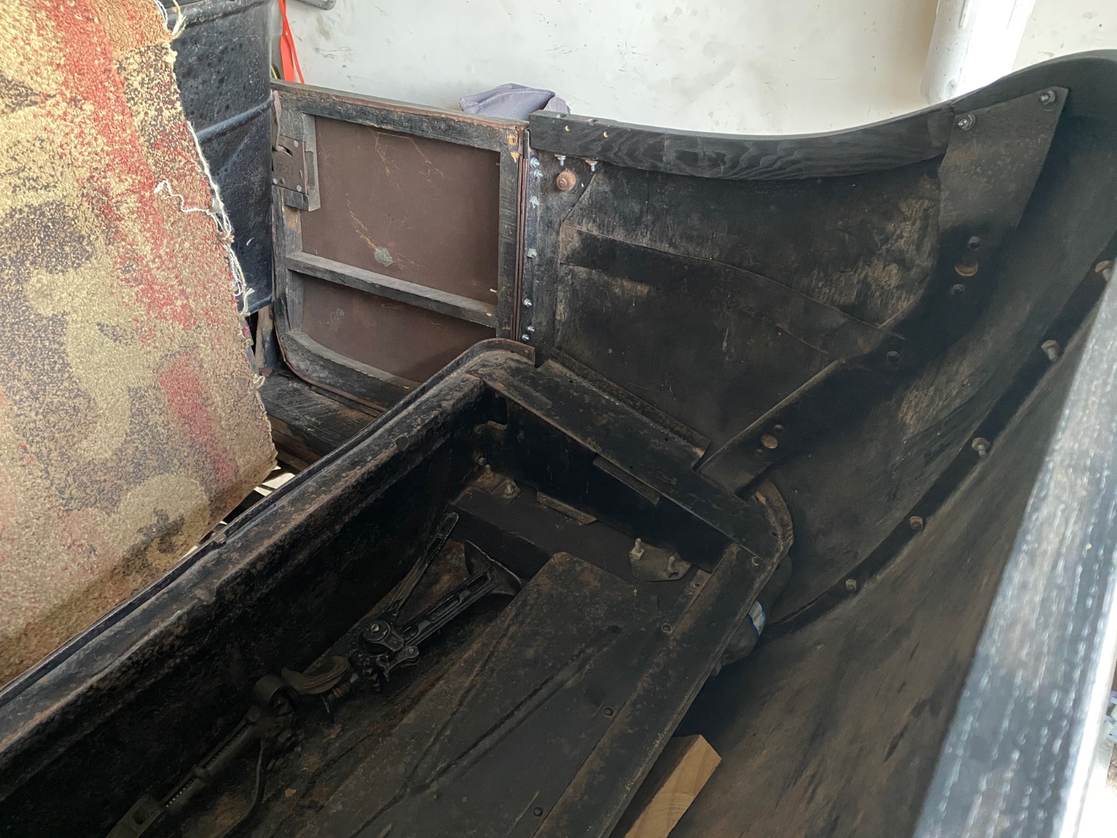

Here you go George. I’m missing the vertical wood slats but I think it’s otherwise pretty complete.
One thing on my car that I believe is a modification made to the car back in the day is the 26-27 style top pivots. I have an earlier set that I’ll probably install.
1924 Touring

Don, thank you for taking the time to post your photos. The 1923 Touring I have has the body in pieces and the photos should help me reassemble, I have to post pictures of 2 styles of brackets that came in pairs, with one pair slightly curved angle sheet about 6 inches long with 4 holes on each side, the others about a foot long each straight angle with about 4 holes on each side, they sides about 3/4". I have to get photos. George

Post by RustyFords » Fri Dec 27, 2019 1:09 pm
Man oh man have I ever had a blast driving this little car all over my local area. However...it's time to take it out of commission for a while and perform a list of tasks that need to be taken care of.
They will be the following:
- Replace front spring assembly
- Replace front spindles and steering arms
- Replace front perches and shackles
- Install motor mount wood blocks
- Install "belly band" engine support
- Install OEM style fuel line and gaskets
- Remove upper radiator hose and reinstall with some RTV (there's a small persistent leak)
- Weld small crack in rear crossmember
- Install spare tire mount
- Install factory park light and a 26-27 style brake light
- Install brake light switch
January around here is our only really cold month and we typically get a lot of rain, so it's the ideal time to do all this.
After that, the only thing the car really lacks will be some door wood, an interior and the top installation. All of those can be done with the car running and driving.
If the weather looks totally clear, I may take it Chickasha just to putt around in. However, the real goal, for the mostly "finished" car is the Texas T Party in September 2020. I want all the major taks complete, an interior and top installed and all the little bugs worked out of the running gear by then. The OCF is on my wish list for 2020 and I'm gonna try like heck to attend, but I'm not 100% sure about it yet. I am sure about the T Party.
My 66 F100 will be glad to see the Model T down for maintenance. He's been ignored lately and wants to go to the hardware store.

Post by RustyFords » Wed Jan 01, 2020 10:20 pm
I procrastinated on starting the front spring project so I could drive the car today. It looked like the last decent weather day for a while.
I was at the end of a 20 minute drive when the car started running rough. I limped it home and shorted out each plug until I discovered #2 not firing. I switched coils between #1 and #2 then shorted the plugs again and #1 wasn’t firing.
So...it looks like a coil has failed.
I’m wondering why/how a fairly new coil just gives up like that midstream. It’s one that the coil doctor rebuilt for me a couple years ago, but it doesn’t have a ton of miles on it. I have an ECCT and plan on testing the coil as soon as possible.
I’ll also start taking apart the front suspension tomorrow.

Post by RustyFords » Sun Jan 05, 2020 2:34 pm
I jumped in and pulled the axle last night.
One of the shackles was not cooperating so I was forced to persuade it.
I expected the perches to be bad....but wow!
The spring set had an extra leaf added. That, combined with the fact that two rear spring clamps had been added to the front crossmember, leads me to believe that this car was set up, back in the day to do some heavy hauling. That's in line with other evidence I've discovered about this car. It was worked hard on the farm during WW2 and possibly before. The old girl deserves respect and thanks for doing her part to keep the country going during trying times.
1924 Touring
Posts: 6798
Post by Scott_Conger » Sun Jan 05, 2020 3:39 pm
Not many miles left before what could become a bad accident. Very good that you're doing this. New perches are nearly indistinguishable from originals and are worth the expense.

Post by RustyFords » Sun Jan 05, 2020 4:56 pm
Yeah...I knew I was pushing my luck. I didn’t realize how far I’d pushed it. Yikes
