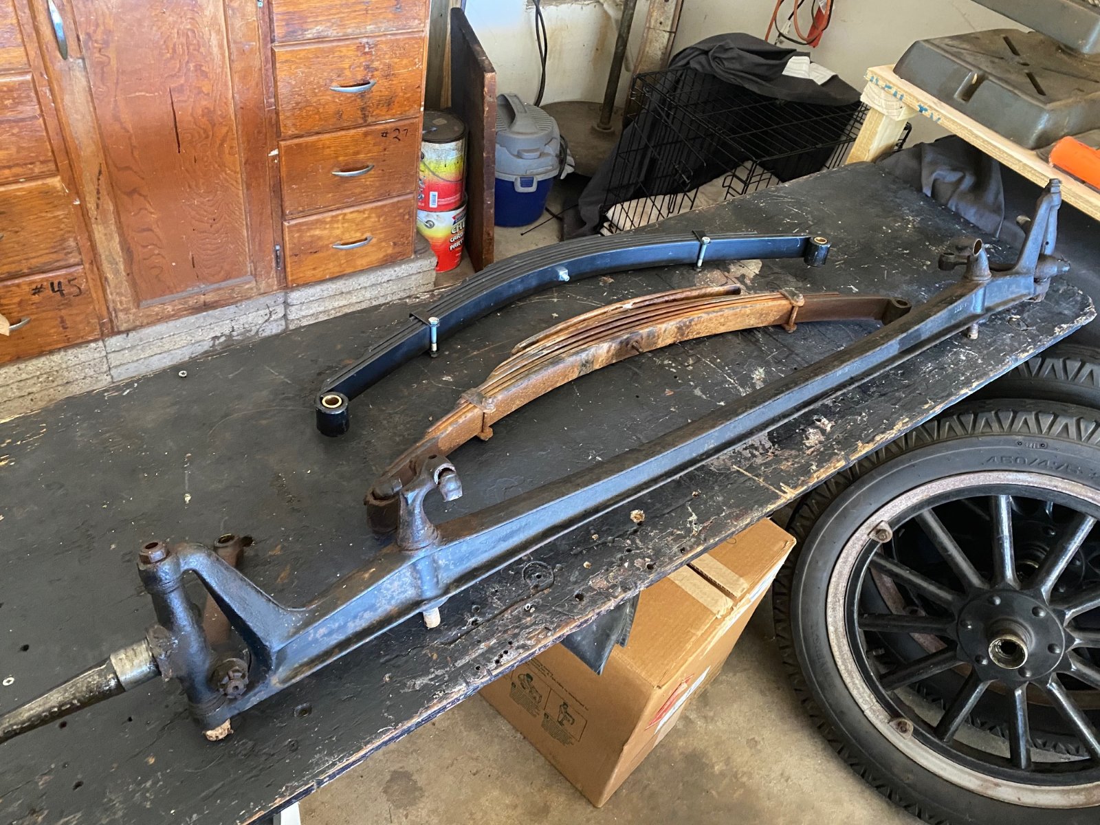

Santa (the mailman) delivered the last of the bits I need to replace my front spring and perches.
Now to set aside a Saturday to do it.

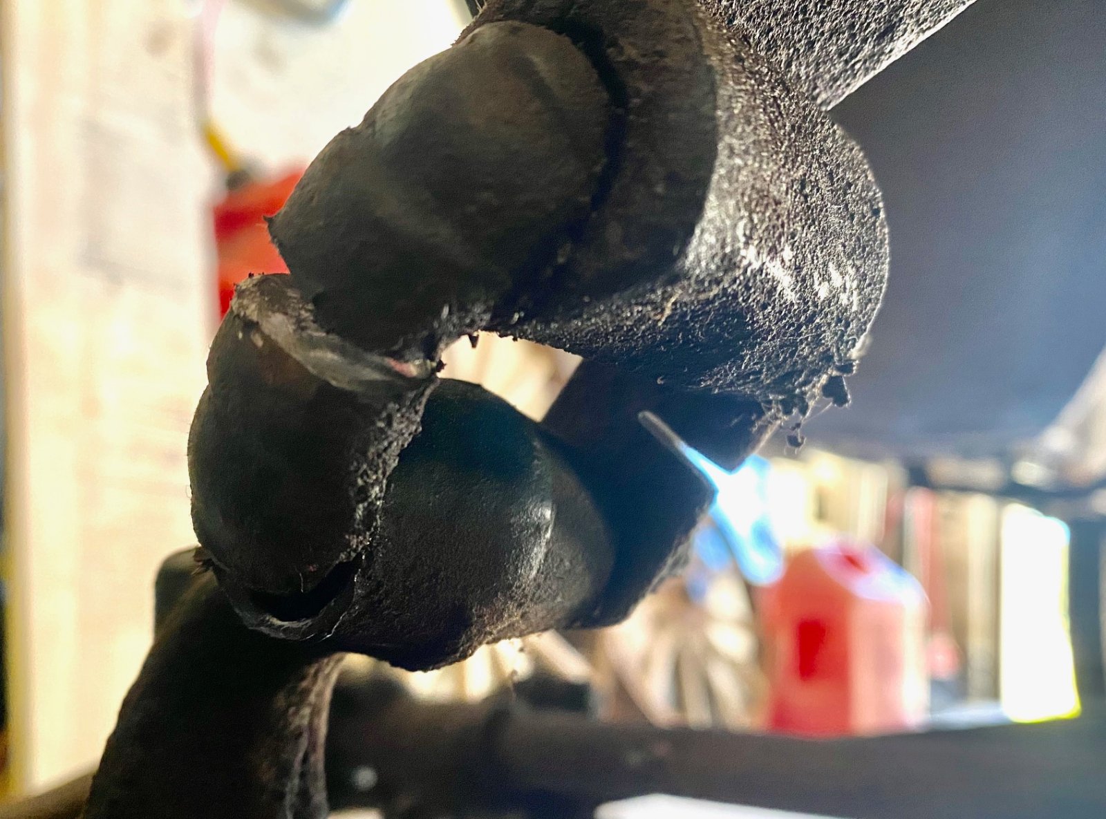

As you can see...things are pretty much shot to hell in that department.

I think I’m going to use the holiday break to install the new spring, shackles, etc.

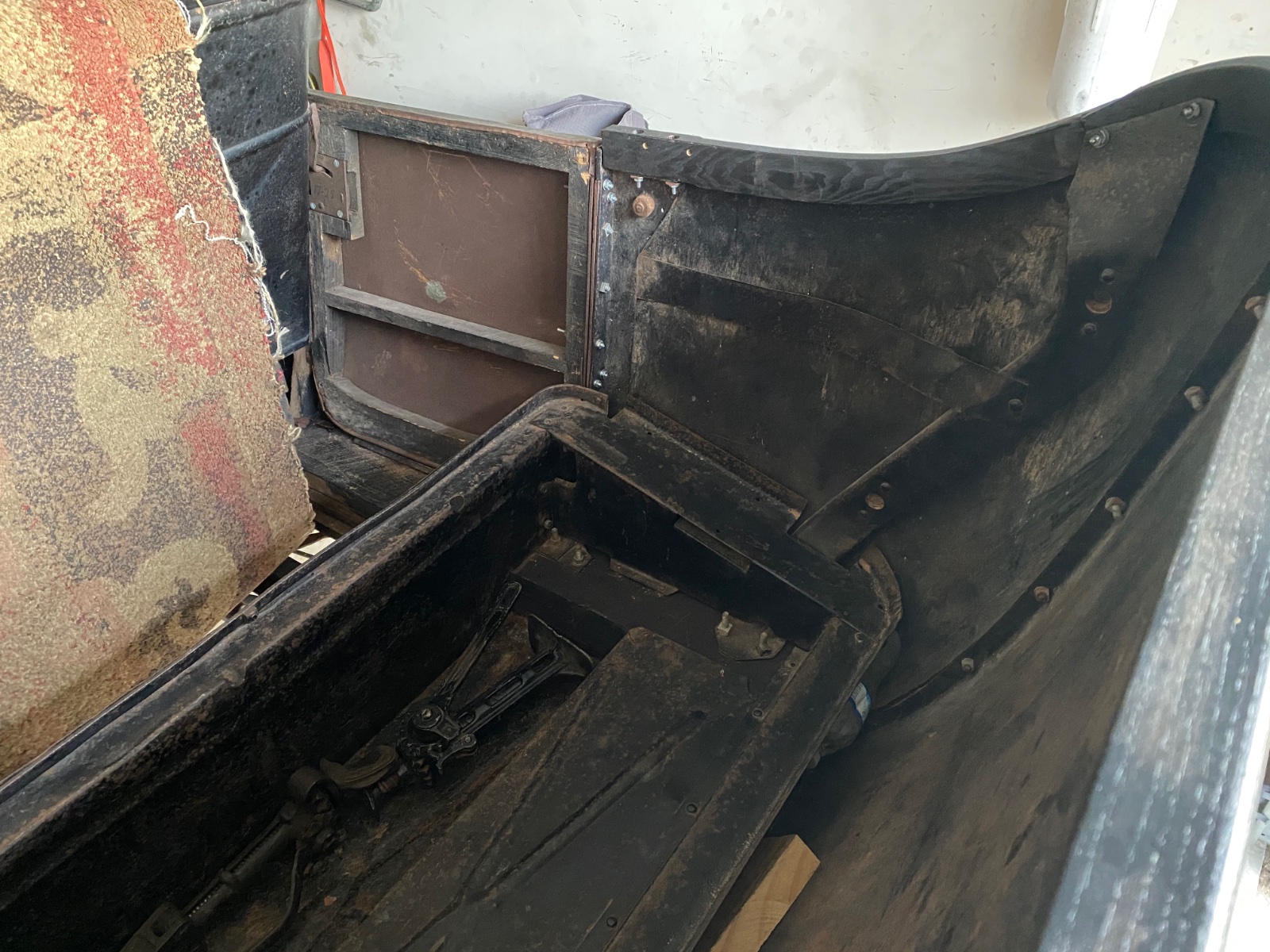

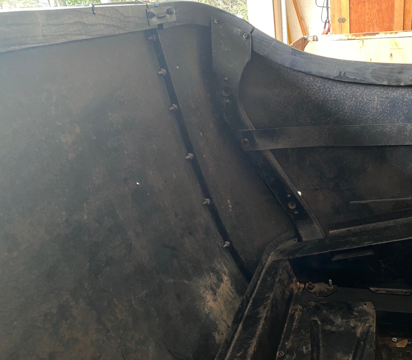

Don, Did you ever get any photos of the inside of the rear seat area? I am looking for photos with out the rear upholstery. George

Here you go George. I’m missing the vertical wood slats but I think it’s otherwise pretty complete.
One thing on my car that I believe is a modification made to the car back in the day is the 26-27 style top pivots. I have an earlier set that I’ll probably install.

Don, thank you for taking the time to post your photos. The 1923 Touring I have has the body in pieces and the photos should help me reassemble, I have to post pictures of 2 styles of brackets that came in pairs, with one pair slightly curved angle sheet about 6 inches long with 4 holes on each side, the others about a foot long each straight angle with about 4 holes on each side, they sides about 3/4". I have to get photos. George

I jumped in and pulled the axle last night.
One of the shackles was not cooperating so I was forced to persuade it.
I expected the perches to be bad....but wow!
The spring set had an extra leaf added. That, combined with the fact that two rear spring clamps had been added to the front crossmember, leads me to believe that this car was set up, back in the day to do some heavy hauling. That's in line with other evidence I've discovered about this car. It was worked hard on the farm during WW2 and possibly before. The old girl deserves respect and thanks for doing her part to keep the country going during trying times.
1924 Touring
- Posts: 6586
Re: 24 Touring Barn Car Revival - Part 3
Not many miles left before what could become a bad accident. Very good that you're doing this. New perches are nearly indistinguishable from originals and are worth the expense.
