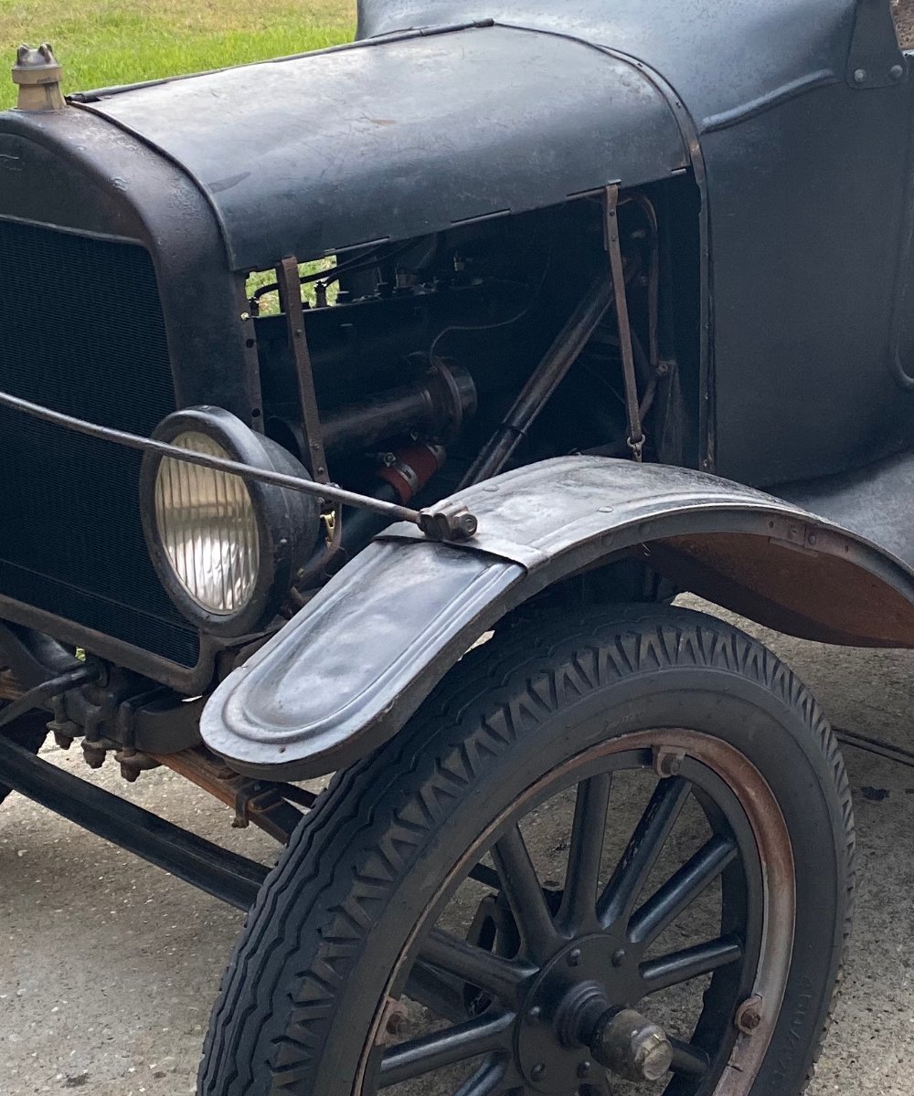

My new Berg’s radiator arrived and I couldn’t resist setting it in place.
My car now has the “face” that a high radiator black T should have. This weekend should fun...I have lots of little jobs to do on the T and then I’ll be able to take it for a ride without a leaking radiator for the first time.

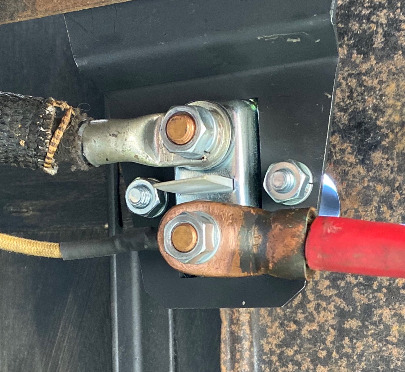

Had about an hour of available fun-time after work yesterday so I worked on an easy little project.
The starter button that came with my car wasn't a Model T button. Who knows what it started life as, but it wasn't for a T. It was attached to the seat frame and was sort of flopping around, making the car hard to start and not doing the seat frame any favors.
A new one was ordered from Langs and it seems like a nice quality piece. The only problem was how shiny it is....can't have a shiny starter button sticking through the floor on my car. What would the neighbors think! ;)
So...the non electrical bits (the mounting bracket and extension) got a quick bath in hydrochloric acid to remove the zinc plating, then were rinsed and received a nice coat of flat black. While I had the HCl out, I also dipped the new radiator hose clamps. They now have a nice bare steel look that I'm sure will start to rust pretty quick. I'll let that happen to a mild extent then I'll stop it with penetrol.
I'll install it this weekend along with the following:

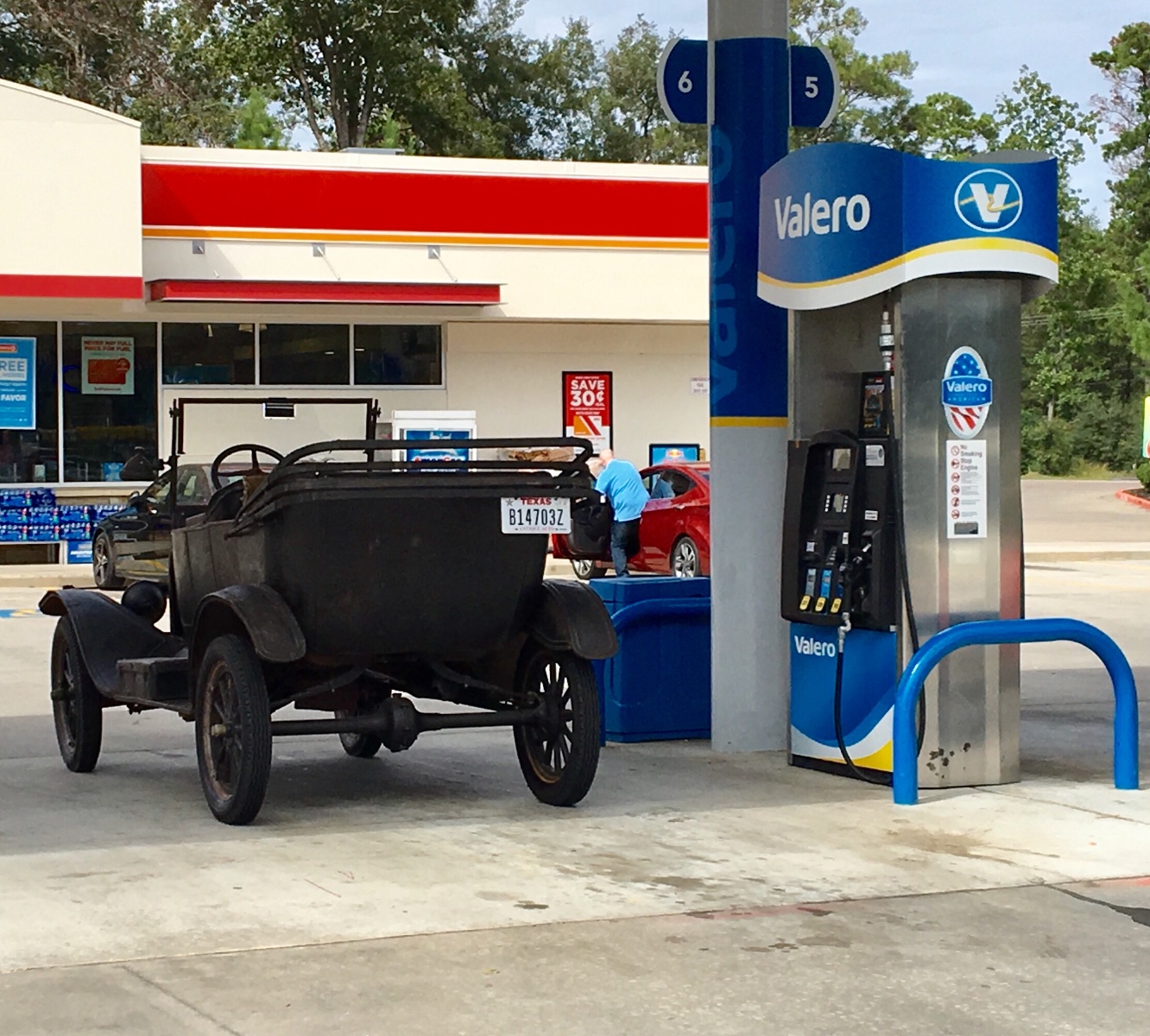

Another red letter day for the T.
First trip to the gas station since the 1960’s. This station is about 3 miles from my house.

This evening I cleaned, rerouted and reconnected all the starter button connections.
It was kinda clunky when trying to start. That’s gone now and the starter engages immediately.
I also trimmed the positive battery cable to a more correct length, installed a new battery terminal on it and used an old shock absorber grommet to run the cable through the cable holder.
Both minor things, but it’s the little fussy bits and attention to detail that go a long toward making a reliable trouble free antique car, regardless of make/model.

Scott, I have followed your build since you started it. I'm glad to see its running and driving. You probably will have way more fun with your "patina" car than a fully restored car. I have had both. While the fully restored car was nice, it is too much work keeping it that way, and you really do not feel comfortable with kids (and some adults) are crawling in it. For me the patina car is just way more fun to show and drive
I think I see a nice high radiator shell in the last pic you posted. It looks like the patina was a good match.
Have fun and be safe .................

Post by RustyFords » Wed Nov 06, 2019 5:24 pm
Thanks Donnie.
I’ve had restored cars in the past and didn’t get a fraction of the enjoyment that I’m already getting out of this T.
Yes...that’s a very nice weathered tall shell that a forum member sold to me for way less than it was probably worth, in order to help me put the T on the road with its new Berg’s radiator. This has happened several times with forum members and I’m humbled.

You might want to check with some of the other posters. I think your new battery red battery cable should be souldered instead of crimped.
RustyFords
Posts: 852
First Name: Don
Last Name: Allen
Location: Houston, TX
MTFCA Number: 50001
Re: 24 Touring Barn Car Revival - Part 3
Post by RustyFords » Sun Nov 17, 2019 9:05 am
John l wrote:
Sun Nov 17, 2019 8:41 am
Certainly couldn’t hurt.
1924 Touring

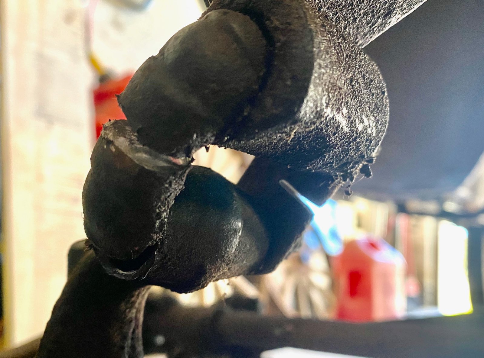

Post by RustyFords » Wed Nov 20, 2019 10:52 pm
As you can see...things are pretty much shot to hell in that department.
Post by Duey_C » Wed Nov 20, 2019 11:18 pm
Jeez, that looks worse than the 24 here! I am glad you're enjoying this car as he is.

Love that Ford photo op too. Later wheels on that A, hopin' they make the contact points that Henry had in mind.
Hey Eric, thank you on my end for that bit about lugs on the end of cables! Didn't even know Don had a problem...
Point is: At work, right now, we have 500 Amp potential (fuse) going thru some of our cables and I need to address a co-worker and his practices with our cables on an electric unit we build. I like to crimp and solder. I must ask tomorrow what he actually does....
Post by RustyFords » Sat Nov 30, 2019 6:05 pm
Remote Fuel Shut-Off
Climbing under the car to turn on/off the gas was getting to be a drag so I engineered and installed a remote shutoff valve today.
I bought a two foot long piece of 7/16” steel rod and threaded the end to match a spare brake rod clevis (5/16x24). I also drilled out the two ends where the arm of a fuel bulb just barely fit through.
Then I attached the clevis and a lock nut.
On the other end, I drilled a hole in the rod and matching holes in an old water faucet handle, then secured it with a machine screw and nut.

Post by RustyFords » Sat Nov 30, 2019 6:17 pm
Here it is installed. It works great. Since both ends come apart, it’s easy to put the rod in place.
I think the old water faucet handle compliments the old paint on the car.
The next project will also be fuel related. I’ll be replacing the fuel line with a factory spec line. The current line is leaking slowly.

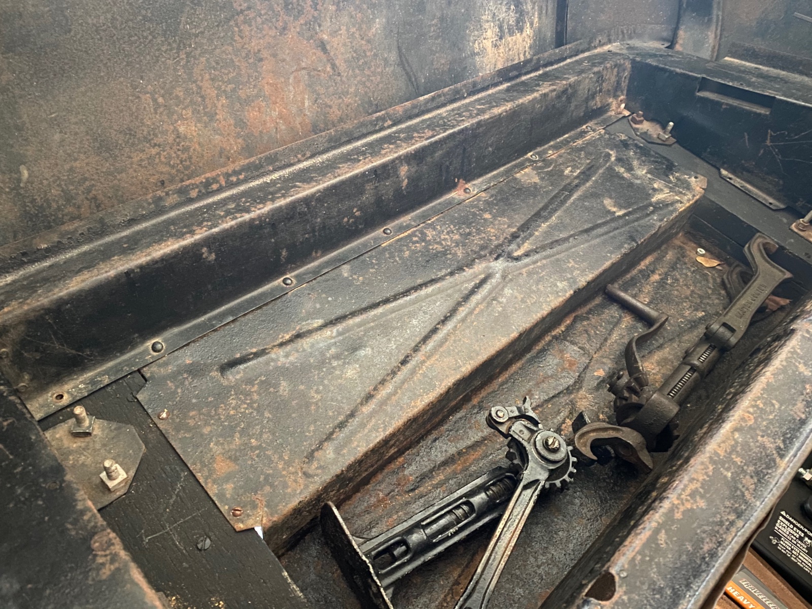

Post by RustyFords » Sun Dec 22, 2019 11:16 pm
Here you go George. I’m missing the vertical wood slats but I think it’s otherwise pretty complete.
One thing on my car that I believe is a modification made to the car back in the day is the 26-27 style top pivots. I have an earlier set that I’ll probably install.

I jumped in and pulled the axle last night.
One of the shackles was not cooperating so I was forced to persuade it.
I expected the perches to be bad....but wow!
The spring set had an extra leaf added. That, combined with the fact that two rear spring clamps had been added to the front crossmember, leads me to believe that this car was set up, back in the day to do some heavy hauling. That's in line with other evidence I've discovered about this car. It was worked hard on the farm during WW2 and possibly before. The old girl deserves respect and thanks for doing her part to keep the country going during trying times.
1924 Touring
Posts: 1847
Location: Clark, WY
Post by Scott_Conger » Sun Jan 05, 2020 3:39 pm
Not many miles left before what could become a bad accident. Very good that you're doing this. New perches are nearly indistinguishable from originals and are worth the expense.

Post by RustyFords » Sun Jan 05, 2020 4:56 pm
Yeah...I knew I was pushing my luck. I didn’t realize how far I’d pushed it. Yikes
