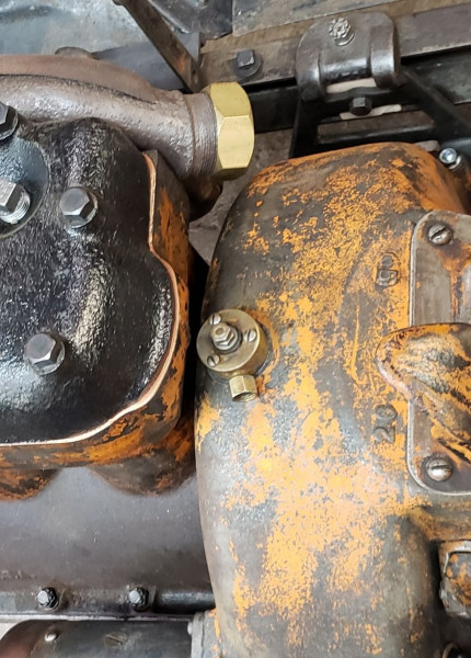

My 1926 touring has an external line from the hogshead to the front pan. It goes through a hole in the pan flange through the gasket and into a threaded hole near the front camshaft bearing. When air is blown into this hole it does not come out anywhere that I can tell. Can someone explain this oiling feature?

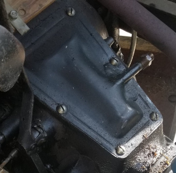

I should have said Transmission cover. It seems that the connection is of no value. I should cap it off at the transmission cover, remove the connector at the front of the pan and use the hole in the pan for a bolt to this blind hole.
Richard

Transmission cover
Transmission cover

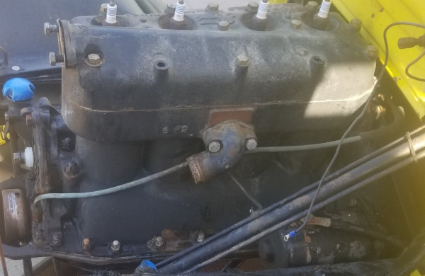

Forgot to say that the motor has the internal oil tube:
Internal Oiler
Internal Oiler

until this last posting with pictures, I assumed you were in error when you pointed to the hole in your first posting. Yes, for all practical purposes this is a blind hole. The last guy just wasn't getting the big picture. That fitting goes where Dan showed...front top edge of motor.
As for no flow. Some mag post oilers flow oil, some don't, and those that don't can be modified for much better flow. They DO have value, and in an instance of a car I bought once, as it turned out, the interior line was plugged with cotton band material and the outside oiler was the only thing saving the motor.
That said, it's your choice, but a properly working, properly installed, outside oiler is a good thing on a T.

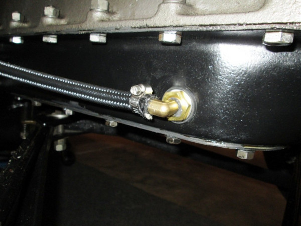

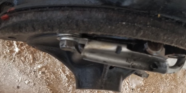

I also use Ford Faithful oilers & this is what I changed out the bottom footplate to.

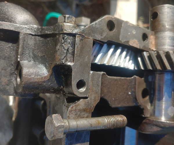

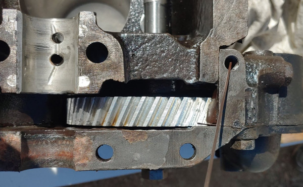

Here is a new photo: With the generating mounting bolt remove and my finger covering the generator casting bolt hole, the air goes into the timing gear area. Note the relieved bolt that may have been intended to allow the oil to pass through. I blew out the holes with the bolt removed (no dirt came out). When I replaced the generator bolt, the air was again blocked. This may have been a "good idea" that never worked.
Bolt removed
Bolt removed
The wide angle of the camera makes the front main look off center. When I cropped the photo, it lost the correct perspective.
I like RajoRacer's solution as it is on the right side of the engine which matches my transmission cover.

Post by RajoRacer » Sat May 23, 2020 2:11 pm
No - it drops right into #1 rod trough.

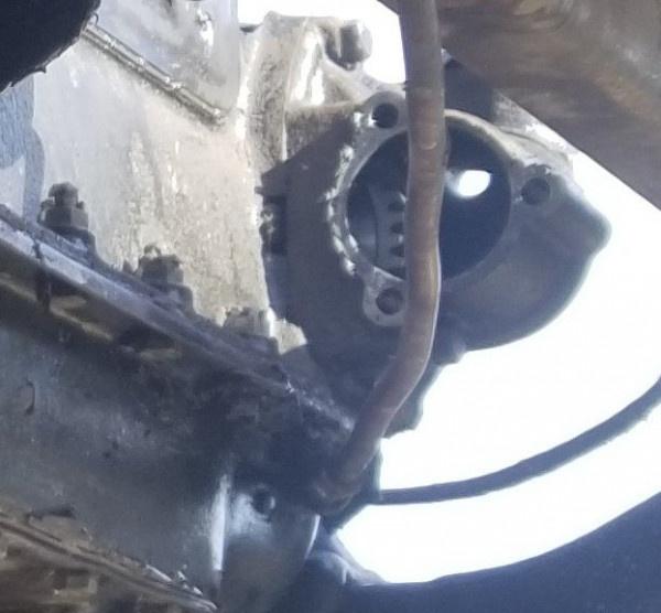

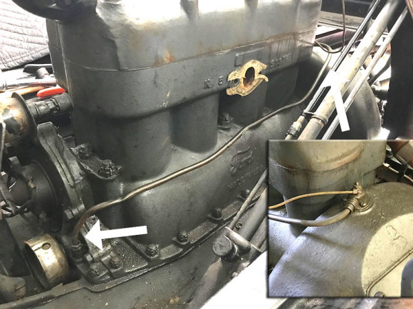

I now understand. My T has 3 front oil connections:
1) The internal aluminum tube.
2) The external blocked one that we have been discussing from the cover to the front.
3) and the one that I forgot about that goes from the hogshead to the front as shown in this photo.
Correct External Front Engine Oiler
Thanks to all of you for your help.
