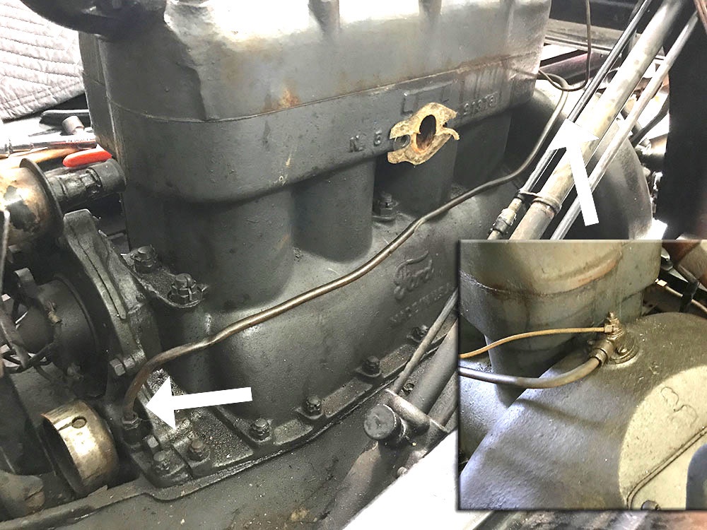

My 1926 touring has an external line from the hogshead to the front pan. It goes through a hole in the pan flange through the gasket and into a threaded hole near the front camshaft bearing. When air is blown into this hole it does not come out anywhere that I can tell. Can someone explain this oiling feature?
I have uploaded a photo. Richard

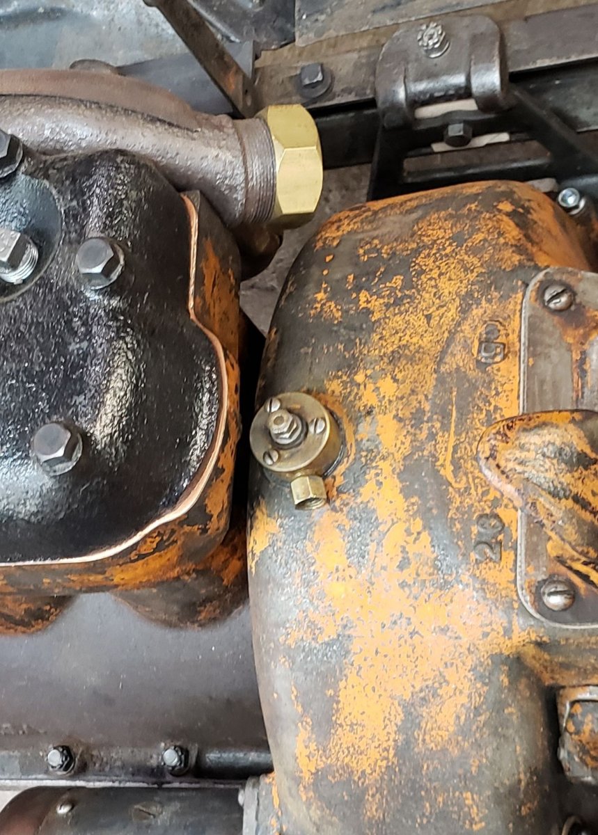

If that outside oiler is the common magneto fitting outside oiler, then the tubing from the mag contact on the hogshead should run to a special hollow bolt replacing one of the cylinder front cover bolts.
That special bolt will flow the oil into the front of the crankcase on the driver's side.

Forgot to say that the motor has the internal oil tube:

until this last posting with pictures, I assumed you were in error when you pointed to the hole in your first posting. Yes, for all practical purposes this is a blind hole. The last guy just wasn't getting the big picture. That fitting goes where Dan showed...front top edge of motor.
As for no flow. Some mag post oilers flow oil, some don't, and those that don't can be modified for much better flow. They DO have value, and in an instance of a car I bought once, as it turned out, the interior line was plugged with cotton band material and the outside oiler was the only thing saving the motor.
That said, it's your choice, but a properly working, properly installed, outside oiler is a good thing on a T.
Welcome to the hobby.

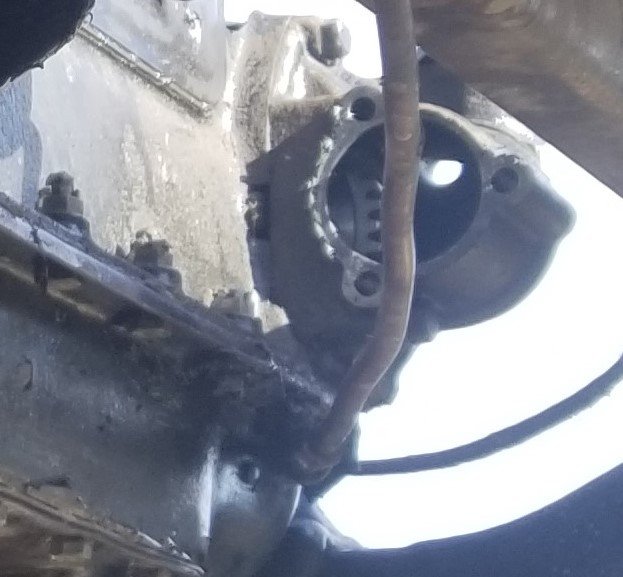

When you say the air doesn't seem to go anywhere, do you mean it blows back at you or can you hear it coming out in the casting?
True that hole ends in line with the side mounting bolt, but the builder may have drilled a hole from the inside of the casting to where the bolt that mounts to pan rail is. With the generator off the car as it looks to be, turn the lights off and shine a flashlight thru the hole. If a hole was drilled you should be able to see light inside the casting. With the type of oil pickup that is shown, the oil line would have to be on the passenger side and come in somewhere over there. If the casting was opened up, seems that it would be a workable solution to were to mount the line if didn't have shoe that mounted to bottom of pan or a fitting in the side of same.
I have a Sure-feed that have been wanting to mount but don't have the shoe and don't want to mess around with pulling the engine to plumb in a fitting in on the side. Pulling the generator and that casting is a lot more doable at this time. Even if it did leak a little, almost would have to be less or about the same as the shoe type that is mounted to inspection cover on bottom of pan.

That first picture, the front main bearing looks like its way off center or is it just the angle of the camera.

Here is a new photo: With the generating mounting bolt remove and my finger covering the generator casting bolt hole, the air goes into the timing gear area. Note the relieved bolt that may have been intended to allow the oil to pass through. I blew out the holes with the bolt removed (no dirt came out). When I replaced the generator bolt, the air was again blocked. This may have been a "good idea" that never worked.
I like RajoRacer's solution as it is on the right side of the engine which matches my transmission cover.
Richard
The wide angle of the camera makes the front main look off center. When I cropped the photo, it lost the correct perspective.I like RajoRacer's solution as it is on the right side of the engine which matches my transmission cover.
Richard

IMHO, the best and easiest to install outside Oiler is the one described and pictured in Dan Trease’s Post. I’ve got ‘em on all my T s and every Model T I’ve previously had. On the last install I cut out about 8” of copper tubing and replaced with clear plastic tubing. Sure enough; that flywheel splash system is awesome. At an idle, oil was pouring down to the front main bearing then into the #1 rod trough.

I now understand. My T has 3 front oil connections:
1) The internal aluminum tube.
2) The external blocked one that we have been discussing from the cover to the front.
3) and the one that I forgot about that goes from the hogshead to the front as shown in this photo.
Thanks to all of you for your help.
Richard
