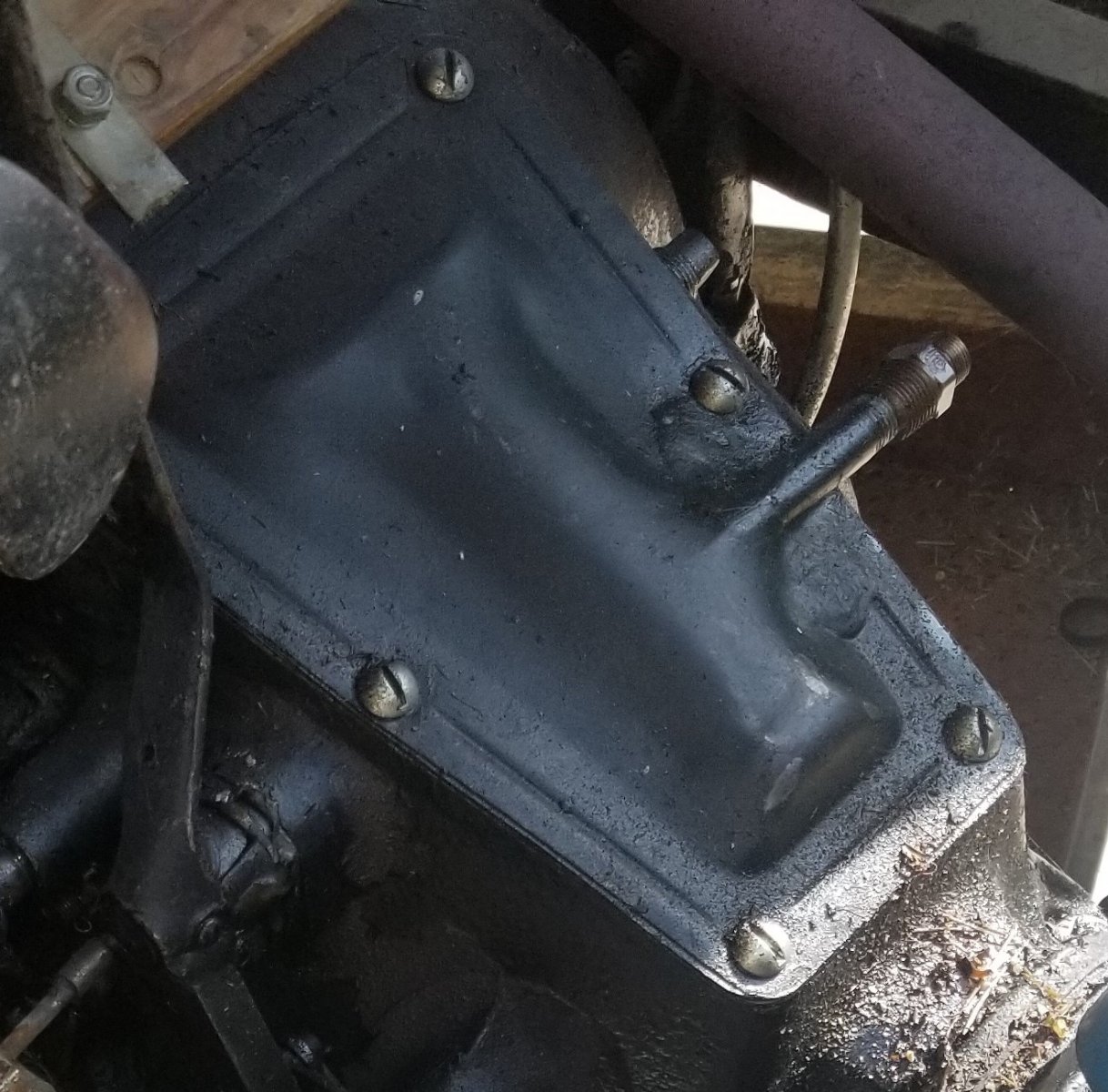

My 1926 touring has an external line from the hogshead to the front pan. It goes through a hole in the pan flange through the gasket and into a threaded hole near the front camshaft bearing. When air is blown into this hole it does not come out anywhere that I can tell. Can someone explain this oiling feature?
I have uploaded a photo. Richard

I should have said Transmission cover. It seems that the connection is of no value. I should cap it off at the transmission cover, remove the connector at the front of the pan and use the hole in the pan for a bolt to this blind hole.

Forgot to say that the motor has the internal oil tube:

Here is a new photo: With the generating mounting bolt remove and my finger covering the generator casting bolt hole, the air goes into the timing gear area. Note the relieved bolt that may have been intended to allow the oil to pass through. I blew out the holes with the bolt removed (no dirt came out). When I replaced the generator bolt, the air was again blocked. This may have been a "good idea" that never worked.

I now understand. My T has 3 front oil connections:
1) The internal aluminum tube.
2) The external blocked one that we have been discussing from the cover to the front.
3) and the one that I forgot about that goes from the hogshead to the front as shown in this photo.
Thanks to all of you for your help.
Richard
